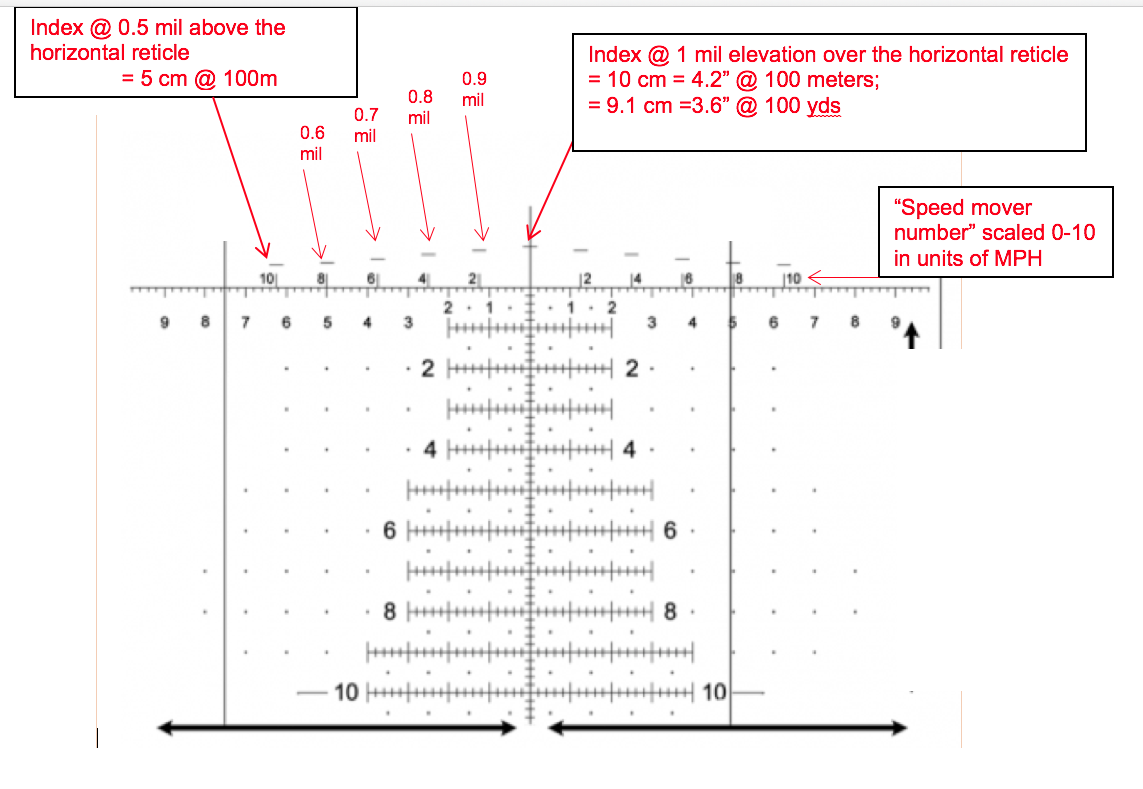

It's just mils. The hop half has .5, .6, .7, .8 and .9 marks with a 1 mil hash at the center. You can use any size target you like, they just show 12" as an example. An 18" target is at 500 if it's 1 mil, 550 if .9, 620 if .8, 710 if .7 etc., just use your MilDot Master.

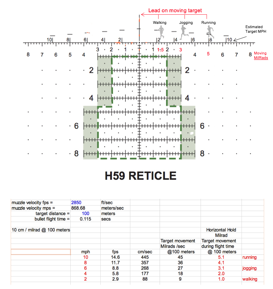

If you've used the mover system, it's like cheating. The number corresponds to the speed of the mover. When the mover hits the speed you've calculated, that's when you shoot.

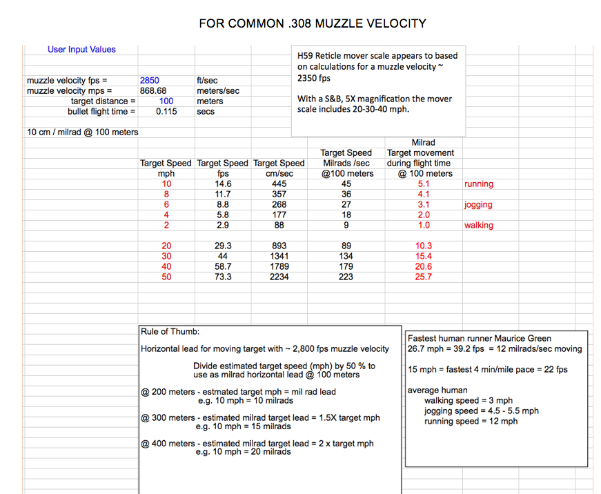

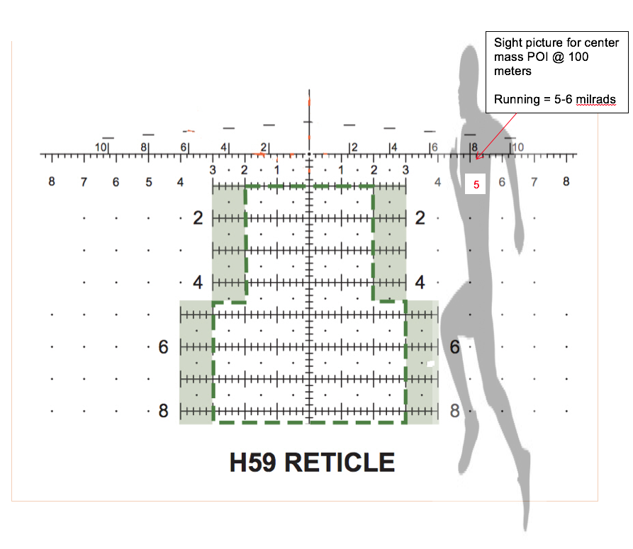

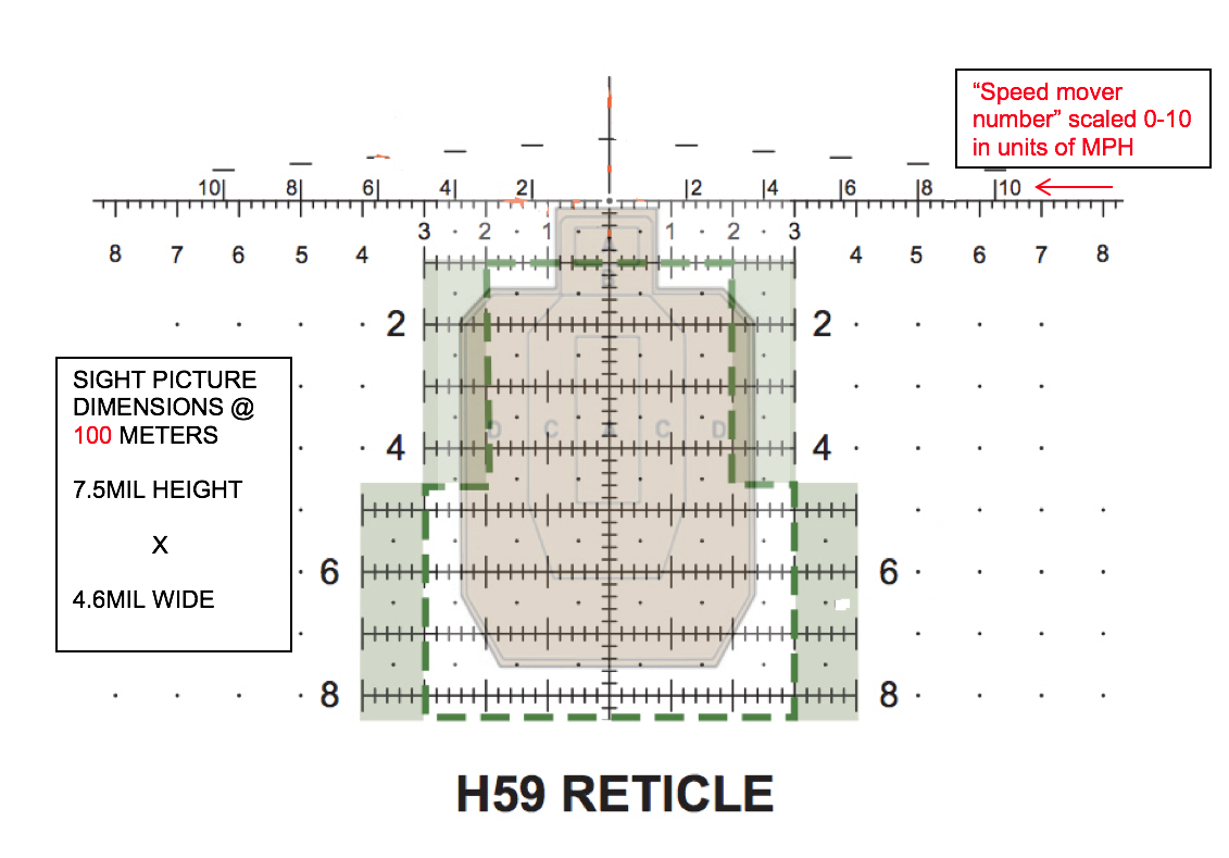

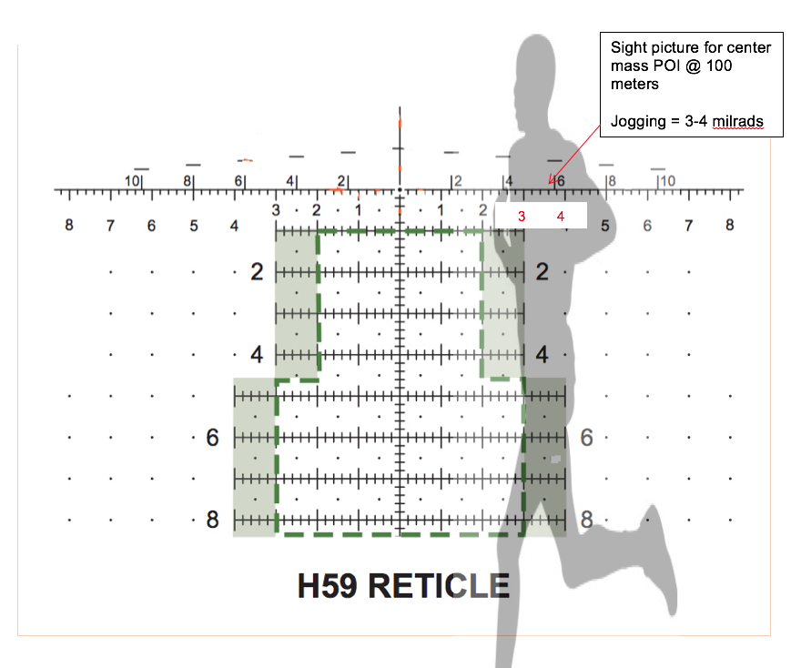

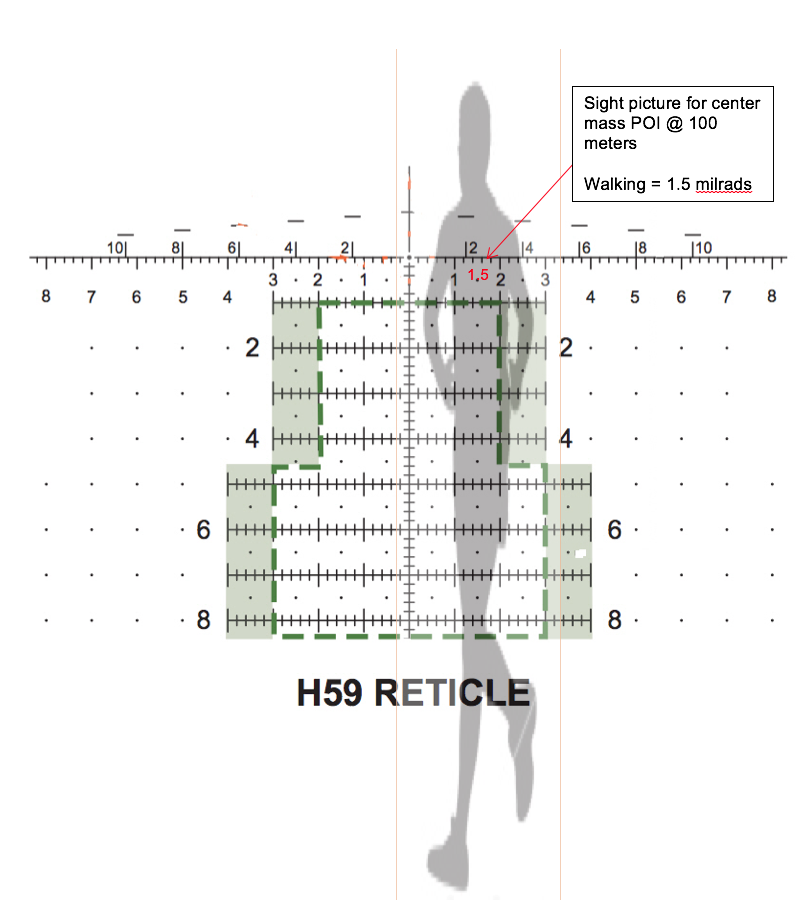

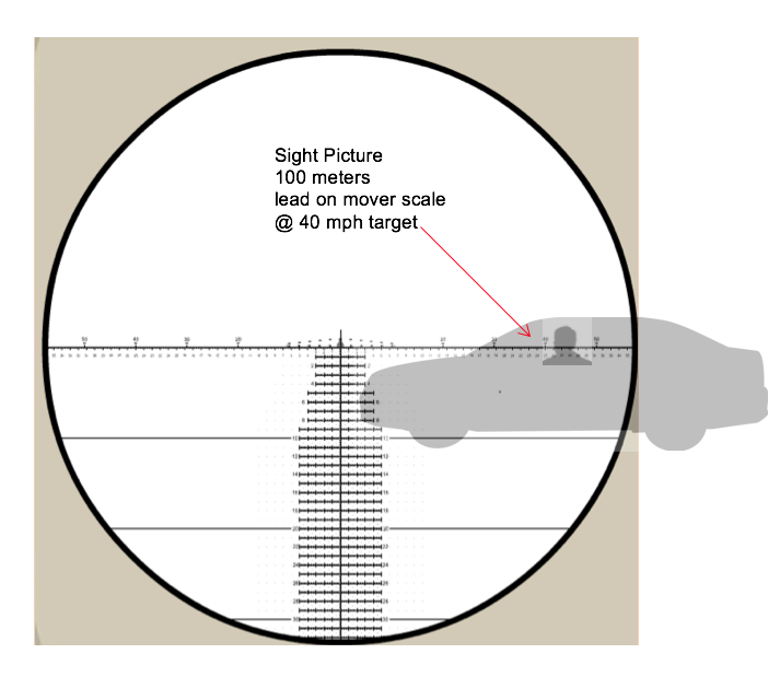

I like the H59. The moving scale is based on some underlying assumptions. These might help.

The mover referencing is not a complete solution, however it offers a consistent reference system to combine with shooter experience, rather than wild ass guessing. The mover referencing has nothing to do with target size or goat fucking; one can either use the horizontal indices above the horizontal reticle or the matrix below for sizing targets.
