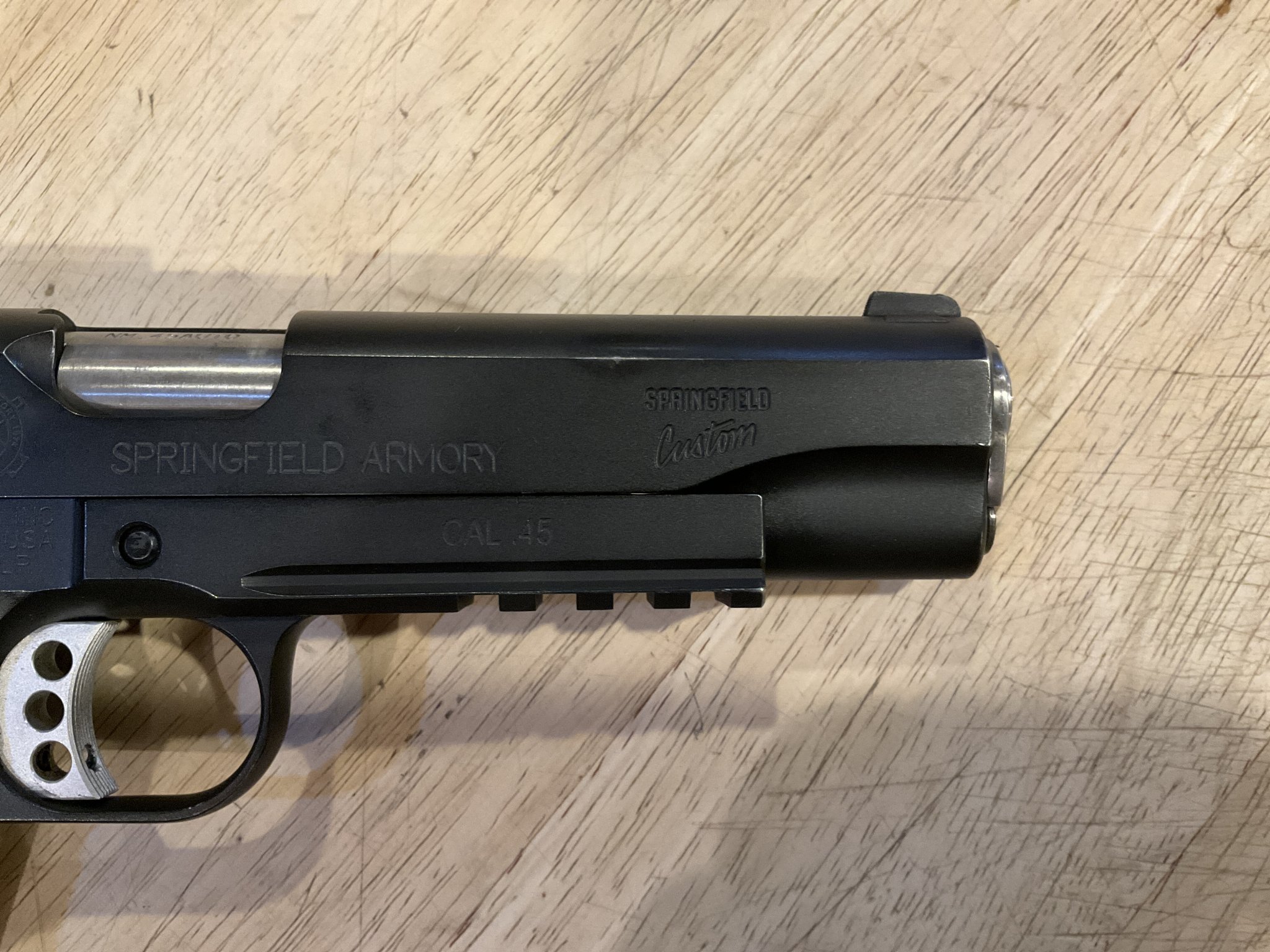

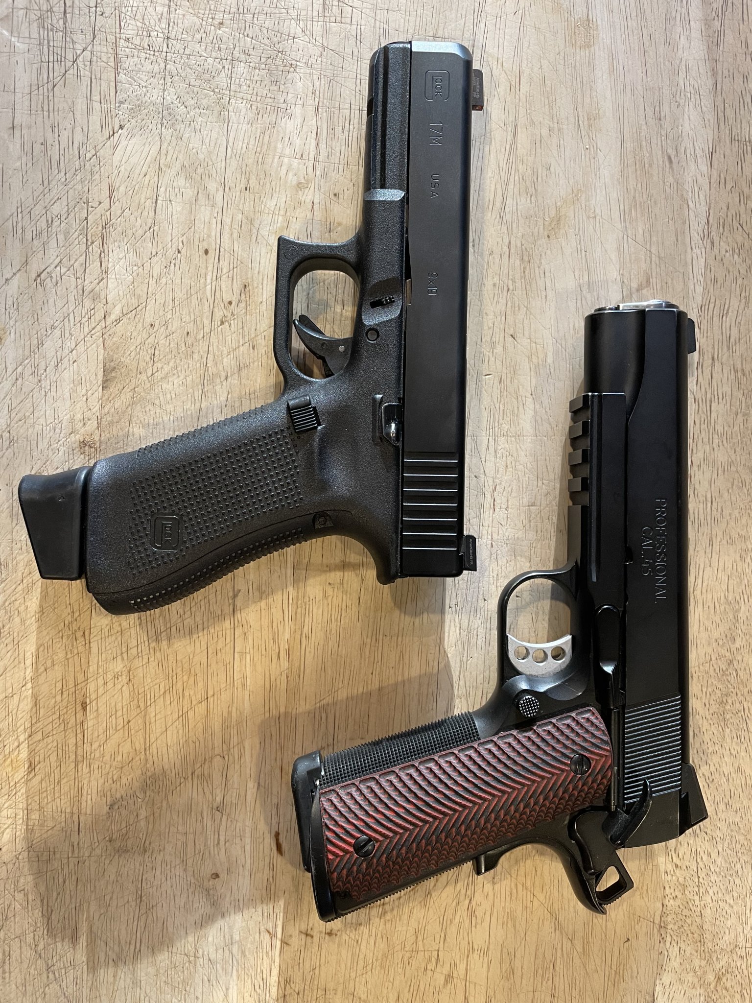

That’s right. As far as I’ve been told, the Bureau Models and Professionals were originally purchase as slick bottom guns (no light rail). When the barrel issue surfaced, the lower receivers and barrels were replaced and “LR” was added to the serial. These guns have a mismatch of slide cut and end of frame. As pictured….
The later purchase guns, the Operators, were purchased as railed guns and the slides had ball-end milling to match the lower receivers.

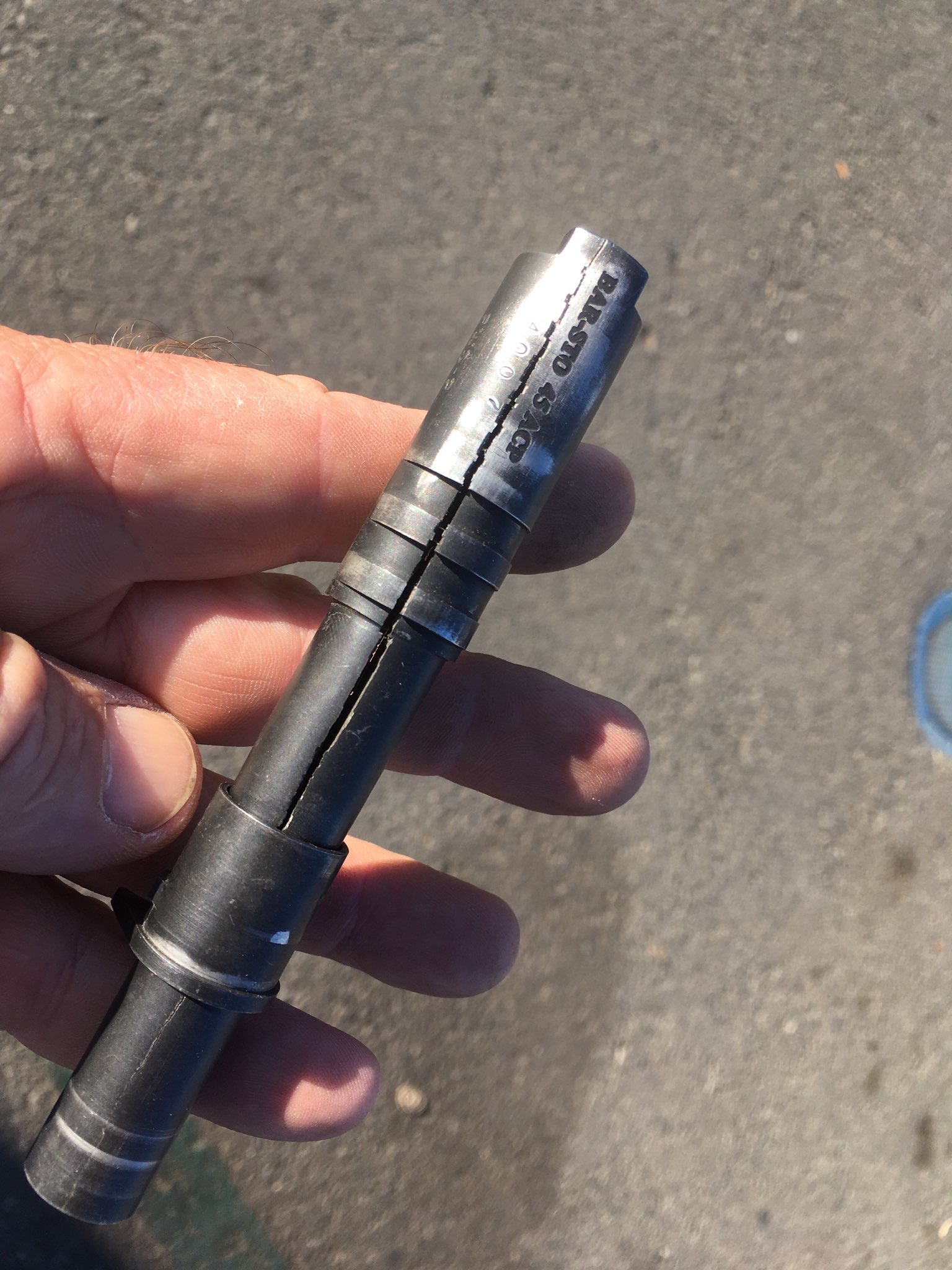

Just this week I was talking with one of my HRT buddies about 1911’s and the growing pains they had in the early days of the Springfield. Apparently, barrels were rupturing under the copious diet of 230gr +P stuff we feed them. So, they were almost all modified to ramped barrels.
Wow that’s a bit of history. Any idea what year they went to ramped barrels?
That’s pretty awesome.
Hmmm, I heard same about ruptured Barstow barrels in MEUSOC 1911’s? Here is a picture of one barrel from a 2112 that I know notice the weapons ser number 4007 on top of the chamber and the faint PWS on the side.
When the barrels fail/failed they just replace it with another one and drive on.

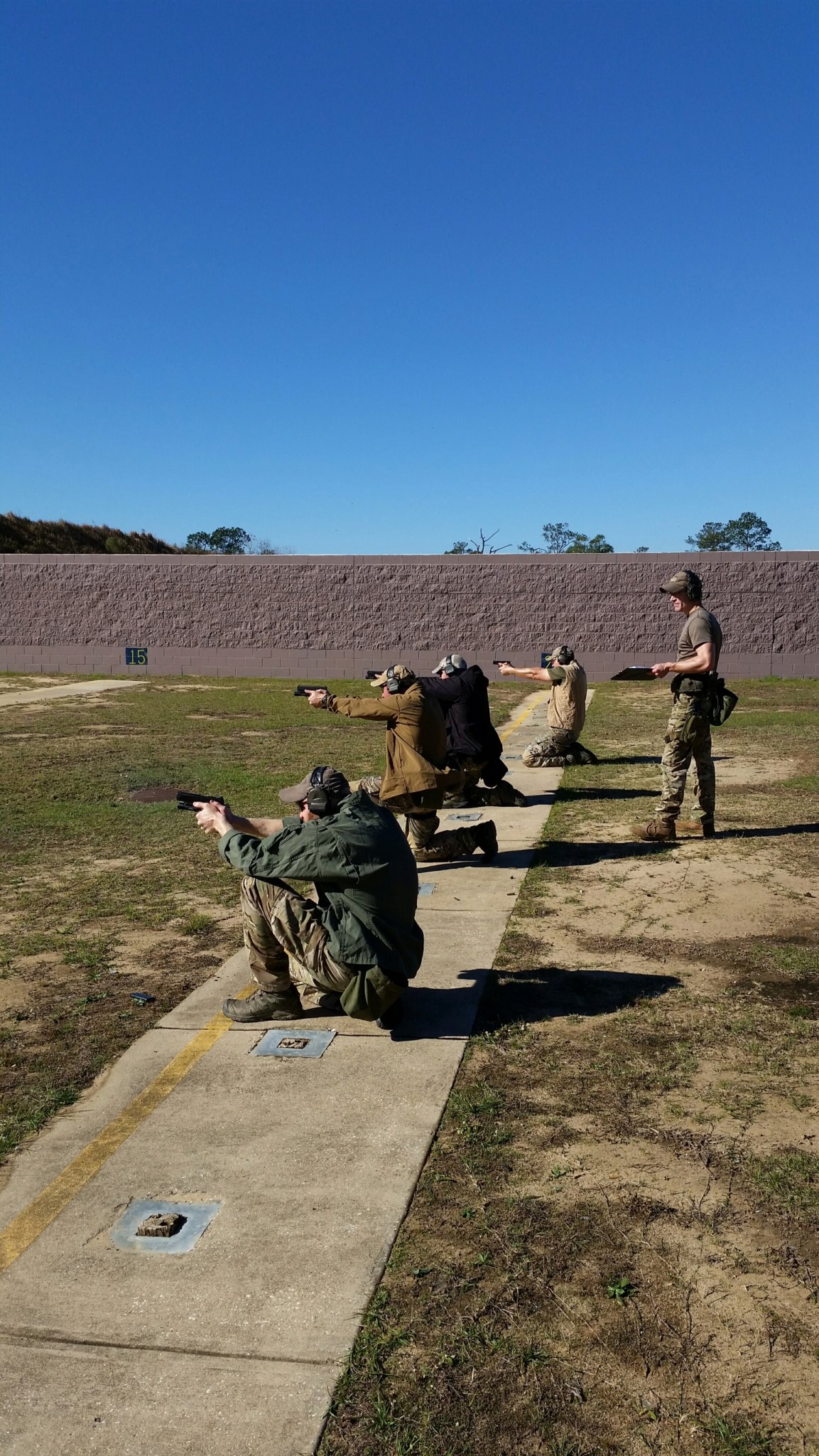

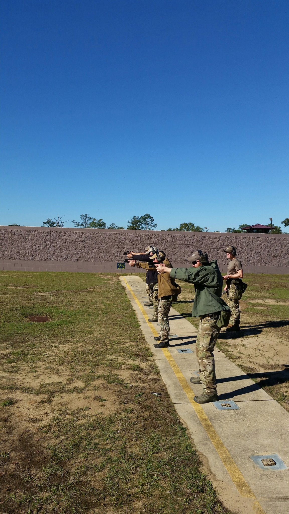

Pretty obvious that the old PPC course of fire is no longer used. The 4x4's cut right off.
There have been at least three pistol qual courses (PQC’s) over the course of the last ten years, and there is a SWAT PQC. I think the SWAT PQC calls for the barricade, but I’ve never shot it that way and haven’t seen barricades used outside the Academy at all. I’ve also not fired on a range outside Quantico where the turning targets still work…
Qual courses are just administrative requirements anyhow. Training is a different animal altogether.
I’m not familiar with the PPC course you reference..
Reactions: RTESantaFe
It was a FBI developed cof in the 40's and turned into an NRA competition course. Obviously not relevant anymore.
Reactions: Skunk
The PPC Course was a 150 rd. Course fired at 7,15, 25 and 50 yards. Shot double action with the revolver with barricades at 25 and 50 yards. Also required shooting right and left handed on the barricades. As I remember there were 5 classes; Marksman, Sharpshooter, Expert, Master and Hi Master. The ILL. Police Assn shot for many years a 48 shot course which was shot by many police departments. I competed 11 years with the IPA winning the Top Gun in ‘95. Great fun!

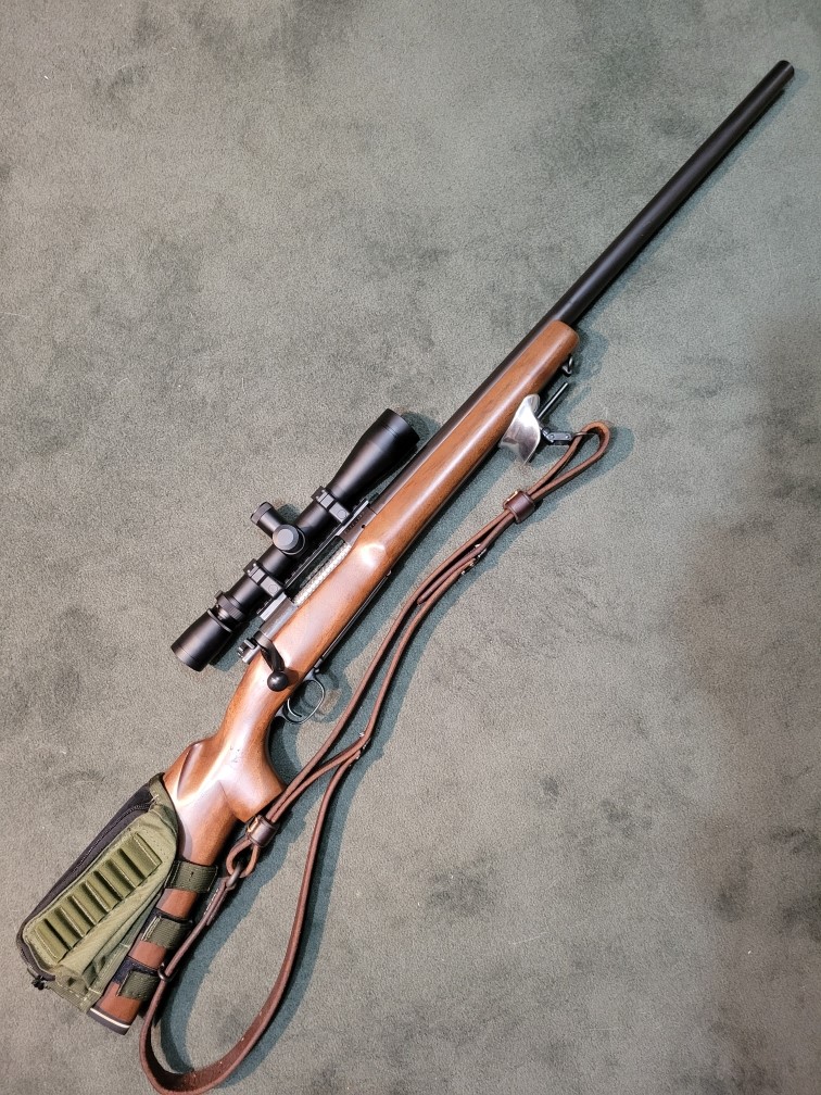

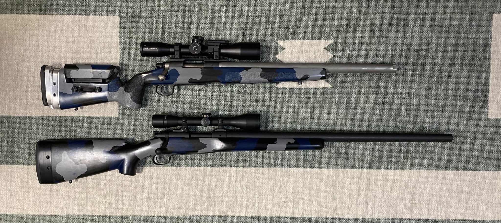

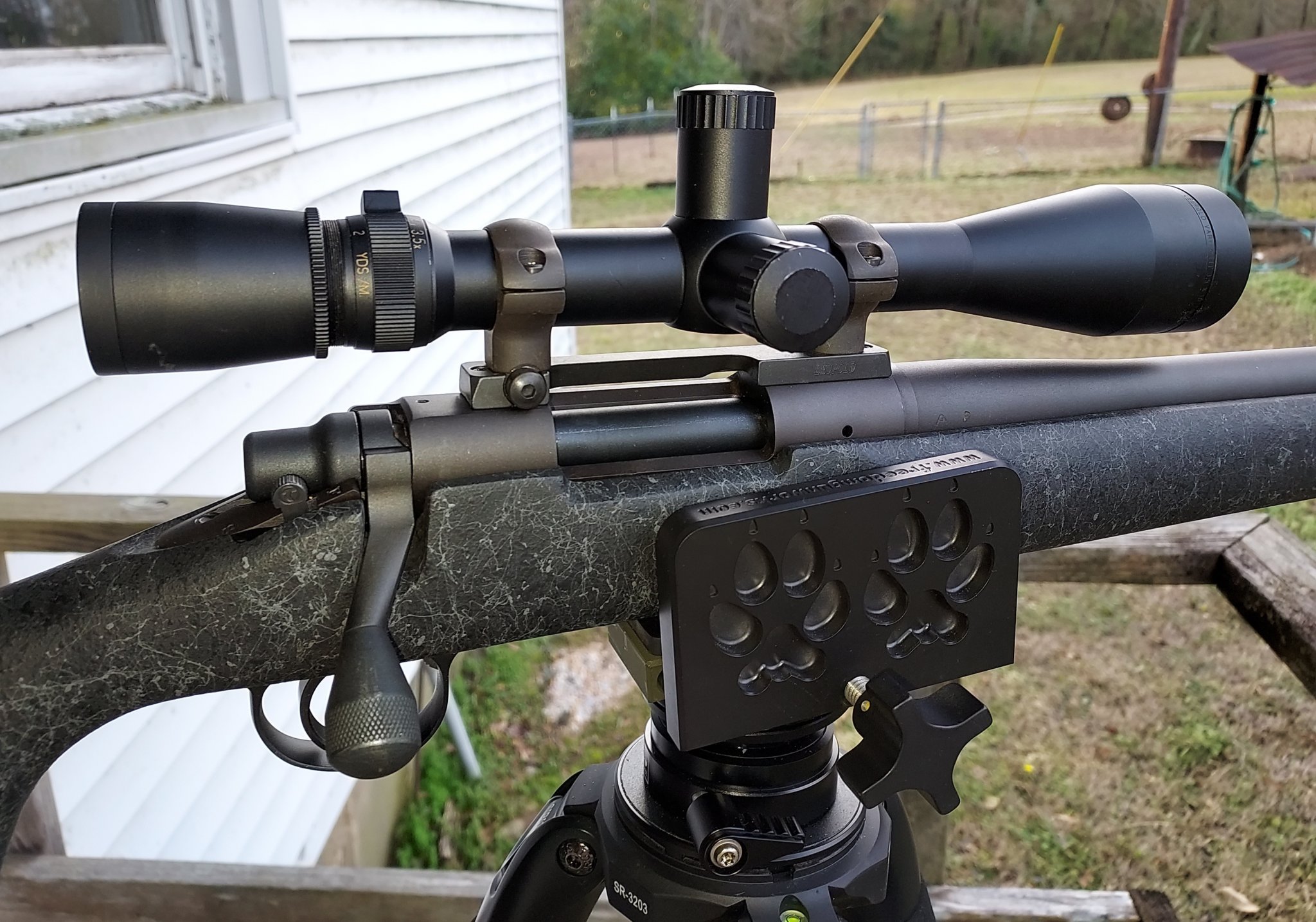

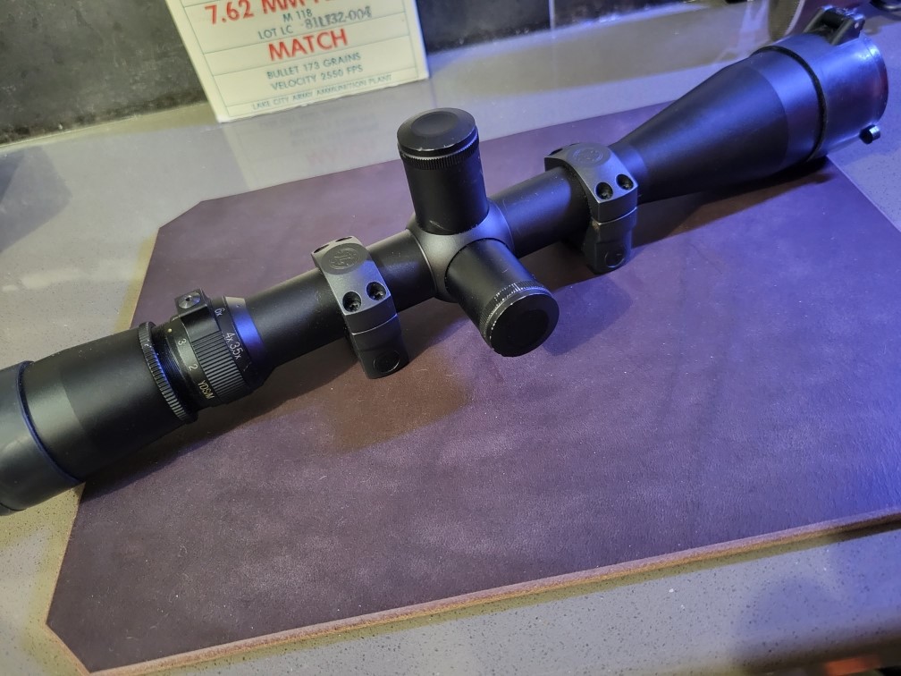

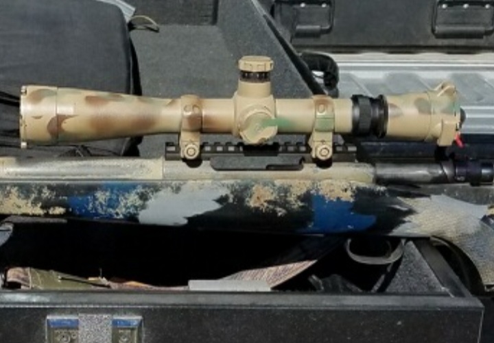

After Skunk built the clone for his retired bud, February 2022, I started gathering parts to do the same for my retired bud (and, maybe me also...)
First thing I got was a short 70 action. Then a barrel, then a short 700 action, then a 3.5-10 mildot, then a second 3.5-10 mildot. Got the matte mount and a set of matte rings. Didn't have much luck with stocks, yet, wasn't ready to order from McMillan. Yet...
Today, is much closer, still working out the stock thing. It's not perfect. But, closer and shootable...
Bud would probably take it, as is, but, he can't have it yet...
Barrel details?

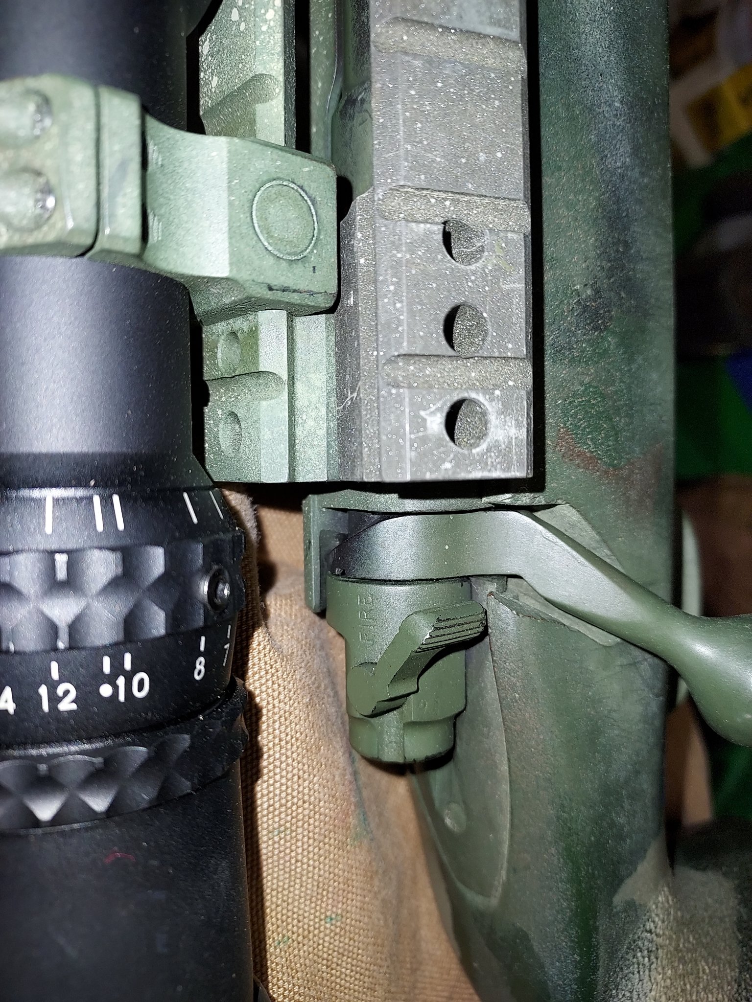

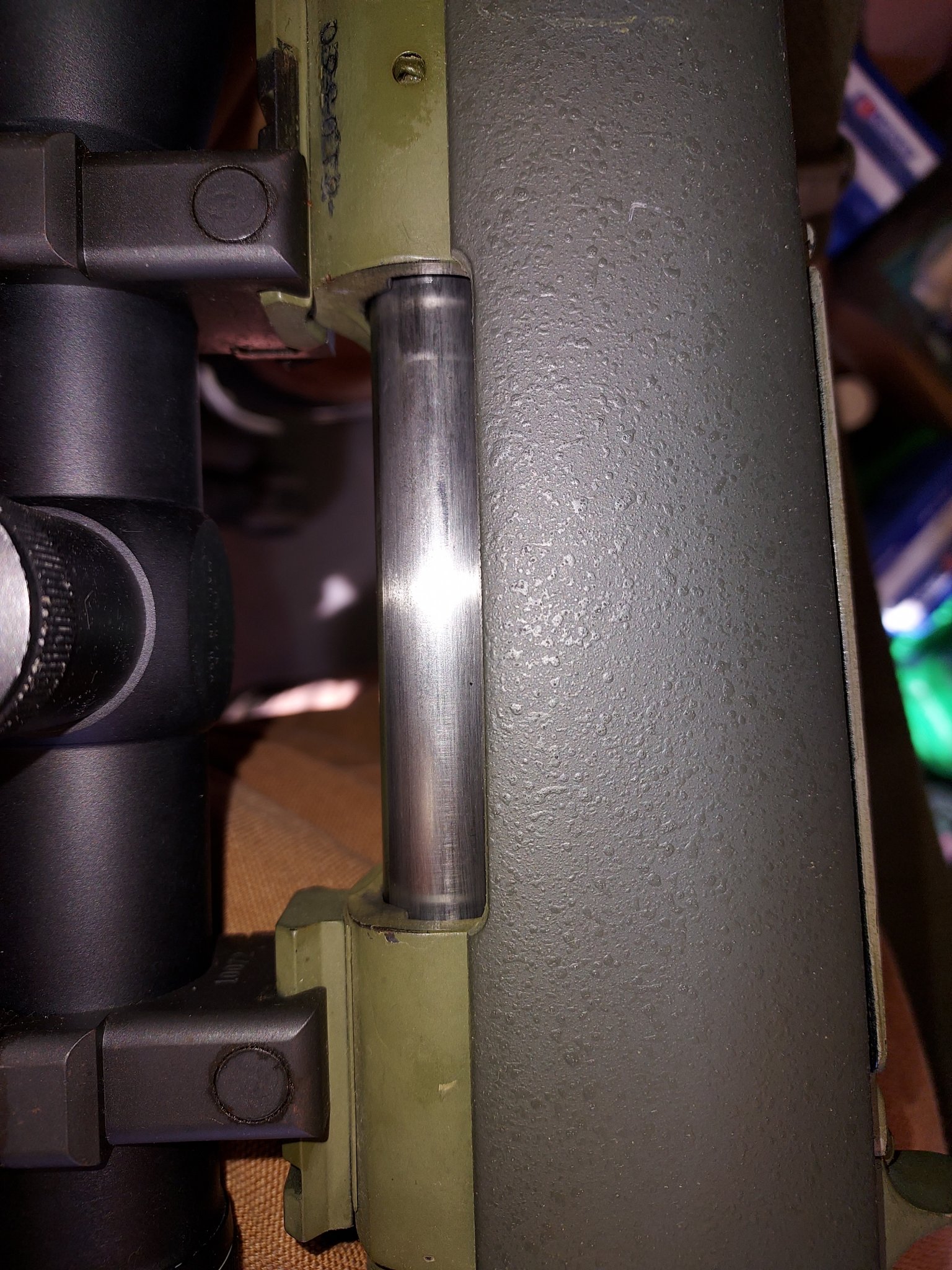

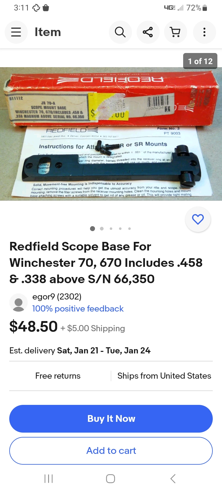

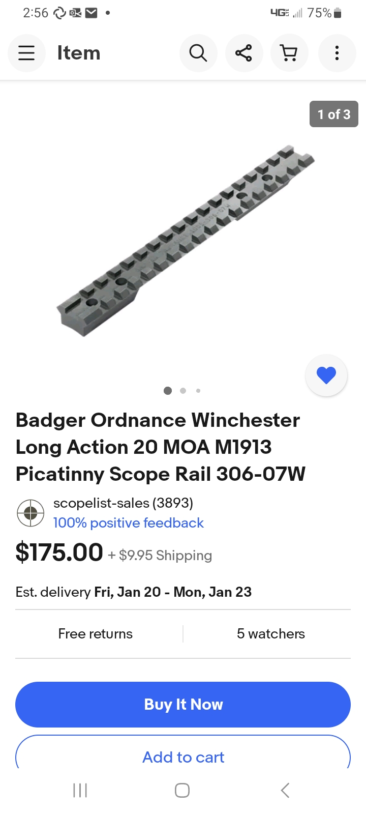

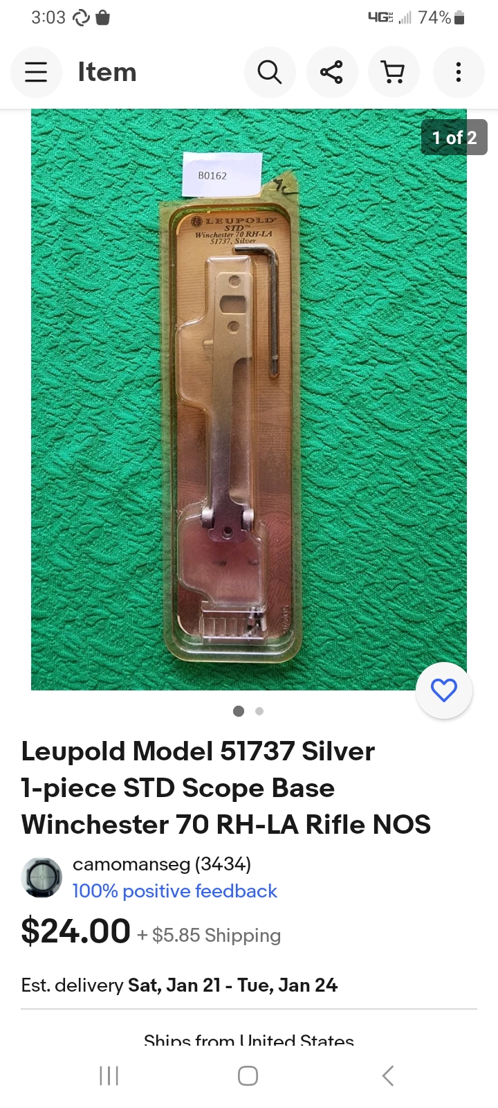

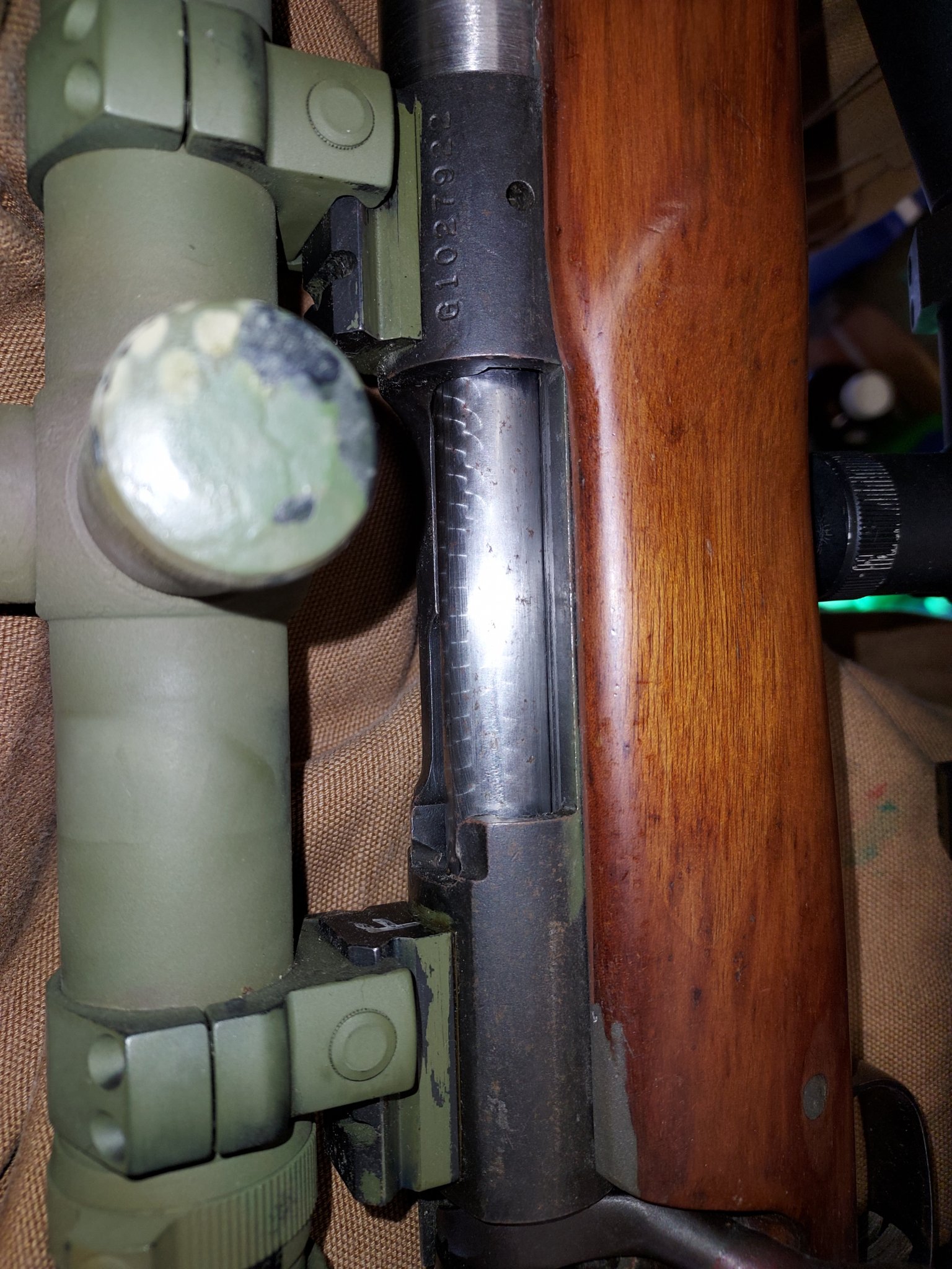

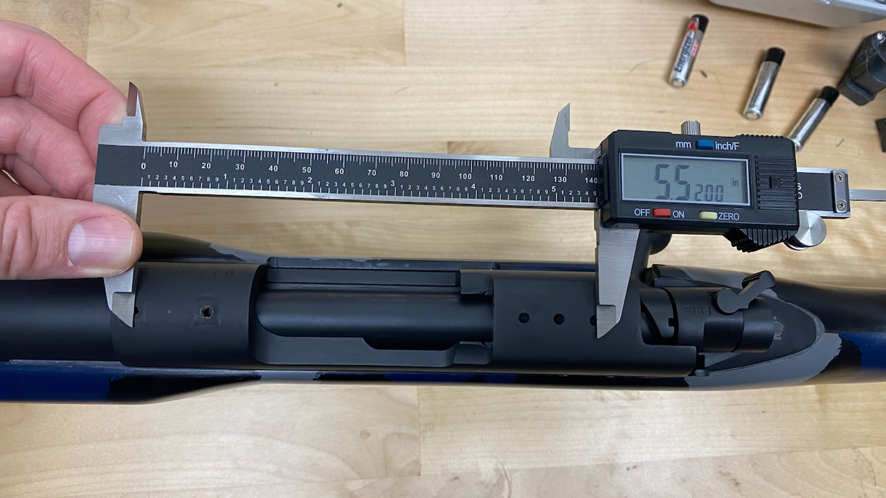

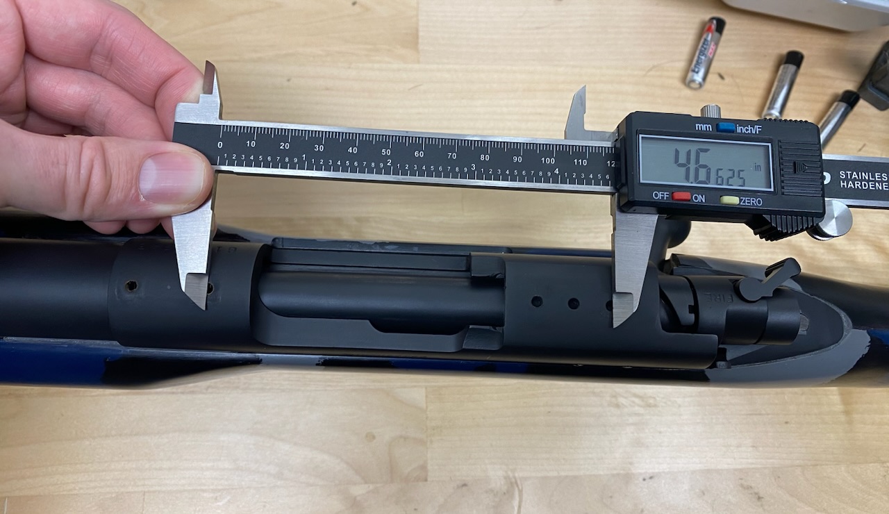

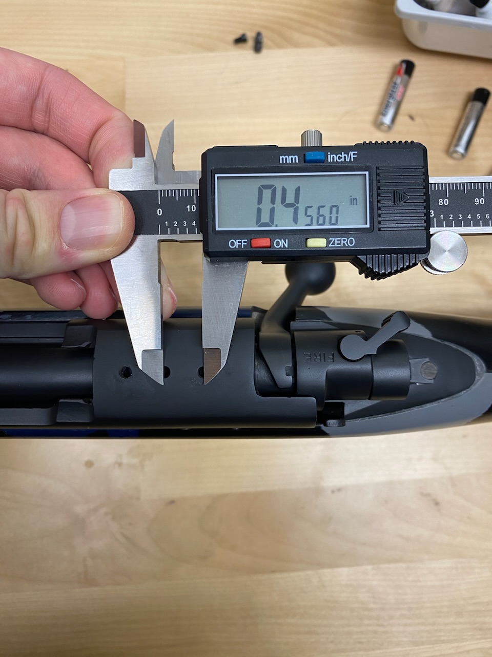

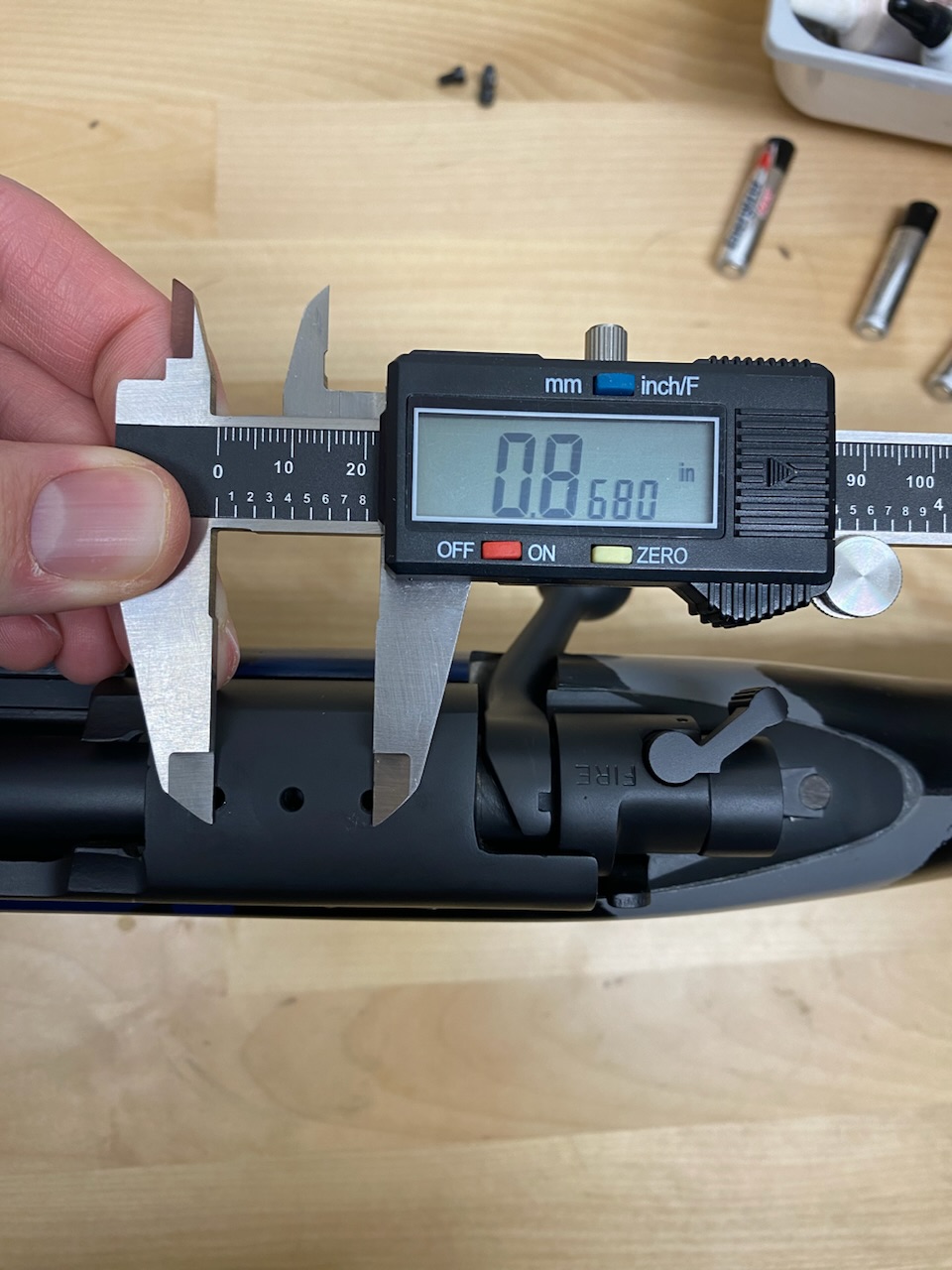

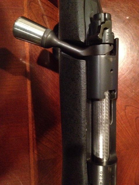

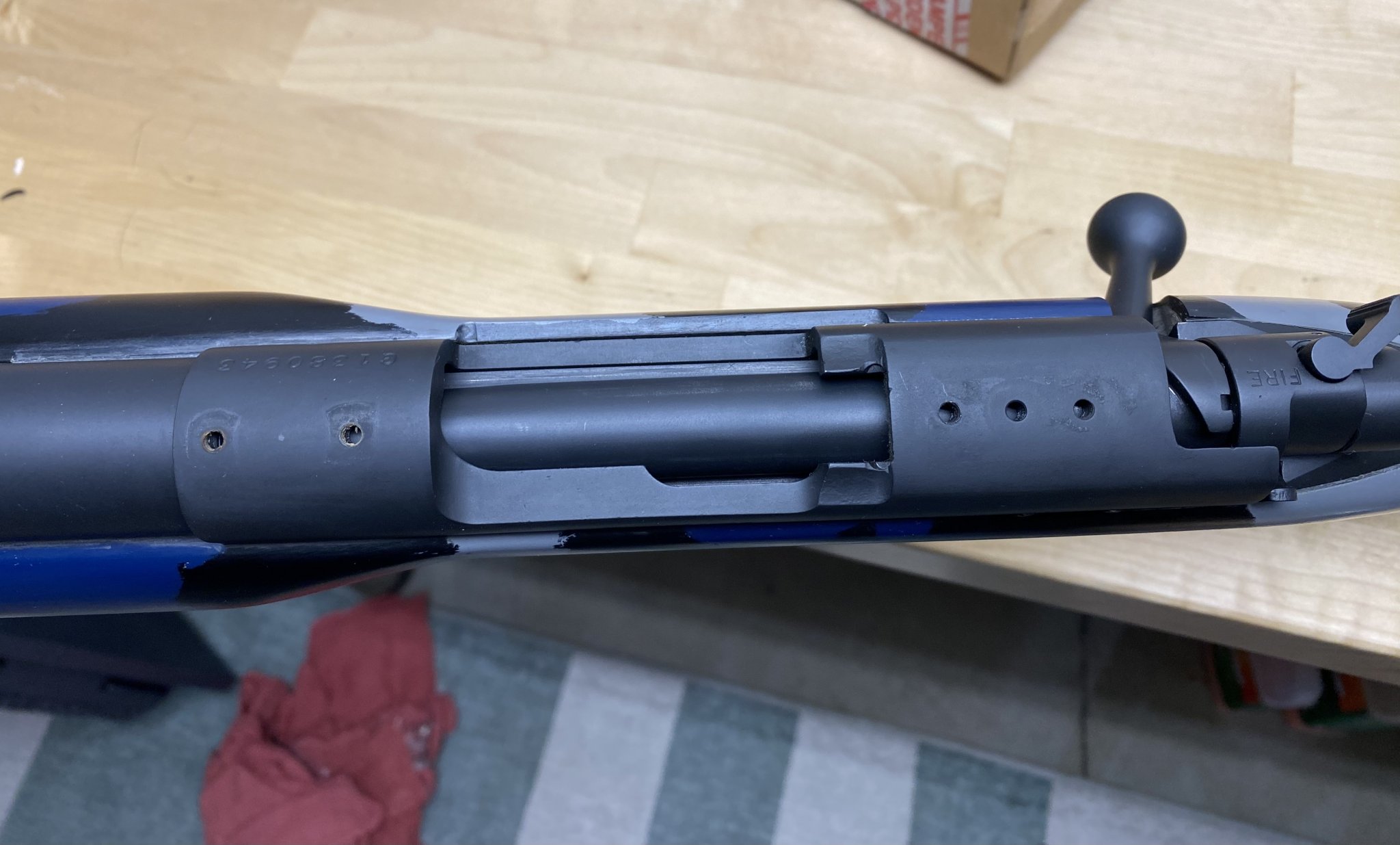

@j-huskey any idea what would be the best mid 80’s era scope base for this? I bought a badger SA without measuring, and it’s definitely not a SA (even though it’s a 308). I have a Leupold 3.5-10x40 that is begging to go on the rifle.
That's a clip slotted long action model 70 in 308.
The Redfield or leupold long action 70 base should fit as long as it's a 4 hole base. The right base would only take one screw on the rear bc the clip slot ate the 4th hole location. That receiver has extra holes drilled in it.
Will post the correct hole spacing in the morning.
65-66-67 palma rifle has the clip slots like that. It's specific to that action, is a standard long action but has the additional clip slot. Not describing it just right, will have to dig mine out to get photos to show yall the differences.
Things intruded this a.m.. still on the agenda.
Very cool thread!

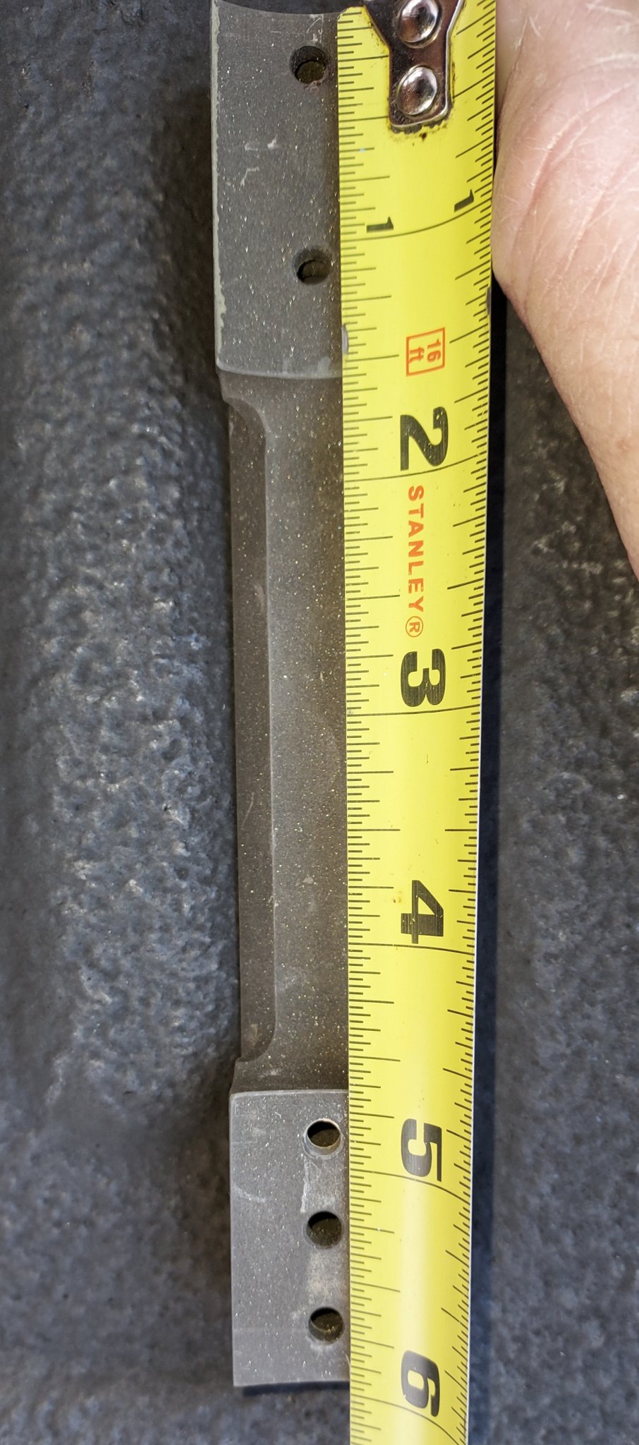

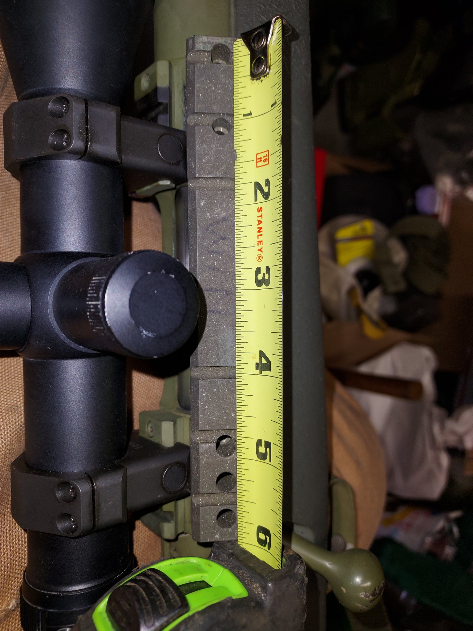

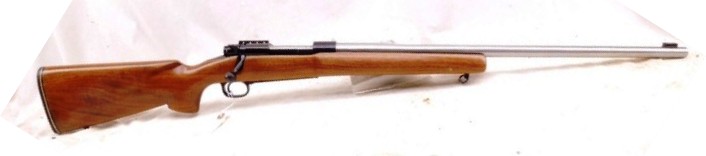

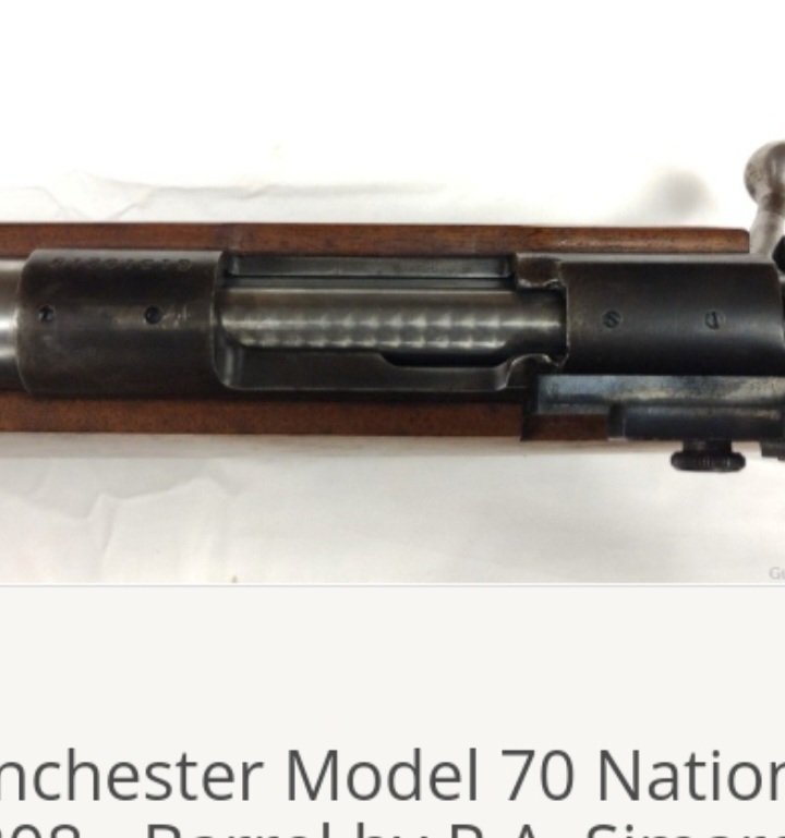

I have a couple clip-slotted Winchesters (National Match XTC style, no FBI history), and scope mounting was a little more work. 70 Pre-war with clip slot has a special order rail from Badger.
Win 70 Short actions have used one piece rails, with just one attachment used in rear due to clip slot.
Looking at the 3 hole pictures, I think I can have an additional hole drilled & tapped between the rear mounting hole & slip slot for more stability.....
Reactions: Calfed
Very cool thread!
You can add a hole, too easy, and customize a base to fit it by adding a hole to it too. Zero problems.

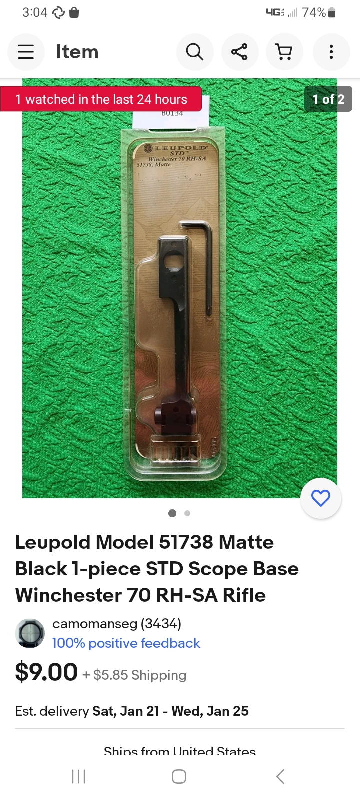

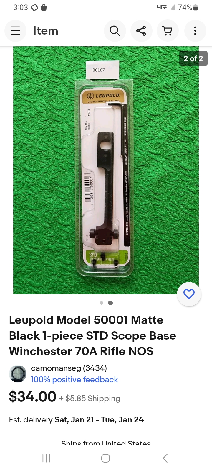

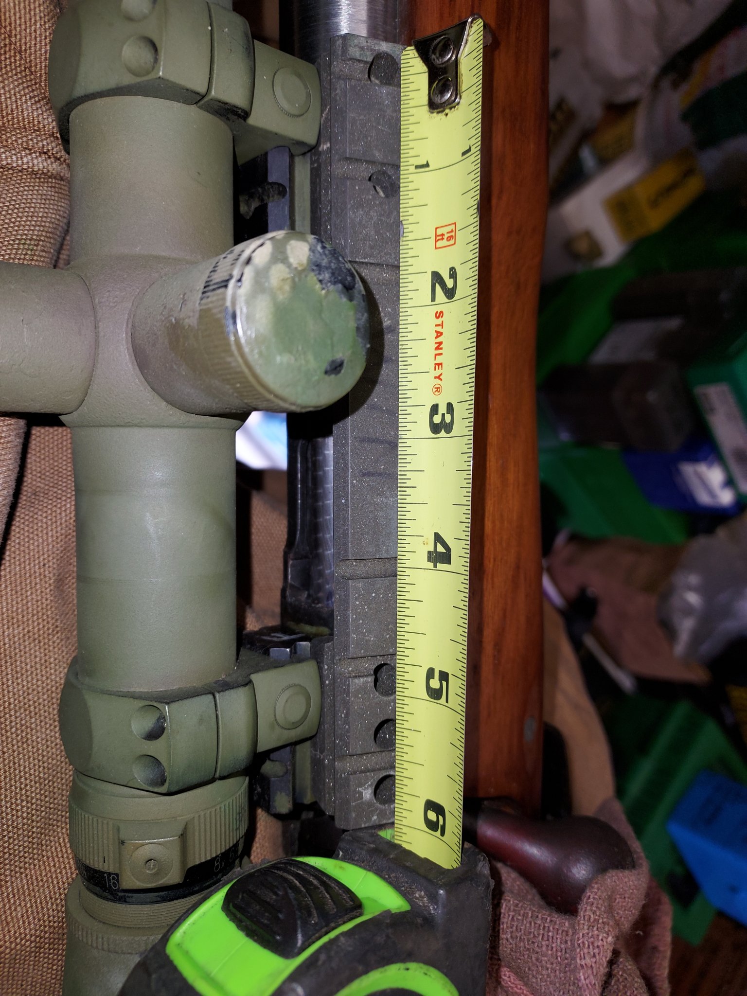

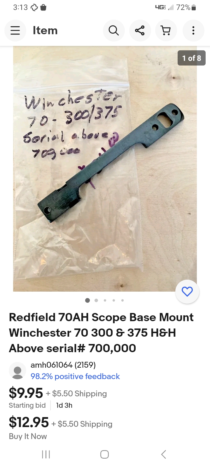

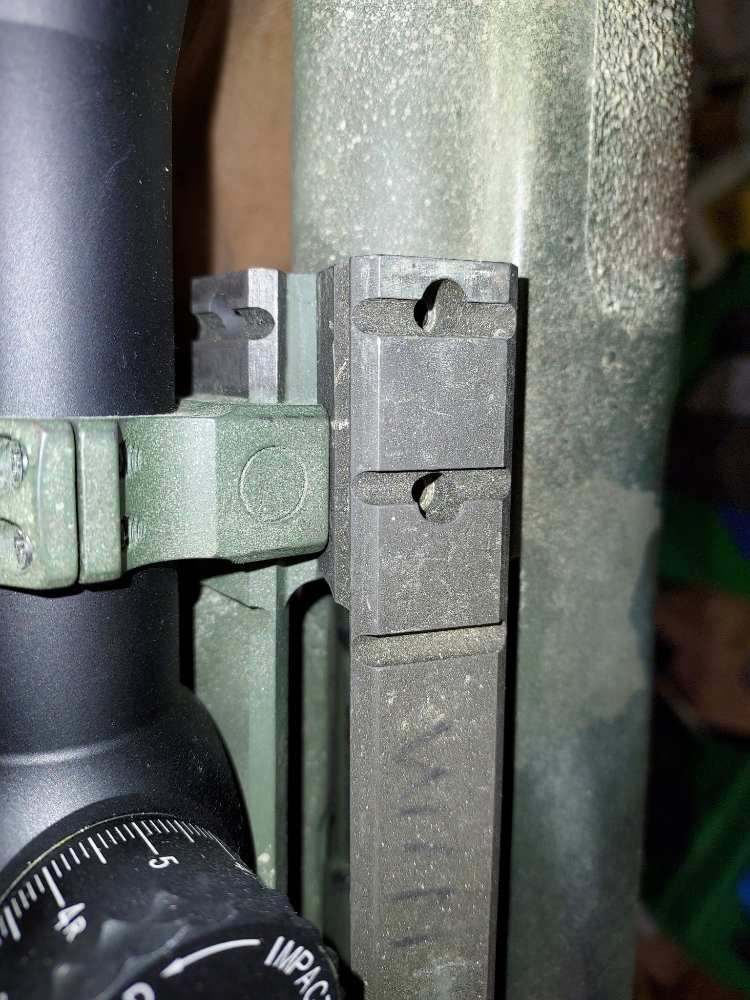

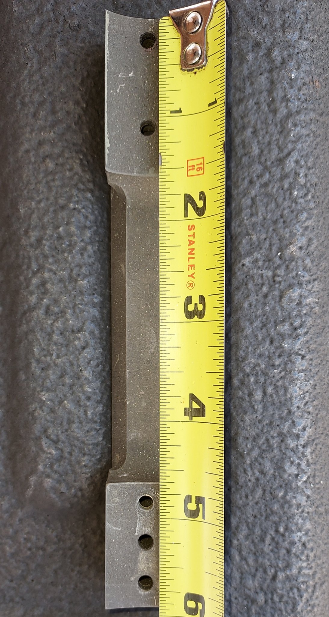

I've got an older clip slotted Winchester M70 NM model also. Note that the older clip slotted 70's use a Model 70 H&H magnum size base. I bought one from EGW when I got my rifle.
This is the one that fit mine...

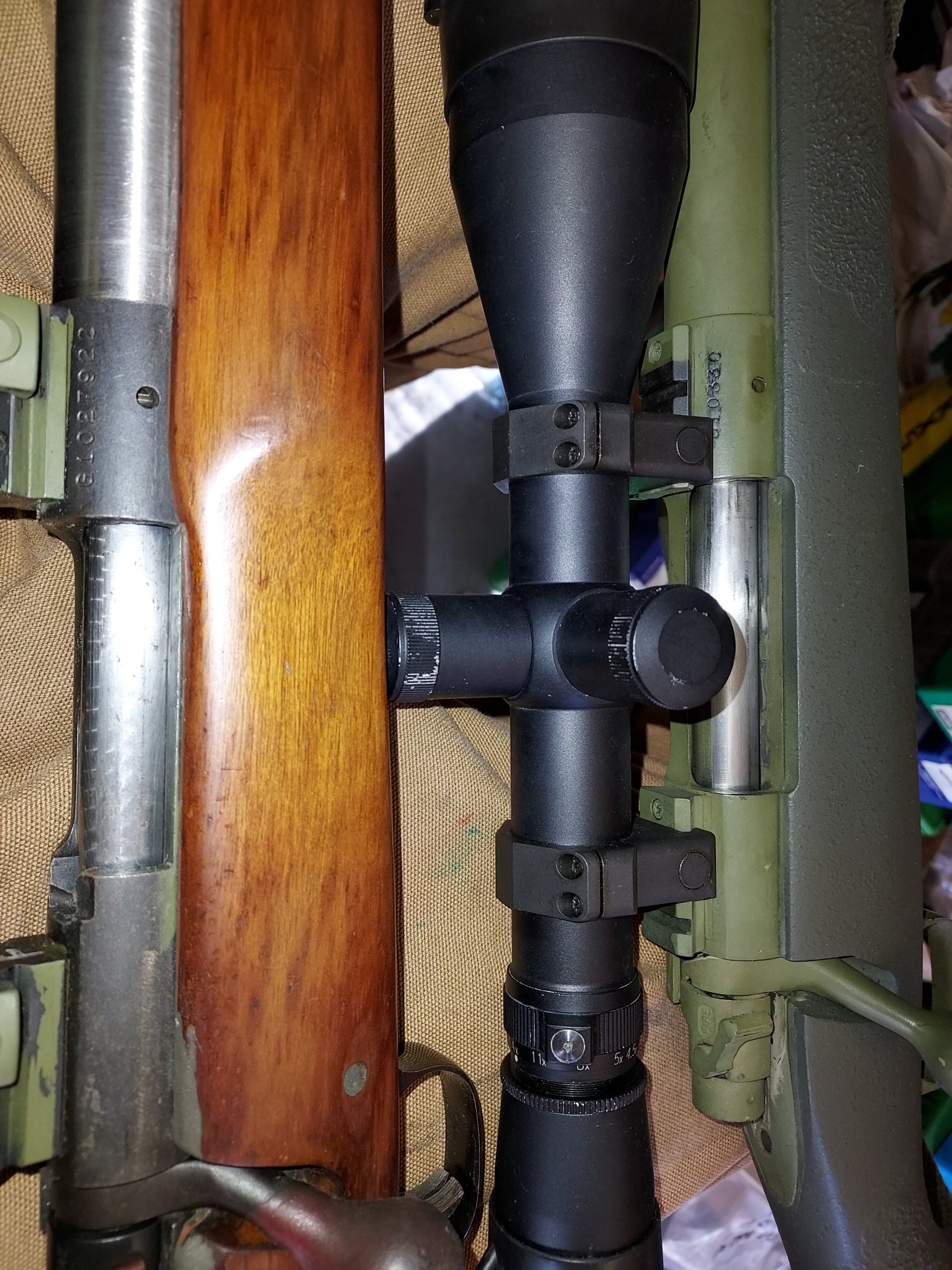

I have a Post-64 clip slot 30-06 (1 rear scope base screw) and a couple different options for the Leupold scope sitting around doing nothing. This thread has got me thinking I should build one of these FBI clones, but where to get a stock? Are you ordering them from McMillan, or managing to find used ones someplace...

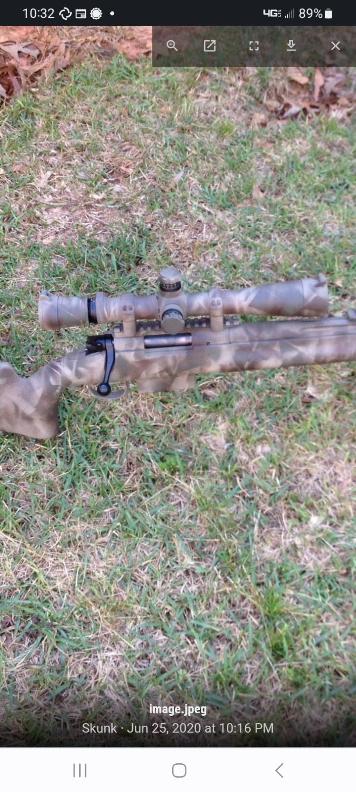

With all due respect, that might not be the correct version for the fbi rifle, the stocks @Skunk pictures on page one are original stocks and have the textured grips and forearms.
The non texture stocks were early m40a1 usmc smear stocks. Maybe one of @Skunk 's pics shows a non textured, I'm still looking at them in these 14 pages.
One of @Skunk 's pics shows a textured stock, Pistol grip & forearm.
One (several) shows a textured pistol grip with smooth forearm and smear pattern.
