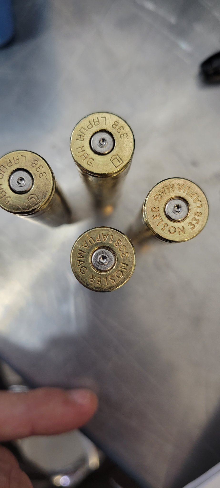

    I have done a load development using the no.200 primers. The load is with lapua brass, H1000 83.6 gr of h1000, Barnes lrx bt 265 gr, avg speed of 2747 fps testing with 10 rounds, slowest speed was 2740 fps and fastest was 2766 fps a variation of 26 fps. Ambient temp of approx 90°f.
    Here is a pic of a few if the primers. What are your thoughts on how they look?
