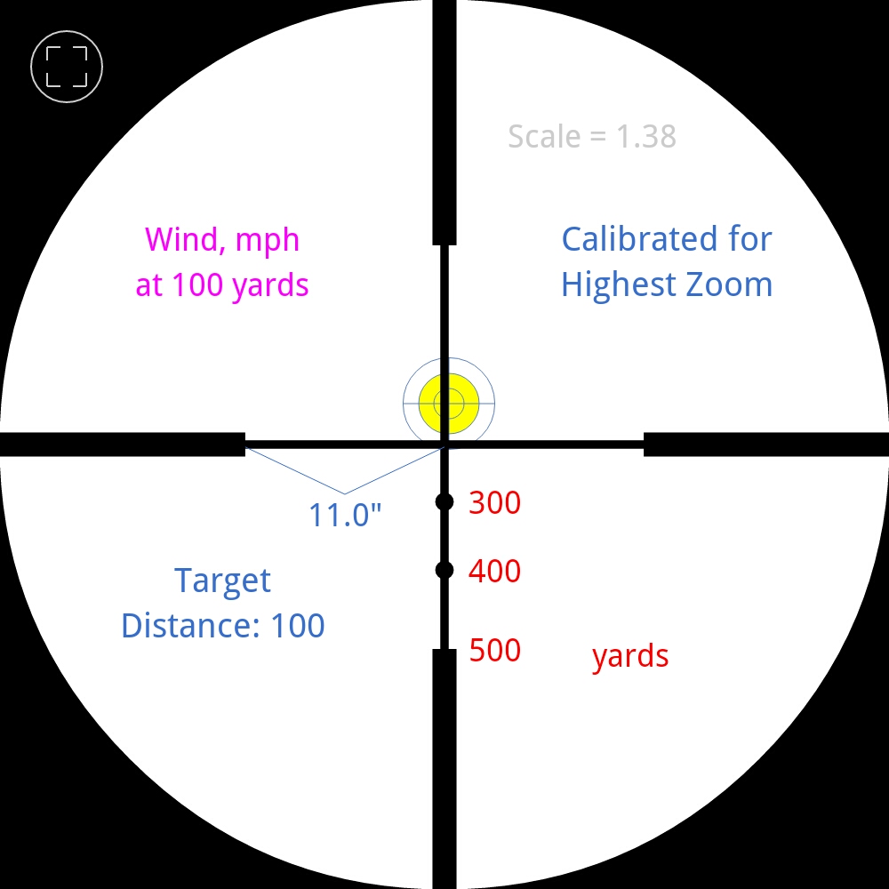

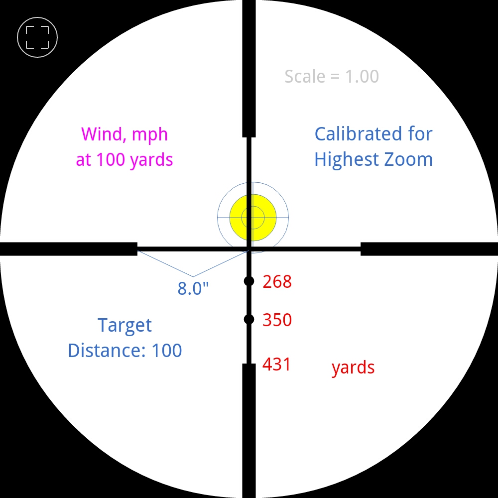

It implies right on the instruction for Leupold scope reticles that the POI will change. Example, variable power scopes with hunting reticles. Magnification is adjusted to match bullet drop. The Leopold LR Duplex and the Rifleman Ballistics reticles are the same reticle. Look up the pdf instructions. It's right there. You get your scope set at 6.5x to match the elevation marks on the scope and find it is accurate. You then change the magnification and now your POI has changed significantly. So yes, it is true but depending on your reticle it can be used to your advantage. It doesn't mean there is something wrong with the design of the scope. Also, if you have Strelok+ you can simulate this with that reticle tool Igor programmed into the app. The attachment with holdovers set at 200, 300, 400, 500 is set at 6.5x. The other one is set at 9x. These are for the same ammo. Notice the change in POI?
Your POI doesn't change the hold off marks changes as the magnification changes as it's not FFP but the POI at the centre duplex should remain the same at all magnifications
The OP was also asking about distances. But I agree and I cannot explain why the 200 yard zero would stay the same and the others change. There has to be some degree of shift to the contrary. Sounds like physics to me. For every action there is a....
It's very easy to explain it's because the reticle images you posted for SFP scope at different magnification ranges. Without getting into depth about the difference between FFP and SFP (it's been done enough) with SFP the reticle does not stay constant in relation to the target like with FFP. If it was a FFP scope those sub-tensions would be correct at all magnifications but with a SFP the reticle does not change so the hold offs change as you change the magnification. He was asking if there was a point of impact shift with SFP scopes and if so was it more prevalent at longer ranges, at least that's how I understood it. Not how do SFP reticle sub-tensions change through the magnification range.
