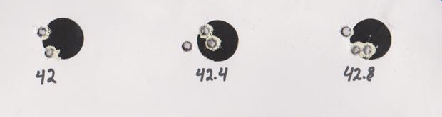

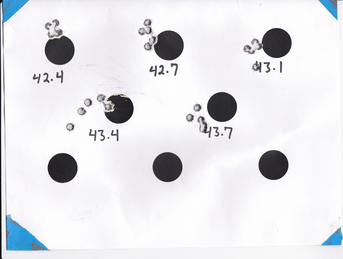

I ran a few rounds yesterday off the rickety benches at the range just to get some chrono readings and do some initial testing. They suck for shooting groups as they move if you do, but my chrono setup isn't able to be used from prone. I need a Magnetospeed
I fired 3 rounds to get a rough zero then had a dud primer on one round of the first test group, which is why it's missing a hole. Yes I'm aware that 5 rounds are minimum for groups, just trying to get something in the ballpark without blowing through a bunch of components that aren't real easy to come by.
130 VLD's jumping .030", pushed by R17, lit off by CCI200's
42.4 and 42.8 hit a flat spot in velocity, both loads averaged 2945fps. 44gr had an average of 3009fps, but the groups were growing the higher I went and one round at 44gr produced a slightly sticky bolt. I think on the next trip I'll work around between 42.4 and 42.8 and see what happens. Both of those came in under .6",so it's already out shooting the old barrel with loads that were just thrown together right quick to get it to the range.
