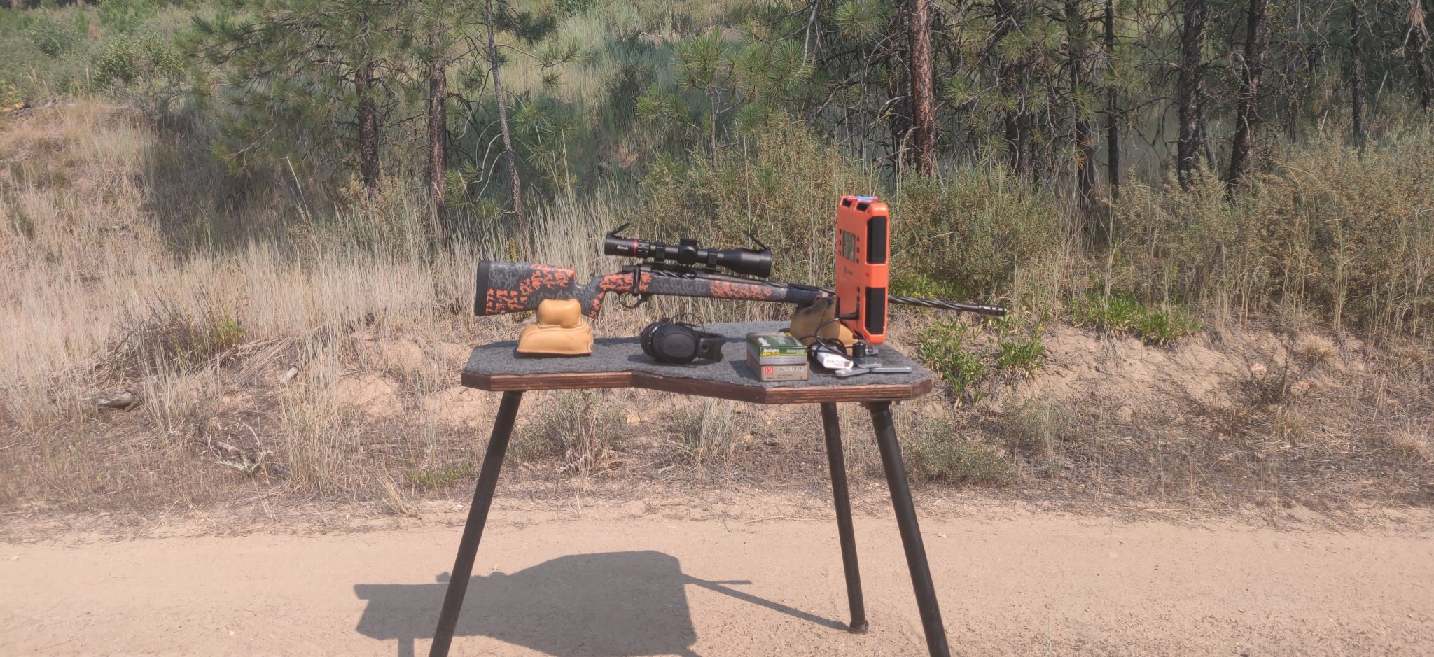

Finally got out to test some hunting loads, in the 7mm RM. It seemed to really like this one:
168gr. Berger VLD Hunting, 69.5 gr. H1000, 30 thousandths off the lands for a COL of 3.414 @105 yards, 2950 FPS. Amazingly, my 3 shot string with 70 gr. of powder had an extreme spread of 1 FPS with an SD of .61, but did not group as well for some reason (probly me). No pressure signs on any string.
