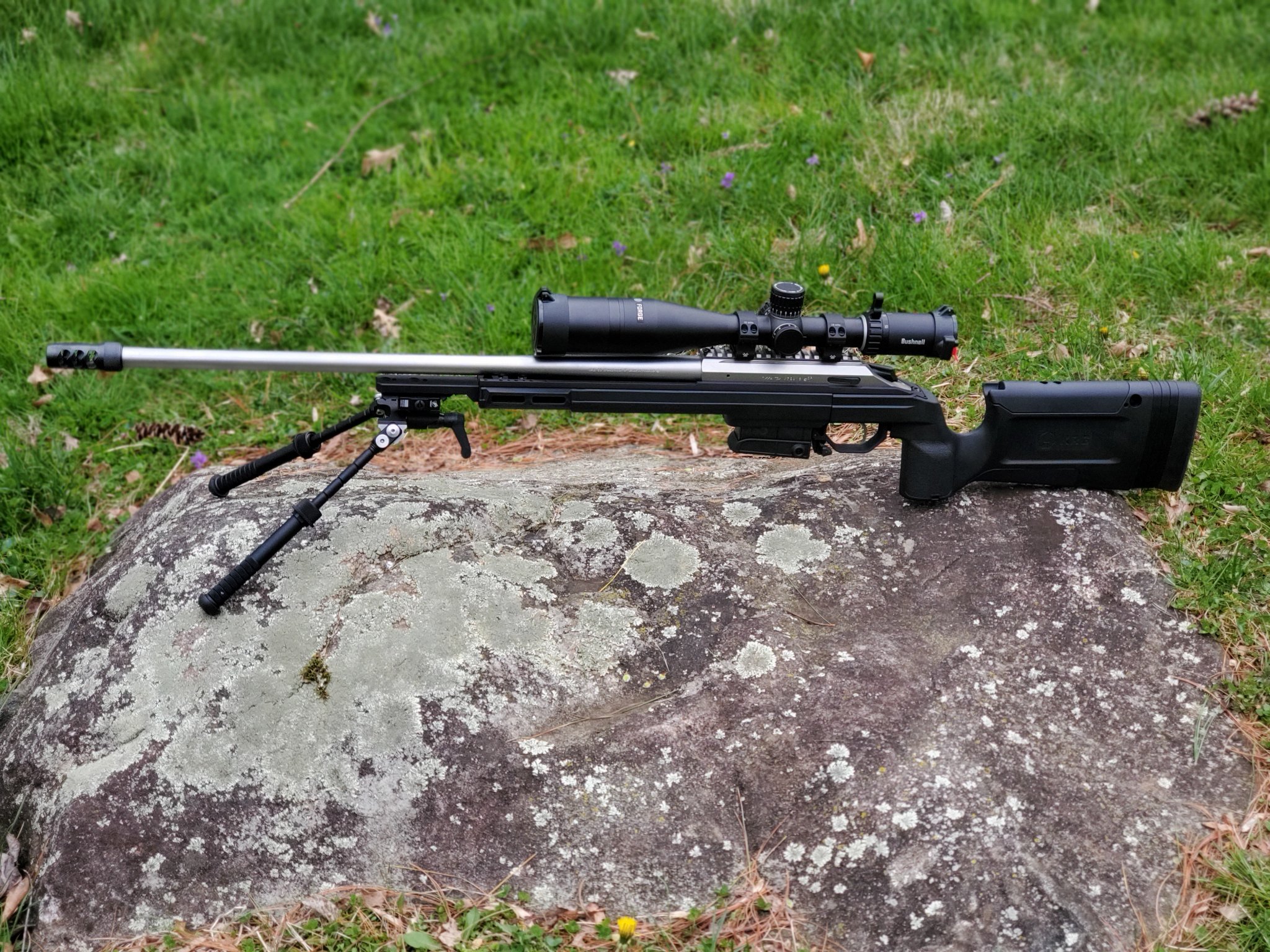

Nice progun. Where did you get such a deal?
I thought with the 6.5 Creedmoor, barrel length was important, with improvement out to 24 inches. Why did you go for the 20" instead of the 24" ?
Thanks, beautiful rifle.
There's the coueswhitetail.com forum classifieds here in AZ. A friend of mine traded a cheap AR and $200 for a CTR in 260R that he found there. Then bought Bravo chassis for $350 later on that he found there.

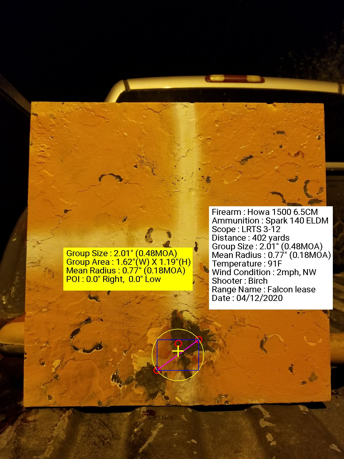

My shooting partner has a Tikka TAC A1 and he's blown away by the accuracy of my 1500 in a KRG 180 XRay chassis.
Lmfao, people say the Tikka is a more refined rifle. While it may seem that way, the howa is just as accurate and offers a great shooting platform for its price point, you get a lot from it and keeps up with customs.
That's a 3 shot group I did yesterday just to see if my accuracy was still there. I had a carbon ring but cleaned it out. Normally I do 5 shot groups but I just needed to confirm it was shooting good. That's half MOA at 400 yards...

Bergara HMR PRO, all you need to add is a Little Bastard muzzle break. I have been competing with mine for two years and like it LOTS. Accurate with factory Hornady Match ammo (.4inch @100yd) great trigger and stock I am good with. By the time the barrel shoots out you can put a better barrel on and whatever chassis you decide you want. For PRS/Fclass you want 6.5C, 6.5X47 or same two in 6mm, YOU DO NOT NEED a 6.5PRC !!!! BTW F Class is a couple nutso levels up in money and top quality barrel, optics and equipment. PRS you gust have to minute of steel gongs, F-Class you need to punch the X/10 ring every time at 1000 yards. Two different games PRS vs F Class.

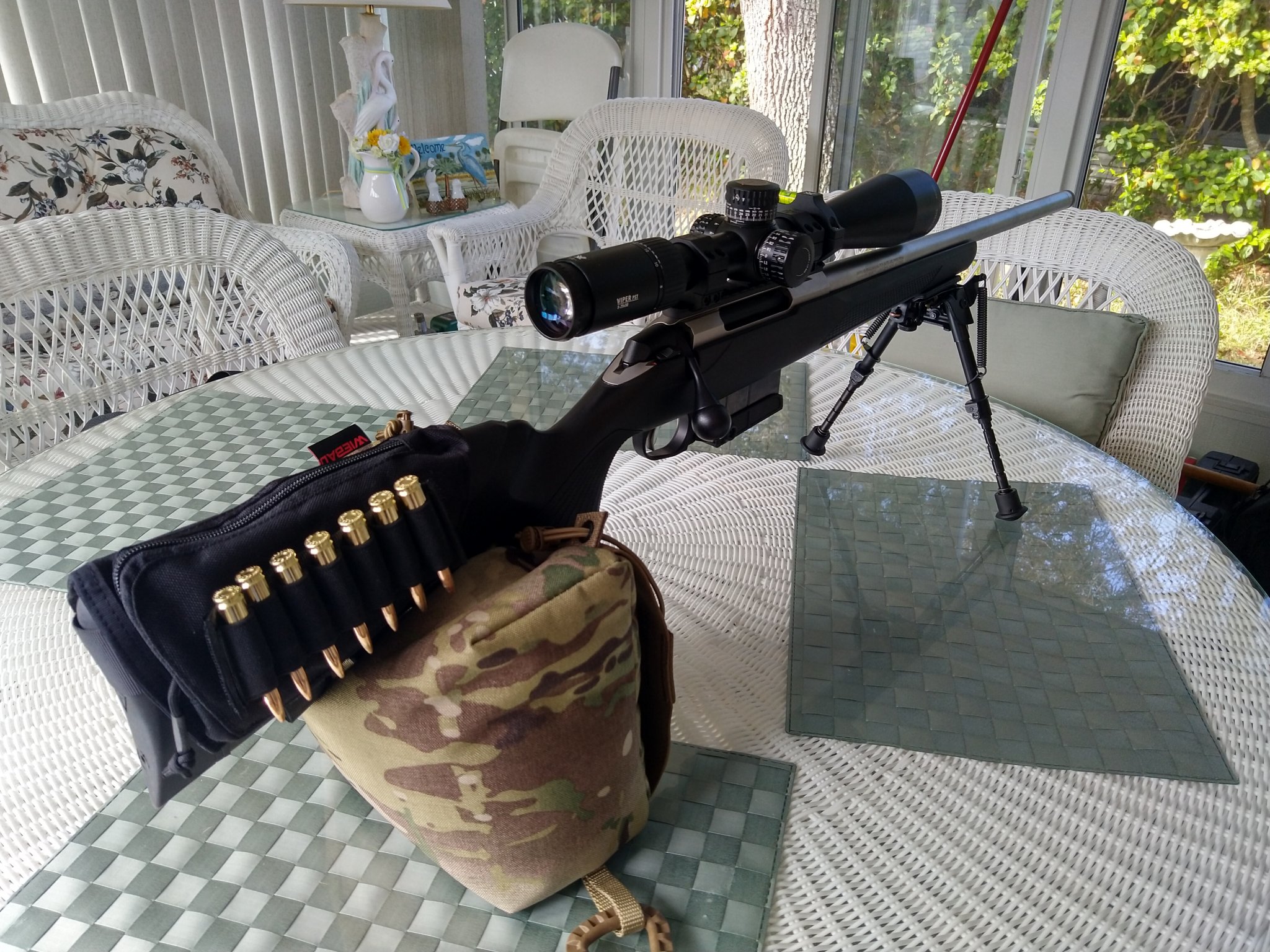

Personally, I would get a Thompson center compass. Sub moa out of the box for less than $400. You could out $1000. Into improvements, scope or whatever. Not going to win a super long range trophy but is quite adequate for the shooting I would be doing.

LRP isn't just a bench gun, I used it for PRS type matches, my custom built on an impact action is heavier and I shoot it offhand as well.
I've played with the Havoc a couple times cause I was interested in buying one. Both were brand new. They had an annoyingly sticky action. You have to really concentrate on running it smoothly. Maybe they will break in, and maybe they just need cleaned and lubed. But after seeing similar reviews from others who had purchased them, I had to pass.
