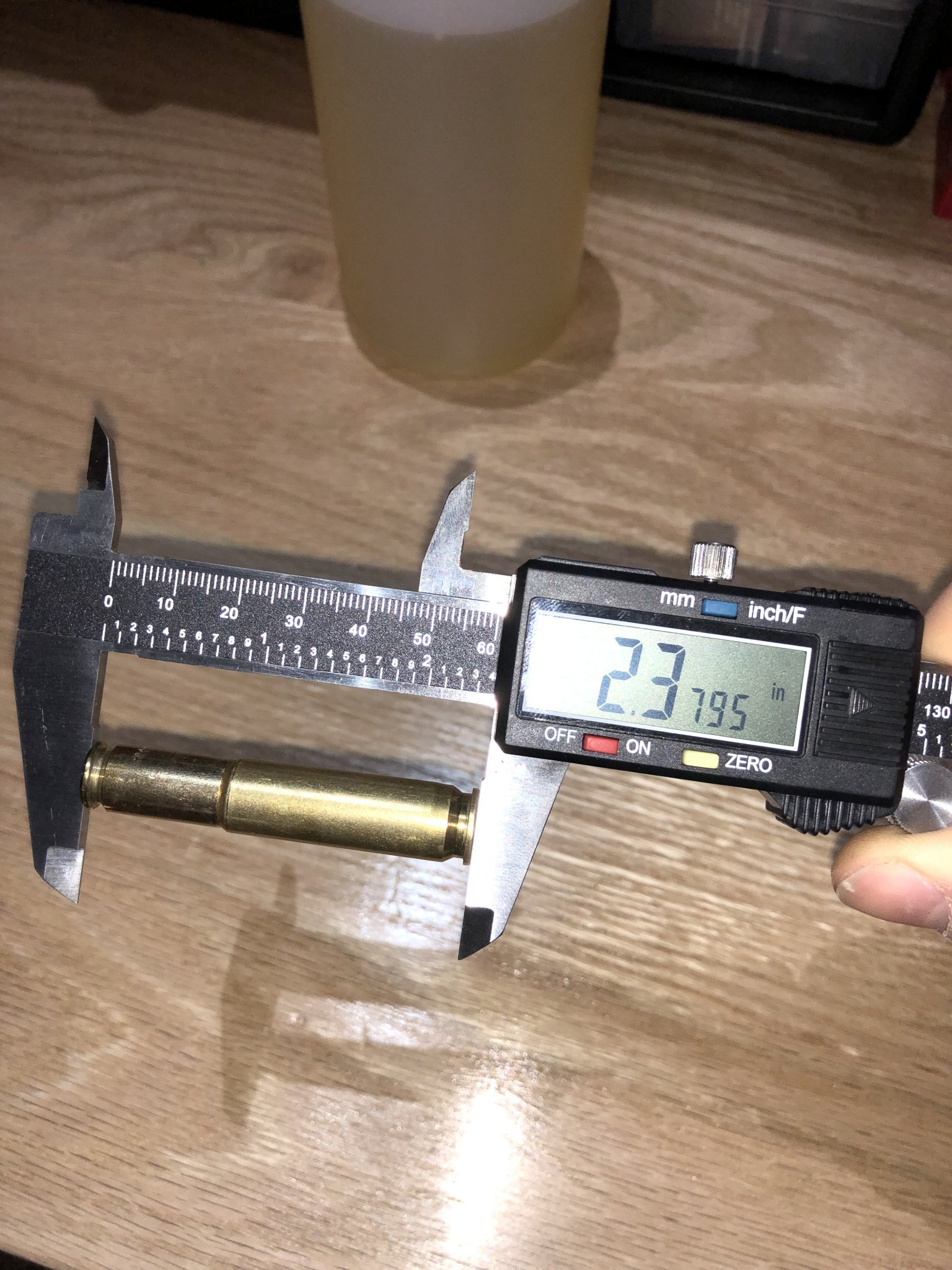

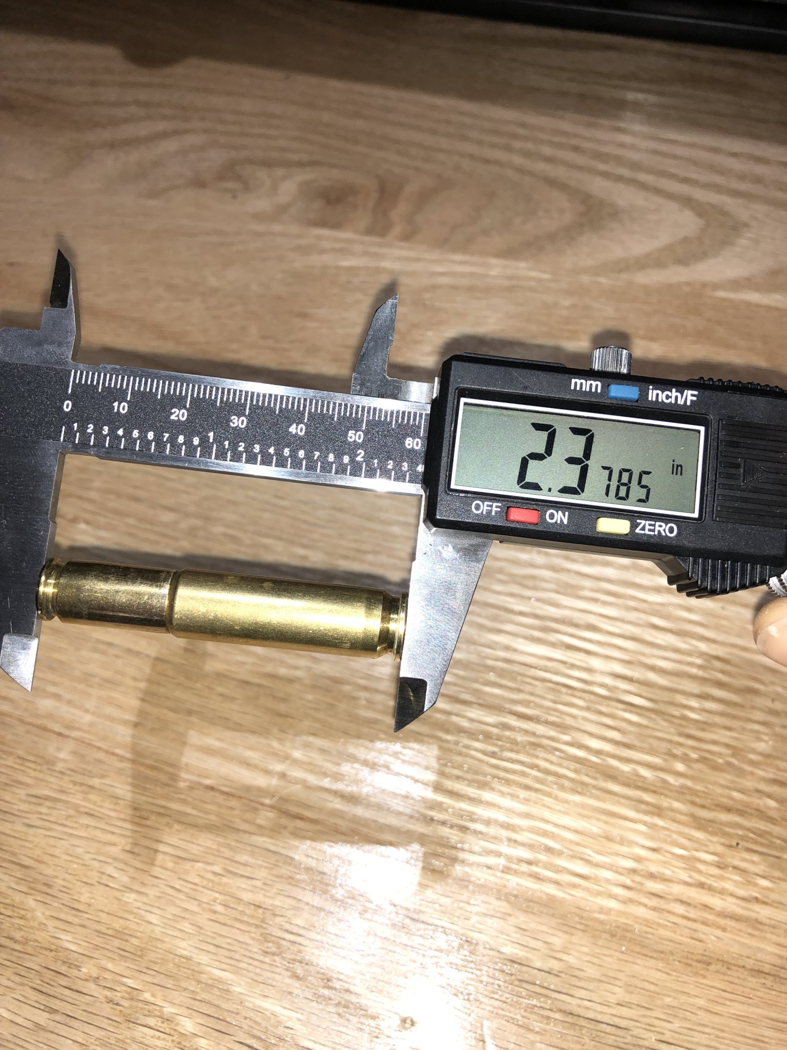

Update*
Took a spent .40 case and measured the shoulder bump with a 1x fired piece of brass.
Before resizing it measured 2.3785 with the .40 case
After resizing its was at 2.3795
Milo was generous enough to ordered a bumb gauge kit for me. When it gets to me I'll be able to take some better measurements. Note I was getting some inconsistent numbers, but those are the 2 that seemed to come up the most.

Update*
After resizing its was at 2.795
You forgot one number, lol
And SOB, I'll ship my crap to you and you can bump my brass.
Lol, his brass is growing in the die, he never said if it chambers yet
All brass grows in length in the die and as you keep screwing the die down the shoulder moves backwards and the neck gets longer.
I thought we already determined his reloads fit the gun?
Atleast we know now it was a errant decimal place.

Got the OAL gauge in from Milo. With the 147s my oal to the lands is 2.013. My previous oal measured from the tip is 2.855. If I use the comparator to measure the 2.855 from the tip it comes out to 2.166 to the ogive. This means my previous loads were a whole tenth into the lands right? With the sharpie test I didn't see any rifling marks, however this tells otherwise.
I'm going to try a load with some 140 elds that Milo gave me as well
That sounds really short. Did you clean your gun really well before measuring? How many rounds down the barrel? Those numbers would put into the lands at 2.7 OAL which is really short, below sami even. It makes me wonder about a carbon ring.
2.855" base to tip OAL does not sound out of line, measure tip to base of your 2.013 number, that number is even short for 6mm creed. I'm with SCD that you may have a carbon ring. I have kids wrestling all day so I wont be around, be careful here.

As mentioned, try cleaning the bore real good before using this tool. Where are you located OP? Depending on location, maybe one of us is close enough to help you get started. I'm happy to help out if you aren't too far away.
I’ve probably shot 120 rounds so far through it. All but a handful of them have been suppressed. Could the extra gunk in the barrel from the suppressor cause a carbon ring with so few rounds?
