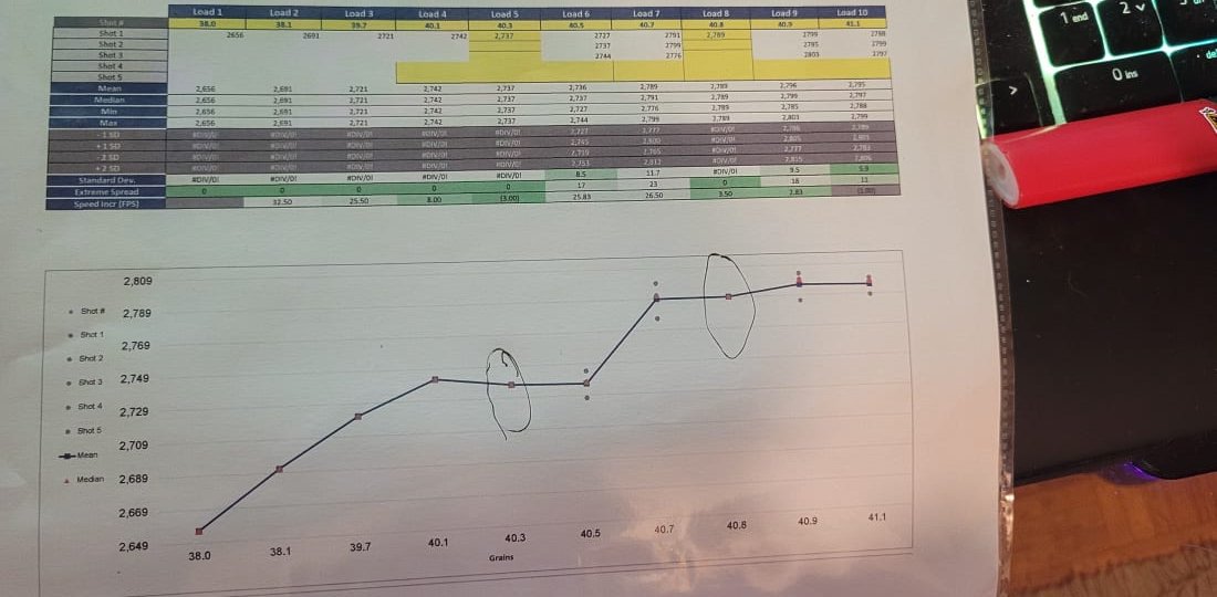

I've only shot 2 through my chrono. One was 2,600 and the other was 2,593
I haven't measured the chamber and I don't have the tool. I did do the trick with the sharpie and it came out with no marks from the lands.
I did notice how some of the primers look like they never reached pressure. I'm not quite sure what could be causing such inconsistencies. All charges were weighed on an RCBS chargemaster Lite so I'd think they'd all be close enough in charge weight to cause the discrepancy. I took a couple cases that had the biggest pressure signs and put new primers in. They seated just like any normal case.
I haven't sorted out any nodes yet.
I wanted to try some reloader 26 because it seems like guys are getting good velocities with the 147s, but I couldn't find it in stock anywhere locally. What do you think about trying a slower burning powder? 2,600 fps doesn't seem all that good to me. I'm shooting with a 22'' barrel.
yea i use a charge master and found them to be off a bit. on the low side. i measure with that and a mecanical scale and found it to be off by .02 grains
i'am only running the numbers on the load i have done now with a 140bthp. mind you i use a custom made barrel and not factory now.

the book also says that h4350 powder is max load at 40.3 grains. for a 147grain round. max speed 2600.
is that a factory barrel? if so lower the load somewhere in the middle and work up from there. 147 are great but they dont go fast and your primers show pressure on some of them.
