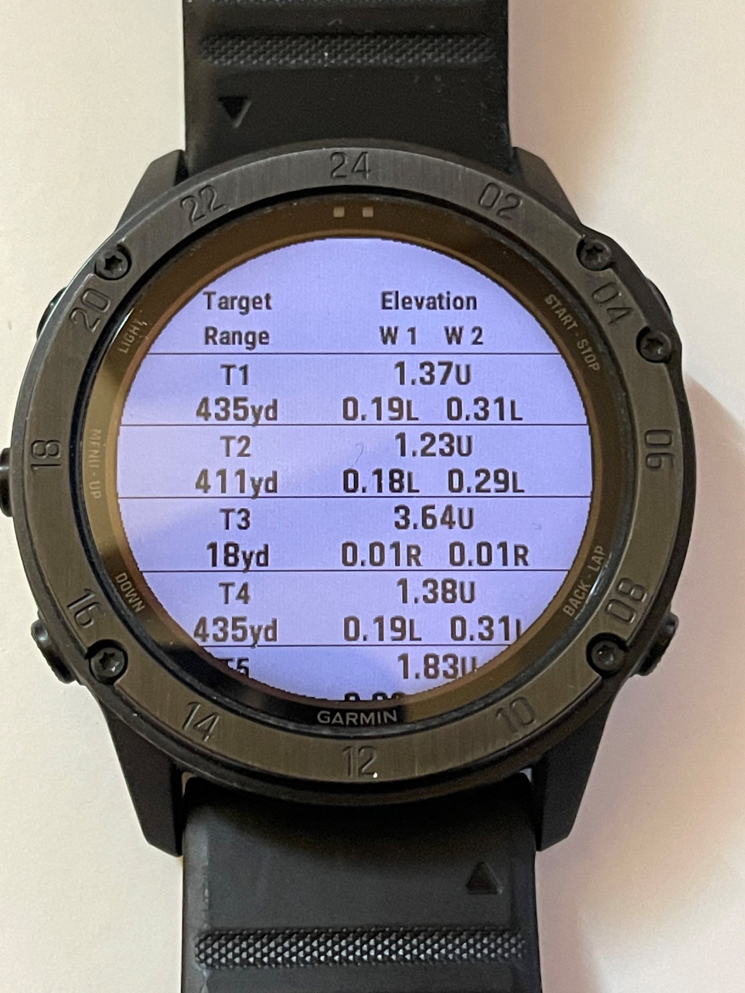

I'd like to make sure you're all aware that you can load Beta software from Garmin for your Tactix Delta with AB from the following link: Garmin Forums - Fenix 6 Family. You want to use the version for the Fenix 6X Pro. This is the correct one for the Tactix as well.
We've made some changes to the Target screen and Target Card screen. Target now has a box around the selected/live target so you know which one is on the main screen. The Target Card has been reworked to allow the display of 4 targets at a time on the screen. This allows you to use the Target Card without all the scrolling previously required.
These will both be in the next Production Release as well but you can try them now if you'd like.
got any screen shots of the target card setukp?
The changes can be reverted if I need to? I dont want to run this beta update and have things not lining up before I shoot the Grand Slam this weekend but having 4 targets on one screen would sure save me a lot of scrolling.
Here is a screenshot of the Target Card:
There are instructions on the download page, where it explains how to install, that also explain how to roll back to the previous release.
