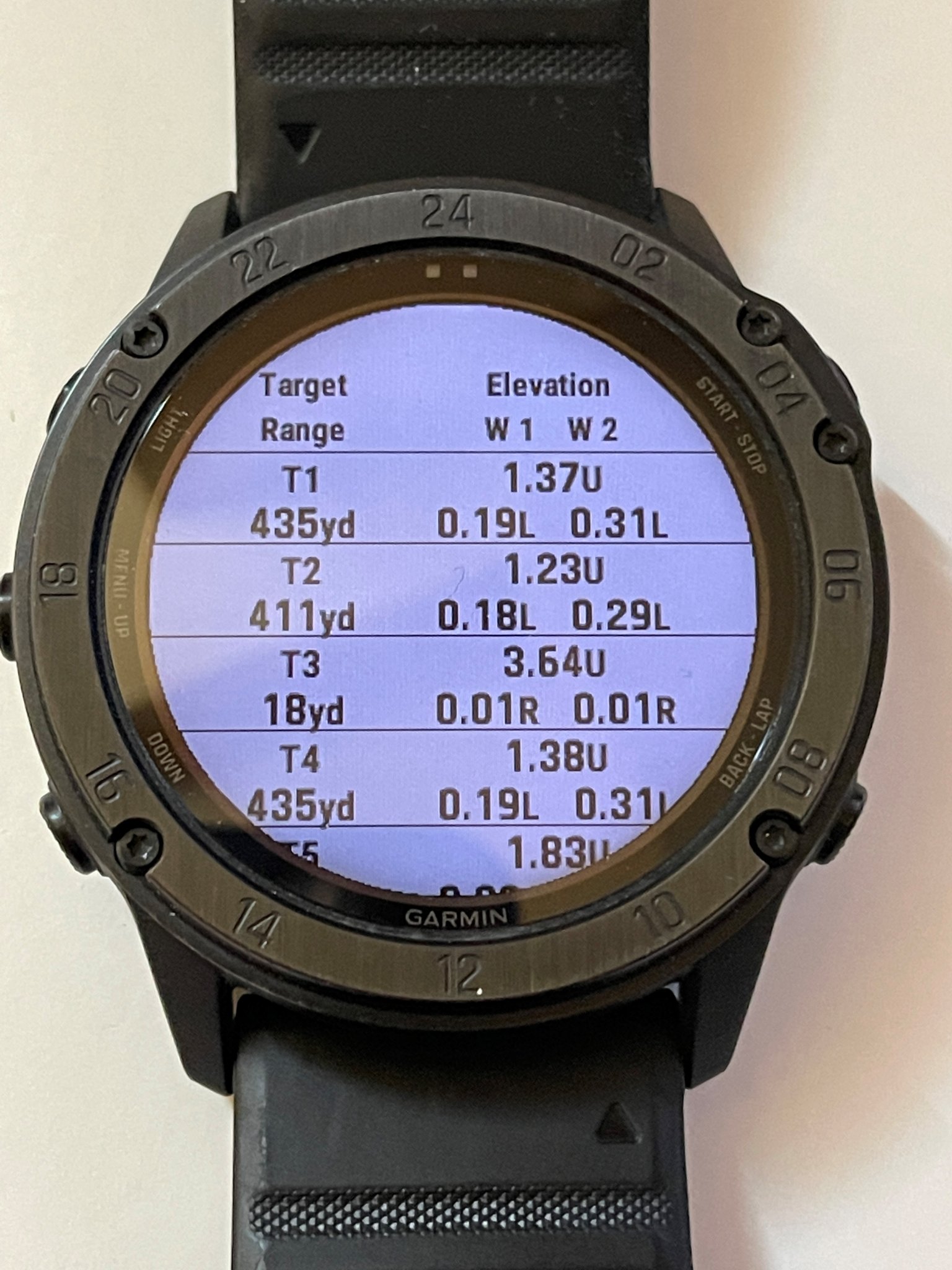

Here is a screenshot of the Target Card:
There are instructions on the download page, where it explains how to install, that also explain how to roll back to the previous release.
Thanks for the screen shot. Unfortunately, the update does not let you update the targets in the Target card with the range finder any more.
I need to be able to scroll through and update all the targets then go back to view and what I find is that on Target card with the update only updates Target one no matter what Target is selected on the Target card.
If you go to Target, instead of Target Card you can scroll through and update each target. The Target Card is a read-only view of all the targets.
I'll have to mess with it after the match. I don't want to learn a new system and have to scroll through things on the clock.

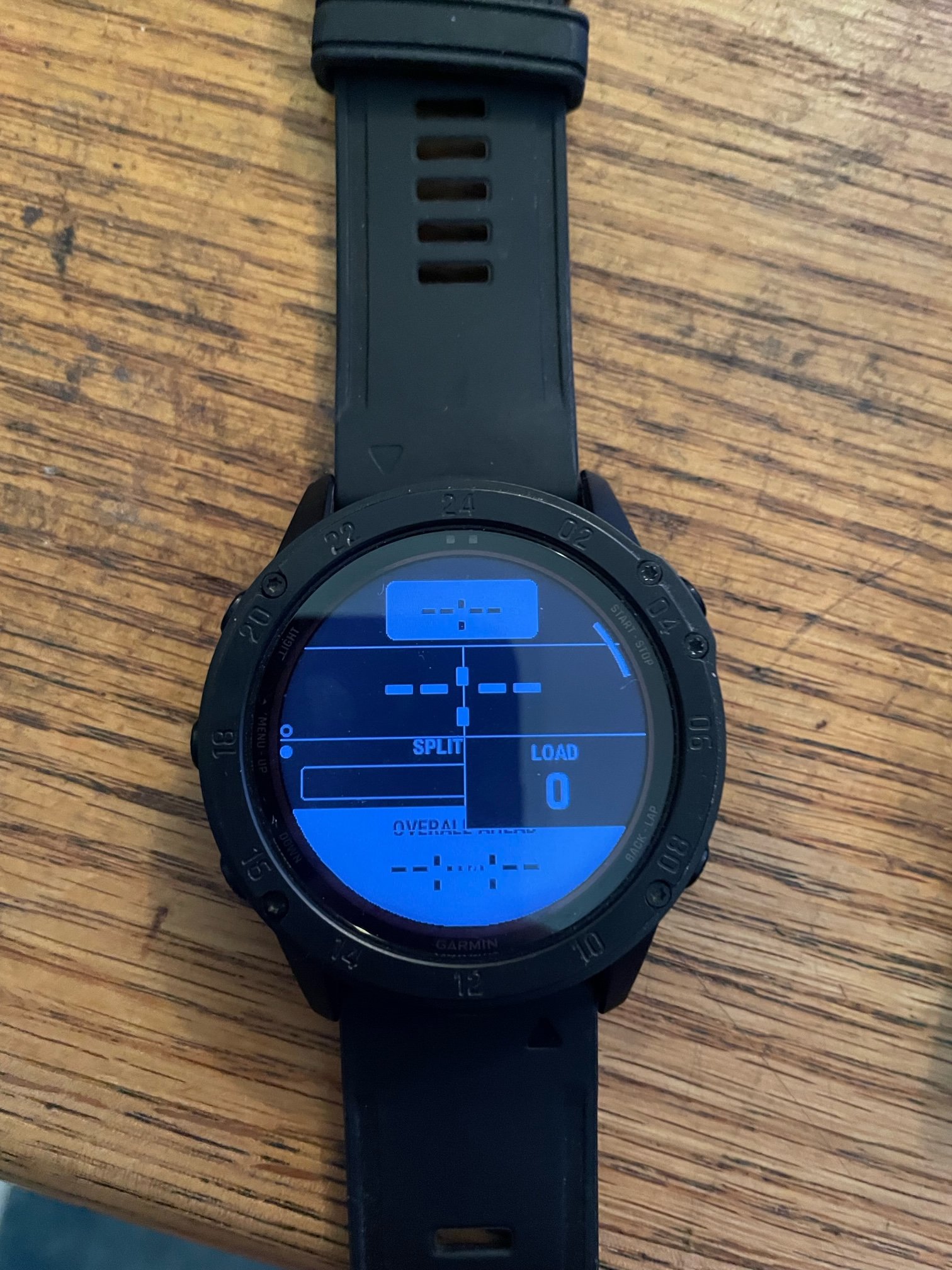

Did this make it into the standard release? I'd updated to this when you posted the above. I discovered yesterday, when I'm in AB, if I press the bottom left button I get the below screen. If I press the button again the watch restarts.
I thought maybe this is due to the beta software and I was going to go back to the previous but now I see it was to be in the next production release. I'm going to update to the version released a week or so ago and see what happens.
It looks like I have. Garmin Express shows me running 20.30 which is the same version shown here as public beta.
Try a hard reset of the watch. If that doesn't work let me know and we'll look at next steps.
Done. It actually ask set to default rather than clear user data. However, the problem persists after doing this.
Edit
Followed these steps to reset and now am starting from scratch although it did fix the issue.
