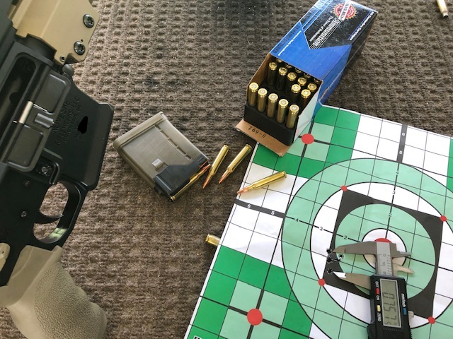

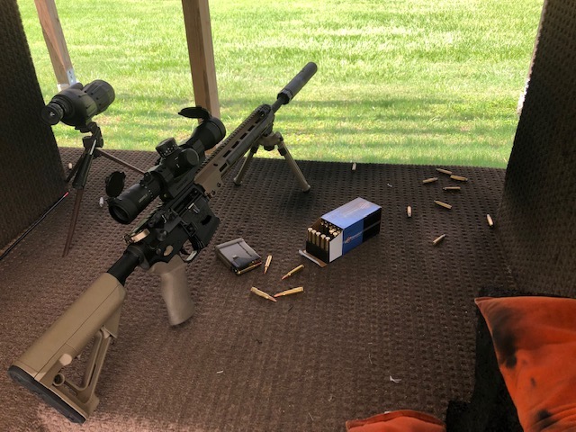

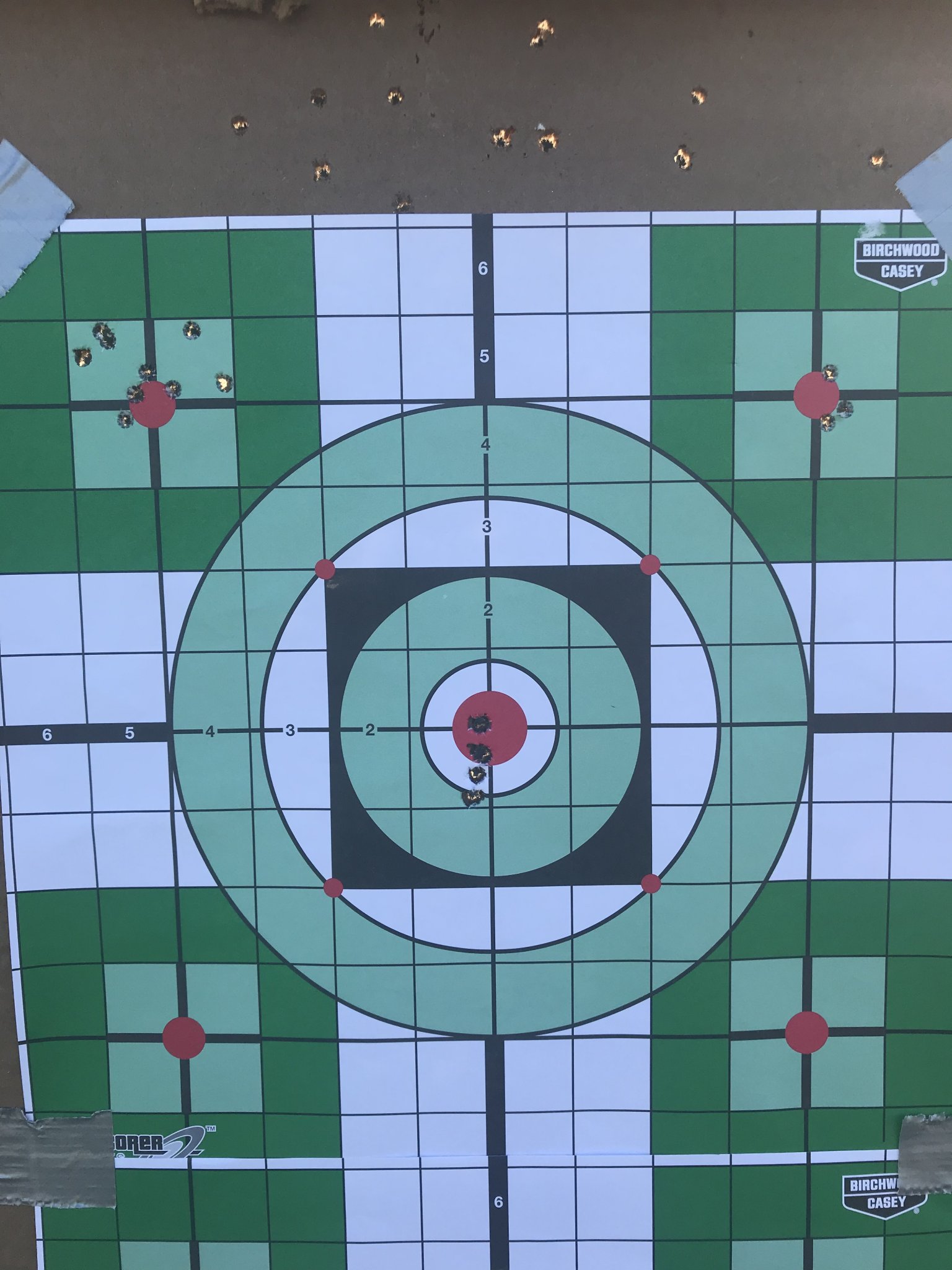

    Sub-MOA in an AR isn’t easy but it doesn’t require fairy dust either. This is from a 20” Ballistic Advantage Premium fluted that ran me under $250 shipped on sale. It’s target grade but not alpha by any means. Second trip to the range, about 80 rounds though it before I started sighting in the scope on the upper right. Five more rounds in the middle right at MOA, then a nice sub MOA group in the upper right. I’ll take a penny at 100yds out of a $250 barrel any day. Obviously a great trigger helps.
    Reactions: Bakwa

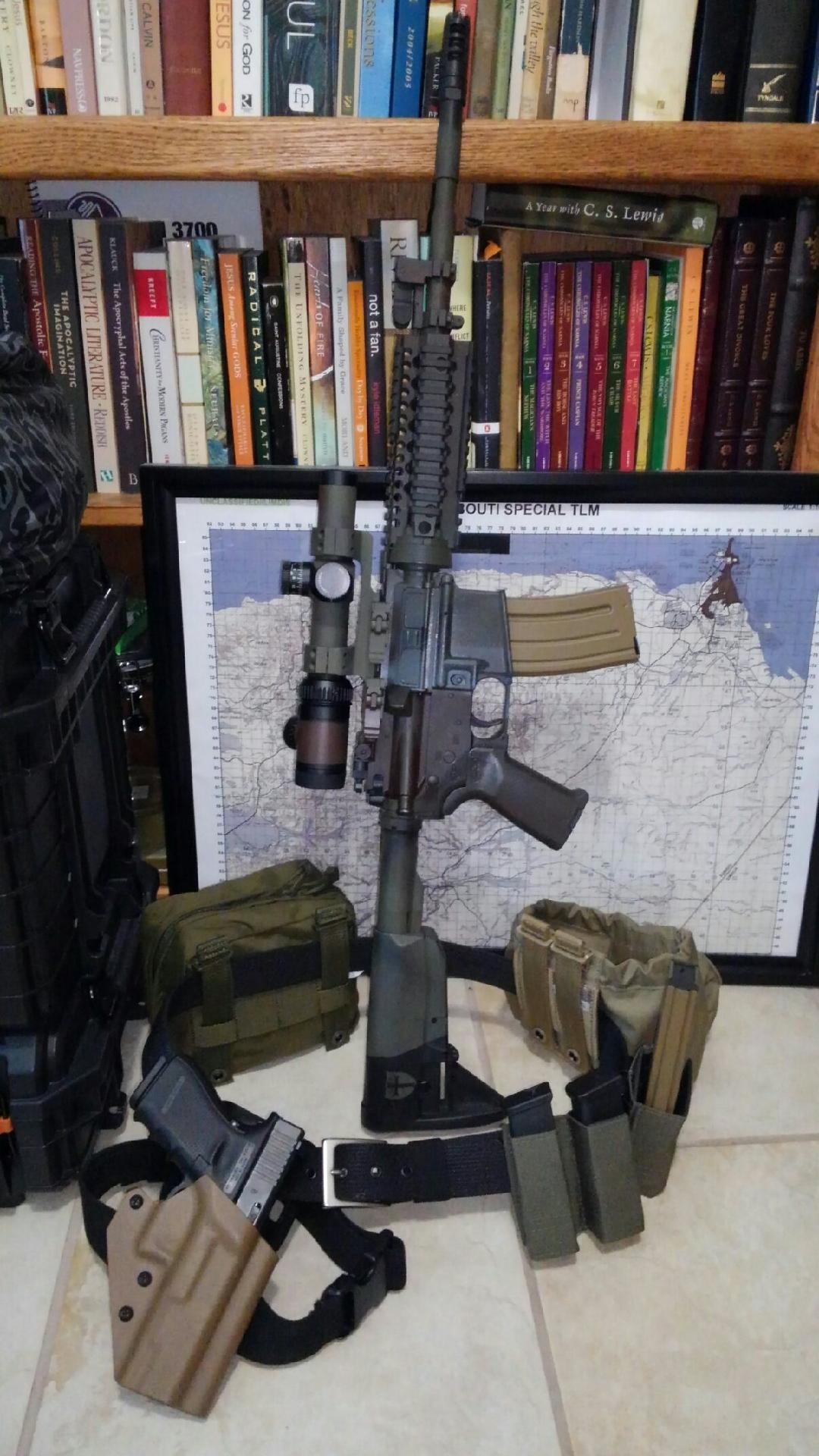

    Have you looked at "recce" rifles? Also called "sniper M4". Supposedly navy had these made because the Mk12 wasn't cutting it for 'em for a few reasons. It's 16", uses a Lilja bbl., 1/8, Wylde chamber, and the rest of the rifle is pretty much up to the user, about the only thing they have in common is the Lilja barrel.
    Here's mine with a Saker. It's a subMOA rifle but I haven't had much time to really do much with it, so I suspect it'll do even better when I get serious with it. Pretty much any stock, rail or scope goes on these and they've been pictured with 'em all (though this one does have a Mk12 optic). Just an option/idea. And it may cost less to make a high end one of these, depending.
    Yes. I love the Recce concept. I have a recce setup that's running a 14.5" Colt SOCOM barrel. It produces .9"-1.25" groups with 77gr IMI and 1.25"-1.75" with 55gr Fiocchi all day. Not the most accurate, but it's fairly handy, and has definite utility as a grab-and-go general purpose rifle.. I ran it in a run and gun event two months ago and it worked out pretty well.

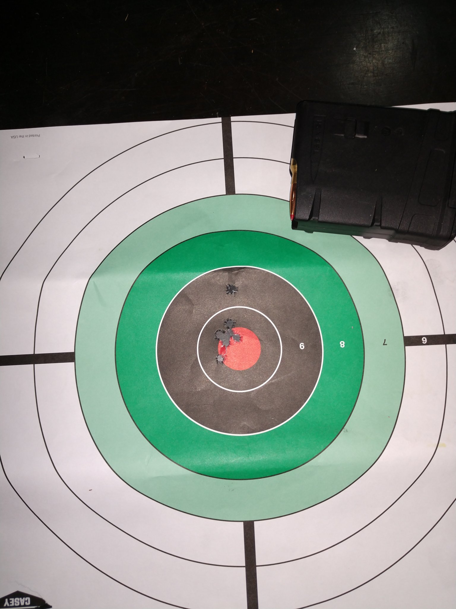

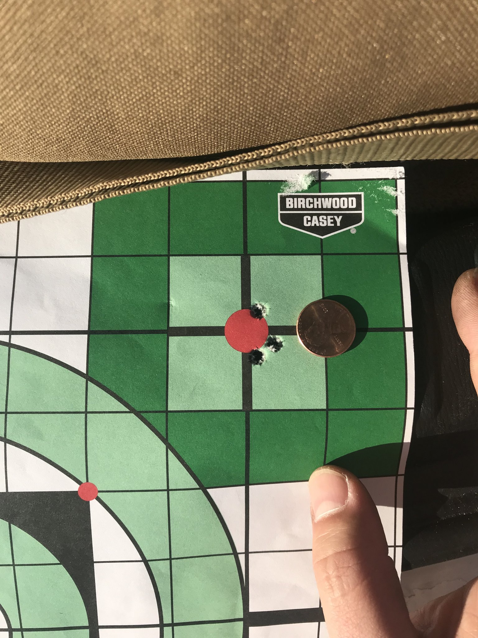

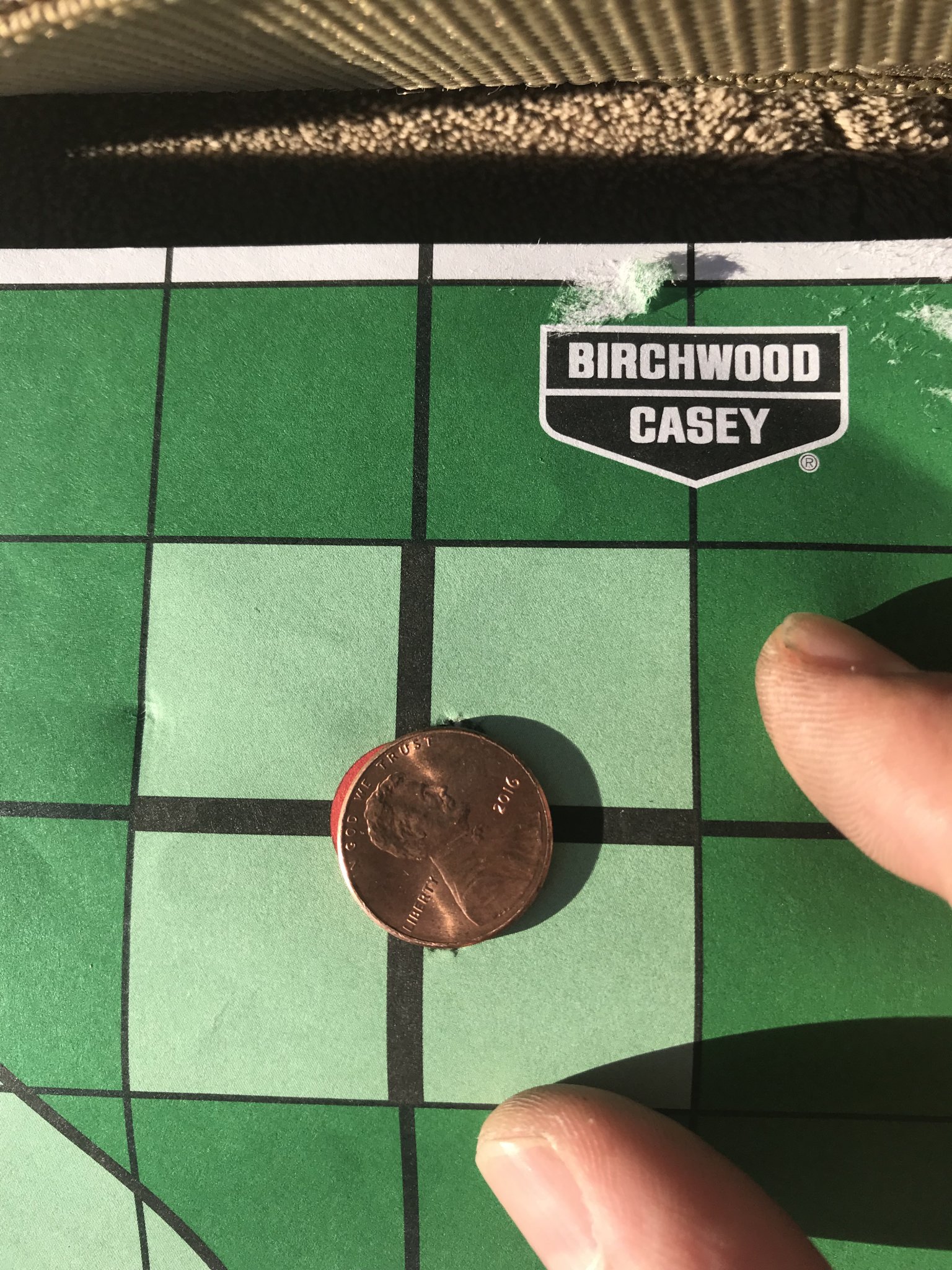

    Number 5 was the POA. The two holes around it were single shots. I was BS’ing around.
    You can also see the other small groups around in different clusters as I was adjusting zero.
    Edited to add: Rainier Ultramatch 16” Shilen blank w/ Ratchet rifling and Magtech 77gr OTM. Colt BCG
    You can also see the other small groups around in different clusters.

    I’ll try for consecutive groups when I get a chance. The private range I go to is literally under water right now.
    But the capability is there and the only thing special is the barrel.

    Let's see some groups! Your build has me intrigued.
    I'm going back and forth on if the Vltor upper will really make that big of a difference over whatever "milspec upper" CLE would use otherwise.
    As soon as the rain lets up down here and I can get to the range, I'll do so. I'll post some pics when time permits.
    I've built plenty of AR's before. They are easy. But I wanted a professional to put this upper/barrel together. My experience suggests that a straight upper that has a high quality barrel tightly mounted will give you your best chance for optimal accuracy/precision. I likely could have done it myself. But since I was spending the money on a top tier barrel, I decided to let CLE do it. And the price for truing the receiver and mounting the barrel was beyond reasonable.
    As an aside, the Vltor upper did not fit the barrel extension to the 'Smith's satisfaction. So, they had to change the extension and do a bit more fitting. So, in the end, I'm glad I let them do it. But results will speak for themselves.
    Reactions: stilesg57
    And anyone who talks shits about my two flyers can suck a dick!...lol
    You can't see for shit with 8 power at 100yrds, the center reticle is bigger than the bullseye. I walked down range, not thinking it was going to be anything special, saw my Target and said to myself.. "That'll do pig, that'll do".
    Reactions: Bakwa and 021411
    Reactions: bigjake83
    Made a quick trip to the range this morning. By the time I zeroed the rifle, got the gas adjusted, and performed my "barrel break in," I ran out of time for serious precision testing. Because I couldn't really help myself, I went ahead and quickly shot 4 5-shot groups at 100 yards with factory ammo: 69 and 77gr FGMM and 75gr BHs. The gun shot all groups between .6-.8 MOA. And I was shooting faster than I normally would. A representative group is attached. They were all about the same.
    This thing might end up being a shooter. We shall see.
