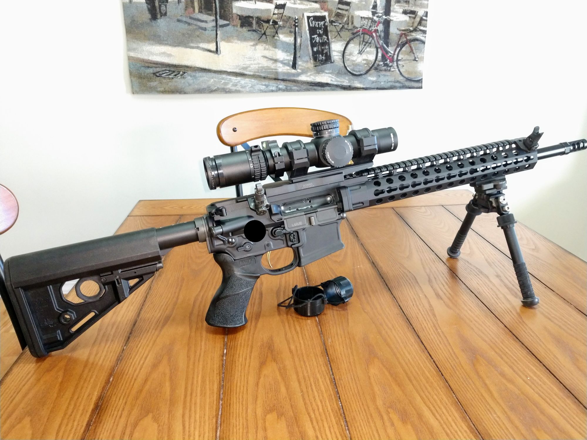

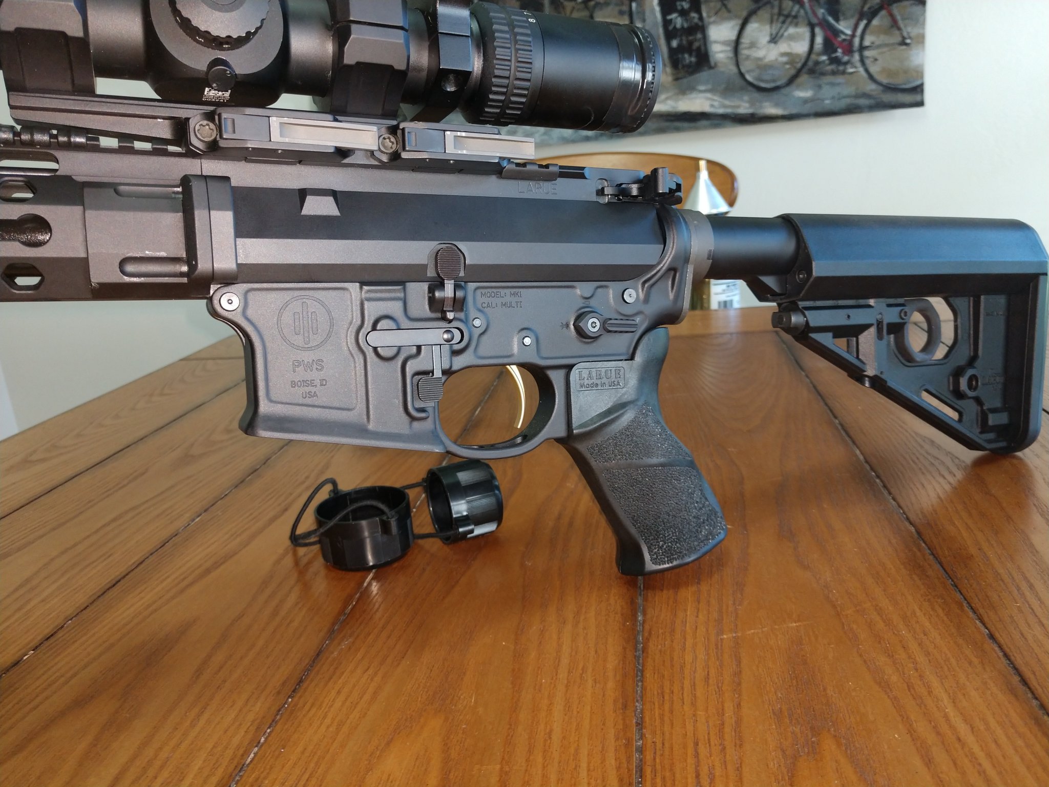

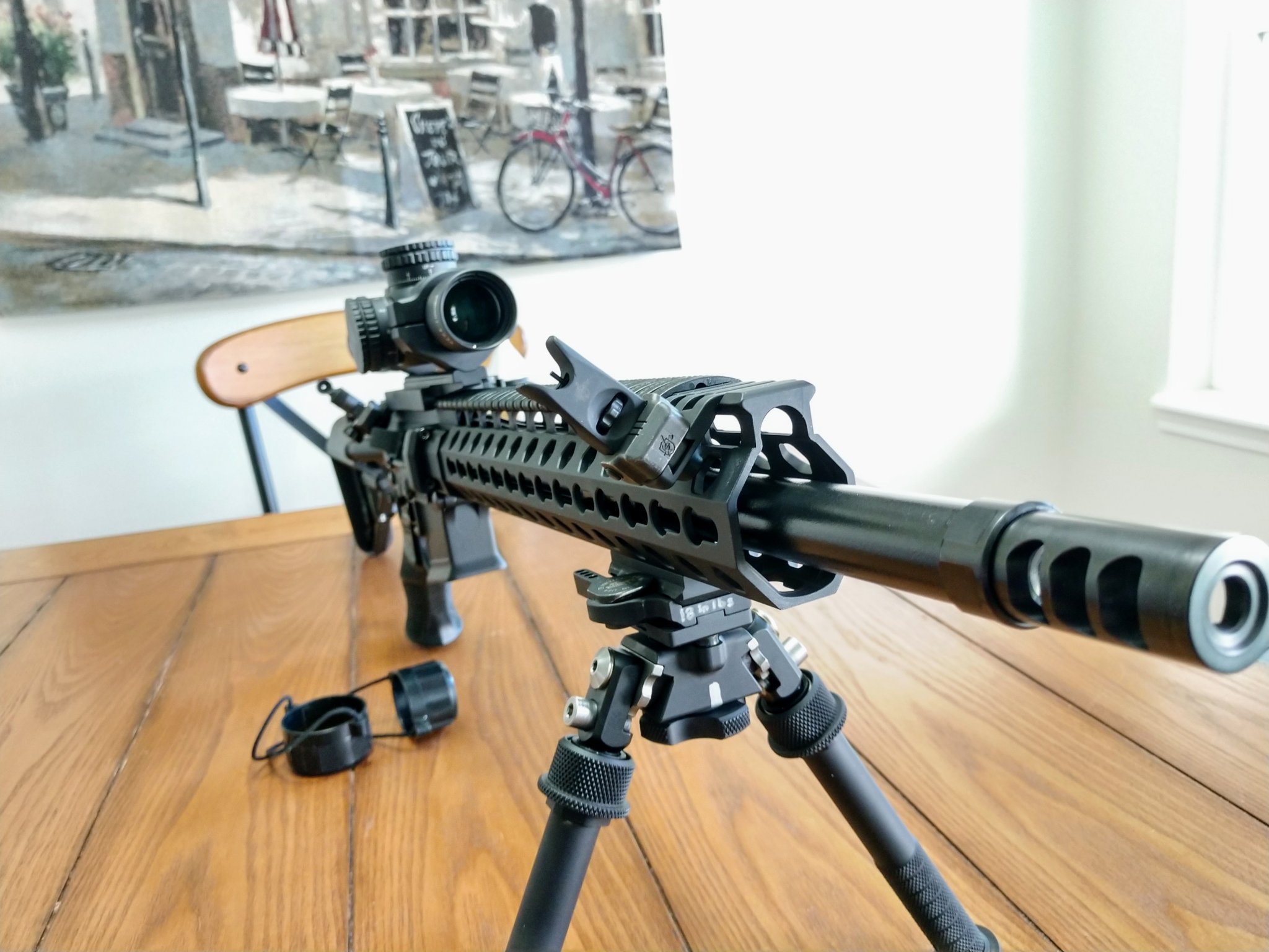

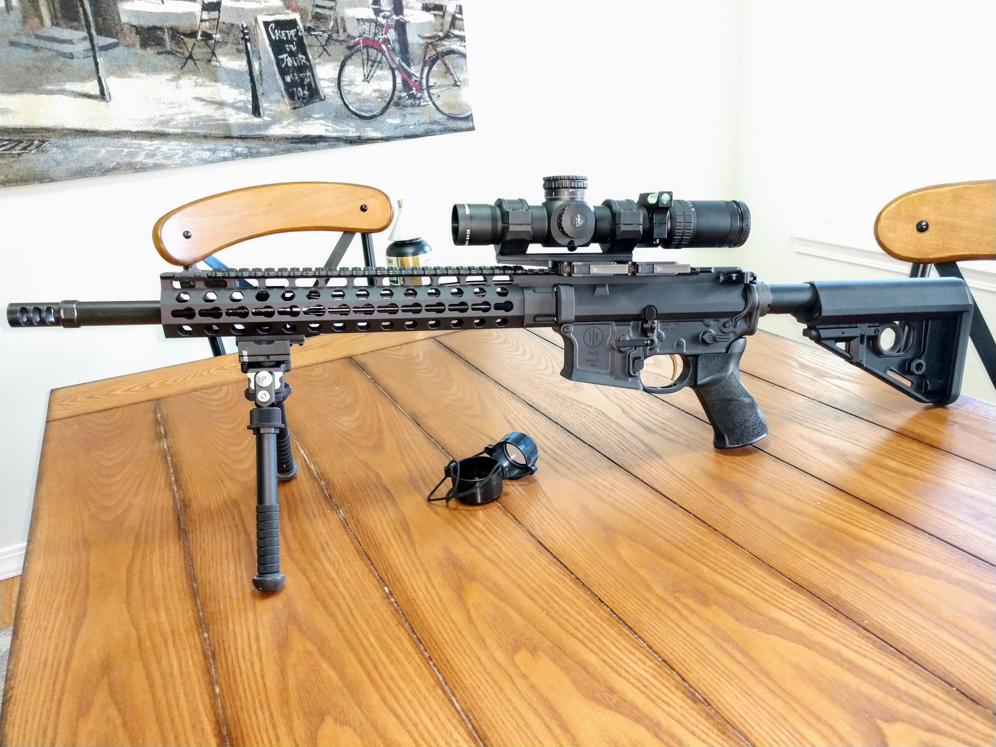

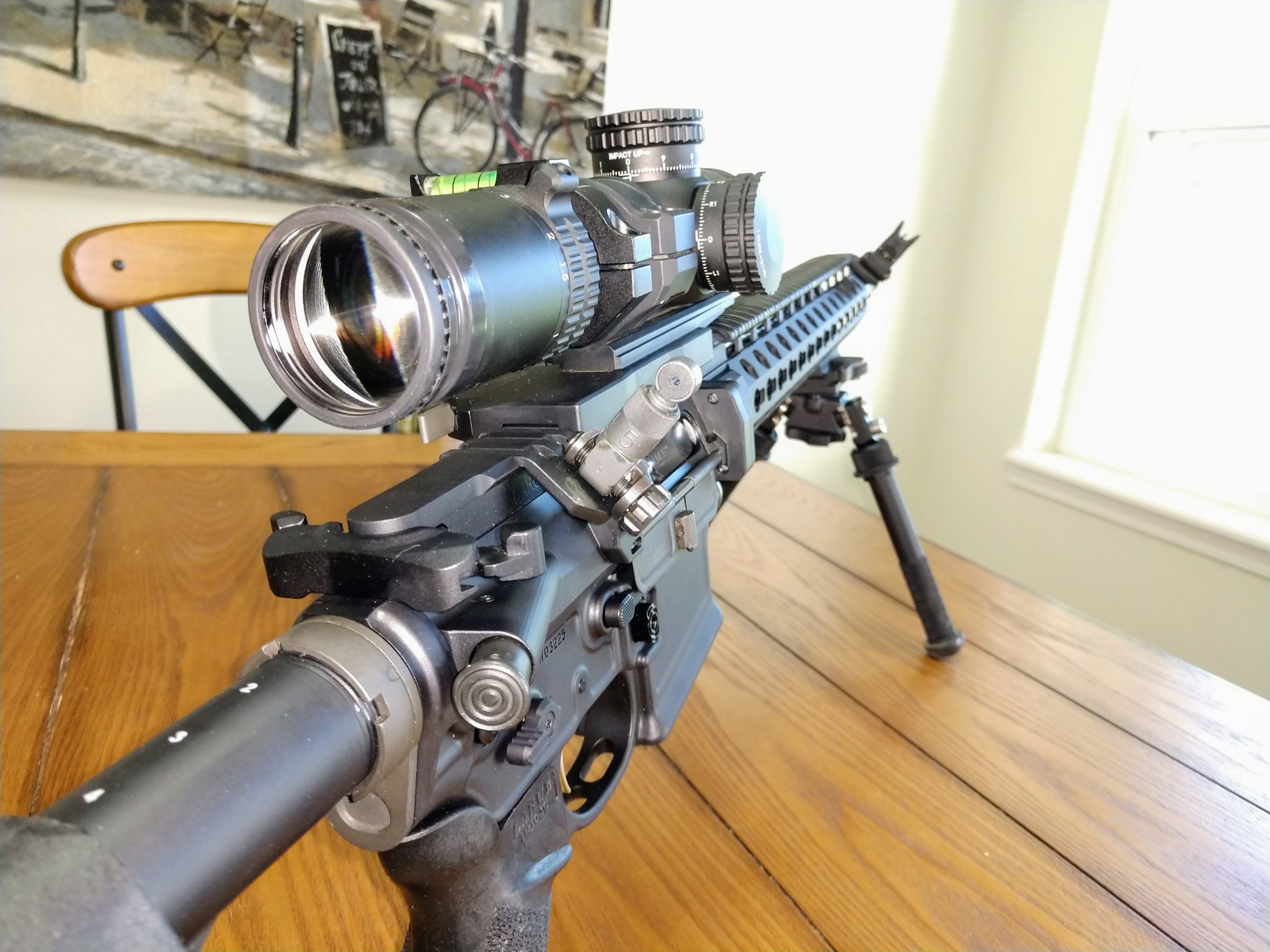

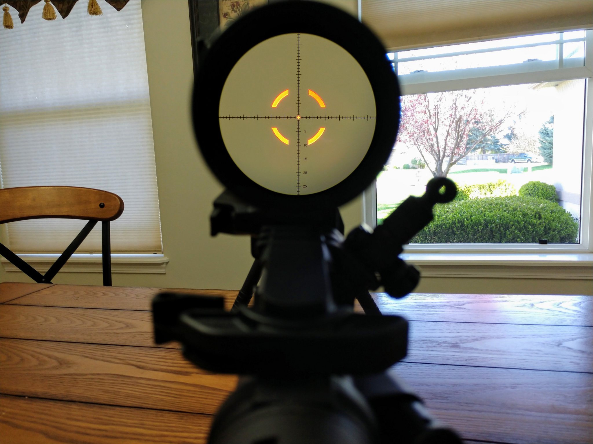

This is how I've built my most accurate recce rifle to date. It's a true .25 - .5 MOA Rifle.
Full Custom Recce Rifle.
Custom Hybrid Contour 16" Krieger Barrel fluted, 1-7.7 Wyde Chamber, 9/16 Threaded, and headspaced by Compass Lake to a JP enhanced Bolt. Before the barrel extension that I provided was threaded onto the barrel it was polished to a mirror finish, feeds without scratching brass or projectiles.
In the past year and a half with all the builds I've done this Barrel contour has produced the best Barrel harmonics, and with the 9/16x24 threads it keeps the heat distribution even.
Fully Adjustable Mid Length gas system.
American precision arms muzzle brake.(very effective and easy to install)
Complete JP LMOS BCG and SCS Tuned to this Rifle. (Has second SCS (H2) if someone chooses to run suppressed)
KAC 45° Off Set BUIS
Larue Upper Receiver and handguard. upper receiver face was trued properly on a lathe with dial indicators, same as you would true a 700 action, and was properly bedded. (I specifically chose the Larue setup because it's an honest free floating system, nothing touches the barrel or barrel nut not even the handguard)
PWS Full Ambi Lower (the reason I chose this lowers because it's almost identical to the SR15 Ambi lower)
Tuned AR Gold Trigger
Trijicon Accupower 1-8x MIL with BoBro QD Mount.
And this is actually for sale if anybody's interested.

This is the exact rifle that this 10rd group target was shot with at 100yrds.
I'm going to post this in it's own thread so people can get some ideas, and maybe learn something.
