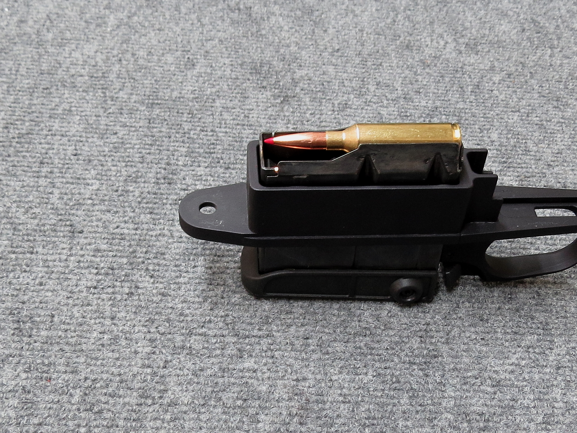

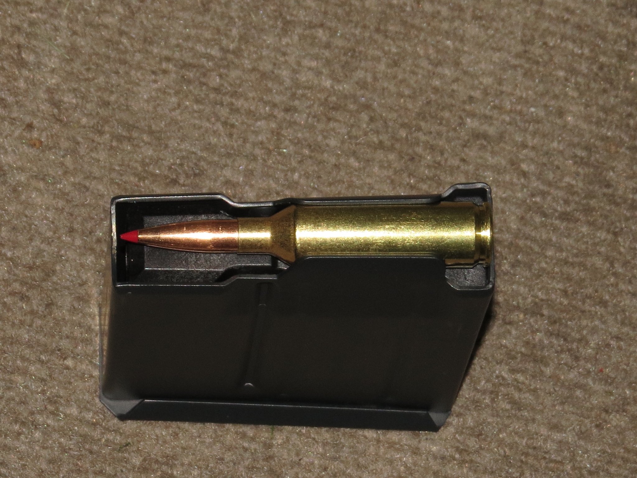

What OAL are you loading to ?
My CTR mags can be loaded out to 2.95 barely and you can order AICS mags from MDT and ARC without binder plates and reach 2.96 to 2.97.
I'm in the process of putting together a 6.5 PRC so shot a couple of pics with the 2.95 PRC in the MDT w/o the binder and the CTR.
CTR
MDT w/o binder
