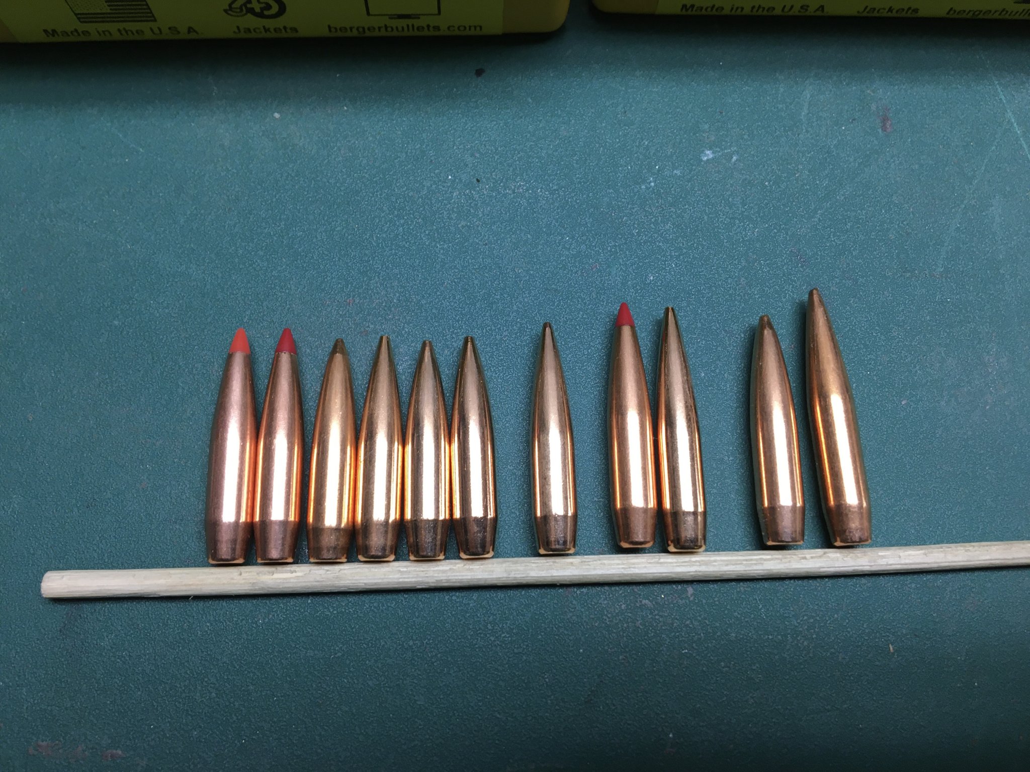

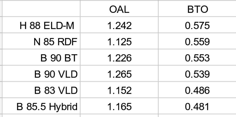

In theory... it might work. Personally I'd be more comfortable with it in a 7, but if you have an 8, it doesn't hurt to try. They are quite a bit shorter than the 90s.
...and before anyone asks, the 'B83 VLD' was a precursor for the 85.5. Didn't make it to market... it's just there for the sake of comparison - and because I had one handy ;)

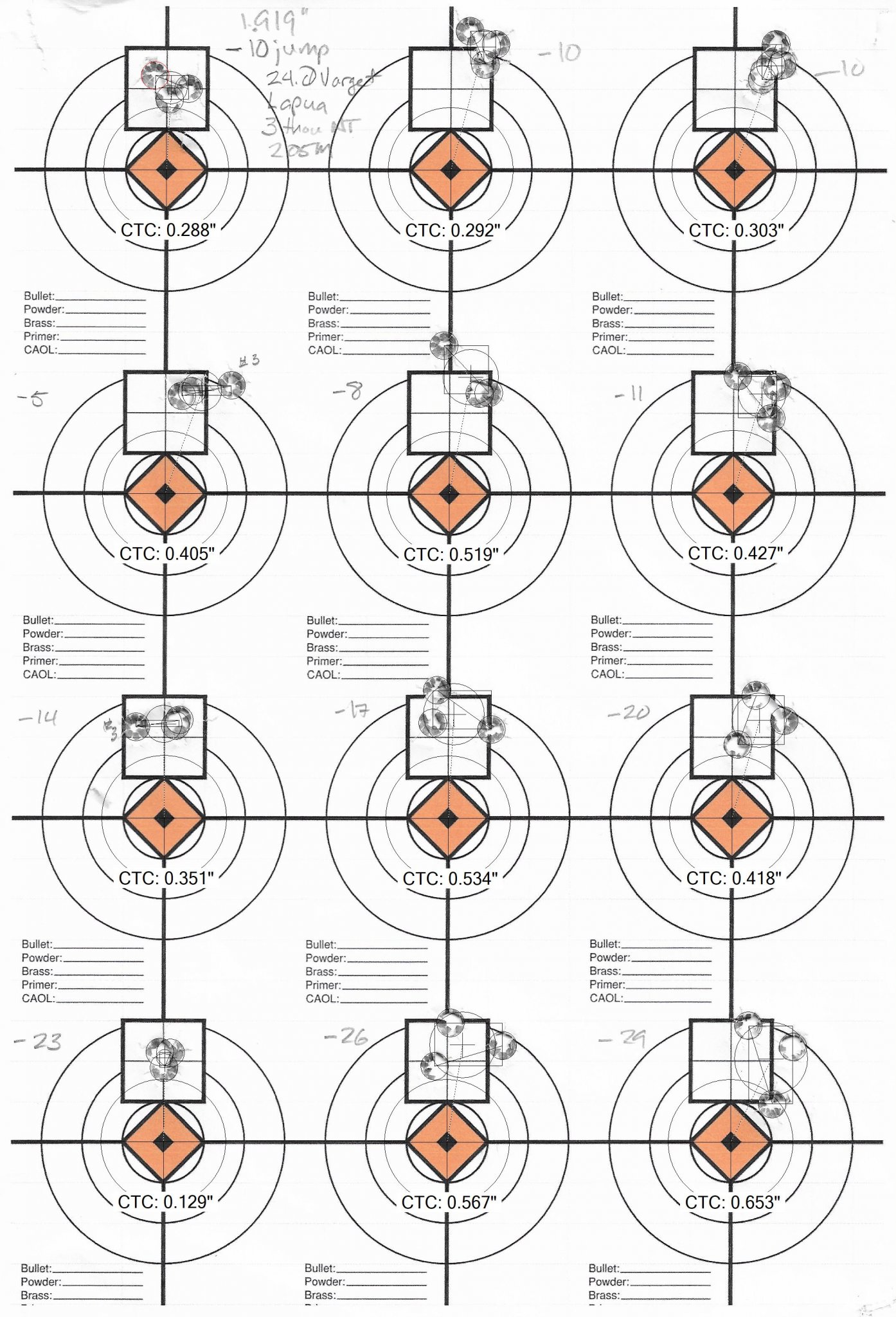

Mine showed up today. Action is in the mail and should have it shortly. Have seen testing but not at anything over 3k FPS. Will know in a couple weeks how they react to fast twist at fast speeds.

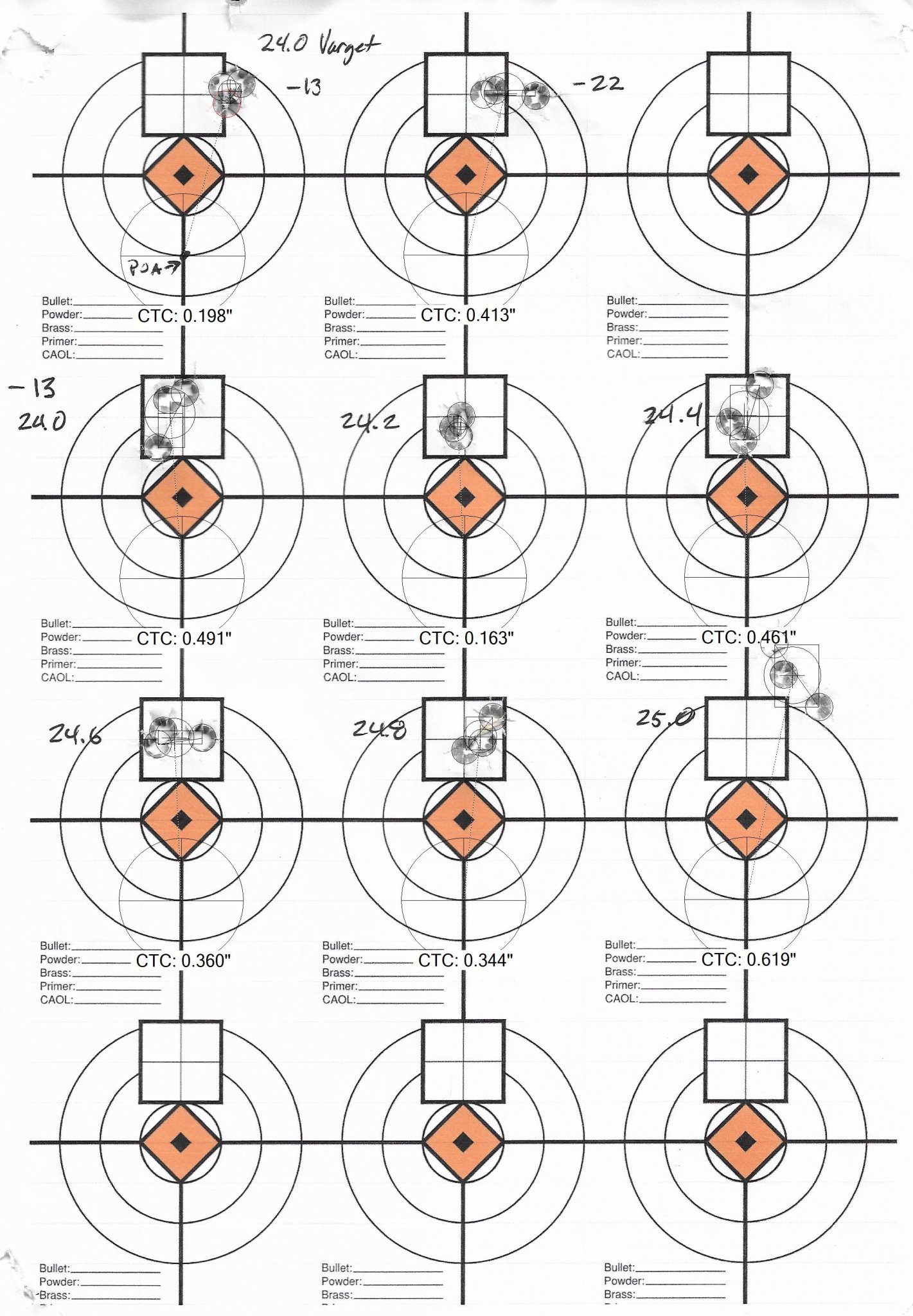

Prelim results with Varget...
Rifle is Savage 12 Palma action, 28" Krieger Heavy Palma 1-7 tw w/ Cortina tuner, McM XIT stock
Brass is once-fired Lapua .223, neck turned to 12.5 thou. Neck tension of 3 thou (.221 ID before seating), Federal 205M primers.
Ambient conditions were 38-42F each morning, between 80-95% humidity.
100yd seating depth test
Felt there was promise both at 11-14 thou, and the 23 thou group was nice but I didn't care for the groups on either side. So when I did the powder charge test, I seated everything long, and brought the arbor press and die to the range. Shot one group @ ~13 thou (based on previous experience with hybrids), and another @ 22 thou. 13 thou won.
Powder charge... obviously tight group @ 24.2, no discernable 'plateau' as far as velocities, OCW 'node' based on vert POI was around 24.6-ish, and calculated OCW/OBT node per QL would be around 24.5, based on ambient conditions. That may change considerably based on temperature. It appears the sweet spot for velocity (in this gun) is around 2800-2820, which jives pretty closely with QL.
Loaded up some more @ 13 thou jump, 24.5 gn Varget for tuner testing (fired round-robin, adjusting the tuner between each shot, then resetting to '0' and repeating the test). The group @ setting 14 was one hole... but the second shot wasn't a good break. Had one extra round, so at the end I re-set the tuner to '14' and tried sticking it in with the other two. No bueno. Fliers work both ways ;)
Overall, I'd say it's looking promising for further testing. The velocity was a fuzz higher than I'd expected; may back it down to 24.4 gn. The bad news is that I'm about out of Varget... but it should be pretty easy to load to the 'target' velocity and work from there with another powder.

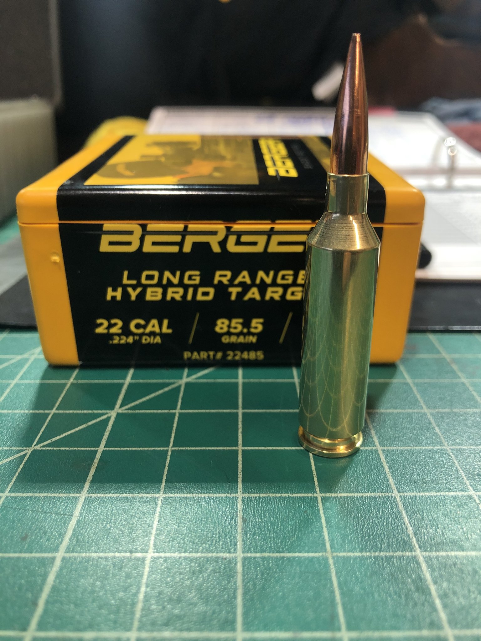

I pre-ordered 85.5s for a new rig I have not shot yet with 0.030” less freebore and a 7 or 7.5 twist. I planned to shoot the 80.5s until the new 85.5s came out. I plan to use 85.5s over H4350.... start at 40.0 grains with 0.020” jump and work up. Hopefully Midway gets them out soon!

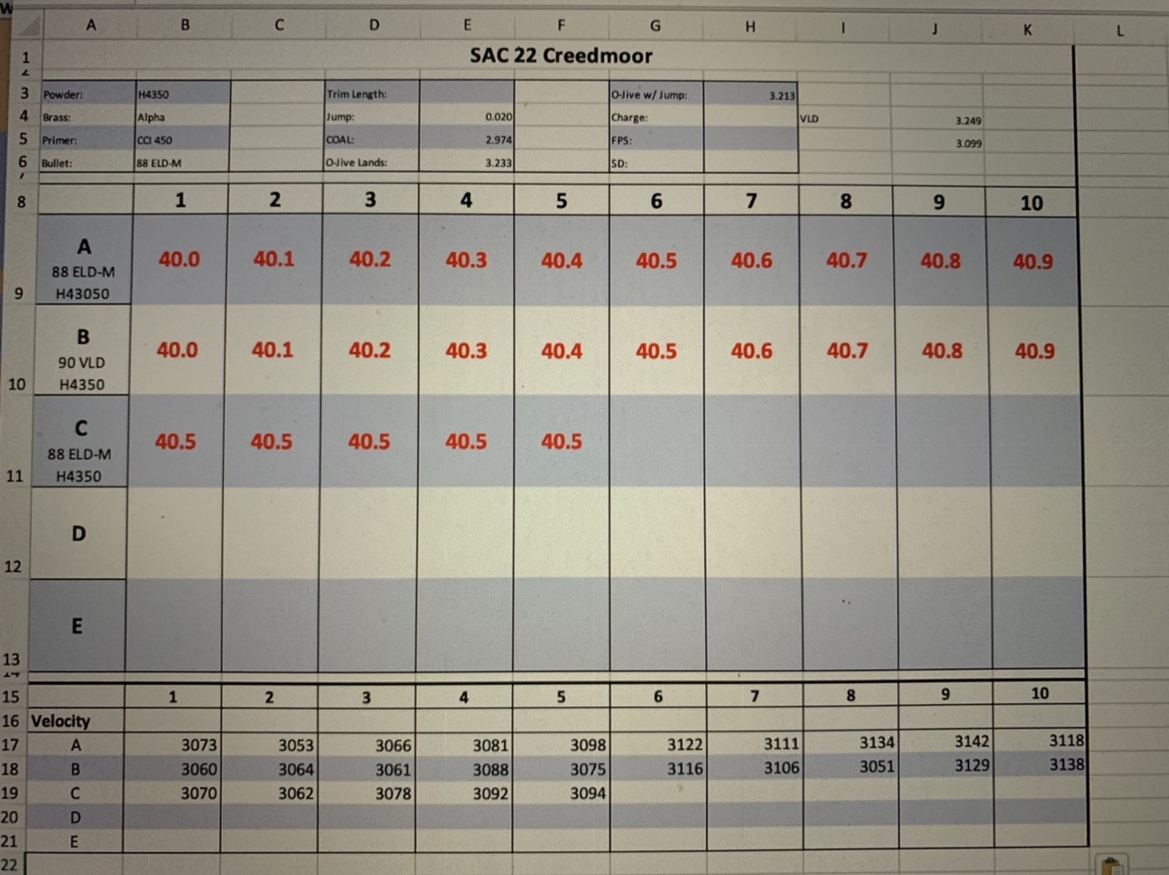

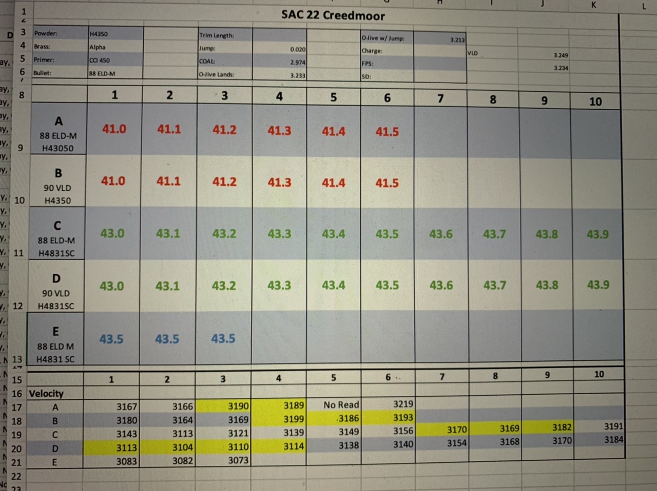

I ran 88 ELDMs in a 22 creed up to 44.4 grains of RL26... was giving me a little bolt lift and over 3320.
42.0 grains gave me 3100 and 43.5 grains gave me 3200.
On 90 VLDs of RL 26..... 42.0 grains gave me 3065 and 43.5 gave me 3175.
Jacket failure with the load I used on 88 ELDMs. They were cooking at 3325 with H4350 and about 15% to 20% of them would not make it to the target. I never played with them that much as I had 147s in a SAUM come apart on me and “my” negative attitude took over and never did more development to find a lower node. I just stuck with 90 Vlds at 3120 until 95 SMKs came back in stock. I run 95s at 3090 with H1000.... the next node up and they wouldn’t make it to the target either. They will shoot and group at higher speeds, but I was losing 1 in 10 consistently. The 95 smk at 3090 works really well and should get some barrel life out of it.
Note, I never had a jacket fail on 90 VLDs but I didn’t push them over 3200.
