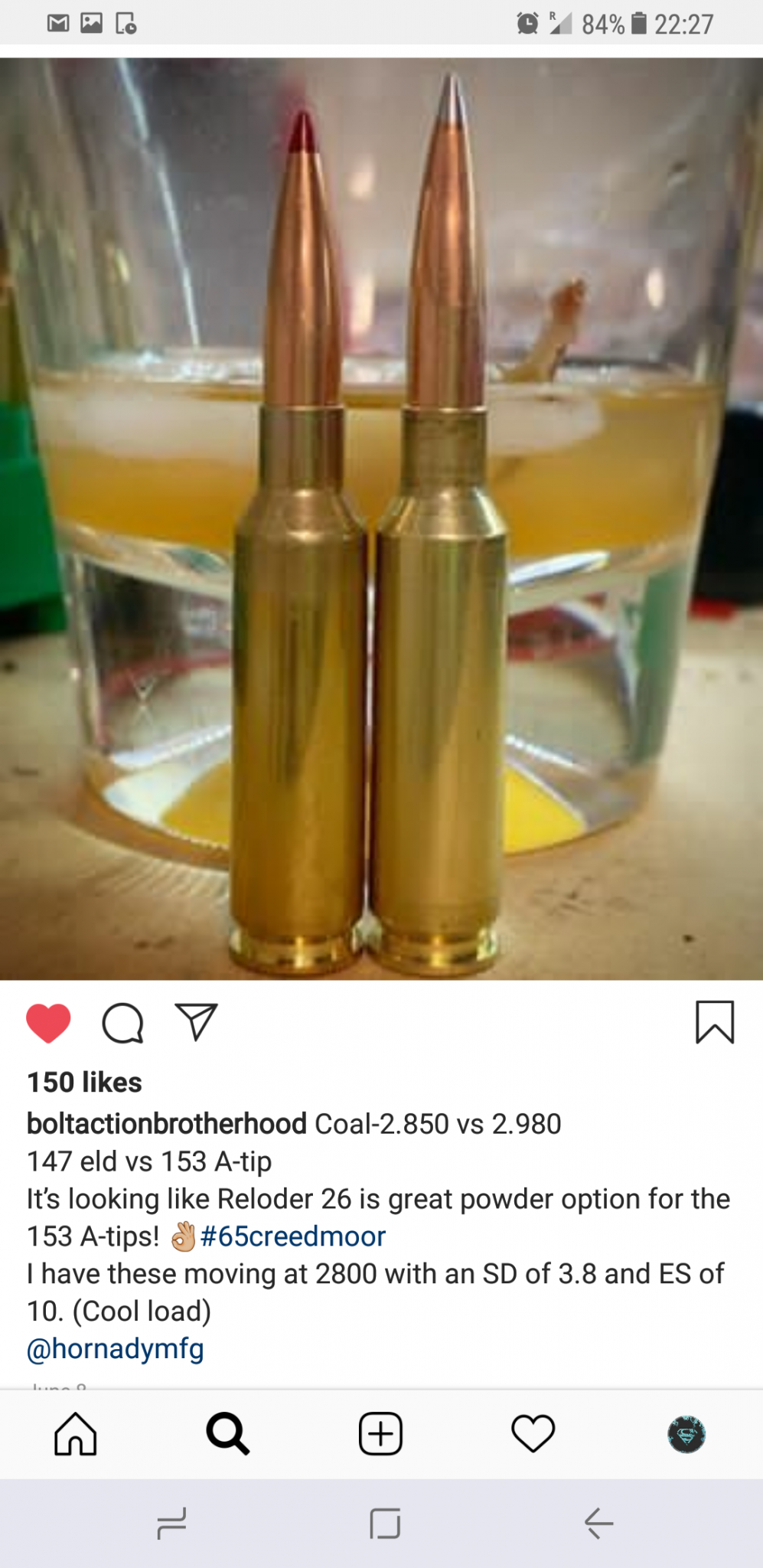

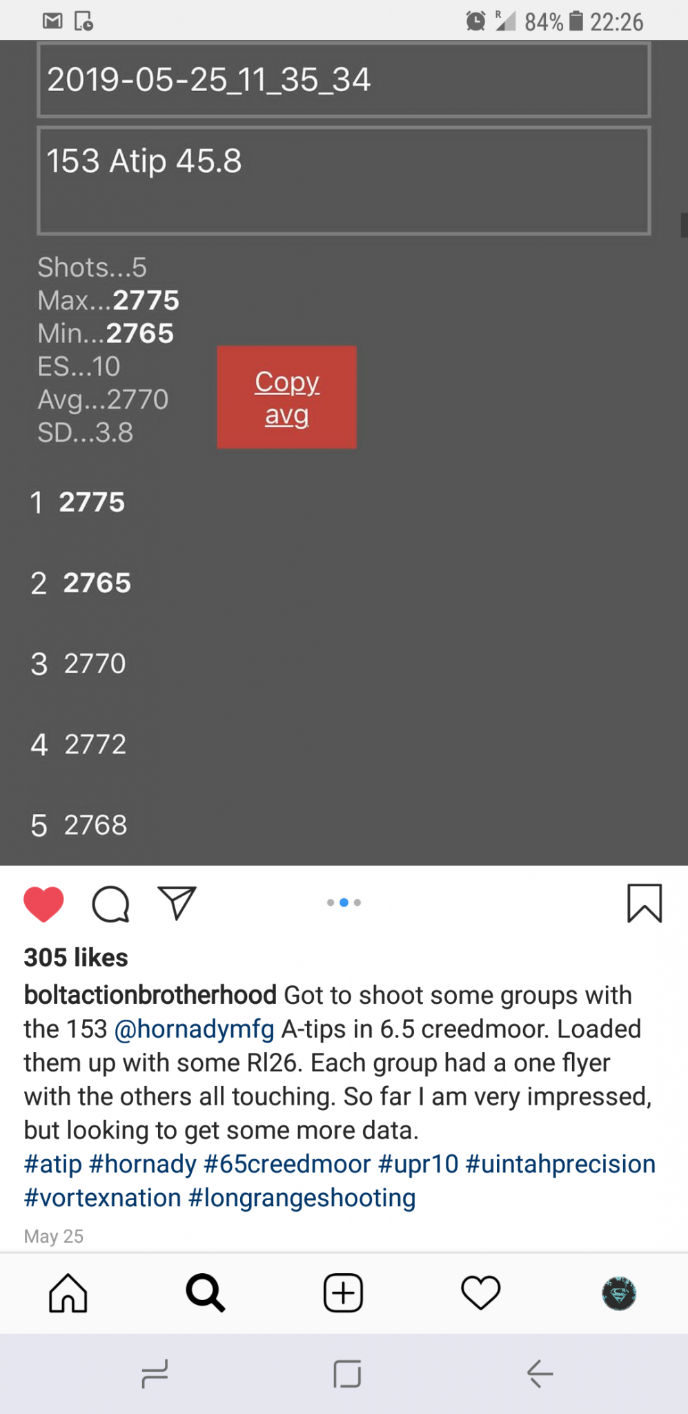

This guy on IG is using the 153 and getting around 2746 MV with RL16. Seems insane to get those speeds out of a CM with 153 grain pills...
Wow, that's a barn burner for real. Probably puts H4350 in the high 2600 fps. Still seems too fast. I've gotten to 2860 with 142 smk, but it was during the barrel speed up. I'd love to get the 135 A Tips to 2800 safely.
These are his posts. I also find it very interesting to have insane MV. I'm sure even if no pressure signs appear, he must be at the upper extreme.

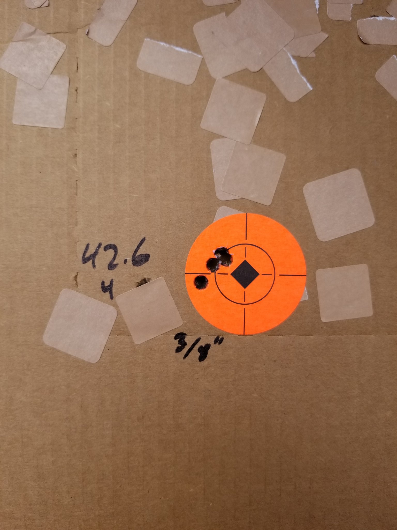

As an update, the box of 135's I got measure very consistently, almost to the point of boredom. Only variance I saw was the ogive, but it was from compressing my calipers too much. If they vary at all, it's in the ten thousandths and I can't measure it. The lengths were all identical in my box.
I will be shooting it tomorrow morning, at 100 and 400 yards, to work on the load. Will try out to 1250 later this months once done.
Reactions: Wormydog1724
Always someone who pisses in the pool. Doesn't have to be new to be in style.

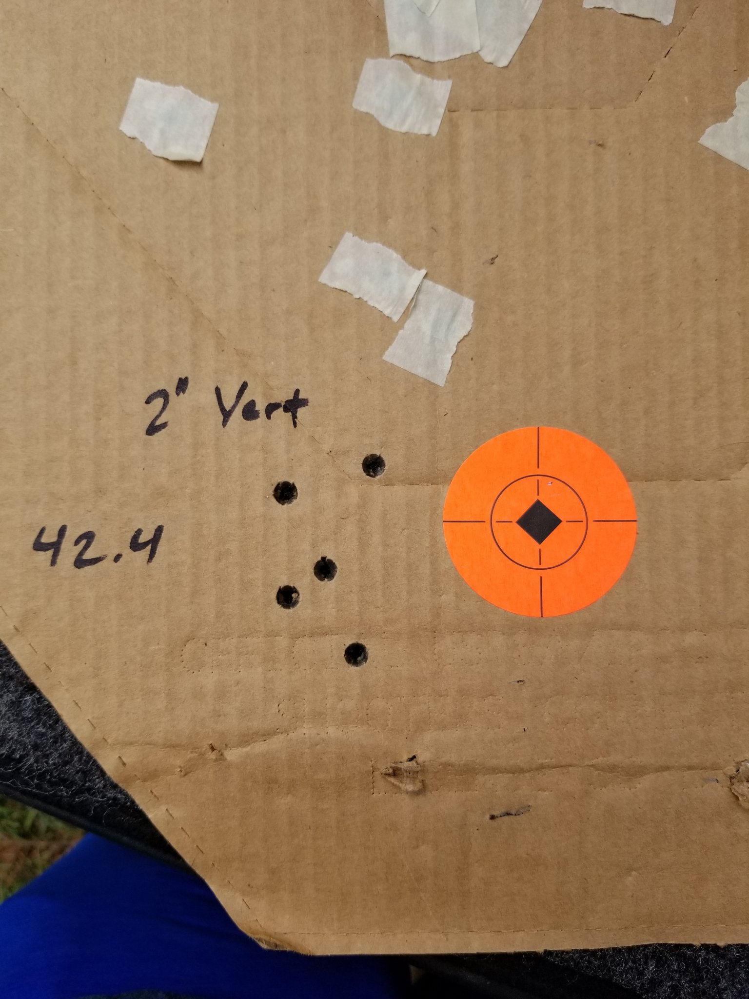

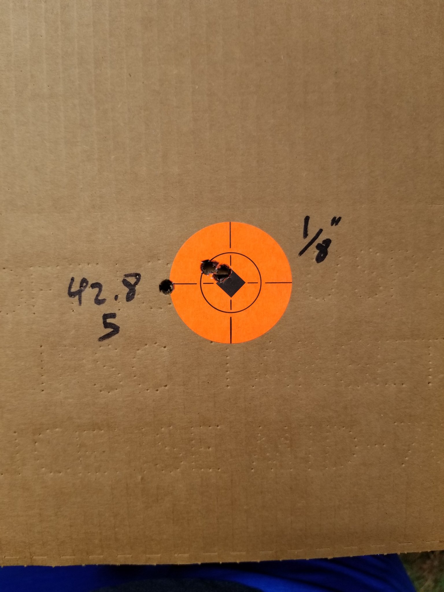

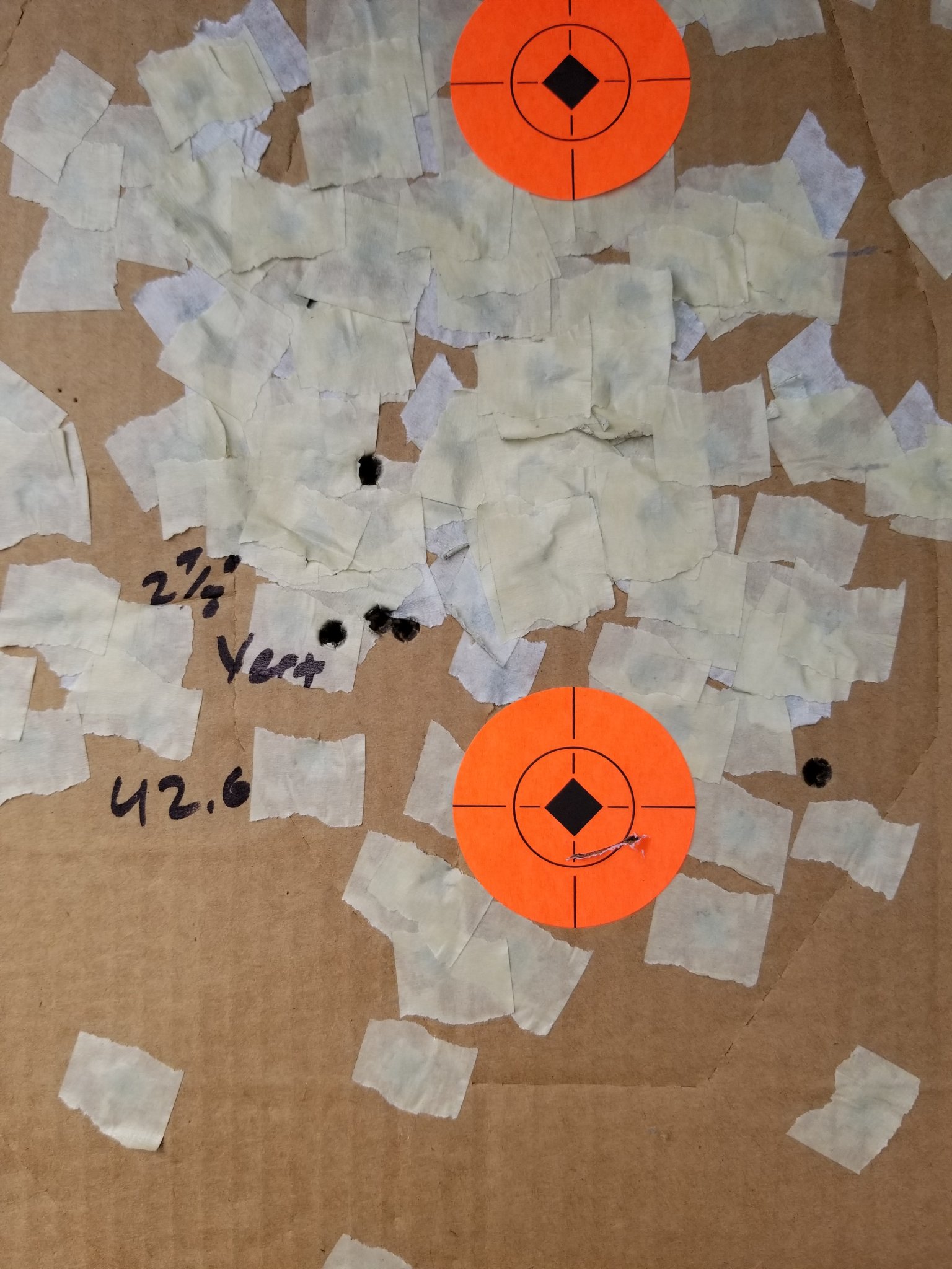

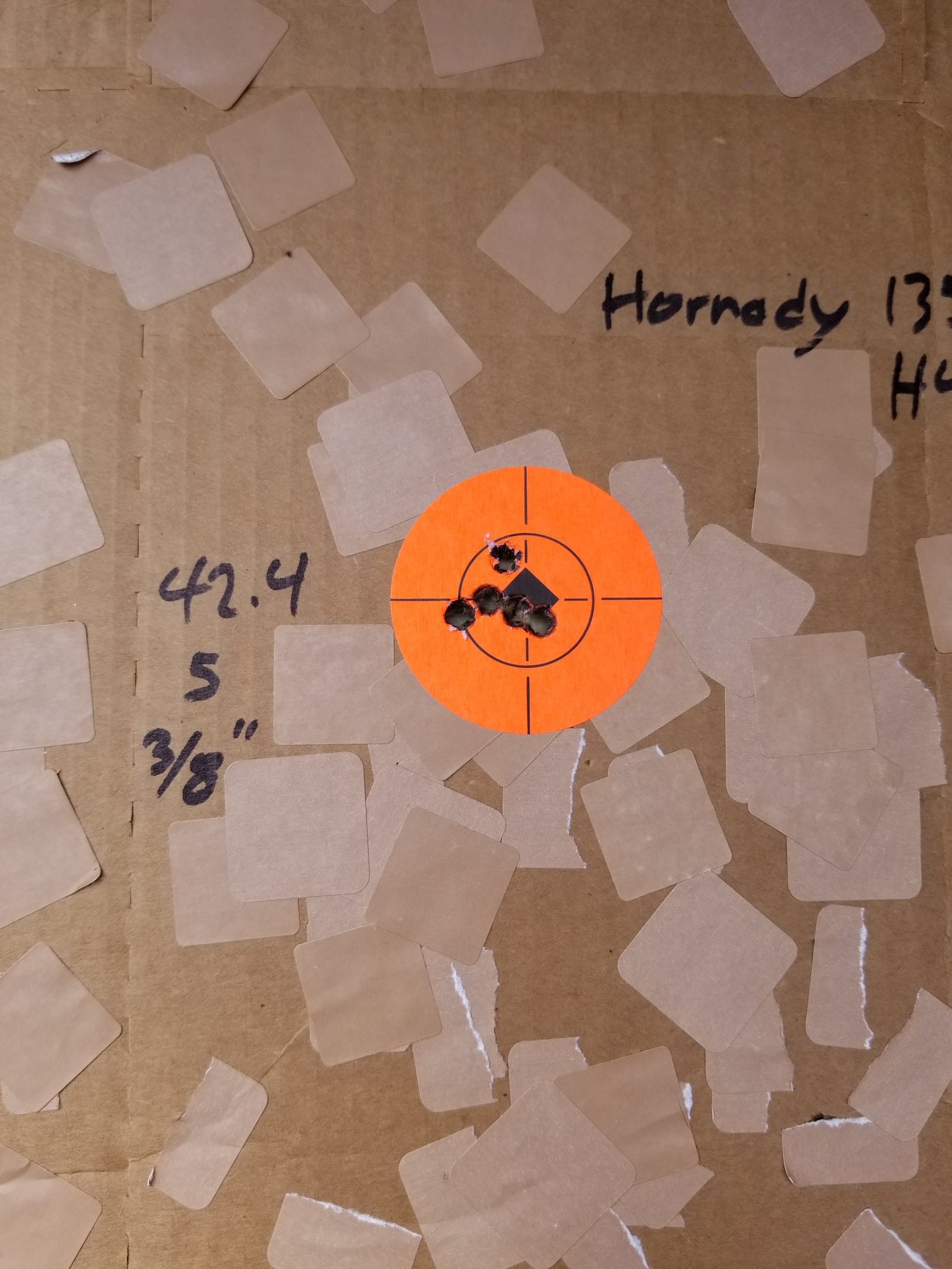

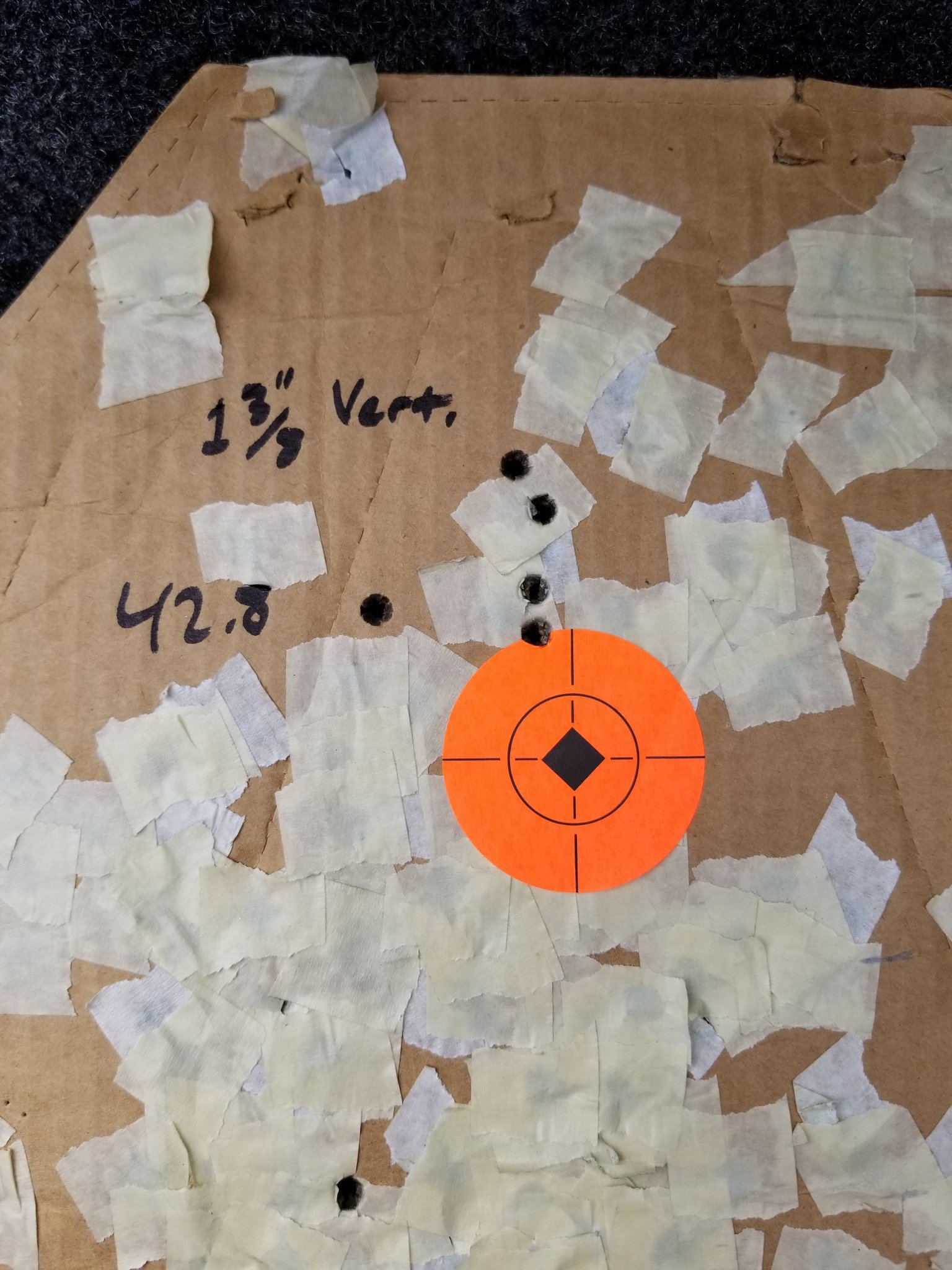

I finished up shooting and am completely impressed. I will preface this with it needs more testing at longer ranges and probably will only show a big difference out there. I can only get to 400 yards today.
What's impressive is that near where I think the sweet spot is, it's cut my usual SD's in half. I can load 142 smk's all day off a $80 RCBS scale in the 4.8-6.2 range. I got a 2.6 and 3.4 with the A-Tips. I did get a couple 9.1 SD's toward the top of powder range I tried, but the kicker was that was the tighest group (@100) at 1/8". The rest averaged just under 1/2", borderline 3/8".
The real story is the low SD variance. I'll be ringing them out against my favorite smk load later this month to see the difference. One word of caution: as with any reloading, start lower than you think for charges and work up. I got significantly higher speeds with less charge than what Hornady's data will have you believe.
Their info shows 42.9 being 2775. I used a tenth less (in a barrel probably 2" longer than their test unit) to get an average 2830. This load had the tighter group, but crummy SD. I'm willing to chalk some of the groups up to my own issues. It's hot as hell in GA and my arms kept slipping from sweat, hence the left-hand bias of groups. Could be my turrets, but oh well.
There is loads of potential here, even in a Creedmoor. Enough that I'm thinking I want a 6.5 SAUM instead of the 7mm variety later to ring it out, unless they make a 7mm version (hint, hint Hornady).
I posted a few pictures, chalk the groups up to what I mentioned above. I know what I'm capable of when I'm not swimming in my own juices. I'll go ahead and say it: not worth the cost if you shoot at shorter distances. I mean, maybe you get that last 5% in benchrest, but I doubt it will show up. However, that is not what these are intended for. These need to go long to shine. Substantially cheaper than lathe turned solids and every bit the laser, I can't imagine pouring on more speed. I'll post the data I wrote down later, left book in my truck. Enjoy.
