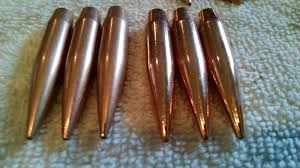

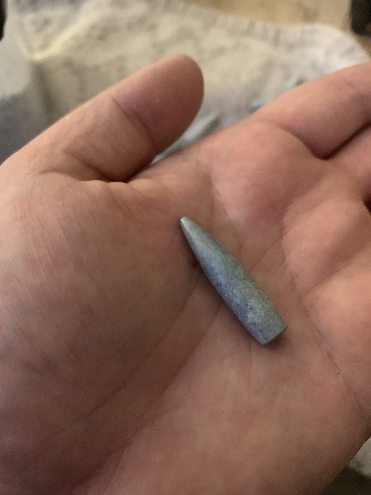

I coat my bullets with hexagon boron nitride. Today I saw that the copper jackets (Lapua scenar l) turned black. I think the air was to moist and colored the copper black...I tried but I cannot rub it off with a towel or microfiber cloth.
Can I still use the bullets or can I better throw them away? I just coated 2/300 bullets that all turned black. 1000 bullets costs in Europe 460 usd, it it only where 50 bullets i would throw them away for sure.

just like copper but then dull like stained glass (left op picture, right is without coating).

Just shoot em. Looks like the coating reacted to the moisture in the air.
If you gotta have shiny jackets, try soaking them in water with a little citric acid solution.
Thanks! I don’t care about the color, even if they where pink with purple dots. I only want the same accuracy and them not to wear my barrel More out than uncoated bullets,
