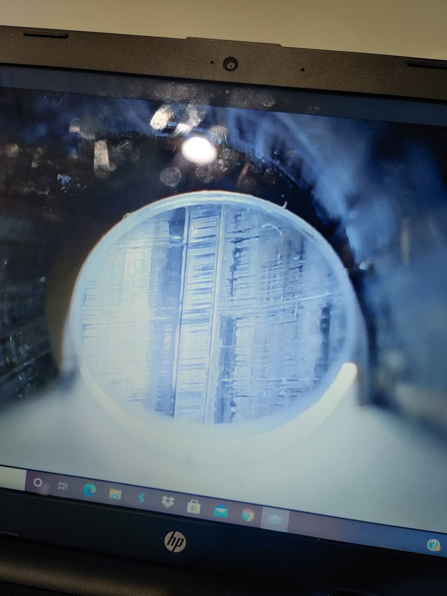

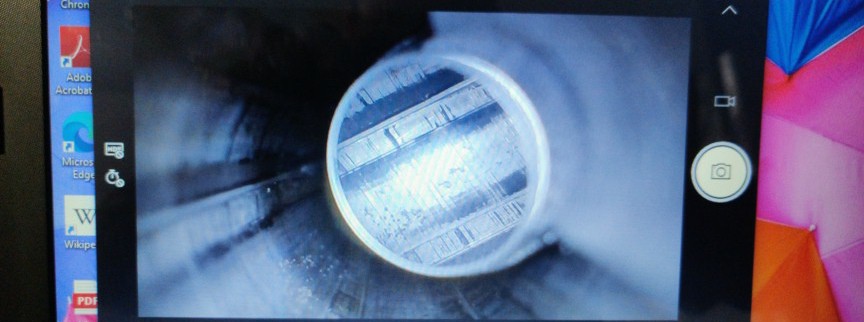

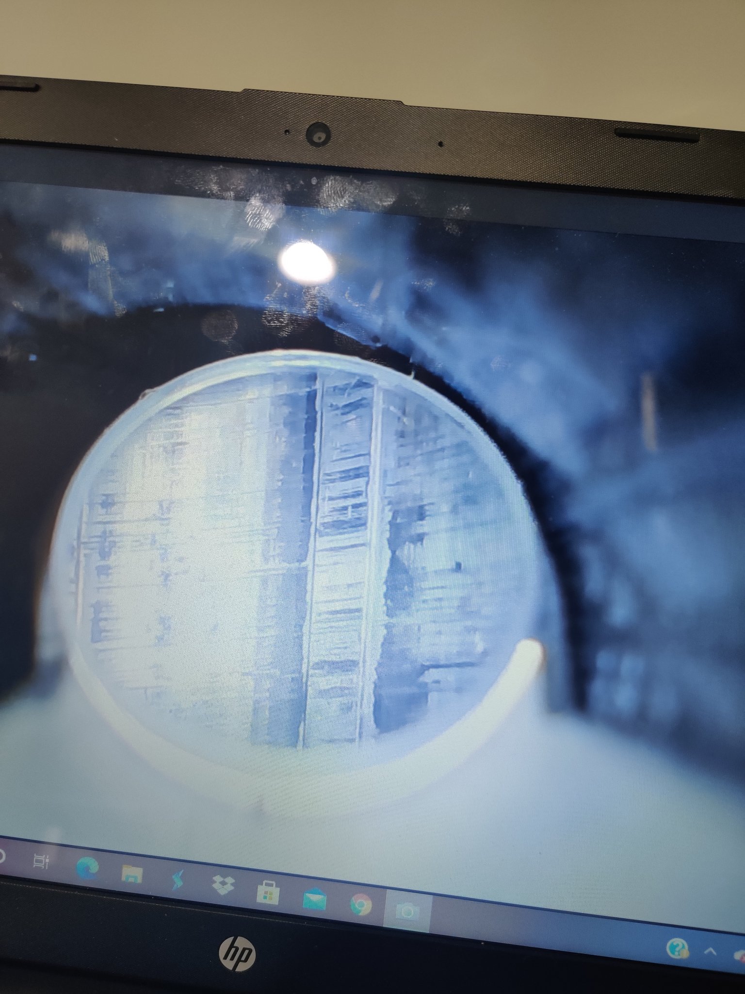

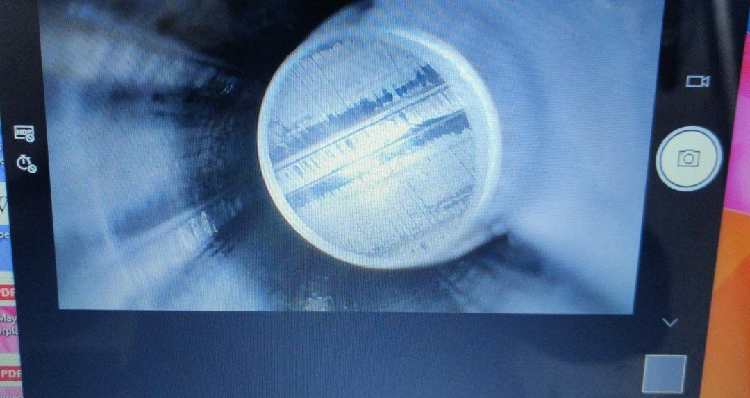

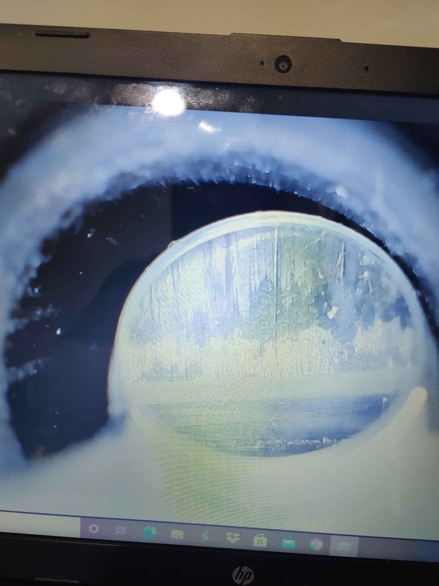

Gunsmithing Help deciphering bore scope pics
creedman12
Jul 23, 2020
13
2
So I just got a bore scope and am not good at interpreting what I am seeing. The pics attached are from a Savage 100 in .270. It probably has around 350-400 rounds through it. Any experienced folks care to weigh in on the condition? Photos start at the troat and work toward the muzzle.
It hasn't been shot in quite a while. I took it out to test some loads and it shot about 1.5 moa on average. Just wondering with the barrel looking like that if I even needed to keep working on it.
So with all that pomp and circumstance, this is what I see. Which has nothing to do with performance, but what are you looking at and why does it look like that.
You are looking at the result of the condition of a pre button rifled bore. If it was bore reamed after gundrill, then they are ream marks and drill marks possibly. If it was gundrilled only, then those are gundrill tool marks. I don't have their drawing which states their surface finish requirements.

Ever see those visual surface finish gages? Look at those under magnification. That's where I started. 64Ra for some bores, 32 for others, 16 for others, min requirement surface finish on bores. Get a borescope, buy one of those kits so you can get some education there..
Reactions: RTH1800
Looks like a Savage barrel. Reamer marks and/or button chatter. If you slug it, I wouldn't be surprised with anywhere from .268-.270 on bore diameter, and .275-.277 on groove diameter.

I'm not necessarily anti-borescope, but I do roll my eyes and sigh at nearly every one of these posts. Can you learn something from bore-scoping a barrel? Sure.. sometimes. Most times, however, if a barrel doesn't shoot, bore scoping it doesn't tell me anything. It'll tell you what a factory barrel looks like, what a good barrel looks like, and how well your cleaning process works. It won't tell you why accuracy sucks, won't show land/groove variation, won't show diameter variation, only shows very poor machining (that still shoots fine most of the time anyway)...
About the most useful thing the end user is going to do is find carbon rings. Otherwise what you see doesn't matter most of the time other than to satisfy curiosity.
Not sure if vintage Savvy, but probably better then .002" on both bore and groove otherwise the air gages mightn't fit. But I do agree in the what you think you see may not bee. Qualitative analysis measures what these things you see might be. Scratch and sniff profilometer testers can tell you what surface finish you have. More to the eye..
