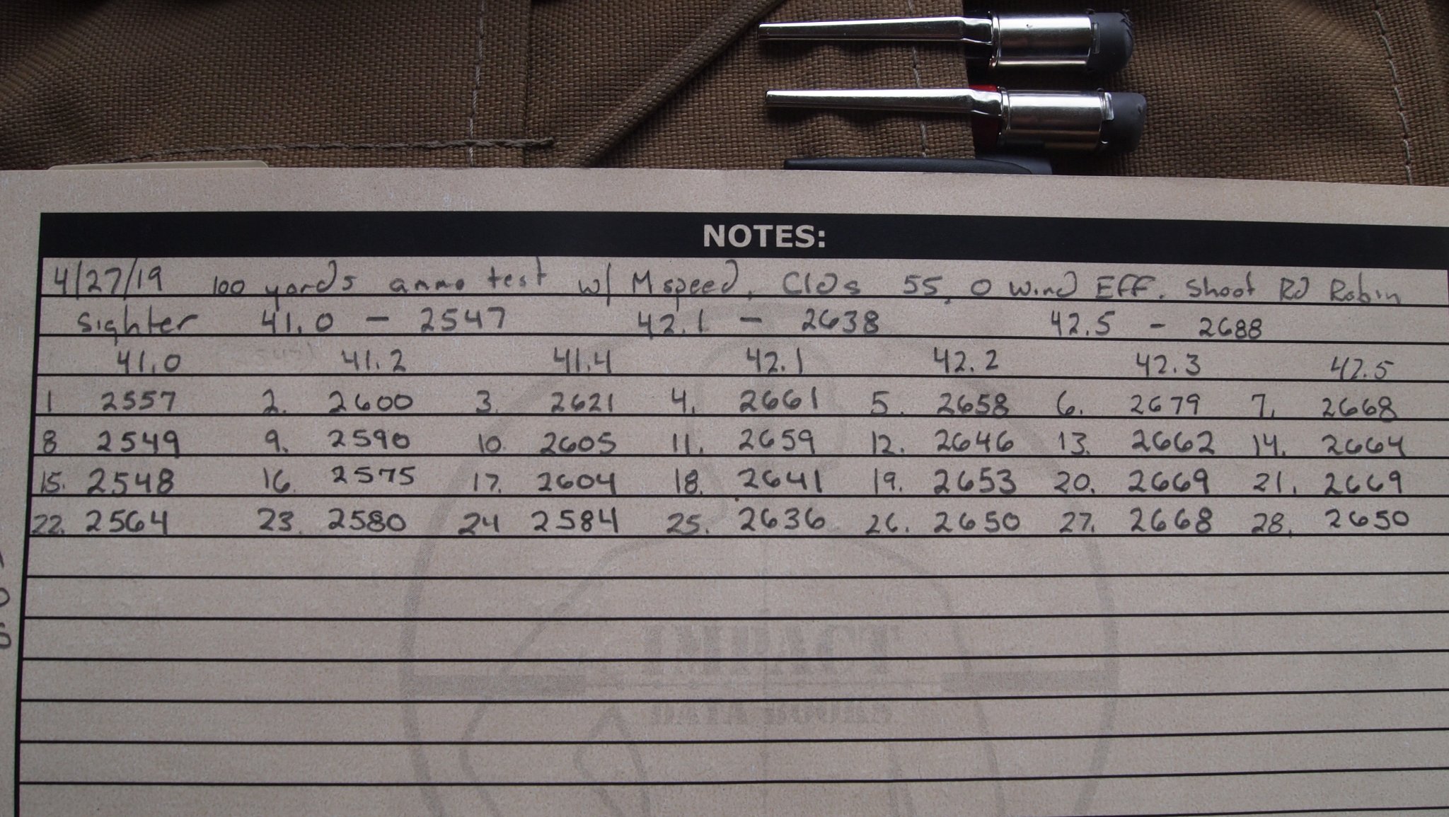

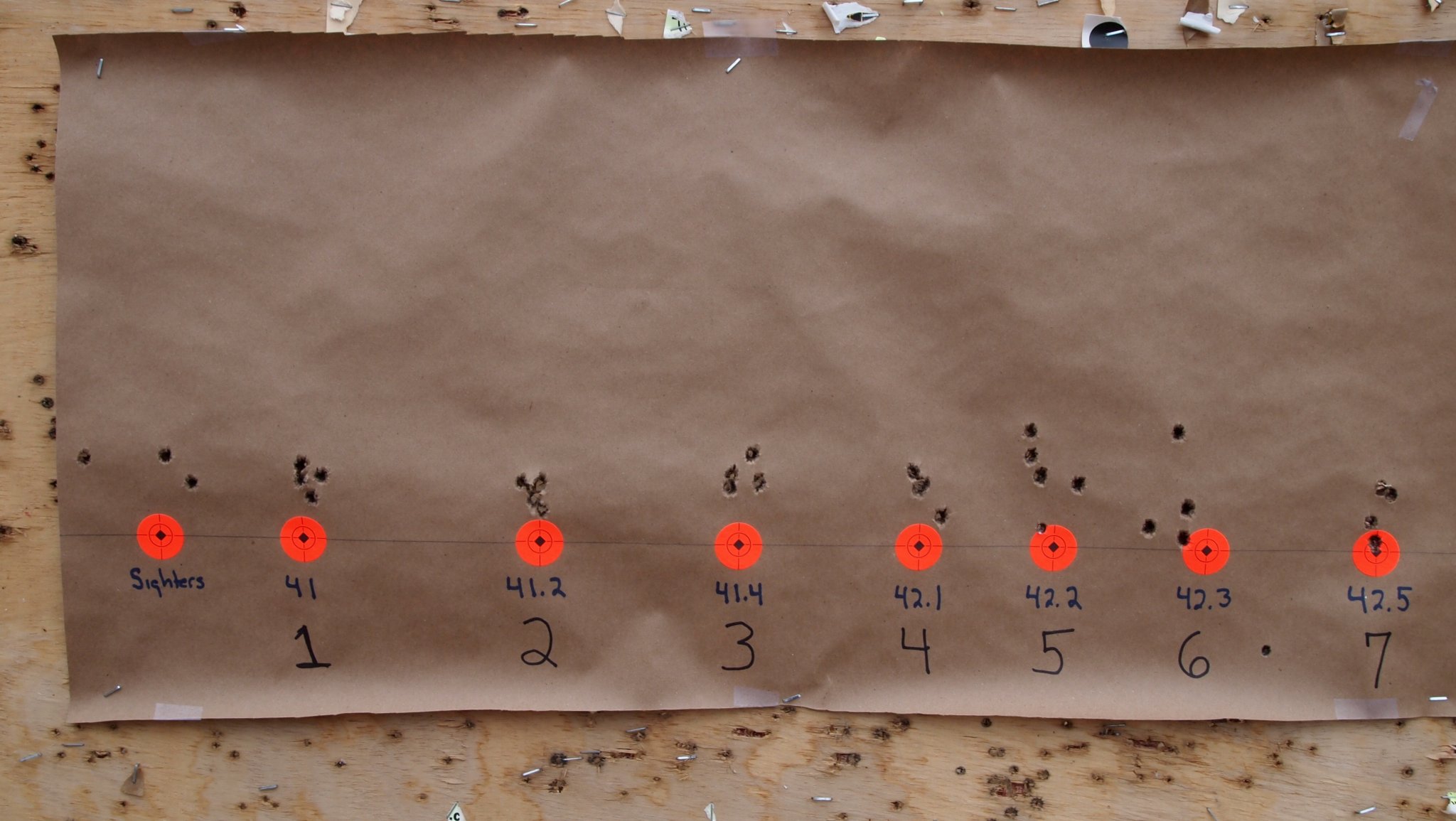

Todays numbers/target.....
Some dick put two .223 holes on my paper.
Reactions: cornhusker86
The CCI primers are holding up without burn through.
Looks like I scatter at 42.2 than start to tighten again at 42.5.
Ill re examine 42.7 plus thinking I wont be suffering "leaking" primers.
42.5 was starting to come back in. 42.7 may be the sweet spot. Couldn't Mr. 223 find his own target?
41.7 is supposed to be the Dan Newcomb node for FGMM 175. 42.7 was the 168 FGMM sweet spot.
As mentioned earlier I was having trouble keeping WLRP primers from leaking and scoring my bolt.
Ive got enough shooting at lower charges with good looking primers that Im willing to crawl up the powder scale...
Maybe 42.7, 42.9, 43.1, 43.3 need to be loaded up.
I know the many here think Im too low right now and I respect their experience.
Guy shooting .223 on my target was a novice with friends letting him try out there stuff. He was supposed to be aiming at steel 6-8 feet left of my target.
Guessing Im lucky I dont have .223 holes in me.
Reactions: pmclaine
Gut shooting .223 on my target was a novice with friends letting him try out there stuff. He was supposed to be aiming at steel 6-8 feet left of my target.

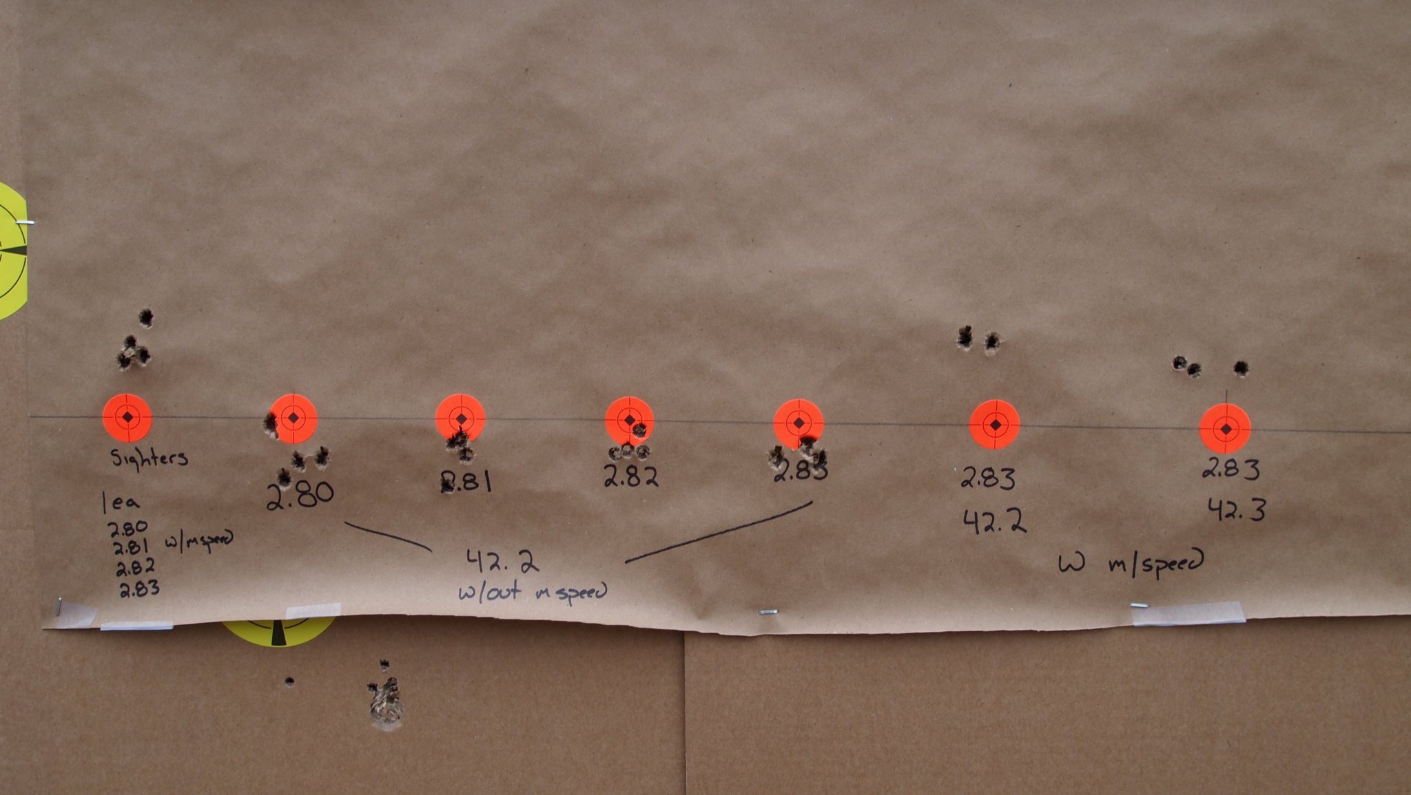

2.830” with 42.2
Your consistent for reason.
Took a look at all my numbers and 42.1-42.5 have consistently the best data numbers.
42.3 would seem to be the way to go but in the cold weather Im shooting Ill drop to 42.2 to allow for summer heat and Im going to load out 2.81, 2.82, 2.83 from present 2.80 to see if the group tightens.
Im thinking it will.
42.3 would seem to be the way to go but in the cold weather Im shooting Ill drop to 42.2 and Im going to load out 2.81, 2.82, 2.83 from present 2.80 to see if the group tightens.
42.3 was my pick from the very beginning.
Just sayin':sneaky:
Reactions: pmclaine

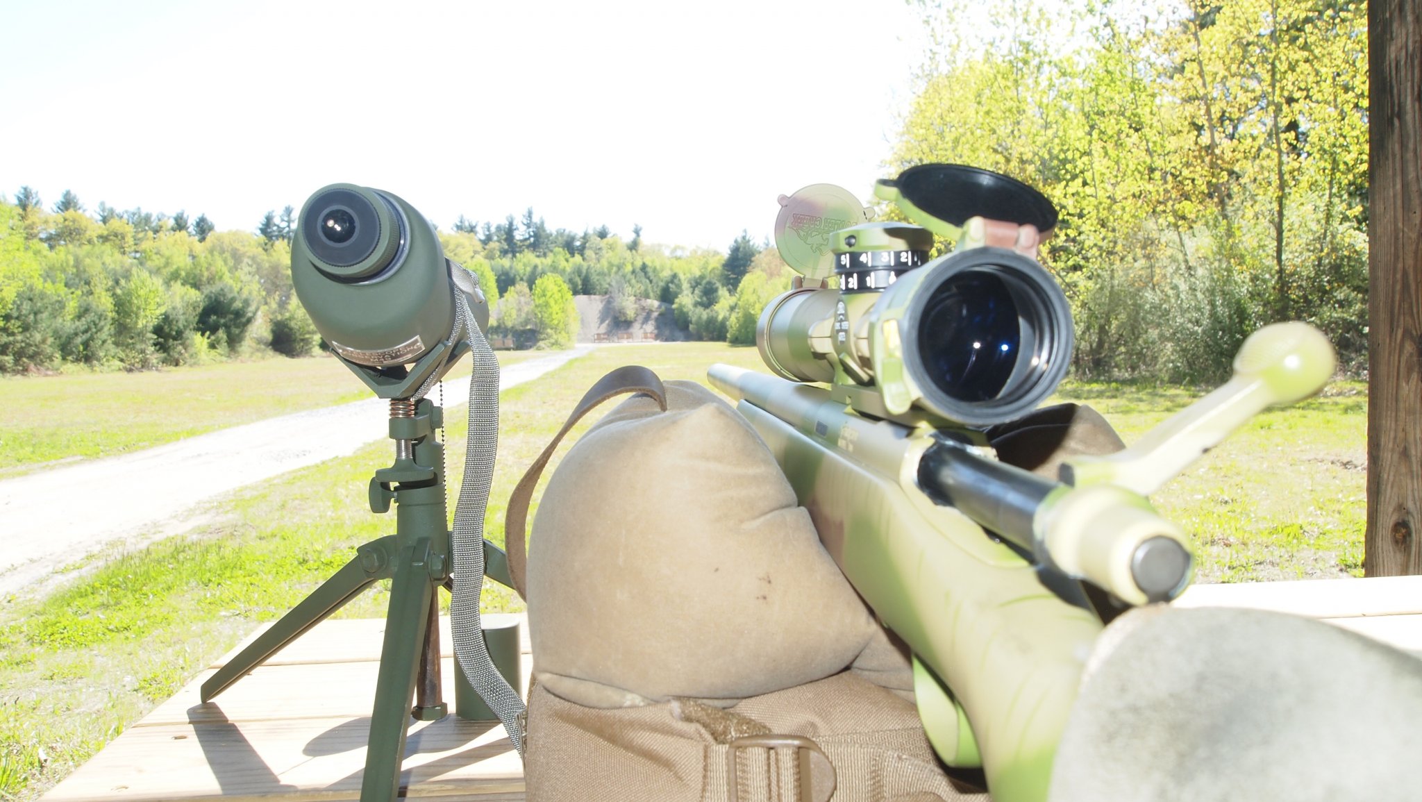

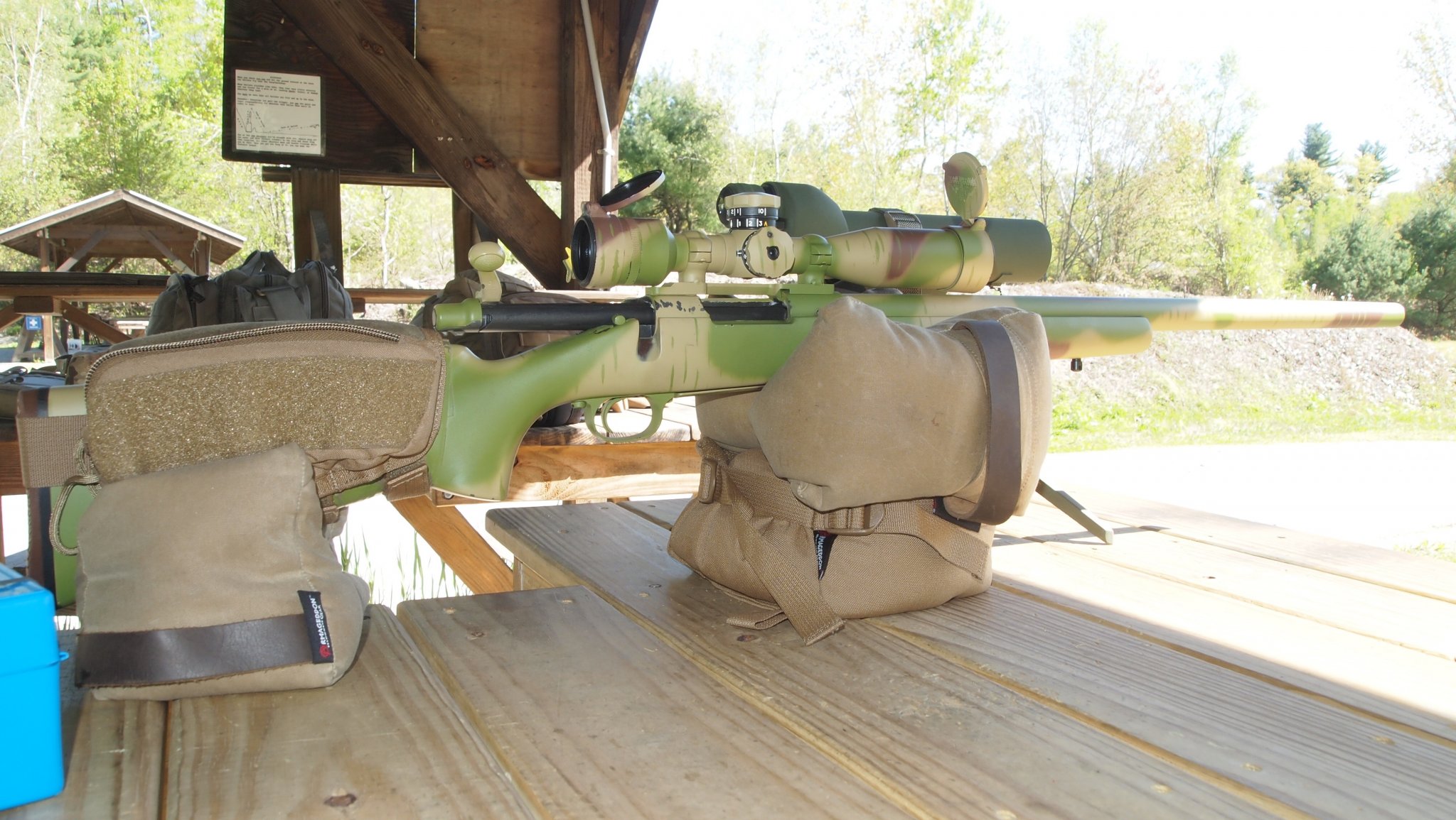

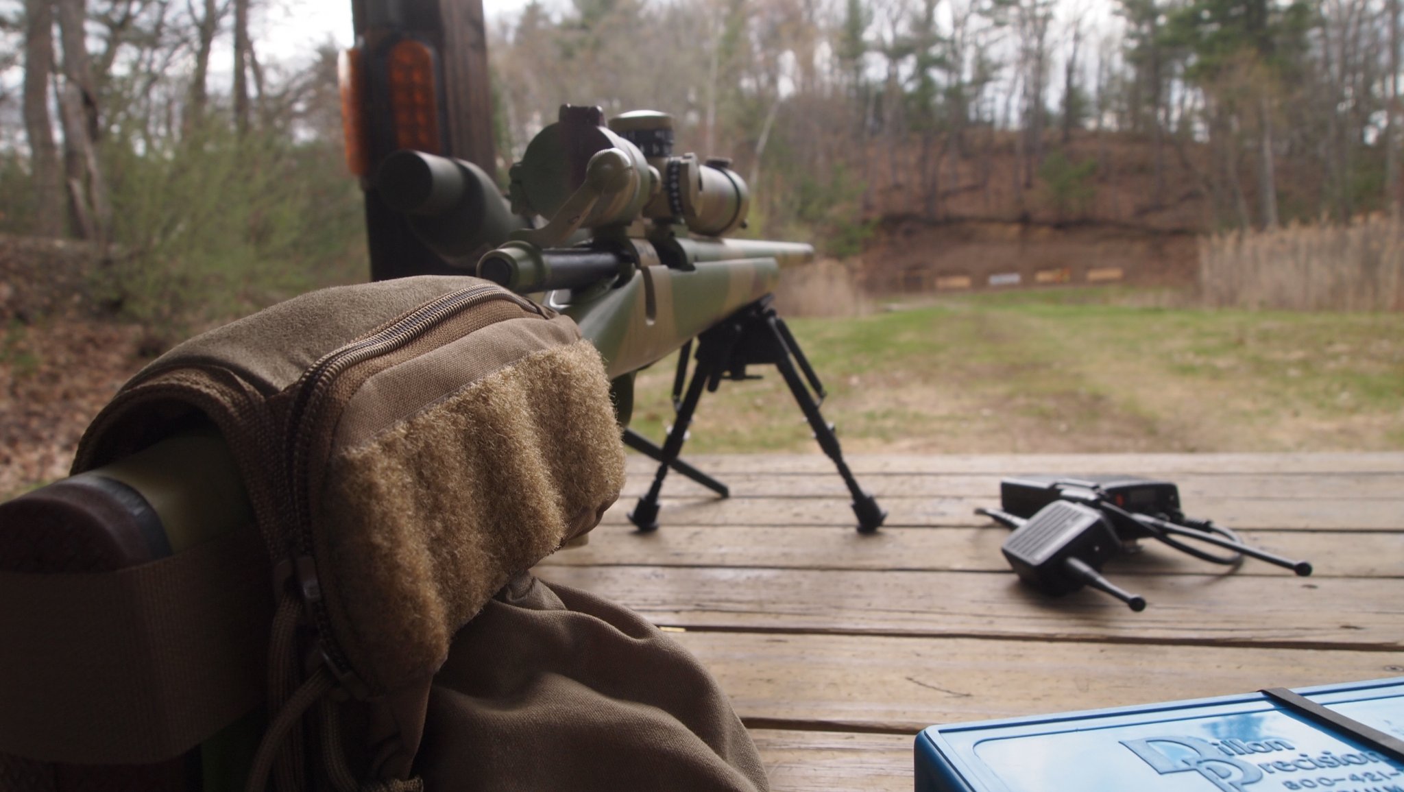

Looking at your pics, the MS is prolly creeping forward under recoil which changes point of impact. I would remove it for this part of the test.
I put a 2” washer over the threaded end of my barrel to arrest the forward movement.
Doing the OCW portion with the MS on can certainly muddy the results. I had noticed an inordinate amount of vertical in all the groups, but chalked it up to the bipod on the concrete bench.
Edit: I guess it's wooden, but same idea
Ill strip the Harris and go back to bags for length testing.
Harris does seem to have more hop than my Atlas that I shoot more often.
The bipod doesn't seem to induce vertical for me on the grass or dirt from the prone, but I personally can't keep the vertical out of it from a bench top.
FWIW, I fight the bipod off the bench also. I keep working at it and I'm coming to the conclusion that its more me than the bipod. Seems hard to keep a repeatable position. I will say that placing a folded towel under the legs seems to help as well as making sure the buttstock is not on the collarbone. .
One key factor that worked for me on the concrete bench with a Harris bipod was two tings. Really tighten that Harris on securely with a quarter or screw driver. And push forward and "load" the legs up with some pressure. The wooden bench seems like it could cause problems with the legs varying from catching in the cracks or spaces between the planks of wood. If it was consistent then no big deal, but I'd find that unlikely. Bags or a front benchrest type rest works best for me off a bench.
I believe you. I have sand bags so I just use those. I have no desire to fight it. I have too many other things to think about.

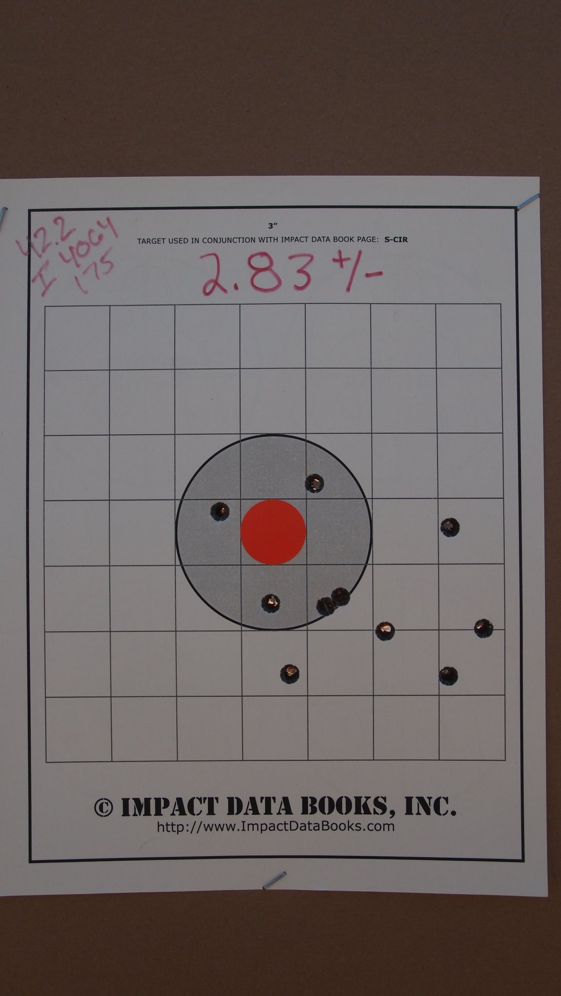

42.2 at 2.83. Good advice here. Thank you.
Interesting the Mspeed throws my rounds high. I actually have the fine adjust -.5 MOA because of what the Mspeed does. If I set it to zero my ammo will line right up with the 175 FGMM zero the scope is set for.
Approx FPS for limited data of 42.2 at 2.83 is +/- 2670.
Reactions: 390fe
One final suggestion... if you are so inclined.
I find .010" to be a bit coarse. I often see a dramatic differences between two adjacent .005" increments.
2.815" and 2.825" will fill in the most promising gaps in what you have already done.
Nit picking maybe, but you've come this far.
Reactions: pmclaine

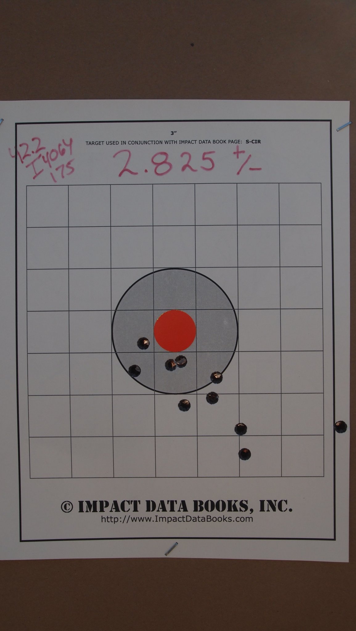

2.83 was really tight until I put the last round slight left. There are three rounds in what looks like a group of two.
Im going to load ten at present 2.83. Detune it just hair, Dial them deeper .005, load ten more, and give them both a try at 300.
Getting tired of shooting this rifle. Missing my other guns.

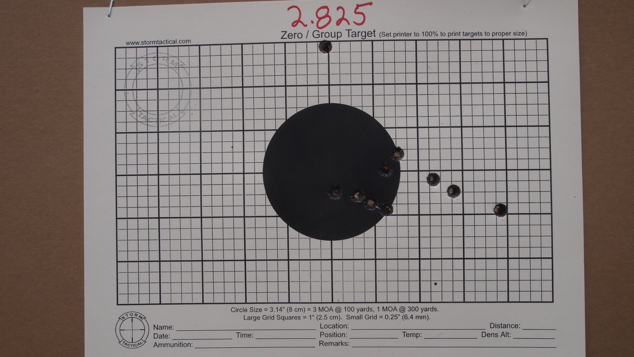

Still working it.....
300 yards......2.83 appears to spread more than I want.
I like the 6 oclock group in the 3 inch circle at 2.825 but the three low to the right make me wonder WTF? A scope adjustment gets 7 of them in the 3 inch circle.
Makes me wonder what 2.82 even would do for me.....

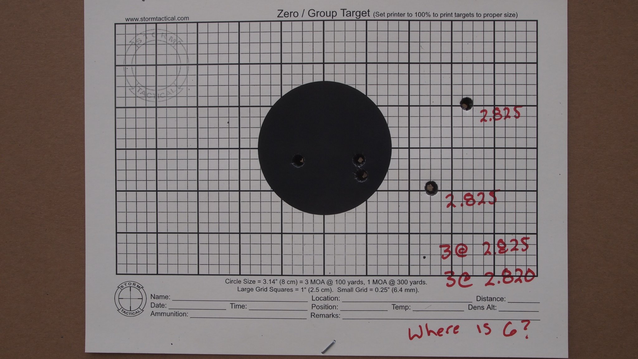

2.825 vs 2.820 at 300 yards
Only other change was a +.5 MOA elevation adjustment.
Sighters - 3 @ 2.825, 3 @ 2.820. Dont know where shot 6 is unless two bullets, one hole, and that would be the 2.820 as the 2.825 are accounted for.
2.825 10 rounds fired alternating with 2.820
2.820 Shot 9 (24) I took when the sun burst through my overcast. It created a big boil of mirage. I wish I had of held it. Thinking I may have lost my mojo after seeing it and followed up with 10 (26).
So 2.820 does better average wise 7/10 in black 1 MOA circle, but that group at 2.825 looks a little tighter, more horizontal, until the 4 "outs" really appear out.
Im thinking .5 MOA left wind makes 2.825 a winner.
Hmmmmm?
2.822 and .5 MOA left?
I disagree. I've done 100's of OCW tests with my MS on my barrels for years before the Labradar was released. It didnt muddy any results. It changed POI slightly but as long as you left it on for your entire test everything was consistent.
Yes.
Looks like my MS caused my results to shoot high and when removed , in this particular case, brings it close to zero I set with 175 FGMM.
How many barrels? How different were the tapers? How different the calibers? Just the V3 or the Sporter also? How different were the set ups (bipod, mechanical rest, sand bags)?
You might disagree, but there is no possible way you can be definitive with something so situationally individual.
