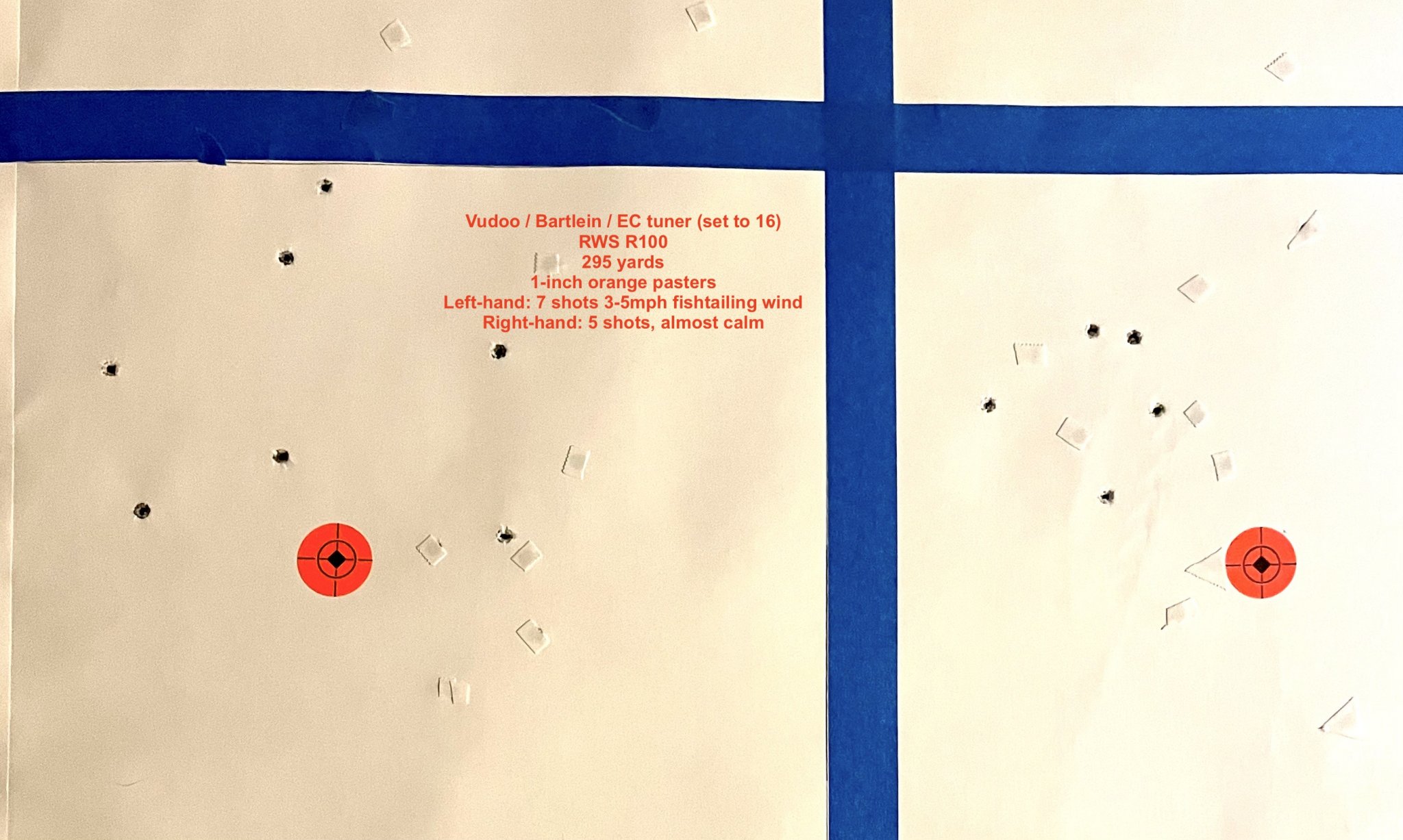

Experiences (all barrels 1:16" twist):
  • I tried a Harrell tuner on my Vudoo with original Ace barrel (19" Kukri) and on my now-departed CZ-455 "Tacticool" with 16" barrel. After nearly two boxes of Center-X, I couldn't make the Harrell do anything pro or con with the Vudoo. But it made a very significant positive difference with the CZ.
  • I had the EC v.1 tuner installed at Vudoo as part of the rebarreling (22" Bartlein, MTU). This tuner absolutely makes a difference. The barrel is pretty well broken in now with something over 500 rounds on it and I have settings that seem to work with the Lapua/SK and RWS labels I have on hand. I tune at 100 yards on an indoor range.
  • Settings seem to be associated with velocity, which makes sense. With the EC, my setting "20" is best so far with Center-X, Standard+, R50, etc. with velocities in the 1085fps range. "16" looks optimal for the faster R100 ammo; will be interesting to see if this carries over to SK Long Range Match.
  • I also have a KSS tuner which I've tried on multiple centerfire rifles and on my RimX... this tuner is a bit lighter than Harrell or EC and doesn't seem to be as effective. However, @Rob01 has enjoyed good success with the tuner and factory ammo.
So - I'm a believer in tuners, albeit with acknowledgement that not all tuners work on all barrels.
(Edit: I saw a difference of 25% or so from "worst" settings to "best" settings with the EC tuner.)
The photos below are with RWS R100 ammo, which has shown a 15-shot ES of 15fps. I held straight up on paster for all shots, no attempted wind correction.
(Another edit: I dislike photos of one 5-shot group. I want to see 10, 20, 30 shots in aggregate. But, with this RWS ammo at $.42 per round shipped, I'm being stingy with it. These were first attempts at 200-400 yards. The two 400-yard groups were awful in the wind and ok in calm condition.)

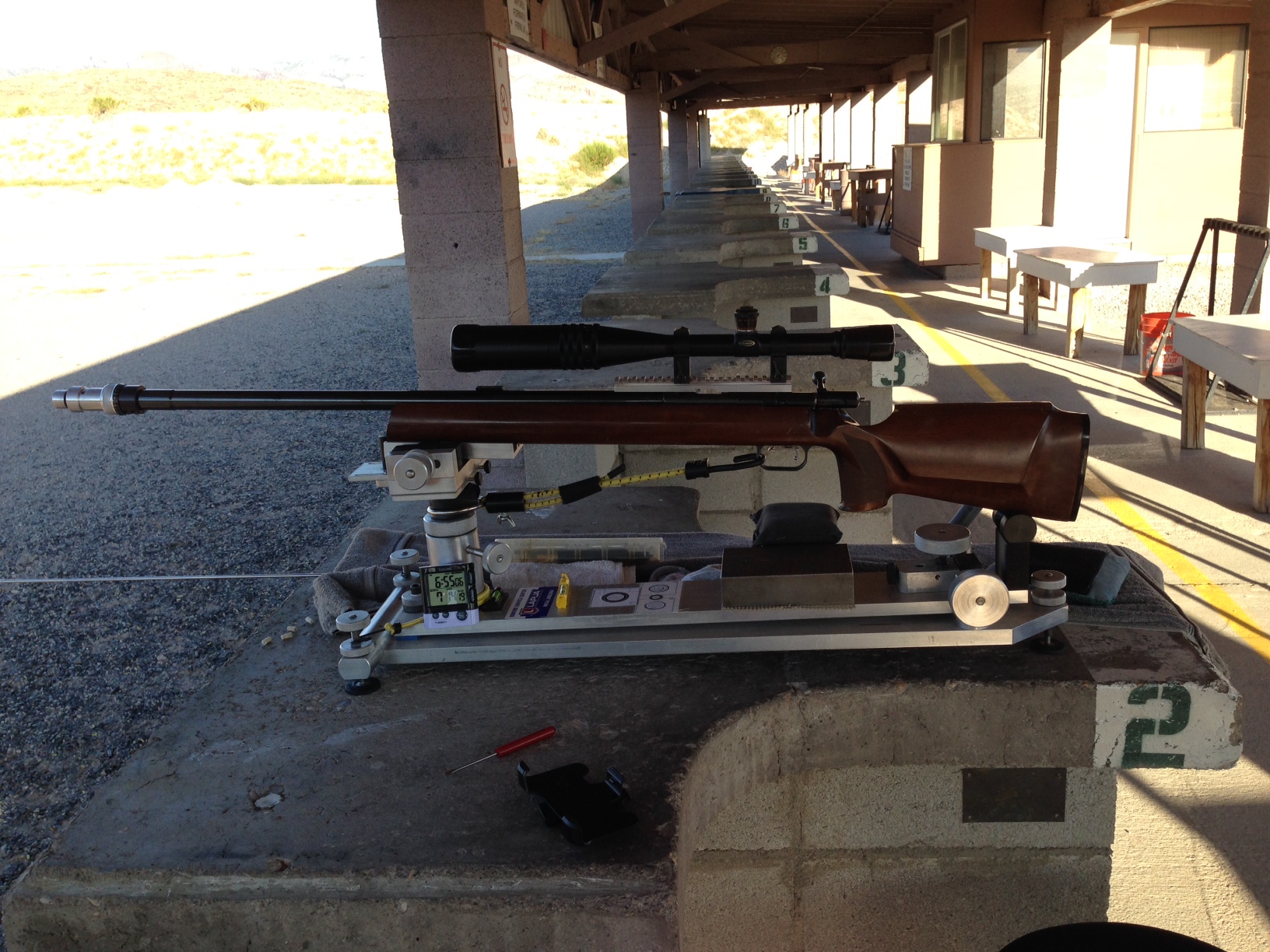

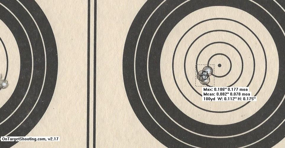

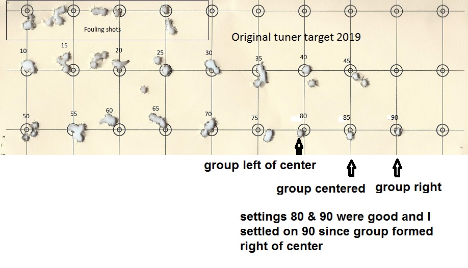

on your comment on the proper way to tune here is an example tuning a factory barreled Anschutz 1413 in a factory stock. in one tuning session (Jan. 2019) I found a setting of 90 and it still is at that setting. in Feb. 2019 at Lapua in Mesa this rifle shot a 11.86mm 10-shot group with the same CX I tuned with. 4 years now the tuner is still at 90 and being shot against Vudoos and custom BR rifles. the current owner still reports he is doing very well with the rifle. an example 100 yd. target 3 shots same tuner setting of 90 but with a different lot of CX.
Two things that are important with setting a tuner 1: Consistent ammo 2: a rifle capable of being tuned. requirement 1 is a no compromise without it you will be chasing your tail. number 2 if compromised, at best you may end up with a rifle that shoots really good sometimes and at other times mediocre.

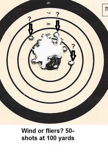

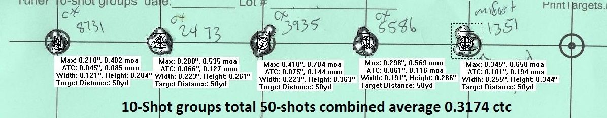

This is where the tuner can help. the rifle that shot this group was tuned at 50yds. 7 years ago tuner has never been adjusted since. the lot that was used for the 50 shots was the first time it was shot in the rifle. granted this is a BR rifle but what I learned if the rifle is tuned. shooting at 100yds. it is all about the ammo and of course the shooter to call the condition.
FYI, the barrel on this rifle has at the time this was shot probably over 70K rounds through it, if not more. if this rifle can do it, I don't see why others couldn't either.
Lee

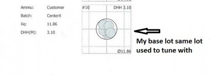

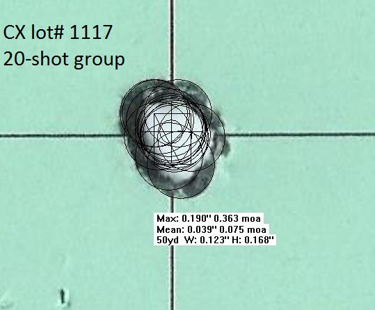

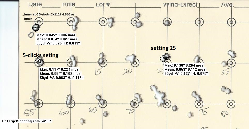

20 shot group after finding the tuner setting using only 3 shots between setting adjustments. barrel 3G BM .900. same rifle with a .850 barrel two different lots, tuner setting again found using 3 shot method. tuner target that was shot and how the 25-setting shot during the session. you will note I shot the two 5-shots group the following day after I decided the 25 setting was what I believed to be correct.
these are examples of using just 3 shots to confirm between each setting adjustment works.
the last target is testing the tuner setting before my first trip to the Lapau center in Mesa this was in 2016. currently it would be impossible to check your rifle before going to test at the centers this way since you won't be able to find any test lots. the results I got at the center 12.14mm @50m 18.58mm @100m. I left with nearly 4 cases of this lot that was the good old days!
Lee

I have 2 EC V2 tuners on my 2 Bergara B14R. The main thing about a tuner, is they will tune in your lot of ammo, then the next lot, then the next lot. I have tuned in 3 lots of SK Long Range, one after the other as I ran out.
Start tuning at 50 yds, Take the best and move on out. I shoot long range 22 lr. I moved to 200yds and fine tune for vertical. Get a EC V2 for the Tikka and a Harrell for the CZ.
