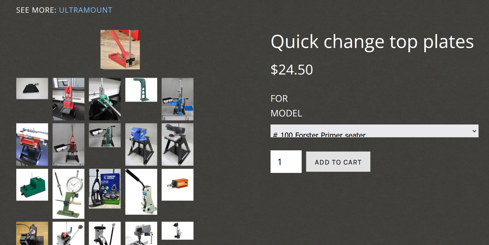

The Forster Primer Seater is also most definitely also 'compatible' with the Inline Fabrication QD system. Go to the drop down menu and selection option #100.
