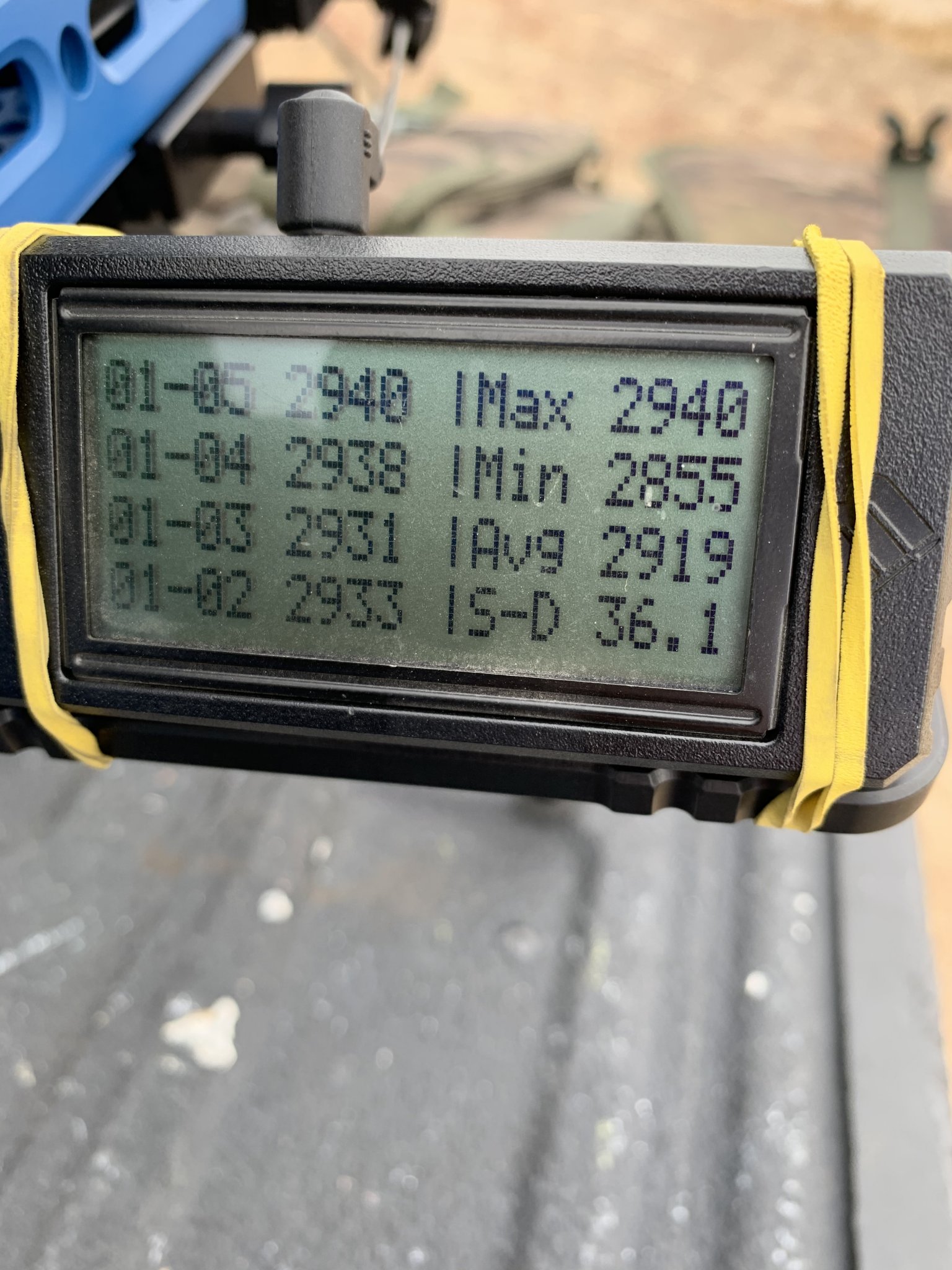

i went out last night again after work but just to check velocities with the H4350 and the numbers are right where they should be nothing odd but again its only 4 rounds
i shot 36.1 first and 36 last
