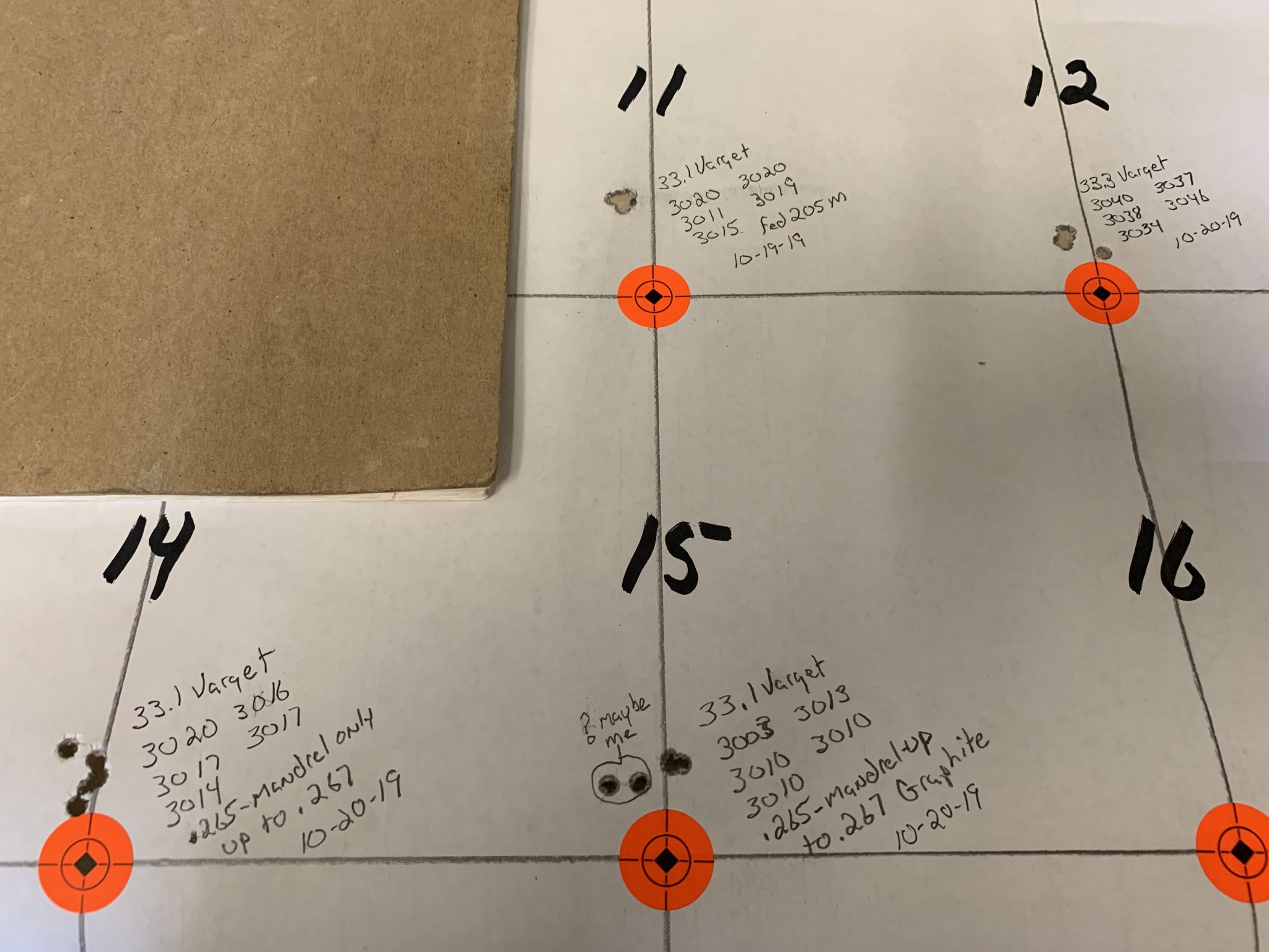

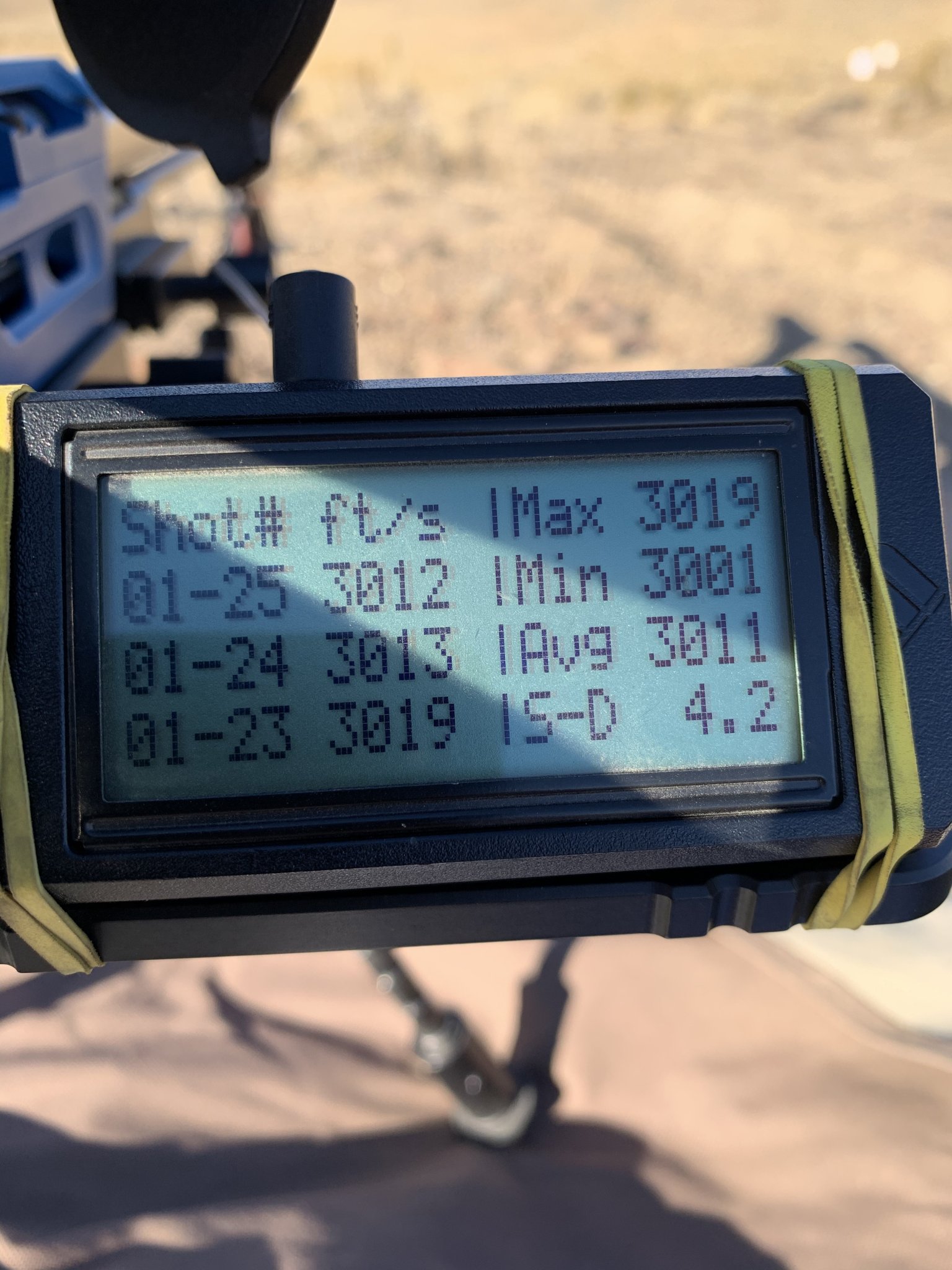

i went out twice today and all the numbers look good...at this point i am pretty sure that just reducing the neck size is the fix for me.
this is a 6BRX using Peterson 6BR brass and a 108g berger BTT...
1 thru 3 is H4350 CCI450 and were seated .015 off the lands
4 thru 7 is varget CCI450 and .015 off the lands
8 thru 11 is varget FED205M and seated .025 off the lands
i dont think the primer swap the second time out was the biggest factor in the tighter groups the seating change was....ive shot a lot of 108s and always end up .020-.025 off.
i have 10 rounds loaded for tomorrow with the 33.1g varget load that i sized to .0265 and used a mandrel to size back up to .267...i did not use the dry neck lube because the numbers are good at this point but did use my normal one shot on the inside necks...ive also got 30 loaded with 33.1g using just a .267 bushing...ill shoot all of these over the magneto speed tomorrow and see how the ESs and SDs go.

first let me apologize for jackin the OPs thread...we seemed to be having the same issue and i planed to figure it out and am 99% sure i have and hope it helps you out.
i went out this morning and shot the 33.3g load to make sure 33.1 was not right on the edge...it was loaded with .267 bushing only.
i also shot 33.1 that i size to .265 then back up to .267 with a mandrel only and 33.1 i sized to .265 then back up to .267 using a mandrel and the dry lube.
the 25 round pic is with a .267 bushing no mandrel or expander.
also when seating....
with just the bushing the bullets seat smooth with very little felt tension
with sizing down then back up with the mandrel even with the graphite there is slightly more felt tension...my thoughts are that the mandrel leaves the inside of the neck more even which in turn creates more of an even/concentric surface which seems like a good thing to me.
so my thoughts are that the dry lube does make a difference...its shows in the numbers..and im pretty sure the more you use it the better the results as it gets worked into the brass more...i also think that just reducing the neck size fixed my issue as it also shows in the numbers...i was getting ESs up to around 40FPS(and groups in the 1"ish range)with larger samples when annealing every time with a .002 neck size.
im going to play with the mandrel and dry lube more because my necks get dented and while they obviously shoot good it just bugs me and if i shoot a shitty group ill be blaming the outta round necks LOL!!
the one outta the group on #12 was the 5th shot and was me...i called it right as the trigger broke.
