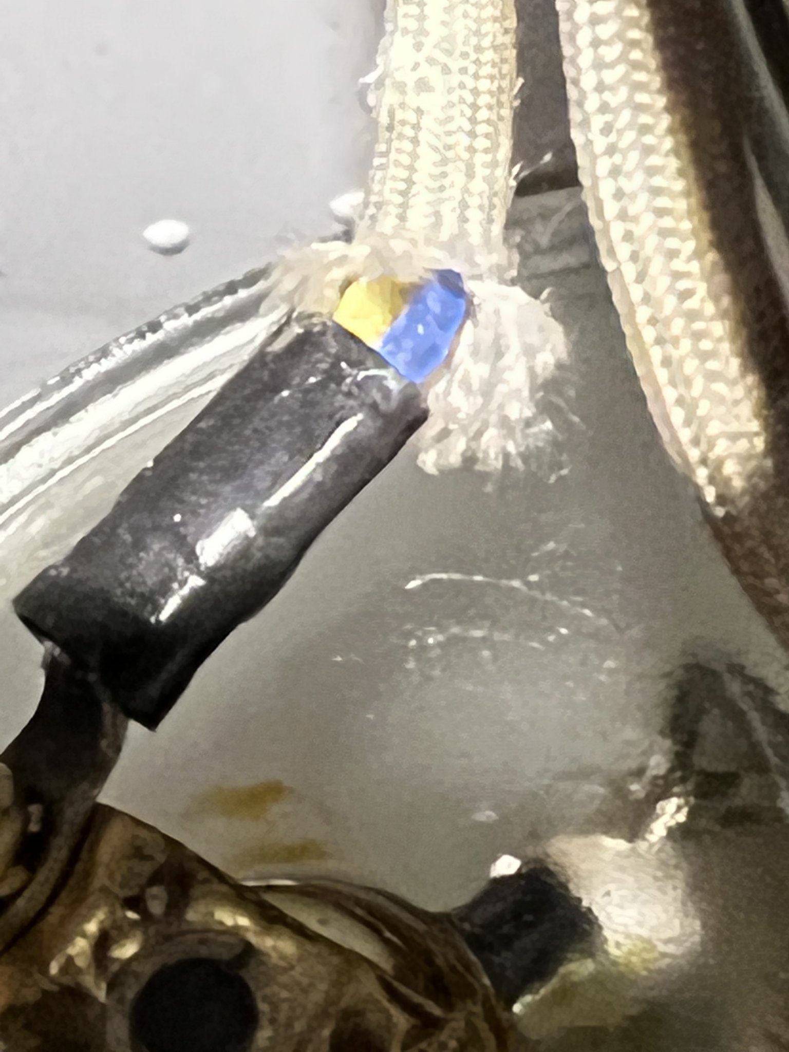

Landing light quit working in protest today on German aircraft, but is showing support for Ukraine.

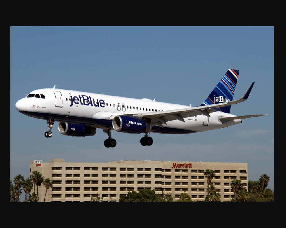

Polishing a turd. The whole thing is garbage and it is doubtful that it does as advertised (saving fuel).
Winglets? They save fuel. On normally blocked flights. When you get into catch up mode on daily flying they don't save fuel. Flying faster than designed means they're not going to save fuel.
I never worked on this type of winglet. I worked on 1900D's, A320' and B737-600/700/800/900's that all had winglets. At ATS I worked on the Scimitar winglet program doing line maintenance on the 737-800/900's. Swapping winglets on and off and swapping icing (simulated) leading edges on and off. The Scimitar winglet has the upper and lower fins. Interesting, the A320 winglets provide no energy recovery. They just enhance directional stability.
Stay the fuck away from Tamaracks on CJs...like I said upthread, they malfunctioned, upset the aircraft, and killed my former boss.
They ain't APIs on a Boeing or Hawker...
Tamaracks really don't save fuel on a CJ2+ or CJ3 anyway...they go right from sea level/MTOW to service ceiling in <25min, and 5 minutes later you're pulling the power out of the CRZ detent so you don't overspeed. Really, really hard to improve upon that. For a straight CitationJet, making FL410 usable could save gas but again - is it worth the risk?
Winglets? They save fuel. On normally blocked flights. When you get into catch up mode on daily flying they don't save fuel. Flying faster than designed means they not going to save fuel.
I beg to differ on the a320 winglets (actually called sharklets). There is a measurable performance difference between a classic 320 and a winglet 320. It climbs better. Can reach higher altitudes at heavier weights. Burns less and most importantly to me the safety margin between Vls and Vne is much larger (often called the coffin corner). In a classic at Fl 360 tHis corner is usually about 10-15 kts, with the winglet it’s like 20-25.
I meant the sharklets not recovering energy. The winglets do.
Does the 321 climb better with wingsharklets?

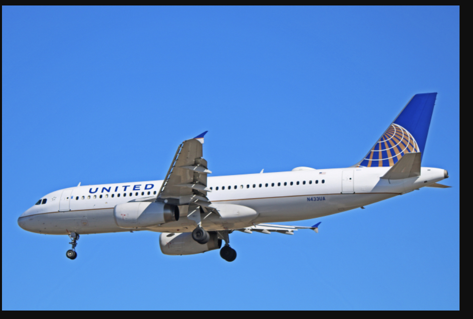

Just so we are clear, the standard a320 doesn’t have winglets. They have what I believe airbus calls gates. The sharklet’s are winglets like on any Boeing. For whatever reason airbus calls them Sharklets.
and yes, the gates are useless. Purely for looks
I never worked on a 320 without sharklets. Didn't know they didn't have them to start with. I have seen the APB winglets (like 737) on the Airbus A320 family. I thought that was what you meant. I never worked on those.
The 'gates' (fences?) may have been what was referred to when speaking of helping tracking.
They don’t even make them anymore without the sharklet. My airline actually developed the STC to have the old ones retrofitted. Went through all the testing and then never did it. We only have like 5 or 6 320’s with the sharklet. The rest are the original classic with the fence (as @BoilerUP corrected me to proper nomenclature). All our 321’s have the sharklets.

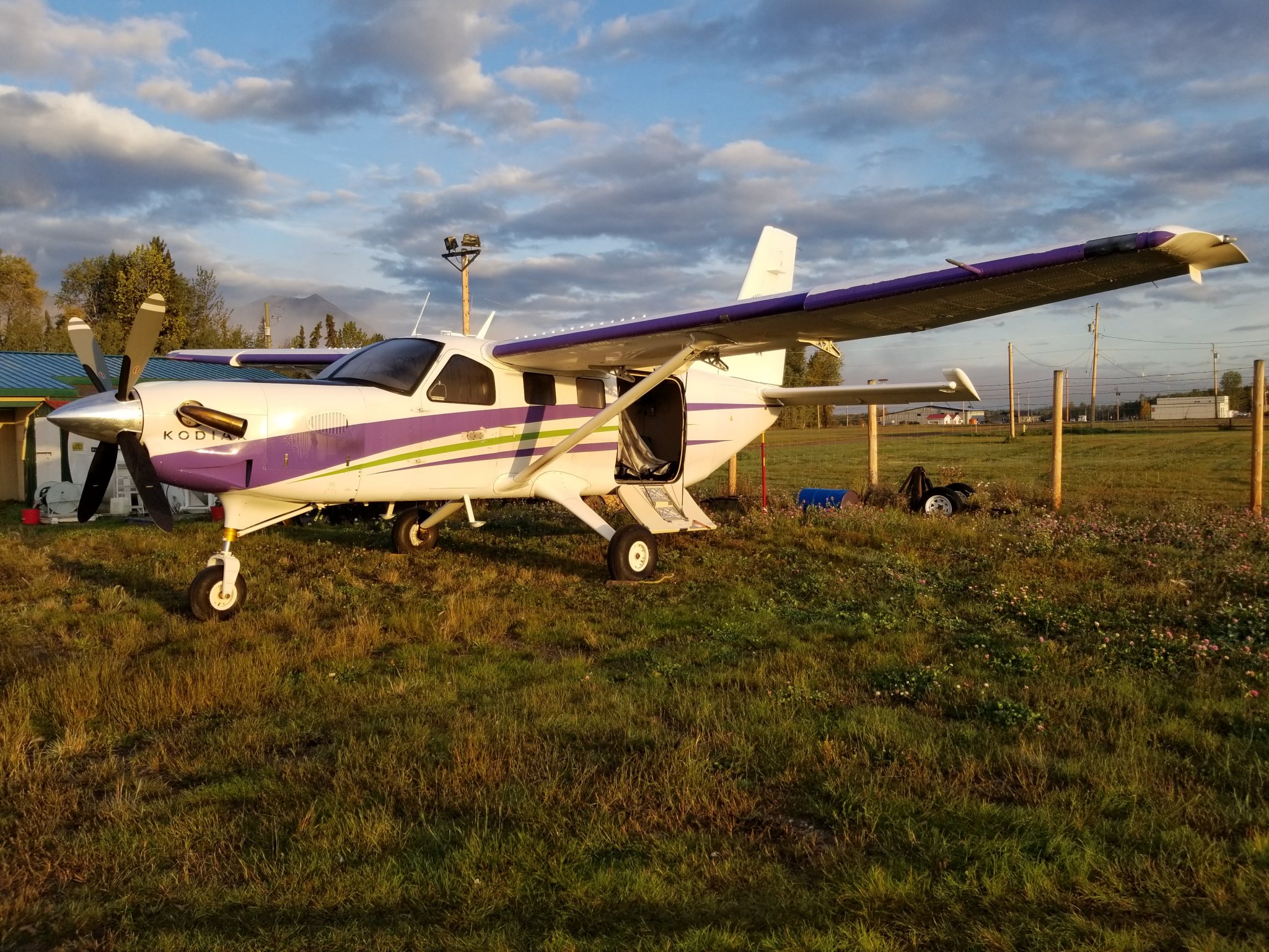

This was my favourite. Just a great airplane and American made! Made short work of a lot of bush strips.
Got typed for CL-65 last fall then laid off again. Just passed my commercial conversion exam last week to turn my commie TC license into an FAA. IFR conversion this week hopefully! View attachment 7827530View attachment 7827527
I lived in Sandpoint for most of five years. I gotta see them a lot. I toured the factory and got the impromptu tour of the maintenance side. The only guy I remember was Larry, the chief/chief test pilot. The aircraft concept is amazing. And, very well built!
