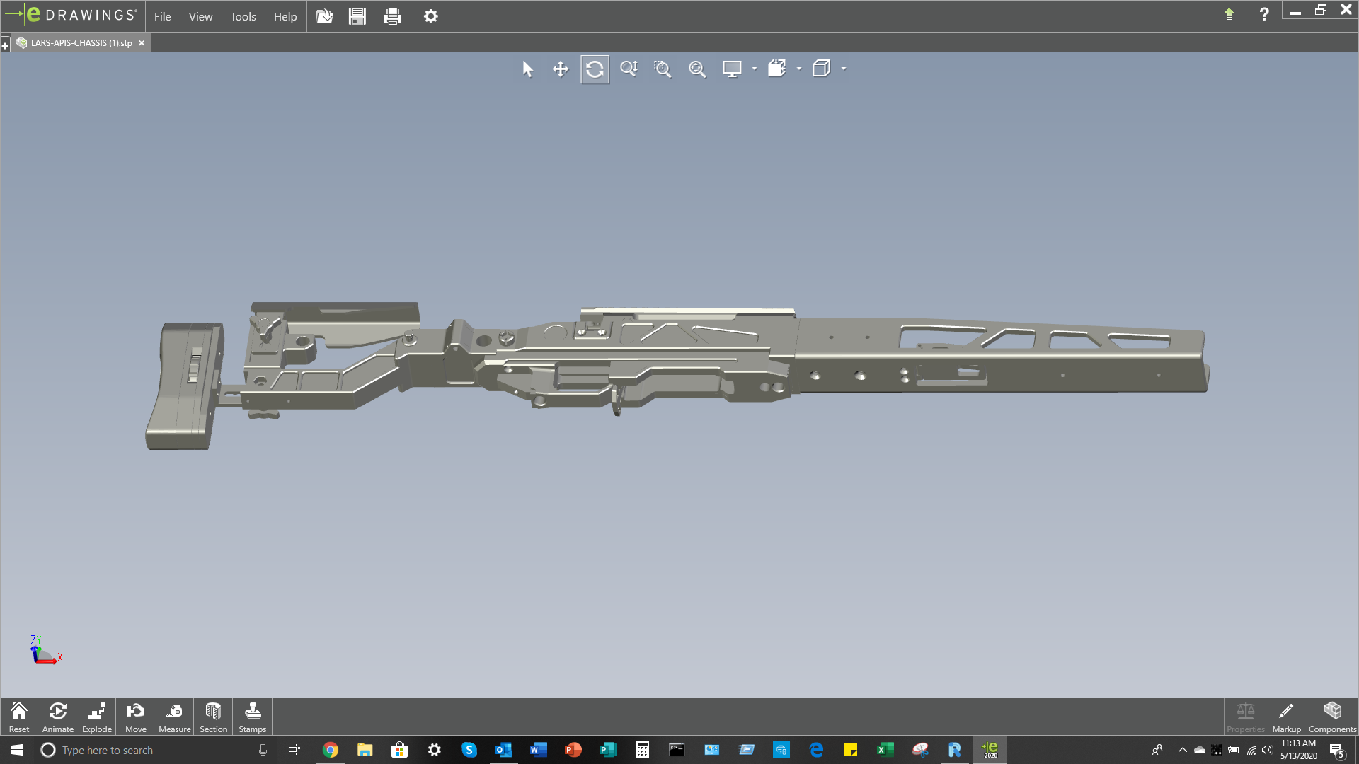

Isn't the dogleg in the butt-plate extension going to act as a cantilever and promote muzzle flip at the shot?
Hi,
I suppose if you lowered the recoil pad to its' lowest setting in which would put the rear section of the chassis significantly above your shoulder then the rifle may be induced to flip.
But being the recoil pad is adjustable in not only vertical adjustment but horizontally angled also..it is quiet easy to get proper alignment without inducing rifle flip.
Sincerely,
Theis

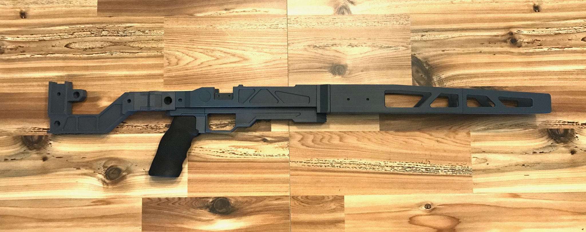

all joking aside i like the edges/joints/creases on stocks or chassis
i find it easier to find the exact same position of my fingers and such by remembering what angle is where...might just be me though

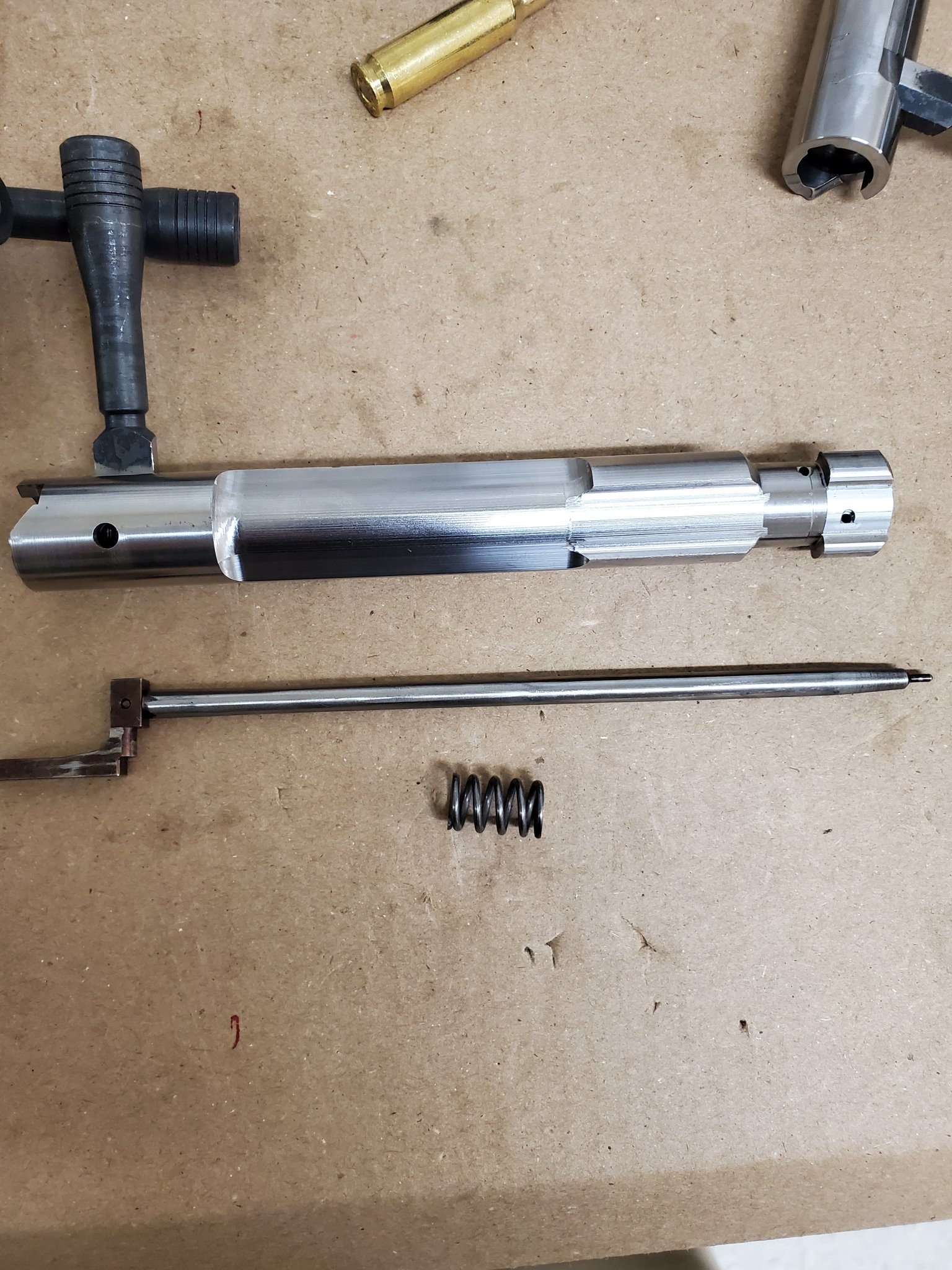

So in the continuation of T&E phases we have ultimately decided on the following firing pin specifications for the Kopis and Aspis Models...
.062" firing pin tip with a .063 firing pin hole in boltface.

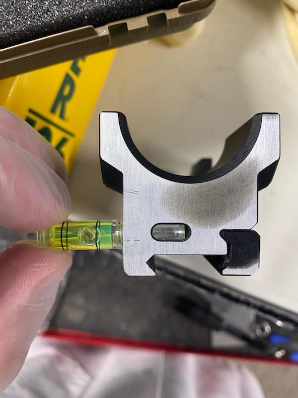

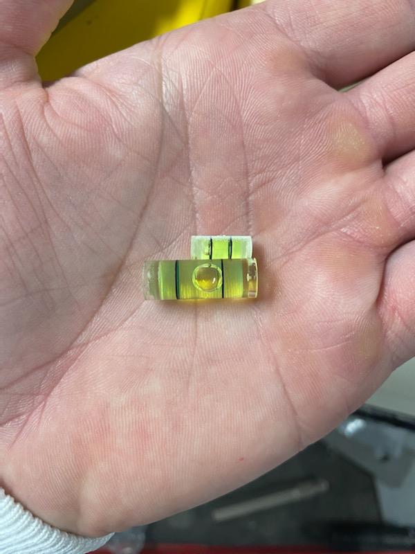

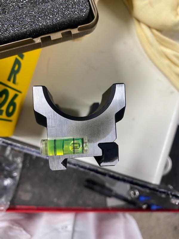

Also been messing around with larger level in the scope mounts...
my current rifles have large firing pin so im out of the loop on SFP (thats why i started a thread a while ago)
is .062 pin and .063 pin hole enough clearance for dirt and debris??

We utilize a Lesjofors #6086 spring for our firing pin spring. The #6086 operates at 151 Newton Meters (111 ft/lbs) spring force {We also have a 125 ft/lbs version of the Lesjofors spring}. So we purposely have the spring force to pretty much self clear any dirt/debris. Along with the way the firing pin system itself rides in the bolt via bayonet and rear bushing in the bolt it pretty much keeps the firing pin centered.

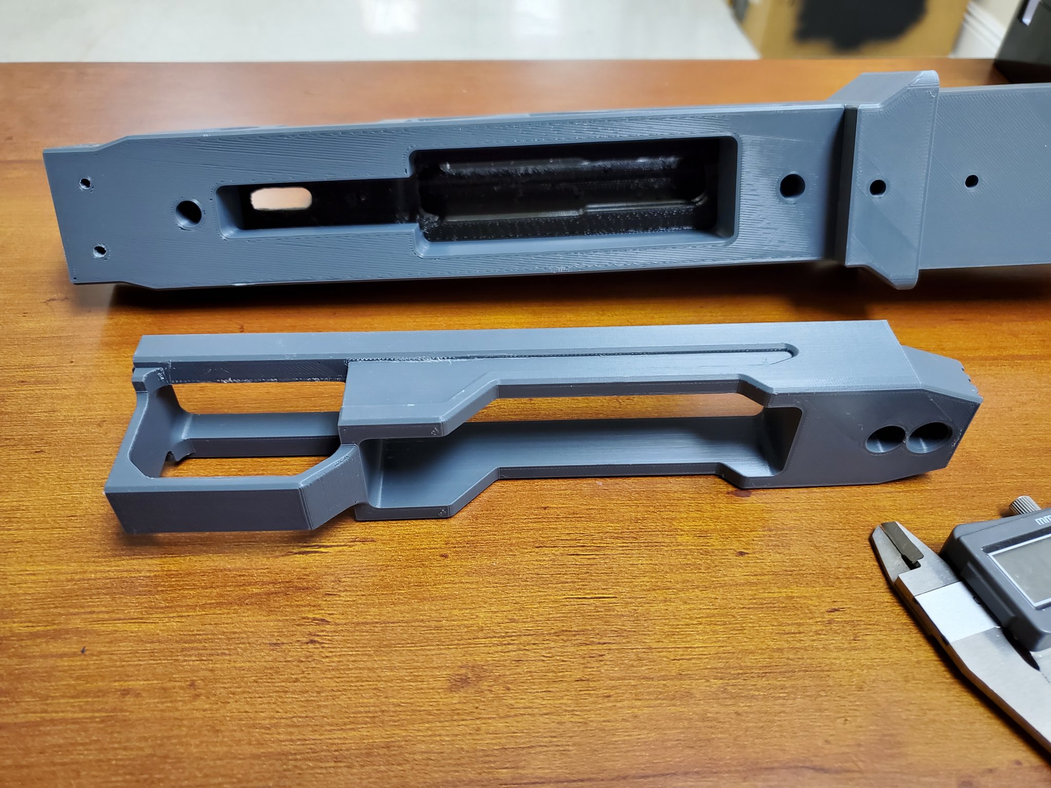

Now on the bright side....the new chassis design will allow us to bond/glue the action into it and still allow us to access/remove the trigger without having to take action out of chassis.

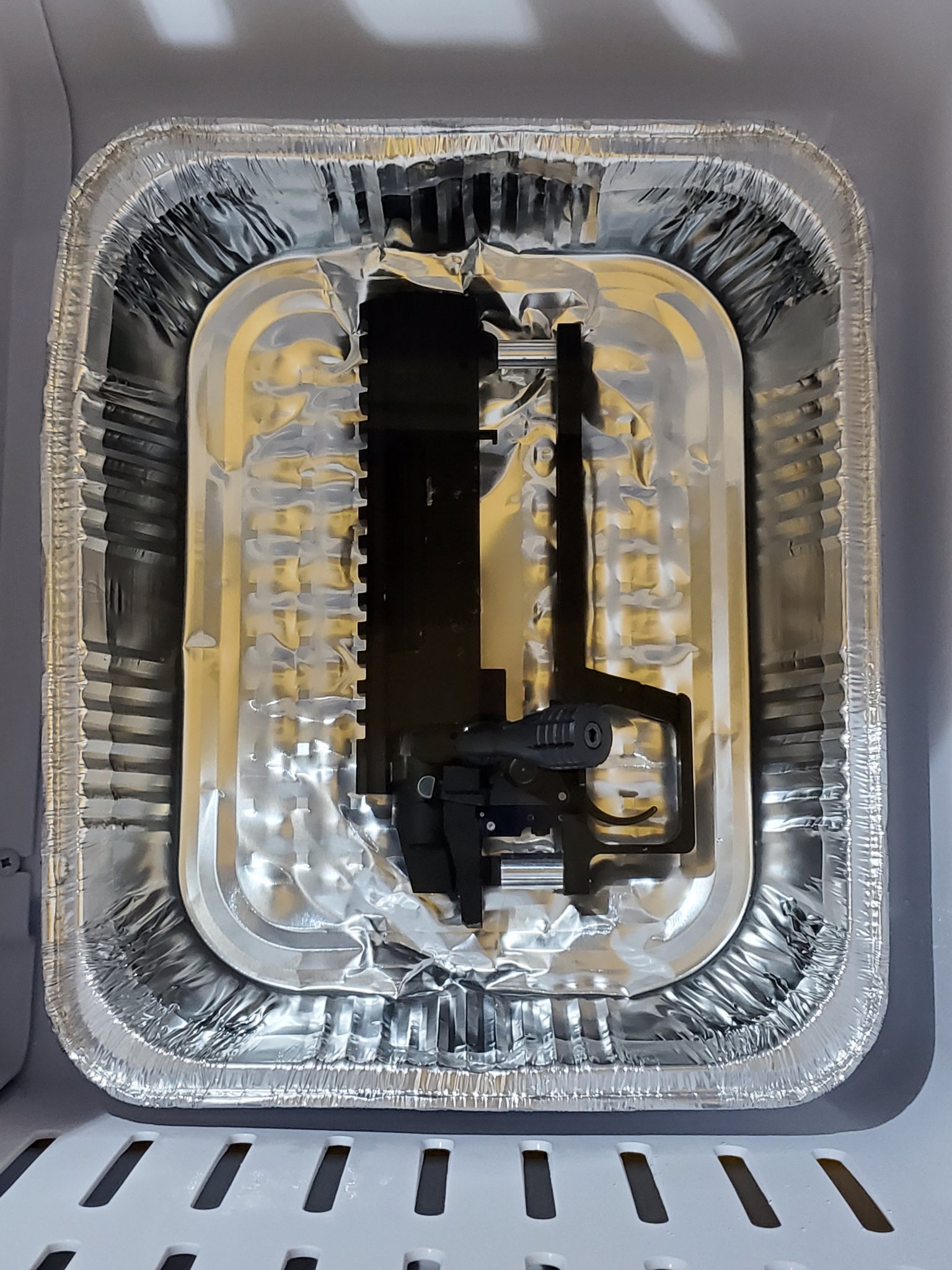

Might be time ti get a voulenteered/conscripted/shangheid chassis and put the two through a frozen test to see if you can get the bolt to cycle and hammer to drop in a simulated freezing mist/wind. More leverage that way to hole the action while cycling.

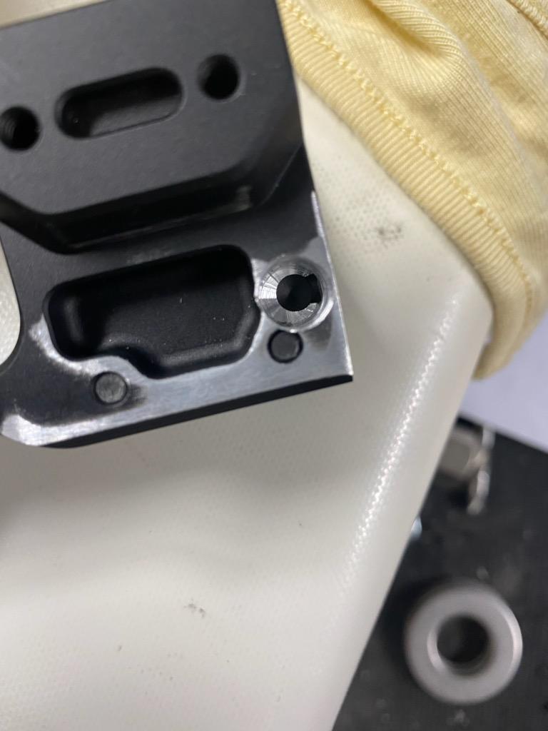

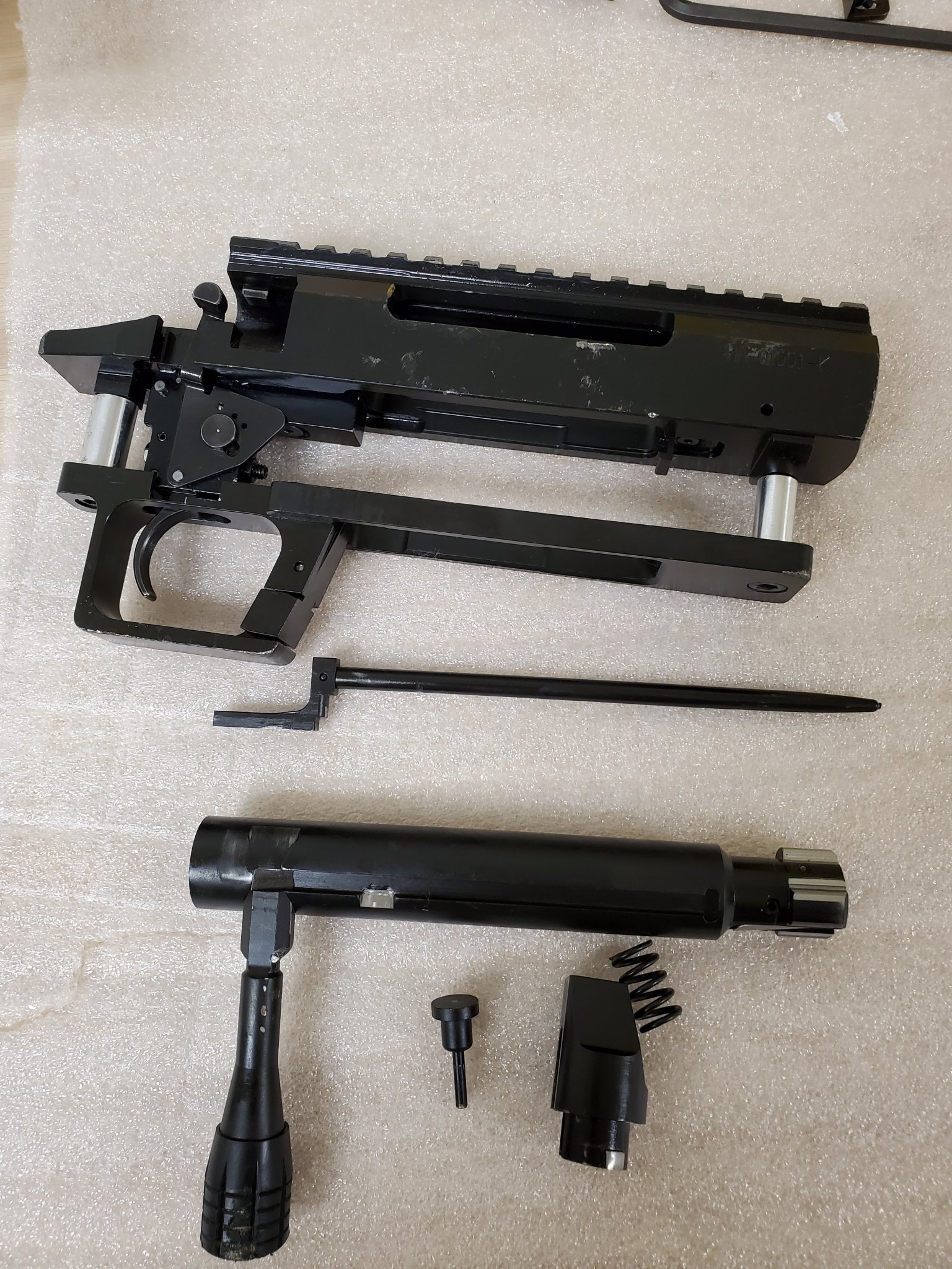

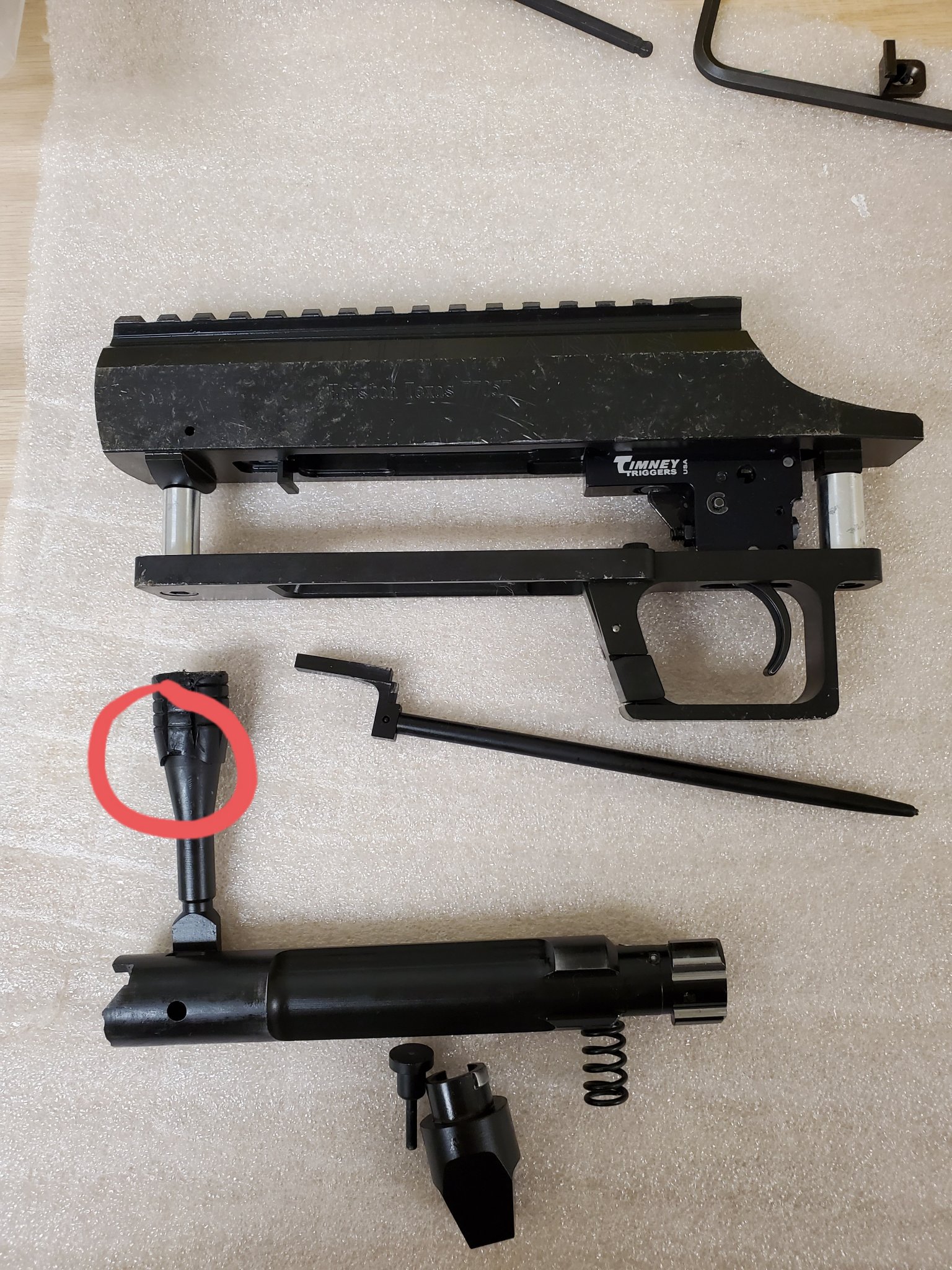

Well it is not looking good for the ol recruit!! This morning during a scheduled wellness check, the Doc found the first crack in its' armor...think the ol gal may be close to a DOR.
Doc found a chip on the delrin bolt knob cover.
Next evolution is the mud pit, so we shall see what happens......
Edited To Add: That is a firing pin from Shot Show so the tip was ground down to be in expo compliance.

Theis, what finish is on, or now *partially* on, the poor test subject/recruit? I may have missed it but saw earlier you had settled on some of Birdsong’s coatings.
Hi,
That receiver is one of the original birdsong coated ones.

This gun has my attention. It has several features i always wonder why weren't on rifles. The flat bottom being the main one. Also the firing pin that can't stay out love it. It definitely function over form though, to say the least.
