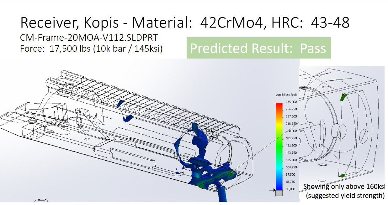

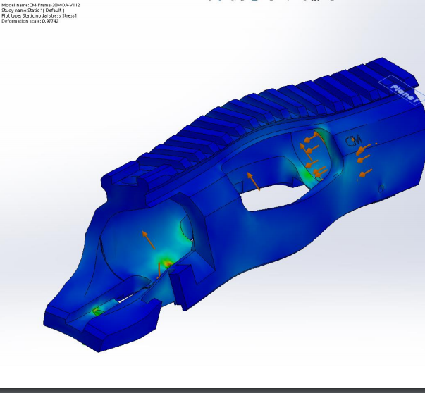

So while we are busy running all different FEA simulations....
Here is the receiver body with 145k PSI (Real pressure, not cartridge pressure) put on it as a single plane static model stress.
The deformation is an exaggeration of the software. Scale is in top left corner.
Sincerely,
Theis

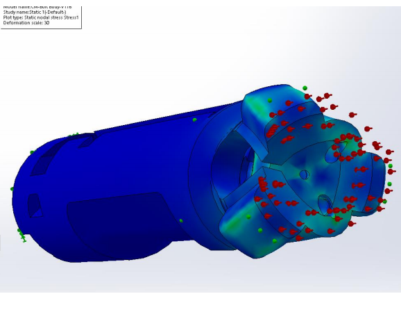

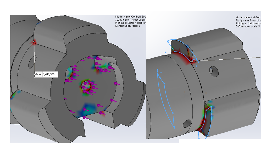

Hi,
We suggest that nobody let anything much larger than an M1 Abrams run over their Hoplite Arms bolt, lolol
Here is the bolt with 145k PSI (Real pressure, not cartridge pressure) put on the entire front area as a single plane static model stress.
Sincerely,
Theis
Hi,
Sincerely,
Theis
You're ruining all my T&E ideas here
@THEIS not understanding FEA what color would represent going out of the elastic deformation range? Or even better what colors correspond with different points on the tensile strain graph for the material? (can't remember what that thing is called).
If I remember single plane static stress transposed to a rifle rifle action would be like taking shaft the size of the bolt face (I’m guessing this is a regular short action sized bolt face 308 win) and pressing 145000psi strait down its throat.
On one linear direction, no expansion
So quick math .473” bolt face has about .178 square inches of surface area.
.178 x 145000 = 25800 pounds of force more or less.
So pretty much it looks like the bolt and receiver can handle a SHIT ton of pressure and still not fail (i don’t see any deep red colors which would usually mean material failure) or in a action catastrophic events.
Since this is a static model and doesn’t seem to have any dynamic stress or “shock” like a rifle action would when firing.
With all the dark blue throughout it pretty much means the action laughed at it.
Only stress points at the bolt lugs and even they look to not permanently deform (again if I remember the color scales). Which I would expect because they take the brunt of the reward force.
That’s ridiculously strong.
Pile up a couple of pick up trucks on a 1/2” shaft ...balance that on the bolt face and this action laughs at it.
Reactions: Slowroll and lash

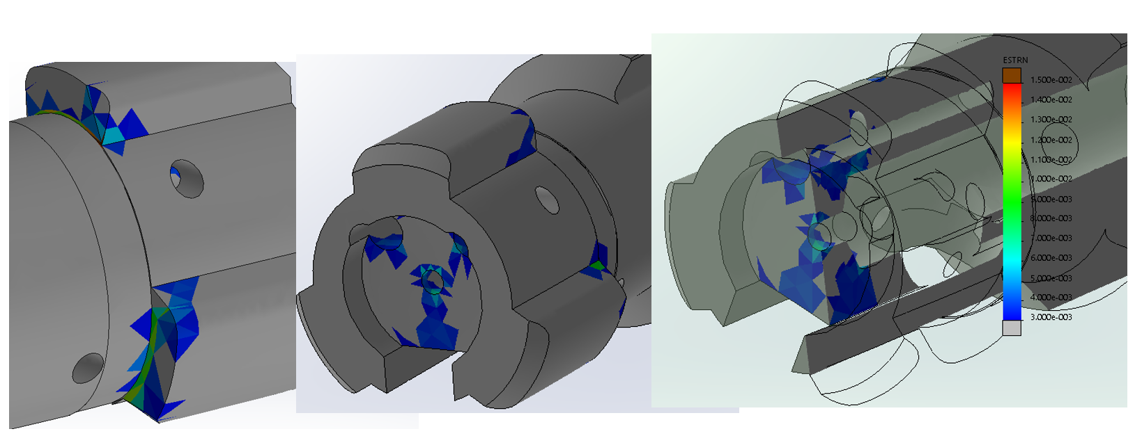

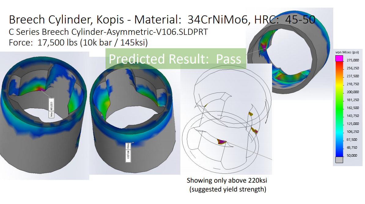

Hi,
So we are running and running and running some more, lolol....
The below bolt pic is from running predicted cartridge pressure of 10k bar (145,037psi).
Kopis Bolt Strain Plot
Sincerely,
Theis
How's it feel when your creation laughs at you Theis?? It's currently saying, "That's all you got, gimme more!!" Awesome to see it holding up so well
Reactions: lash
I’m guessing..
Gray is almost untouched / way below max
Blue/green is showing up on the scale
Orange/ red would be getting up there (I don’t see any)
Looks like the last set, those pressures aren’t even waking it up from its nap.
Correct me if I read the scale wrong.

Hi,
Thanks!!
Luckily (or unlucky, depending on how you view it, lol) for us there is not a cartridge case that can function at 145k pressures; so for right now that pressure is off limits in regards to operating pressures, hahahaha....not to mention you damn sure do not want that recoil very much.

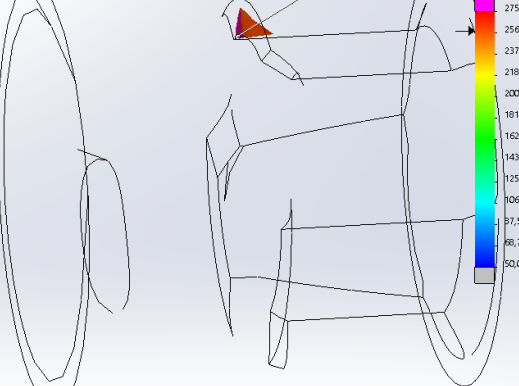

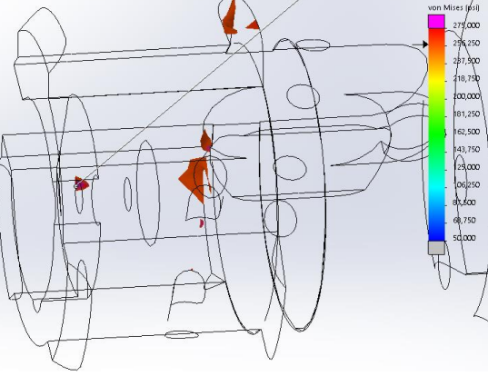

Hi,
Pretty much and now for something we do not hardly ever see in the firearms industry......a company showing the "Red", lol
Here is the Kopis Bolt Stress Plot at 10k bar cartridge pressures. The red areas are above 200KSI from such cartridge pressures.
Sincerely,
Theis

With that kind of ceiling it should run those 80-90k high pressure cartridges no problem, the conventional chamberings would barely be a warm up. Very well done

So it looks like 256,250 psi. Is that the failure threshold? If so, 3 x safety margin over 85K, assuming FEA pressure closley correlates to actual chamber pressure.
