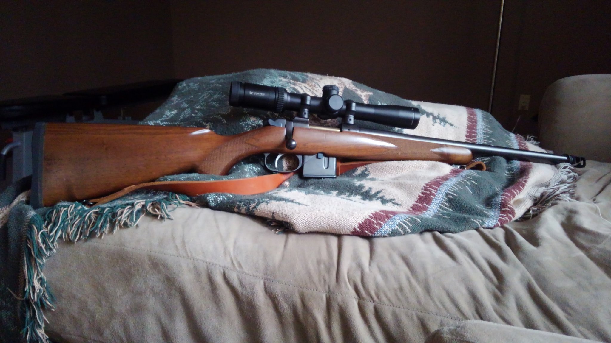

My little CZ527 Rust/Nitre blue project is in 6 ARC. 8.4lb as pictured. It's a handy little thing. I've made it out to 600yd so far and it's very capable. The intent is a 0-300yd hunting rifle. Bartlein #4 contour (shank buzzed down to fit the action) 4140 5r barrel. Rifle was originally a 7.62x39 carbine.
I would buy this in a heartbeat if CZ started offering it as a chambering.

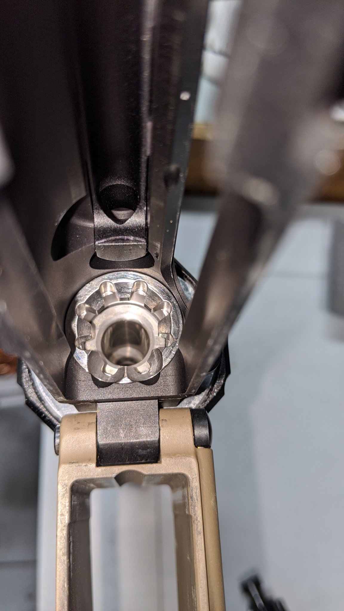

I’m going to tell you that you need a 6.5Grendal barrel extension. The standard AR15 barrel extension the feed ramp bolt notches are too tight (not wide enough). Brady had issues with it beating up the bullet tips (accuracy was still excellent). Something to think about.
Picture attached of what we will say is the proper barrel extension.
