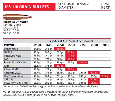

A clear distinction needs to be made with this caliber as to "bolt gun" 62ksi loads and "Gas gun" 52ksi loads. Current published load data is only at 52ksi max for the sake of AR-15s' bolts.
You'll see a few powders make 2825-2875, maybe even edge in on 2900fps with the 105-110gr bullets in 24" barrels when 60-62ksi data is published. Figure 20fps per inch and all of a sudden a 28" barrel pushing 2940 doesn't seem so crazy... Because it's not.
Spherical powder. If I loaded it with RL-15, Varget, or H4895 I'd be in the BR ballpark or slower. Nobody wants to use ball powder because they gotta track temps. I let 4DoF handle that part for me.

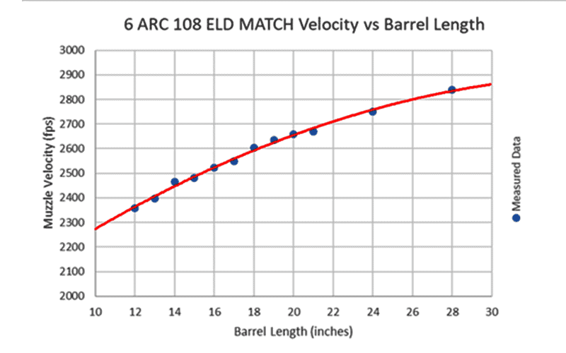

After a cursory glance at a few forums Google provided, I still think my numbers are in line. I think a lot of folks are pushing their luck in AR-15s with 6AR/Turbo/RAT/LBC... lol Nonetheless, the powder charge vs. velocity vs. barrel length all correlate. Hopefully official 60-62ksi data will get published soon.
Another variable is brass and internal capacity. Especially with as small a case as this one it doesn't take much to change internal volume by a significant percentage, and that can really skew pressure and velocity numbers. I should also mention that lot-to-lot consistency on powder can change things considerably.
As far as your 6.5 Grendel w/100gr pills. Take 20-25fps per inch and add 8" of barrel to that. Right off the bat you're 2890-2930. Try a few powders with burn rates faster/slower and maybe one has the right density to fit enough in the case to get you to 2950 in a 28" pipe. Barrel length is always the safest method to get more speed.
18" - 2600 (my 18" AR is 2596 avg)
28"- 2835 (my 28" bolt gun, same ammo, 52ksi)
23fps per inch
Correlates to this chart... like exactly.
I'm about to stop posting about this. If you don't want to believe it, that's cool man. Wait a few months to believe it then.

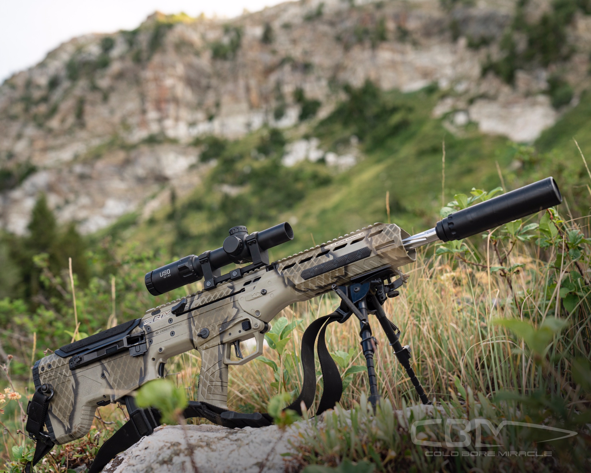

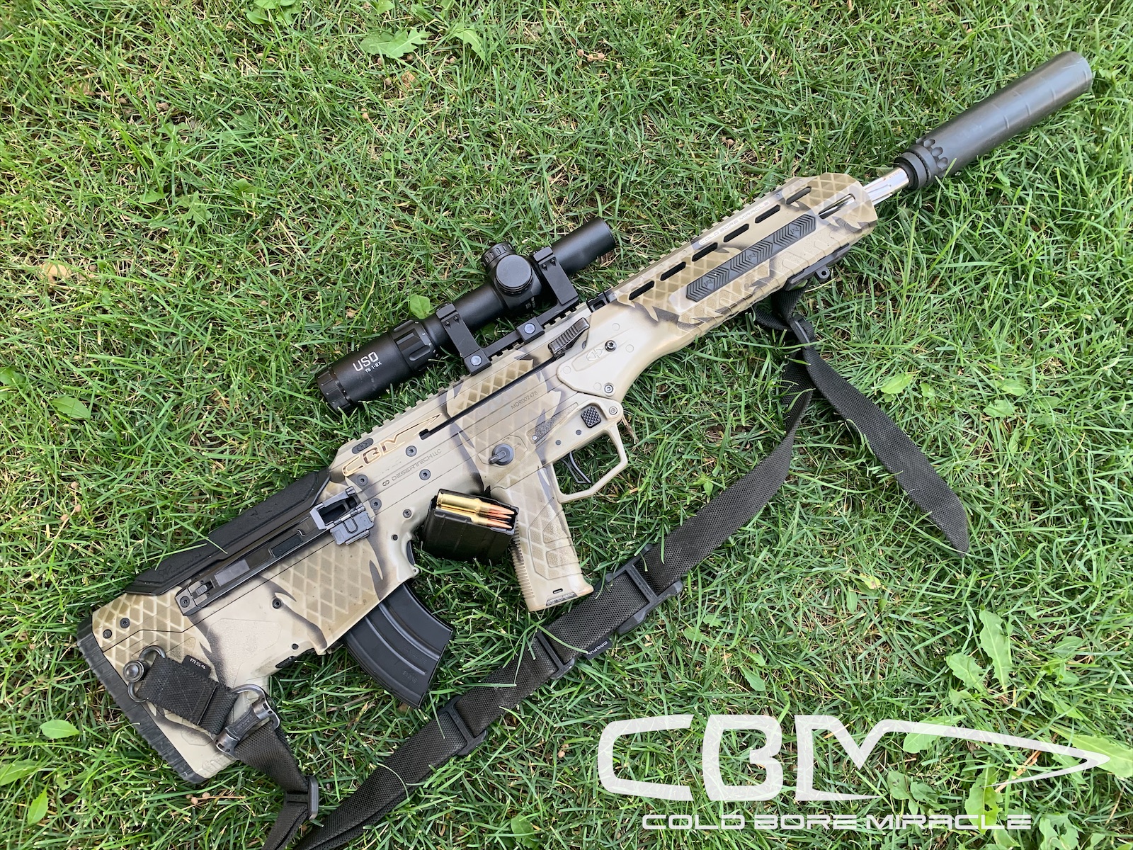

I had ES Tactical build me a conversion kit for my MDR, and it has been a blast. Real easy to load the 105’s and shoots lights out.

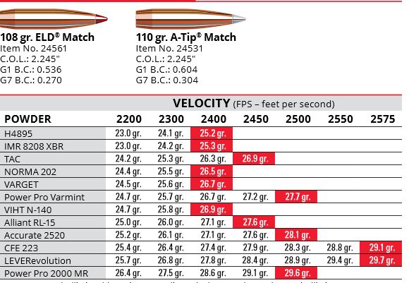

That data is presented by Hornady for a 24" barrel in a bolt gun. He's saying factor 23fps per inch for 4 more inches supports his current velocities of 2950.
