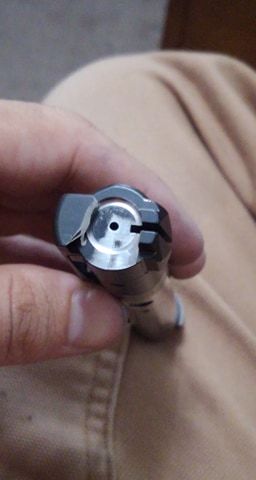

I did a 6 ARC barrel for my Mausingfield. 28" Proof Competition contour, 1:7.5". Had to buy a .223 Bolt face and open it up in the lathe and mill. Filed the extractor to fit. Running MDT BR magazines (no modifications necessary). Feeding has some small bugs to work out, but I'm pretty sure I know what will fix it.

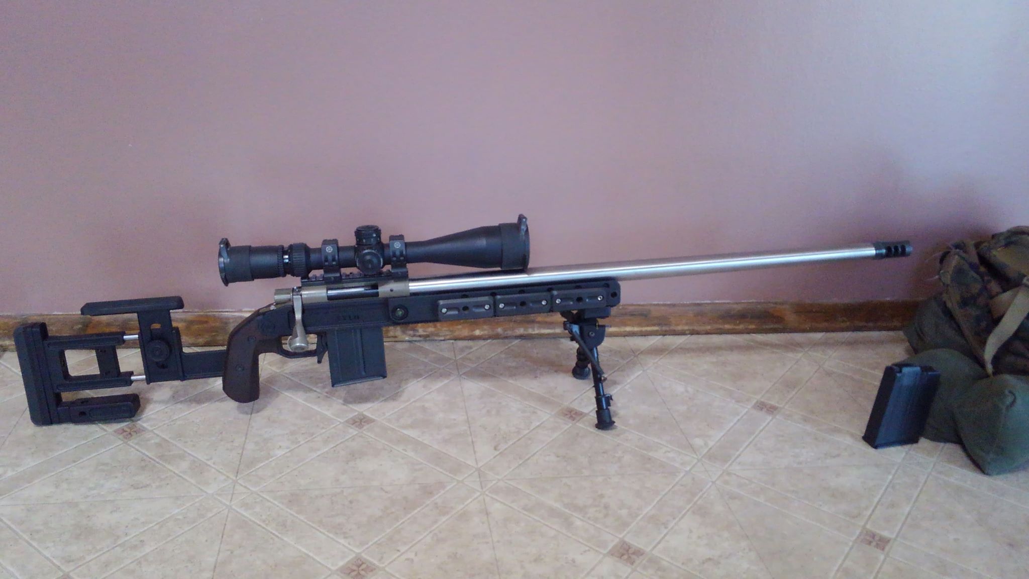

With LeverEvolution running 105-110gr bullets at 2870-2960fps. Definitely warm, but not "spicy". :) Rifle is 23lb as pictured. Feels like a damn 22 magnum for recoil.
