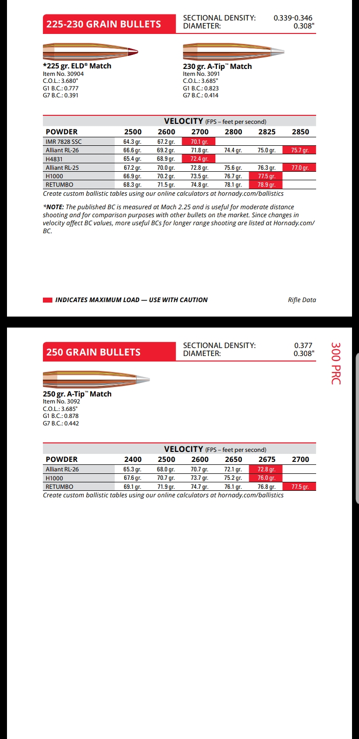

In the 30 caliber magnum category that's pretty impressive numbers for a magazine-feedable bullet (at least it appears to be magazine feedable).
ELD-M 225g @ 2975 fps: 222.8" drop, 10 MPH, 3 o'clock - 45.4" drift
A-TIP 230g @ 2975 fps: 216.0" drop, 10 MPH, 3 o'clock - 41.6" drift
Not too shabby.

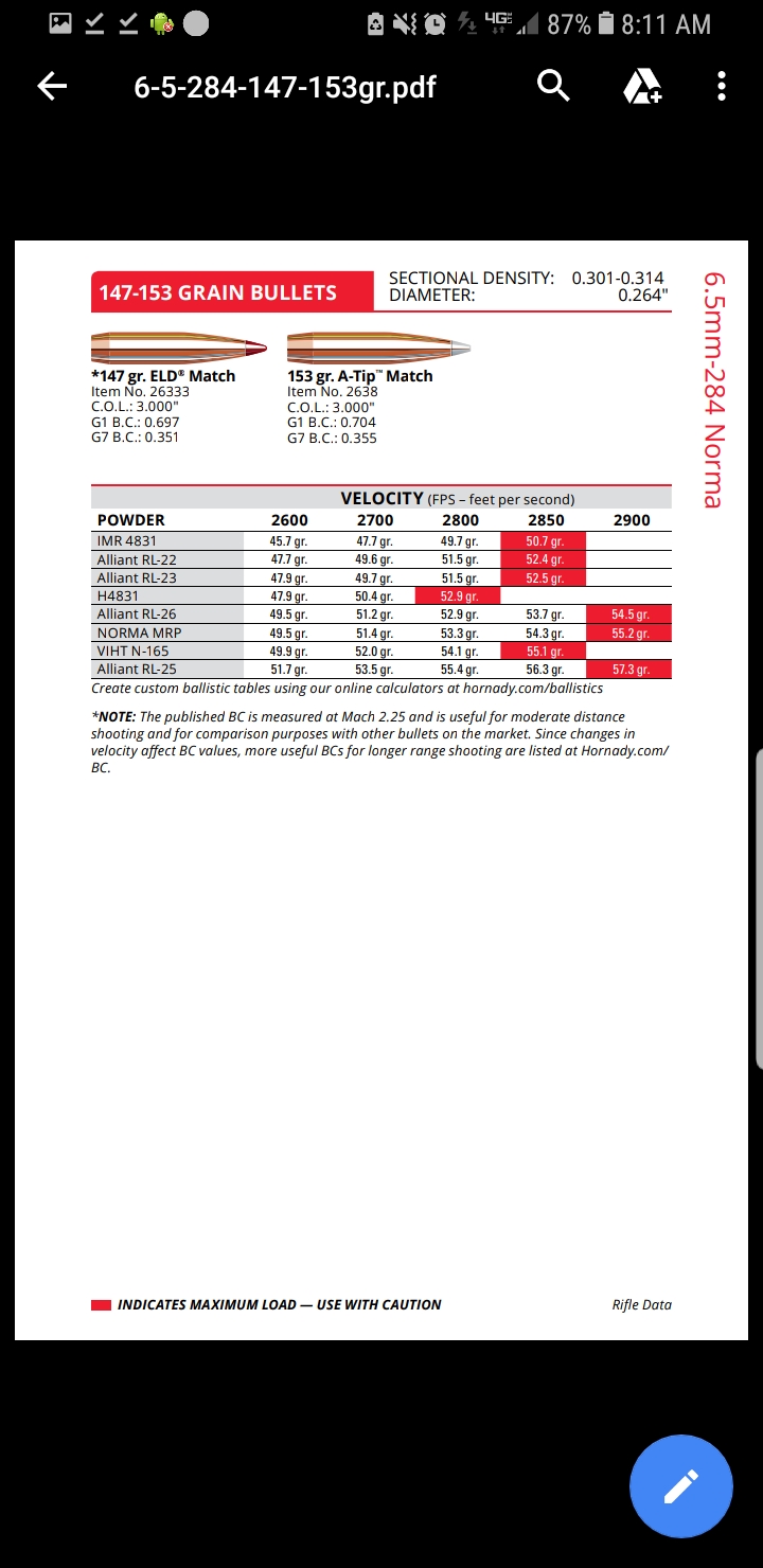

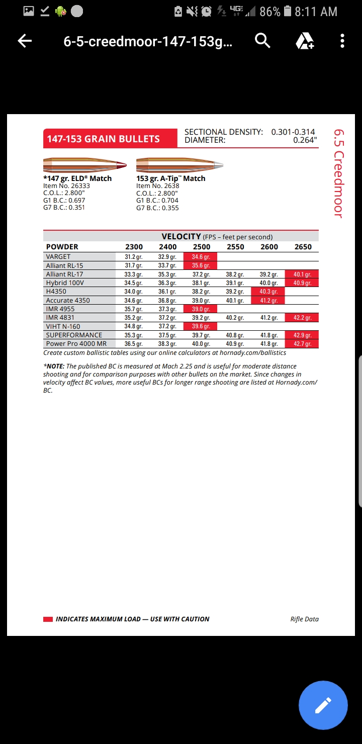

But the great thing is... the 153 does stabilize in a 1 in 8” twist

Both 6.5 a-tips are more than double the price of 147eld cost .27 Cents .697bc
153 almost same bc .75 cent per if they really stay that price can’t afford to shoot them

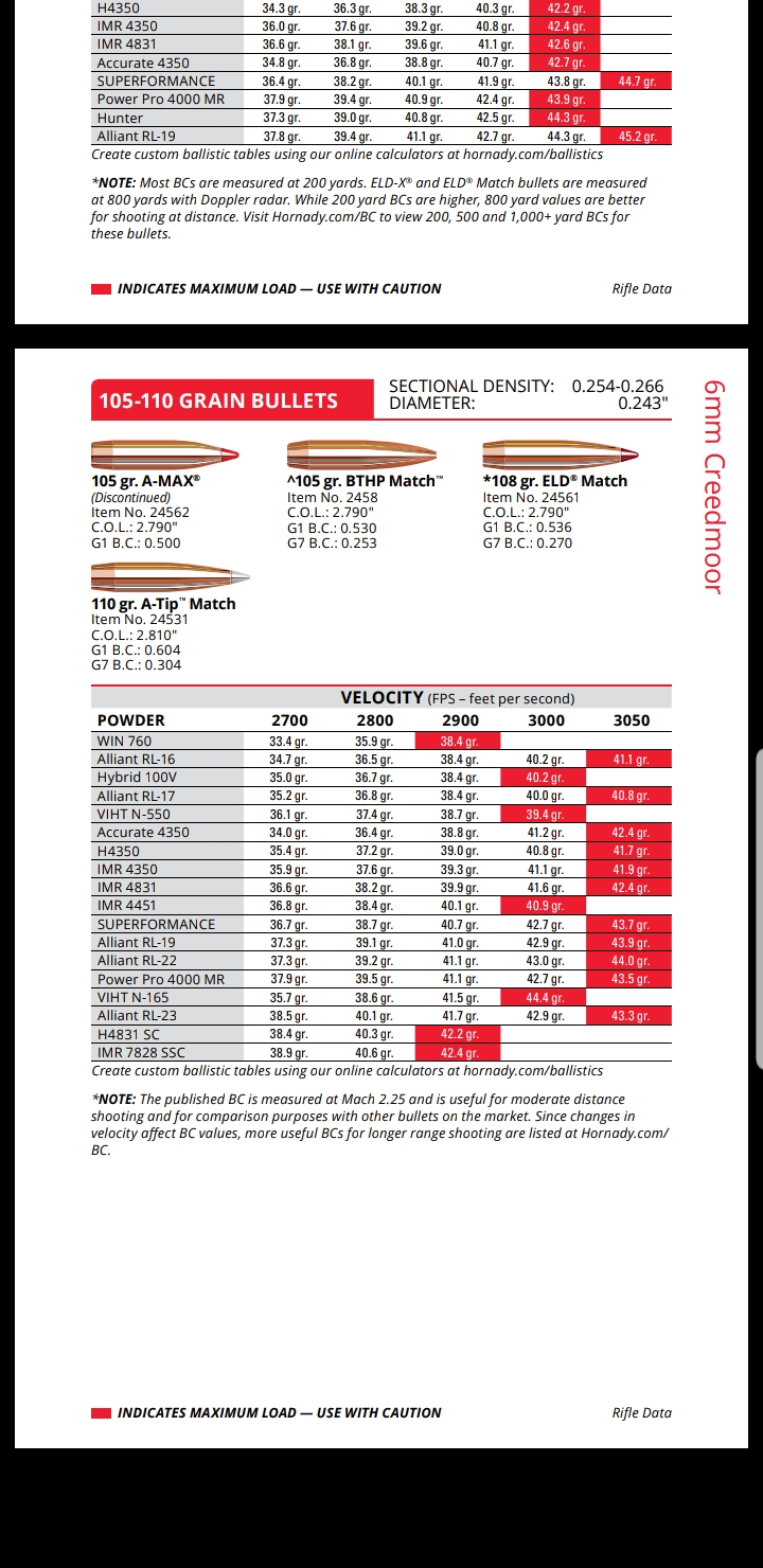

I got excited when I saw the 110gr 6mm bullet, but unfortunately the price will be a little too much for me. I'll probably pick up a box or two to test with, but the main issue for me is that on a budget I can't afford to spend twice as much money on the projectiles as I have in the past. At 250 rounds per PRS match I'd be looking at ~$190-200 in bullets alone instead of ~$150 for all of the ammo - bullets, primers, and powder combined.
