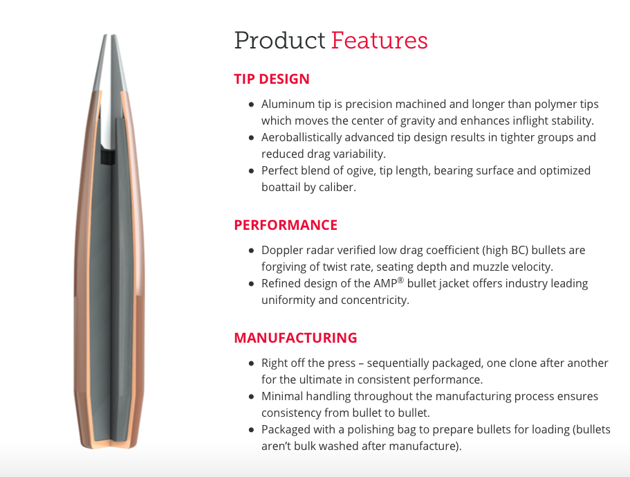

If keeping the center of gravity further back leads to better accuracy and easier loading, and the AL tip let's you do that while improving BC, thats pretty slick.
I think you have this backward. The center of mass is moved forward since the aluminum is more dense than the plastic or hollow tip and it's also longer than their plastic tips. This results in a better BC based on better bullet stability in flight.
It said in the video that the CG was moved backward. Yes aluminum is more dense than polymer, but way less than lead, and it sounds like they used the Al to make the tip bigger in these.
I knew they were working on an ATip but damn. I've known many of the people at Hornady for many years. All smart guys but kudos go to Steve and Jason Hornady for providing the resources needed and turning these guys loose. For as long as I've known them the atmosphere at Hornady is one of innovation. My hats off to them.
Wonder how different the aluminum tip is in these than the browning bxc aluminum tips. Probably more to do with what is under the tip but those expand well.
The bxc i have for my 300wsm are nice but its a blunt nose aluminum tip with a shitty bc designed to punch through heavy bone and muscle, I don't think these A-tip compare well. Kinda apples and oranges.
Edit: I watched the 17 minute video and these sound like they designed them for prs and matches, where as the Browning bxc is a hunting bullet and the aluminum tip on those is what helps push the nose of the bullet in and expand. I'd be curious those if they've tested these a-tip on game and how they performed.
I remember talking with a very knowledgeable gentleman about a year ago that mentioned some incredible things on the horizon in the area of bullet development(y)
Nothing for us 308 folks for now i guess. At the price i will stick with the ELD-Ms for now anyway even if i could buy them in 168-175. I was buying 168 ELD-Ms from bigdaddyunlimited for 26 bucks a box of 100.
Right.. my meaning was simply that the aluminum tip itself doesn’t necessarily mean it won’t perform on game, it’s likely what’s under that tip that will determine that.
That makes perfect sense to me. The ATips are purpose built for distance and speed.
I haven't asked the question yet but unless the ATips have a thick jacket, which I'm sure they don't, the aluminum tip would facilitate rapid expansion. Probably to the point that Hornady couldn't recommend them as a hunting bullet.
