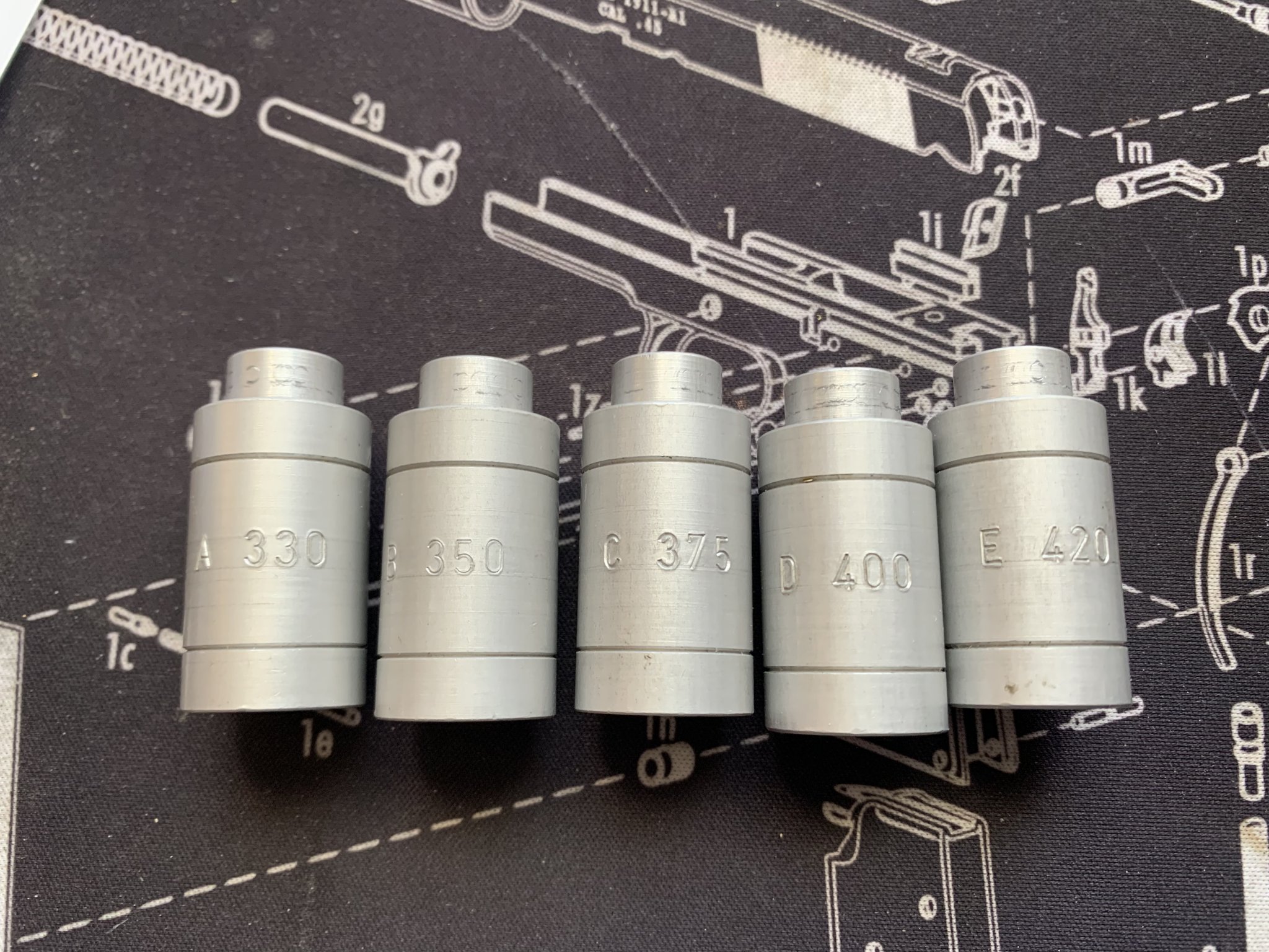

Not sure what the .375 comp is, it's the standard Hornady.

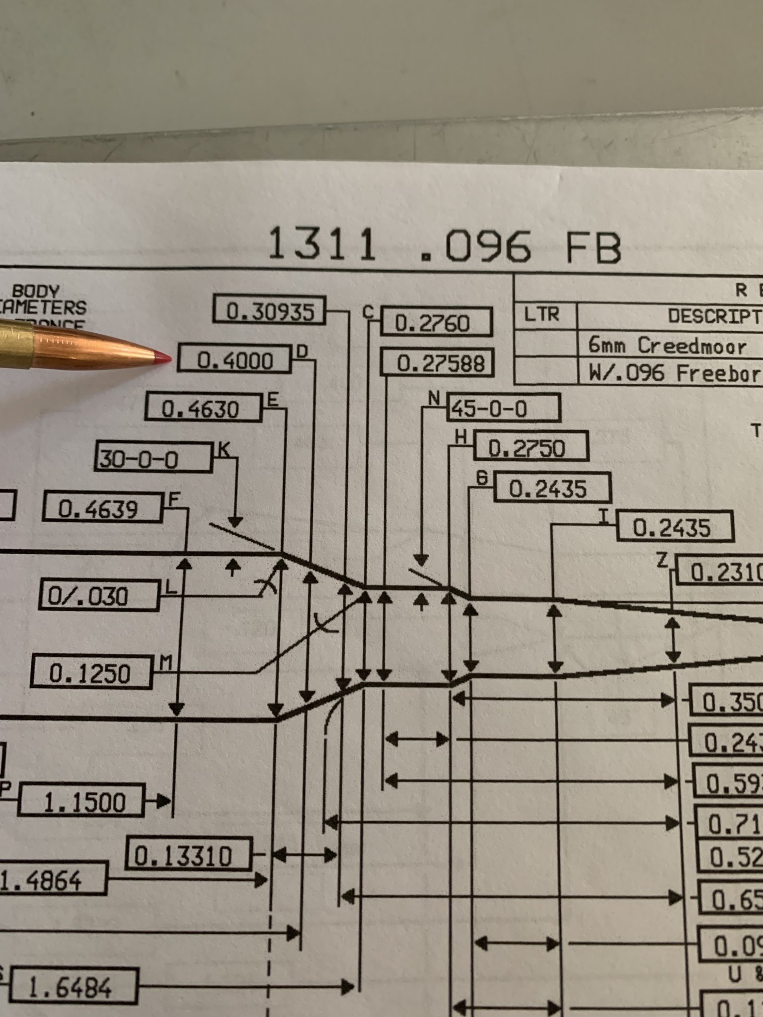

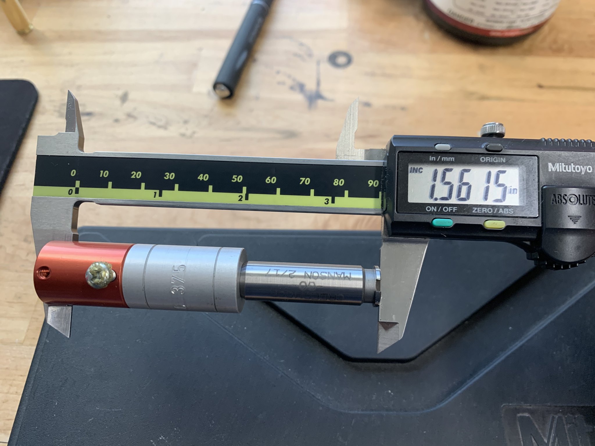

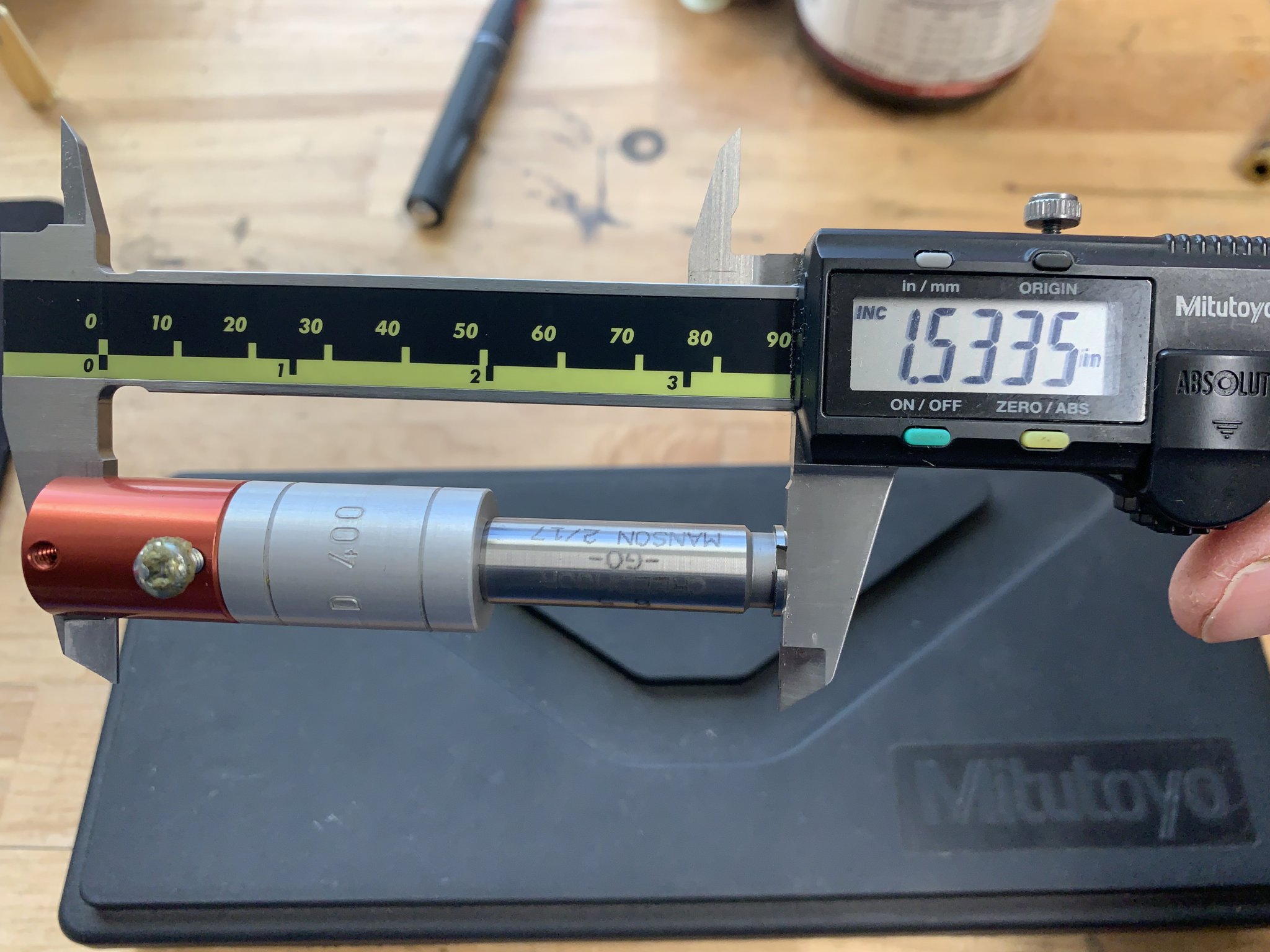

The datum on a creedmoor case is at .400. You’re using a smaller diameter comparator, which is why your headspace numbers appear long. That doesn’t mean your cases are long.
The standard hornady set
A creedmoor go gauge with a .400 comparator
Same gauge with a .375 comparator.
That’s the problem. Due to the length of the comparator you’ll get misalignment between it and the case. You will get different readings every time you measure.
Yeah, just checked and it is the .375. I didn't know there were different ones.
What's the purpose of making a .375 and a .400?

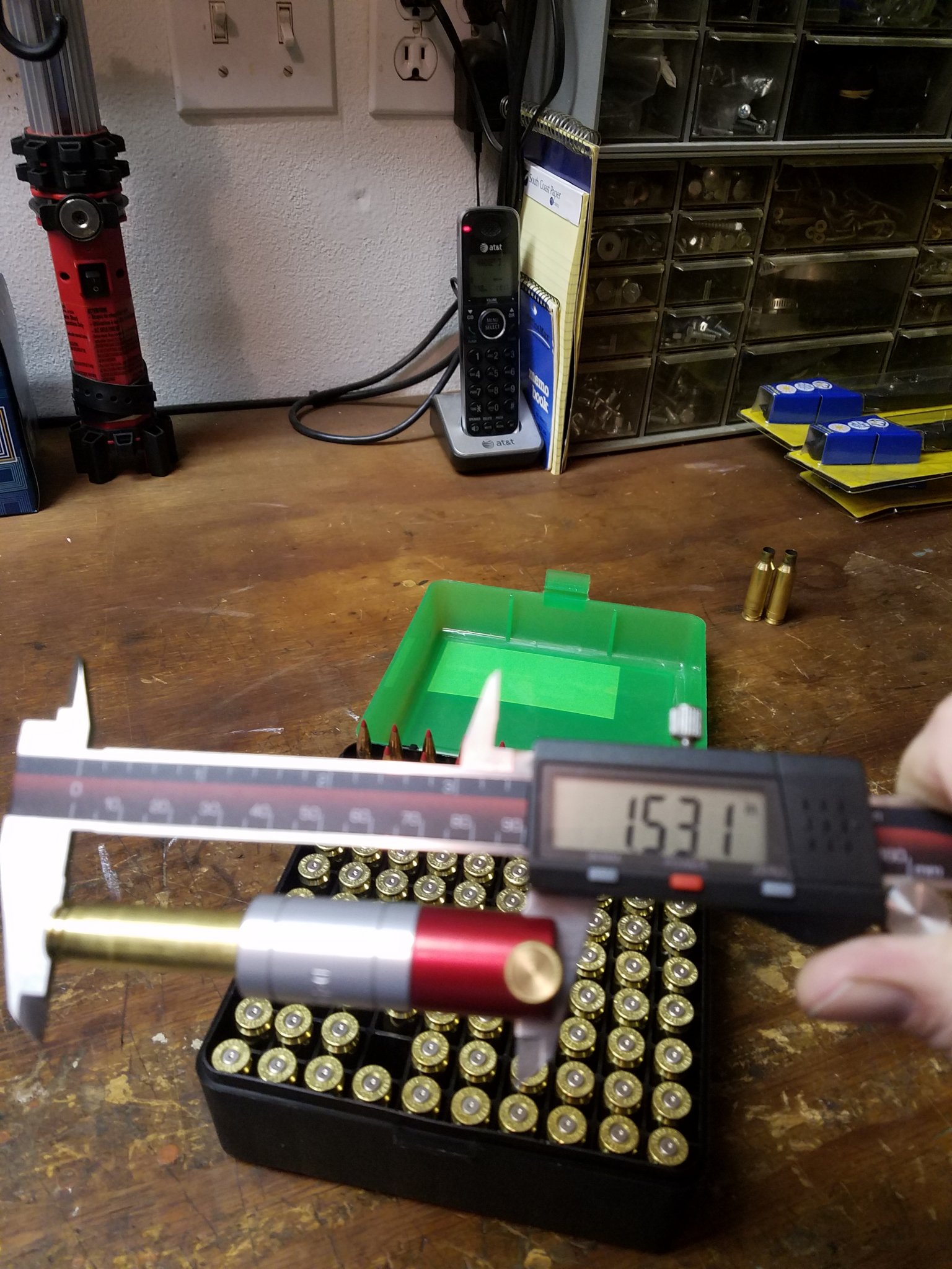

Have you measured some factory ammo??
1.529 seems short.
Factory Hornady ammo measures 1.5560 on my comparator and it's under to fit in a variety of chambers.

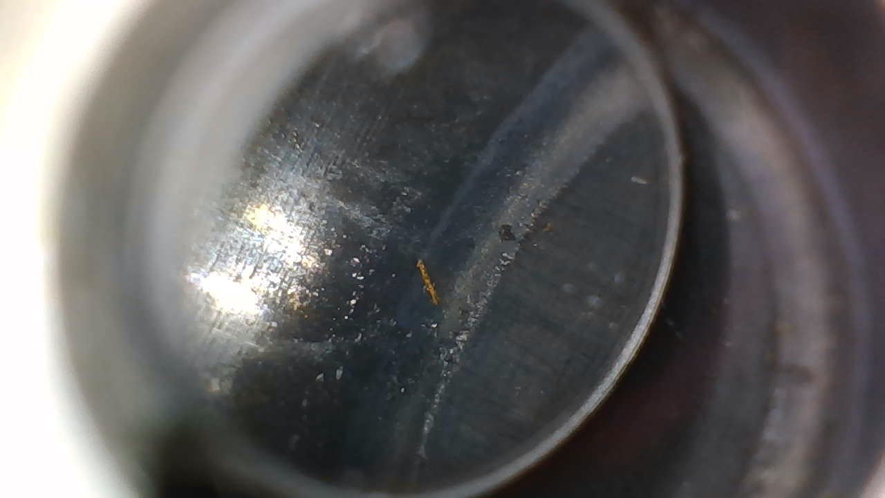

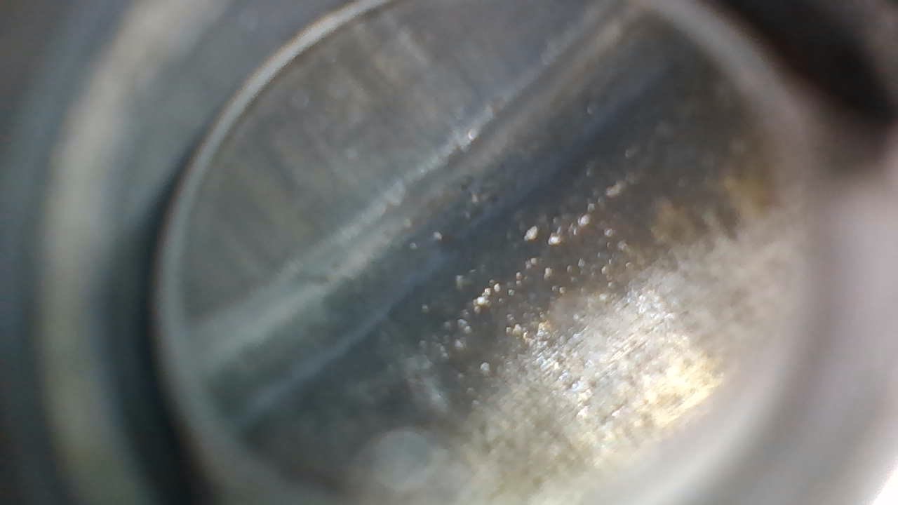

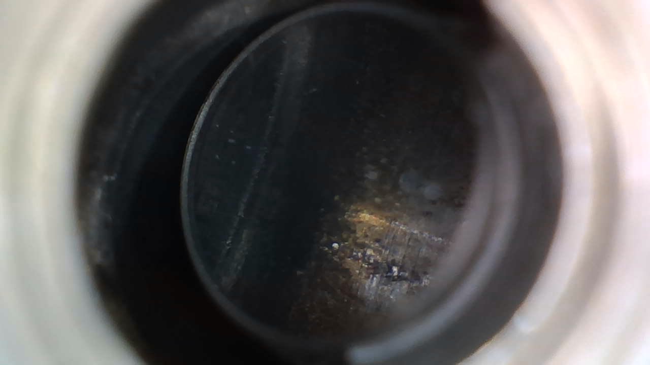

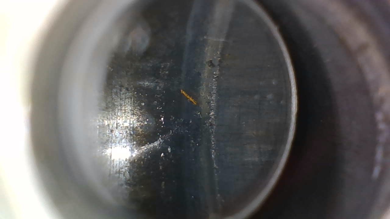

Another question guys, I just ran the bore scope down my chamber and it appears i have a carbon ring in their. It doesnt look like its out of control yet but there is defintely a ring forming inside. Could this have possibly casued the brass to fail? Weird thing is if the carbon ring did cause a huge pressure spike wouldnt it have blown the primer out or at least showed signs on the primer or pressure?
Here are some pics of the chamber i just scoped.
Reactions: Eddystone
Take the rifle off the stock to make sure nothing is cracked on the barreled action. Check the bolt and lugs. Make a field gauge with the fired brass. Electrical tape should be enough. It shouldn't close on a field gauge.

You must be using a .375 comparator, which prevents you from comparing numbers directly.
Numbers even when using two D .400" Hornady inserts will not be the same. The inserts have a chamfer on the inner edge. That chamfer can vary a bit. I have two D .400"inserts. One will measure a 1.630" 308 headspace gauge @ 1.622" (.008"chamfer) the other measures @ 1.611" (.019" chamfer).
They are both accurately measuring the 1.630" 308 Go gauge, but the numbers are different.
Also, i had some once fired brass set to the side and i just chambered it and it chambers with ease. So should i just neck size it and not use the full length for a couple firings?
Bingo... Your brass sprung back after stretching all the way on the first firing and you bumped it back again when you reloaded it. Always check the brass safer the first firing to see if it Chambers easily. If it does you don't want to push the shoulder back any until after the second firing.

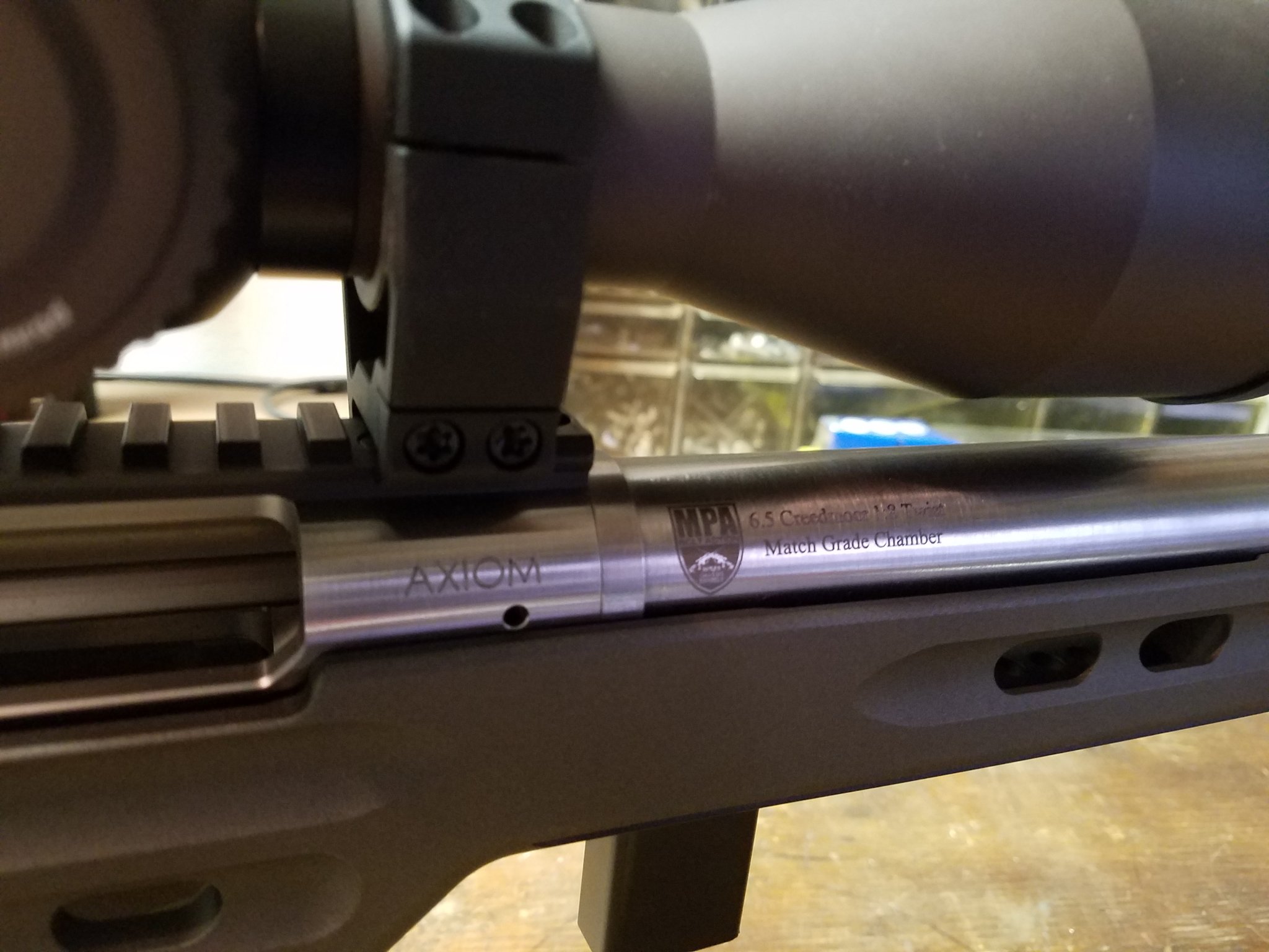

What barrel and action is on your MPA? Mine with the Curtis Axiom and MPA/Spencer barrel my fire formed brass measures 1.537 so I bump back to 1.535.
Very much doubt that the chamber is off, but worth checking anyway.
1.537” on the Hornady 400 comparator: So i have exactly the same dimension for my fire formed brass from my MPA in 6.5 CM. [Of course your gauge can be expected to be slightly different from mine.]
MPA cuts a “match chamber” (see section in your manual), and their reamer has tighter dimensions than the typical standard SAAMI reamer. Fire formed brass from my Remington or Savage does not fit in the MPA.

If you have a bad (well developed) carbon ring that is severely pinching the bullet, pressures could spike a lot, enough to cause the big increase in recoil you reported, and of course over pressure the case.
Best advice is to stop shooting the rifle and ask a gunsmith with a high quality borescope to inspect it. Also inspect the action. He can check headspace with a go and a no-go guage while you are at it, just to be on the safe side.

Scrub out that carbon ring (whether real or not, it is worth being sure that issue is not present).
Get a good gunsmith to inspect the rifle. Money well spent in this scenario.
Also, in my experience, the MPA chamber is tight and my max load has come down by 1.3 plus grains compared to the Savage LRP with the Shilen barrel. Max speed is down by 60-70 fps. Accuracy is way up.
