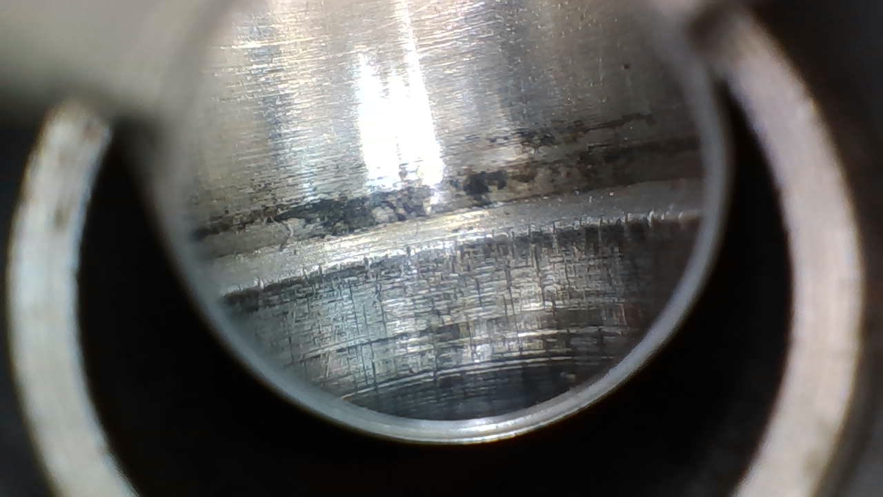

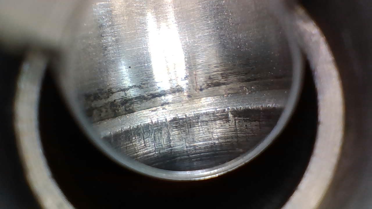

well i just got done scrubbing the chamber and removed (mostly) the carbon ring i had going.

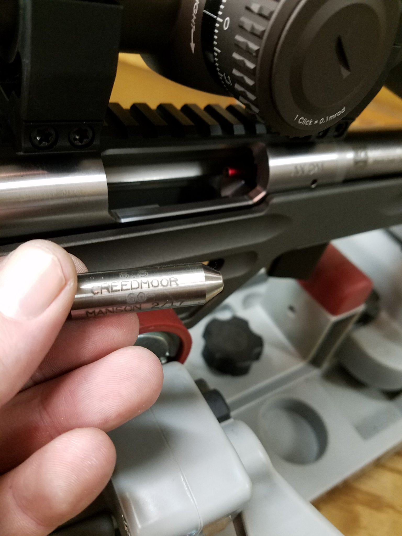

I also borrowed some headspace gauges im getting ready to check those now(assuming will be fine)
im going to shoot tomorrow so i will see if i have any issues. Im using once fired brass tomorrow so hopefully everything will be back to normal.

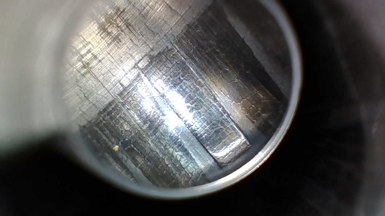

pics of chamber after cleaning for last 2 hours.
Reactions: NamibHunter
Got the same bore scope off Amazon. Works really well.
FIRST low cost bore scope to have the correct focal length lens. Well made. Connects to any device that has a USB port and will allow an external camera. Worth getting one imho.

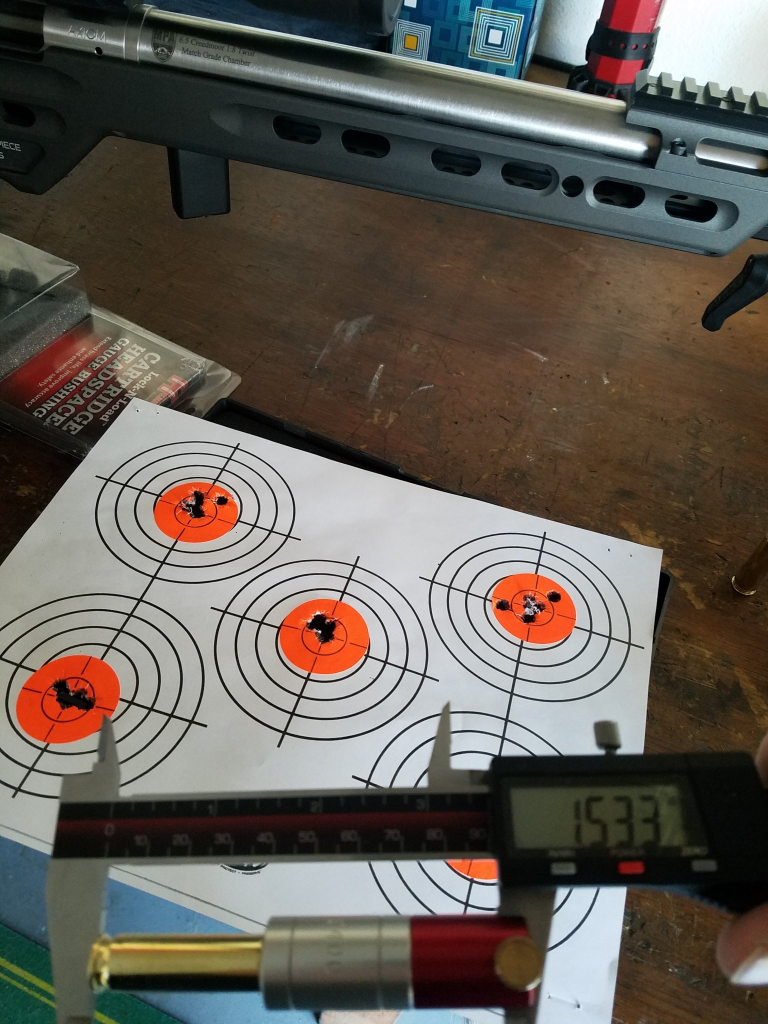

Just a quick update, everything was good today @ range. Rifle shot great, no issues with ammo, and case length grew a little bit after 2nd firing and still chambers easily so I will neck size it again and see what happens on third firing of it.
Thank you to everyone that had helpful info.

If all the above doesn't get this resolved, do check for and clean for a carbon ring. I have had the mysterious heavy recoil before at starting loads, case separation, bad bolt lift, weird fliers. All I can figure is the carbon hangs up the bullet release from the throat/case. I had to reset headspace after also. I got a 2/3 circumference piece out intact. Major "Oooh" moment.
I started a thread like this on another forum. The answers all went a lot like this one. Then one member chimed in saying " Carbon Ring". Sure enough, I checked the barrel with a borescope and the carbon build up was obvious!
Check for decrease in velocity from previous time you checked it.
Getting the carbon out will be your next big hurdle!
Good advice.
From the OP: “i just got done scrubbing the chamber and removed (mostly) the carbon ring i had going.”
So I believe the OP actually found a carbon ring. To my eyes, it looks like a fairly minor carbon ring (at least compared to the one i found in a retired 6.5 CM barrel with 2,600 rounds through it). Pitch black, thick and wide, and extending below the case neck. Might explain the erratic speed i observed during the last weeks of shooting that barrel... Took a whole day to scrub that barrel back to 95% cleanliness. Plan to spin it back on and see how it shoots, post Tubb TMS treatment. Long shot perhaps, but that barrel was ridiculously accurate in its prime, so hoping i can re-use it for long range hunting purposes.
The lesson i learned the past week: Unless you have a good quality bore scope, you will very likely be unaware just how much carbon can build up in that area, until you see spikes in speed and recoil... the dreaded carbon ring can creep up on you! Normal barrel cleaning will not avoid a carbon ring.... [Especially if you use up an 8 lbs jar of RL-17.... why? because it was accurate and 180 fps faster than H4350). RL-17: Dirty powder that one. Mostly gave up on it (also too temperature sensitive).]

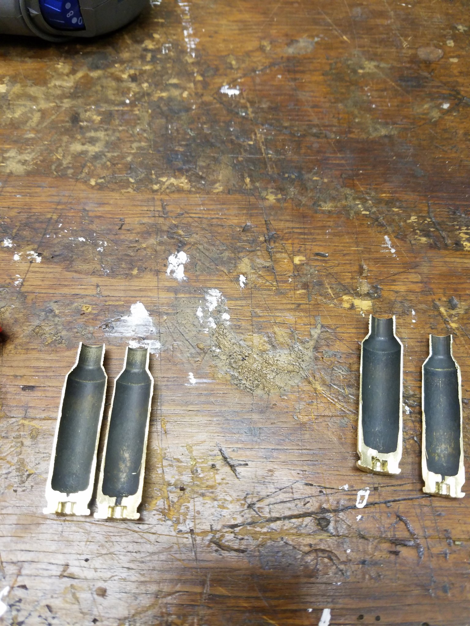

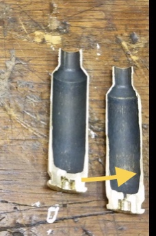

Just a quick update. I have since switched to lapua brass and started load development with it. But as I was getting ready to chuck about 160 pieces of the hornady brass that failed on me (5 times fired) I decided to cut a few open to see if I could see the case head getting thin, indicating imminent separation.
Oddly enough the cases I cut open all look good? I cut open several. Of them and they all look the same, shouldn't there be obvious signs it's getting thin in the case head?
Either way I'm still moving forward with the lapua brass but I think this hornady brass still has life left, I guess I'll just save it for a rainy day or different rifle.
You might well be right.
Always hard to tell from a photo, the case on the left looks good to me. The case on the right needs a bit of “deburring” to clean it up some more, but there might be the slightest of thinning at the yellow arrow - or not!
[i use a small file and try to chamfer the sharp edges 45 degrees, makes it a little easier to diagnose. My wife’s disposable nail files work surprisingly well...]
[i use a small file and try to chamfer the sharp edges 45 degrees, makes it a little easier to diagnose.]
I'll give that a go and see if I see anything different.
