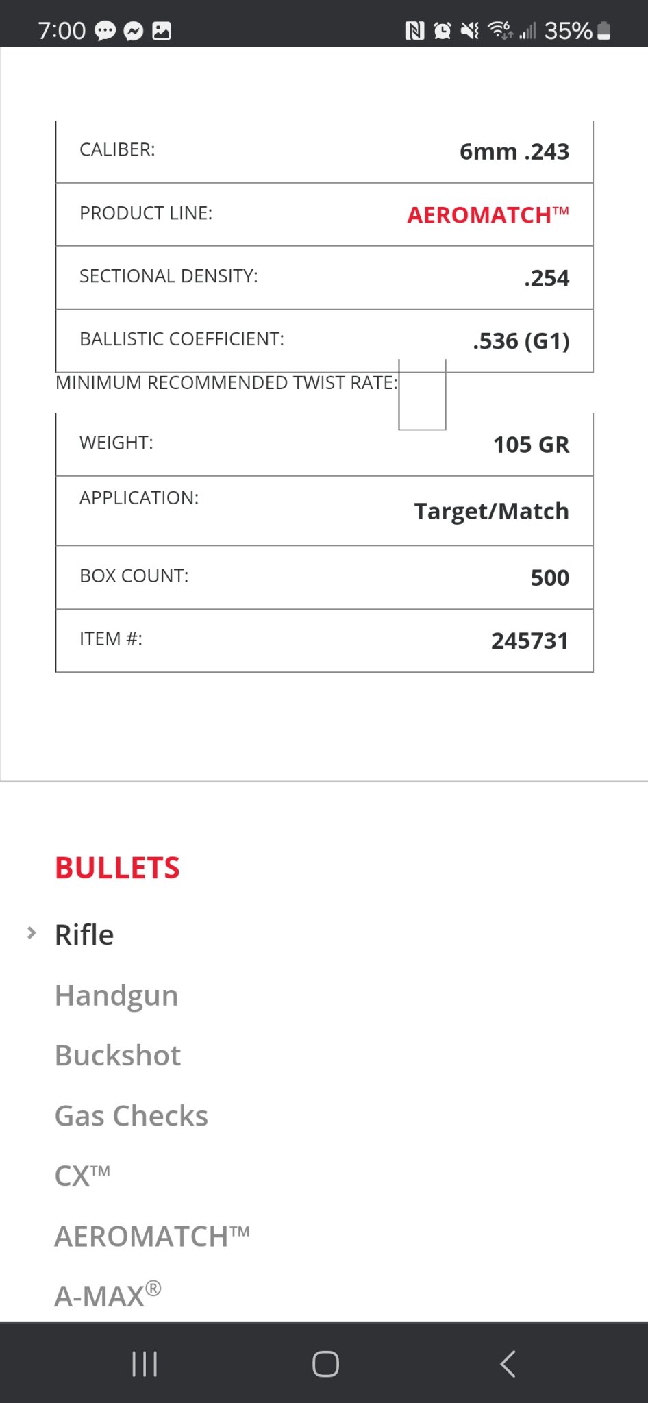

So, if I'm seeing this right, they are just popping out clones of SMK and Bergers now. Theory is that if you have difficulty finding what you want in stock, you just get an Aeromatch bullet and you can use your same load.
Super weird though.... I guess bullets aren't protected IP unless they are patented. Or maybe I'm misunderstanding this product.

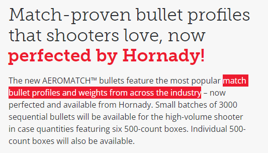

Are you serious? Did you look at what I posted? They literally deadass state they are using bullet profiles from other companies and making the bullets so similar that you won't need to adjust your loads when you switch to the Hornady version of the bullets.

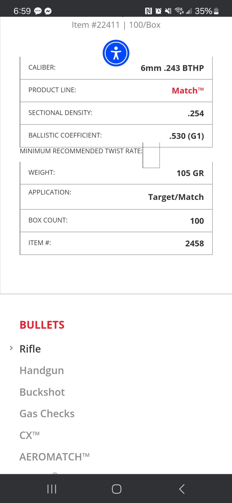

I take that to mean a hpbt in a normal weight such as a 105 which basically everyone has.
I assumed they were going to be phasing out their old match line and replacing it with this for a few cents more, ala the atip amax> eld
Theres not exactly a lot to go off of there and they are pretty generic weights, such as are/have been made already by hornady before as well
I assumed they were going to be phasing out their old match line and replacing it with this for a few cents more, ala the atip>eld

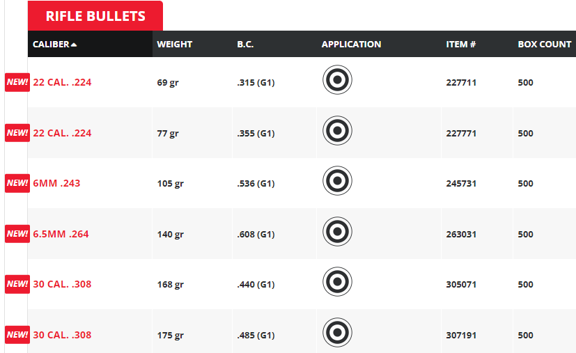

they say “don’t change your load, seating die, or dope”.. they are 69, 77, 168, 175 smk clones and 105 and 140 hybrid clones. Look at the gol darn BCs. They aren’t being sneaky about it, they are outright saying we’re making the same thing for cheaper and it’s going to be more available.
So which is it? A smk or hybrid clone?
And, even without watching the video, how would it be possible to nail the ballistic coefficients exactly and not have to adjust seater stems if the bullets weren’t identical?
The same can be said for almost any non secant match bullet from this millennium, my 105 rdf, 105 hybrid, 105 barnes are all within .010 of each other on the seating micrometer. And all have the same .270-.290 bc along with the 108 eld, only its more secant so it touches my seater stem a smidge different, comparator tool puts it in the same general range as the other 105s.

.27-.29 is a pretty big spread. Even if it’s not as good for our purposes, I’d argue it’s hard to nail, to the third decimal, the G1 b.c. without them being IDENTICAL. Only time and folks measuring, and shooting them, will see if that holds true.
