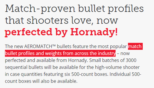

There's plenty to go off of. Like the video which I also posted: "One thing we hear from a lot of shooters when we're out at competitions, we're out at the field, is availability of some of the very common hollow point boattail designs that are out there. A lot of shooters love these bullets. They have good aerodynamics, they shoot good groups. The problem is availability and getting enough of them of one lot to make it through a match, a life of a barrel, a couple years worth of supplies, so you don't have to keep changing your load. The arrow match line of bullets addresses all of those issues."
"You don't have to change your dies, you don't have to change your loads, you don't have to change anything to switch from your popular profile other brand to these."
They are telling you they are copies in as clear of terms as they can without violating copyright and trademark laws.

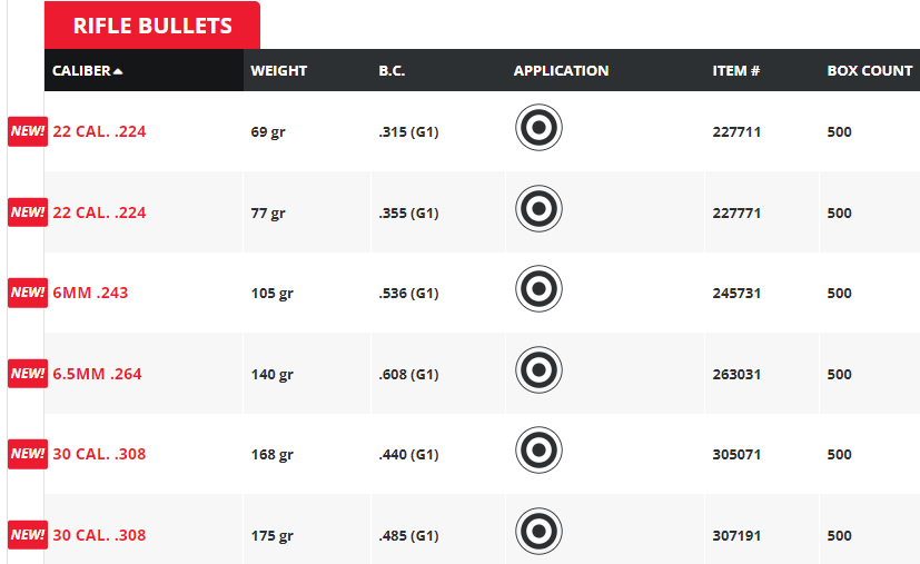

The bullets don't match the BCs of Hornady's existing HPBT match bullets. But the 105s are exactly the same as the BCs of Berger hybrid targets.

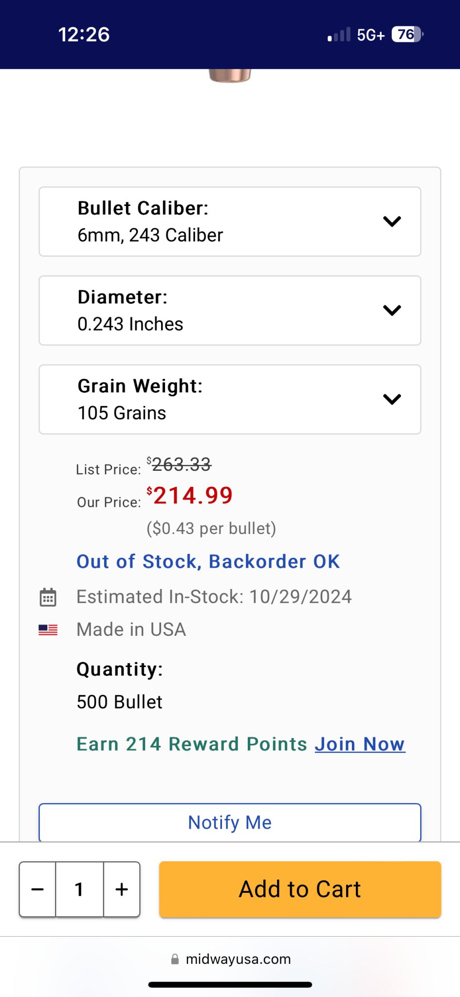

Well, if this is going to be the price then I'm out. But this is Midway, so who knows.

LOL @ the guys in this thread saying they're not blatant copies of Berger Hybrids for 140's and 105's and SMK's for 77's and 175's.
They're not hiding the ball, they're not even being coy about it. They're saying everything short of, "We made identical bullets to our competitors because our competitors haven't kept anything in stock for 4 fucking years, and people really like the design of those projectiles."

Wait wut.... A brand new 77gr .224 bthp bullet with a .355 g1 bc when they already make a 75gr .224 bthp with a .395 g1. This makes absolutely no sense.
The 75g bthp isn't really .395 g1. Seems they weren't worried about correcting their existing inflated BCs when they got all serious about BCs with the intro of the ELD line. Apllied Ballistics says 0.348 G1 for the 75 bthp. It sounds like they were already making SMK clones for black hills and possibly others.

Interesting. The 140 BC is listed the same as the existing 140 bthp so I would guess that's what it is rather than a hybrid clone. The others may very well be SMK clones though.
The 140 is a hybrid per Hornady tech yesterday.

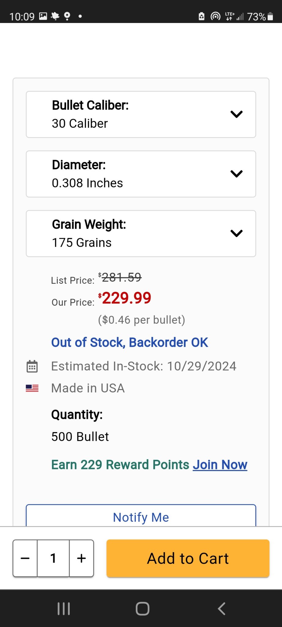

These prices I'm seeing aren't very good. Hopefully it is just some companies gouging for new product.
This looks like about a 20% savings over the yellow box:
