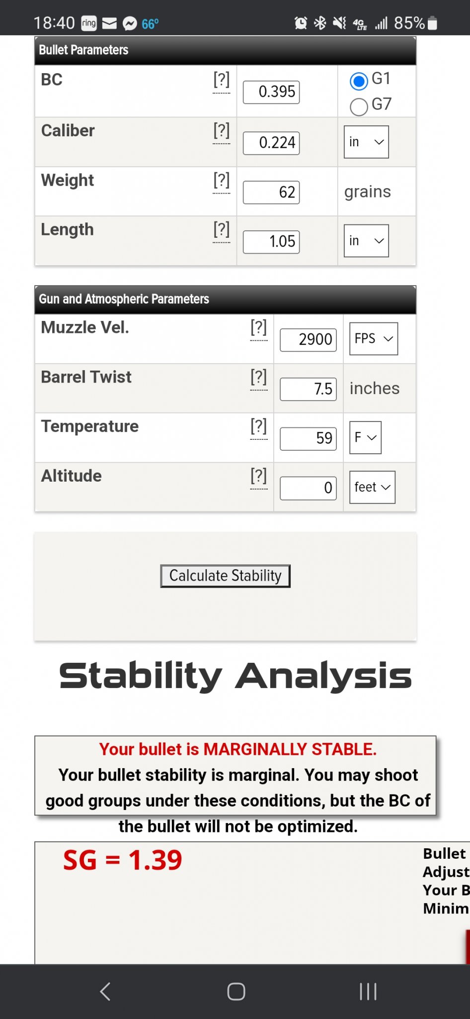

So here is another question, with the front of the bullet being hollow would that count like the plastic tip length in the stability calculator?
Yeah it's going to skew the Greenhill and Miller formulas because the weight distribution isn't "standard". Best bet will be once a 4DoF file is live to use the 4DoF app because it uses the specific bullet's physical model to determine stability. You can put in any twist rate and velocity at any conditions and it will output Gyro SG in the "table" tool.
There is an older version in the library, Proto V2 (Proto V6 is the 80gr 6mm), which is a little bit longer than the final production bullet so any stability calcs done with that bullet will be conservative. The Proto V6 was a similar situation and is shorter in the production bullet.

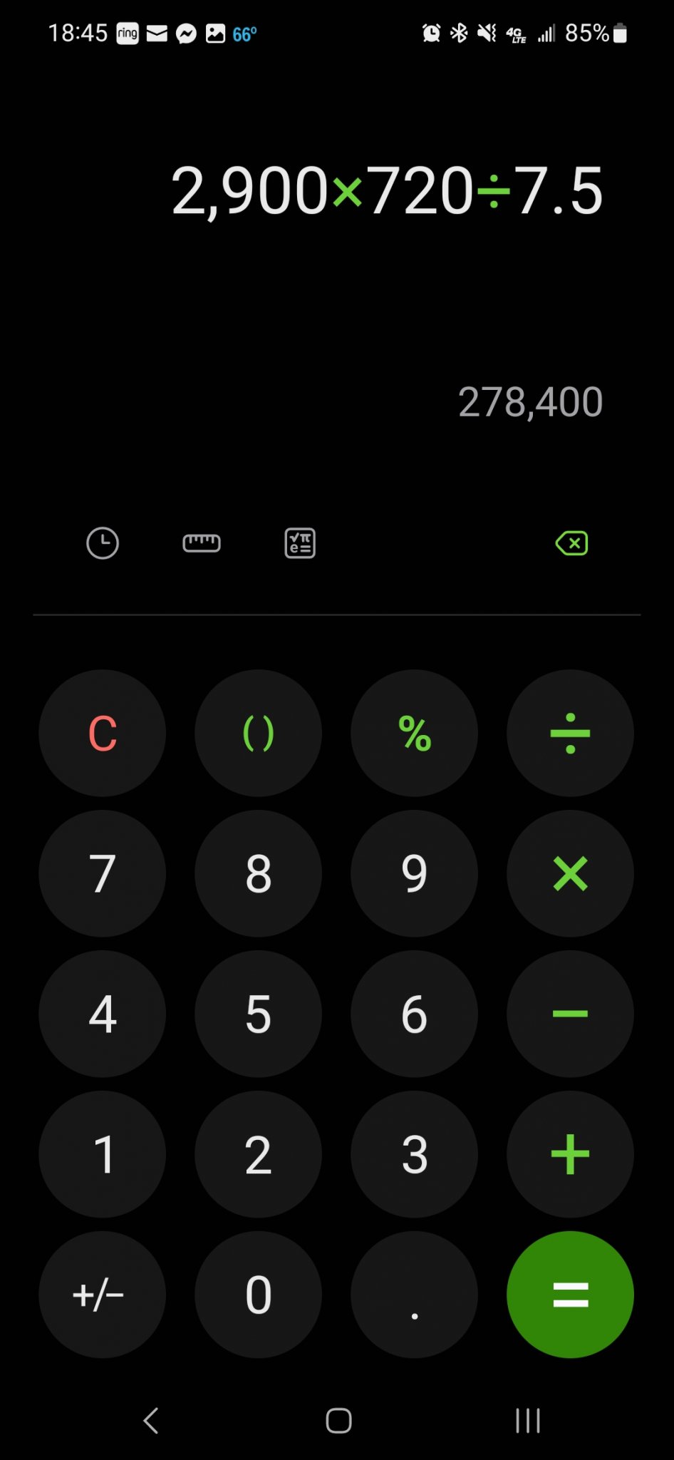

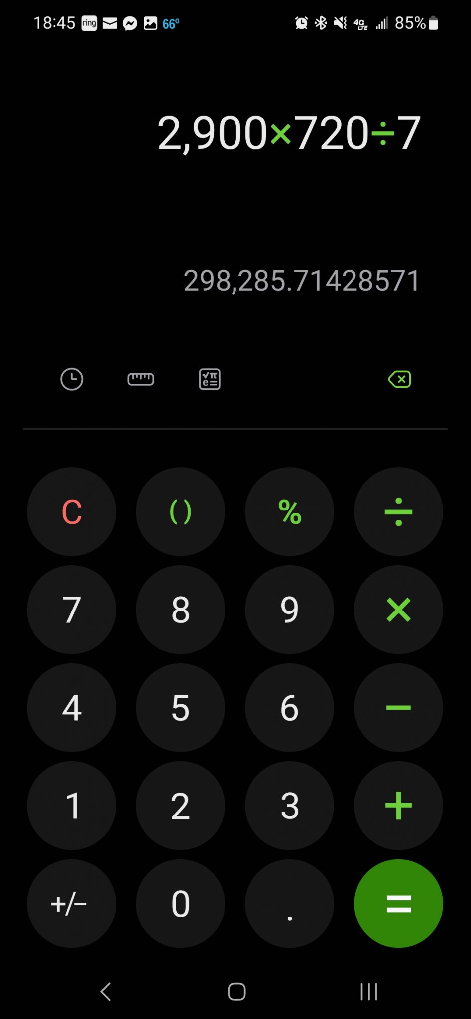

This might be a problem if you plan on running anything faster than a 7.5 twist unless you're just running them slow af.
doing a long range varmint rifle. want to shoot the 88 eld and possibly the 62 eldvt when it comes.
hornady advised me that 7.5 twist would be good. said their bullets can only take 285k rpm so 7 twist is "too fast" for 2900 fps or so and could destroy the jackets.
y'all think I should do 7 twist or 7.5 twist?
I bet I can run them fast enough to blow them up from my 28", 1:7, 22 Nosler AR (loaded long, single shot sled).
