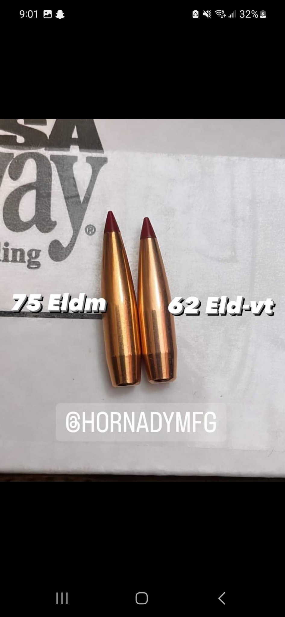

Hornadys new ELD VT
Stole this picture from a group on Facebook
Reactions: 260284

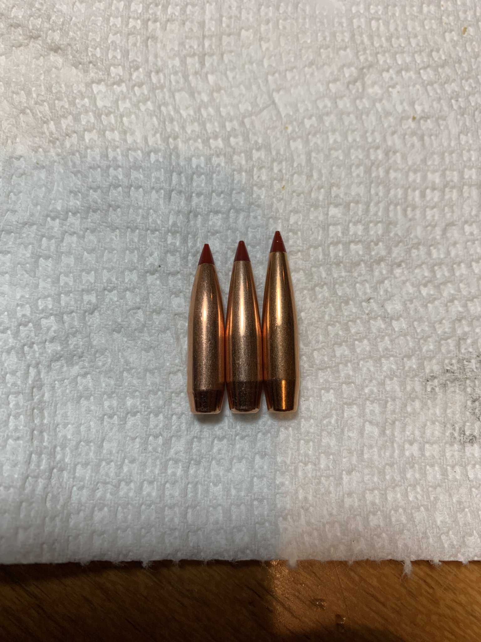

Well these 62 VT's aren't going to work in a 223 AR unless they like a really long jump.
I got my hopes up when @Ledzep posted .600 ogive length.
Below Left to right are 73 eldm, 62 eldm vt, & 75 eldm. Keep in mind these 62 vt's are seconds but I doubt there .100 out of wack.
The 73's shoot well in my AR's & like to be loaded long at 2.290"
All measured using Hornady 2-22 comparator.
73 eldm oal = 1.036" & BTO = .583" or for AR's it means .453" in front of ogive.
62 VT oal = 1.050" & BTO = .503" so .547" in front of ogive or .105" more jump than a 73 eldm
75 eldm oal = 1.110" & BTO = .557" & .553" in front of ogive.
The 75's don't shoot worth crap in my AR's & also sucked in my Valkyrie so I don't have high hopes.
I'll give these a go first in the 18" 7T Valk with 8208 & a 10.5" 8T 223W with Tac. If they won't shoot in the AR's I'll load some for the 26" bolt gun.
Guessing I can get 3100+ in the Valkyrie & 2750+ in the shorty 223W
Reactions: 806guns
The 75 eld-m are about my most accurate 223 Rem load out of my Desert Tech. I load at 2.525 with either 23.5 XBR or 24.5 Varget. They’re very sensitive to depth and need a chamber with lots of freebore.
I have a feeling the 62 VT are going to be similar.
Reactions: bar_n and 357Max

I'd like to get the dimensions of the 62 gr. If it mirrors the 75 ELDM then we could use the AR15 with the mods mentioned by TonyTheTiger.

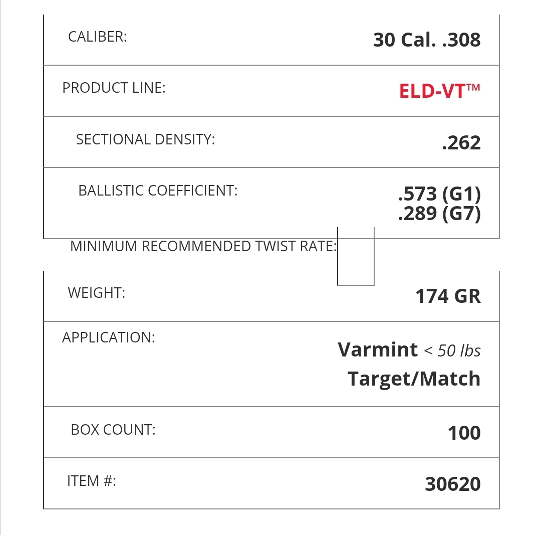

Can anyone confirm minimum recommended twist rate on the 174gr 308? Doesn't show on the bullet listing to me? Have a 1:12 26 inch barrel going onto an action that will be primarily used for sporter/F-TR at F class matches to 900 yards, guessing these may be marginal but it doesn't get cold here and there is usually reasonable humidity, nearly always shoot after midday so far as temperature goes too.
