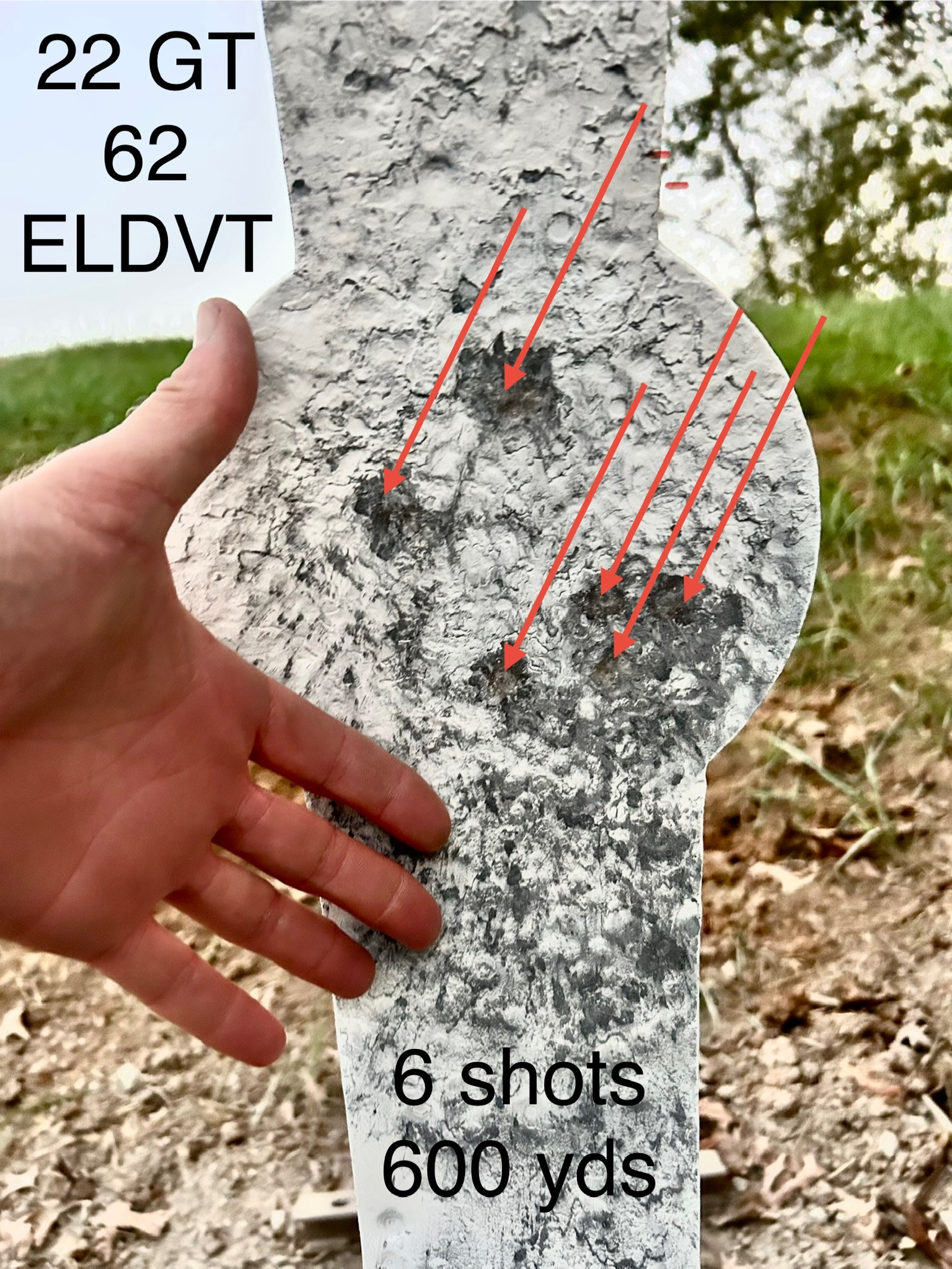

I was limited on time so I just set up and quickly threw 41-ish grains of StaBLL 6.5 from my Harrell's without weighing every charge. ES and SD was terrible but it was fairly accurate to 750. 39.2 of the same powder gave me 3257 with 80 ELDM’s. Also poor ES/SD, but it put three inside of about a generous foot at 1250, which is way better then I expected to do with a 22 caliber off sitting tripod and 18 max power.
Going to mess with Long Rifle now that I have about 120 rounds down the pipe.
This was six at 600 with the VT’s but the wind was favorable yesterday evening.

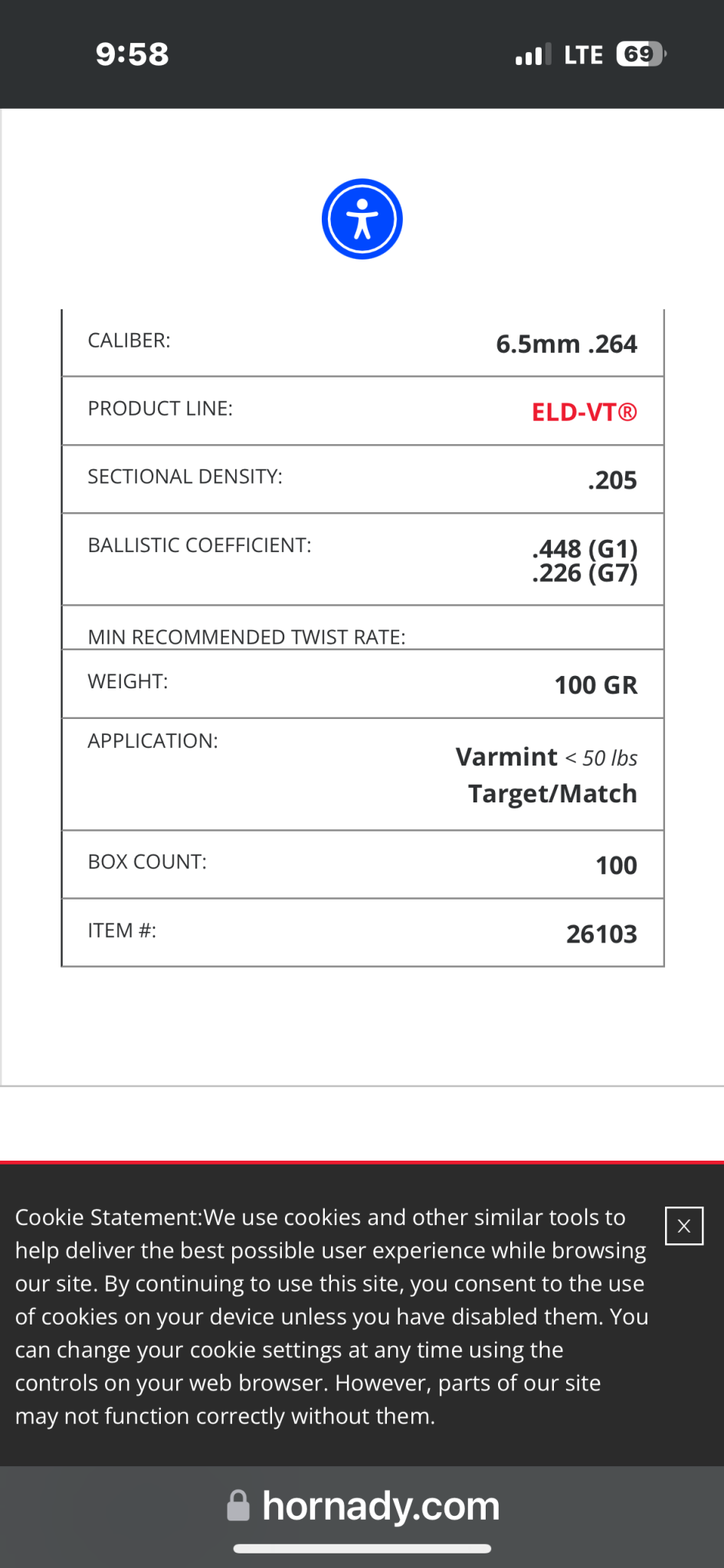

Speaking of BC’s, @Ledzep there’s a discrepancy in advertised Bc’s for the 6.5 100gr VT. Hornady website says .448 G1/.226 G7. My bullet boxes say .448/.266. Searching around the web shows both ways as well.
.266 lines up perfectly for me across two rifles so far.
Yeah that's a known issue should be fixed going forward. Typo. I don't remember off hand which is correct but just off the fact that G7 is usually half G1 it's probably .226.
