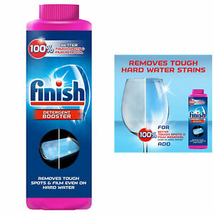

Maybe the dishwasher? Test the water resistance while your at it… 😜
Just make sure you got jet dry rinse aid in there to prevent water spots.
