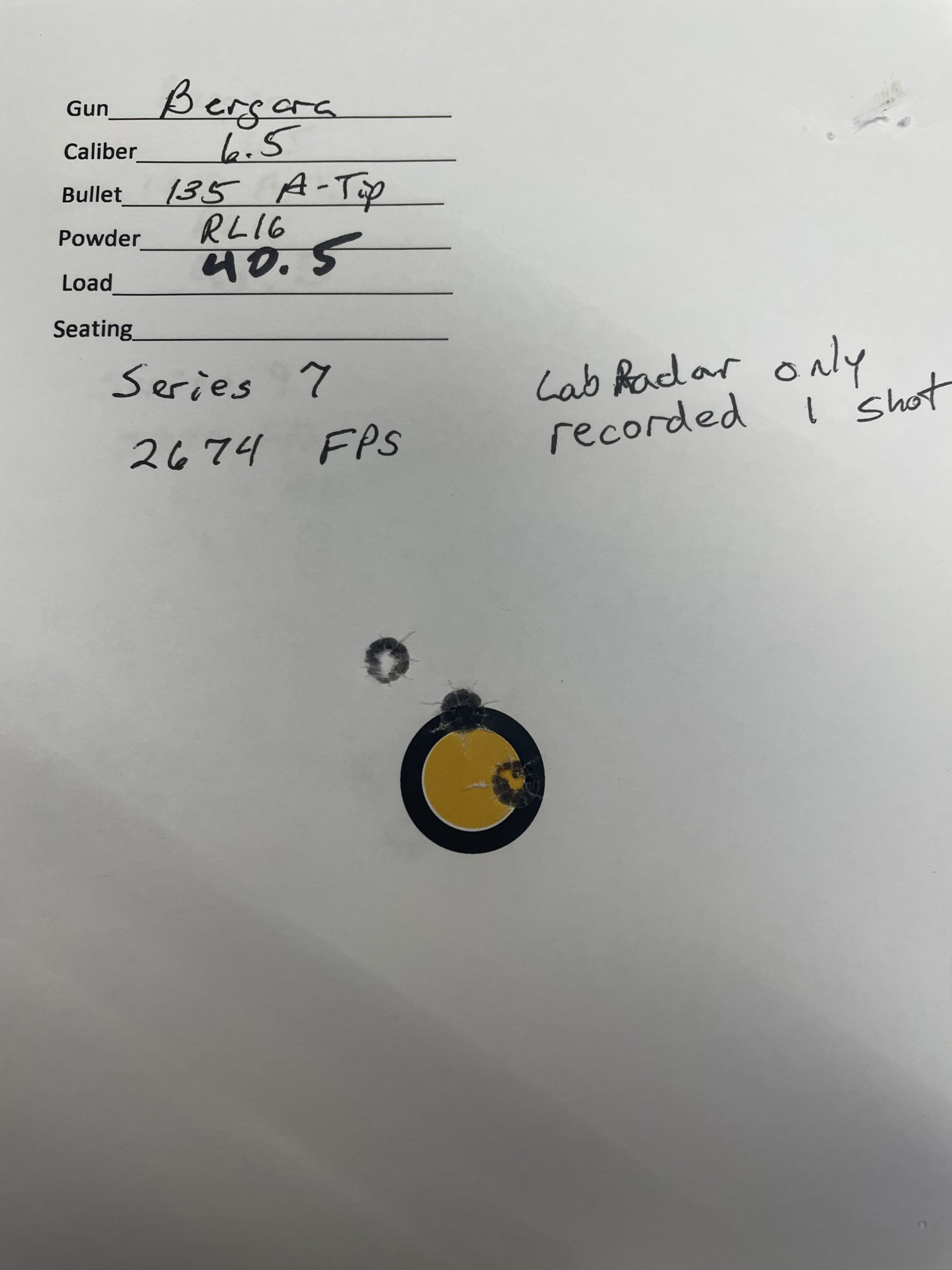

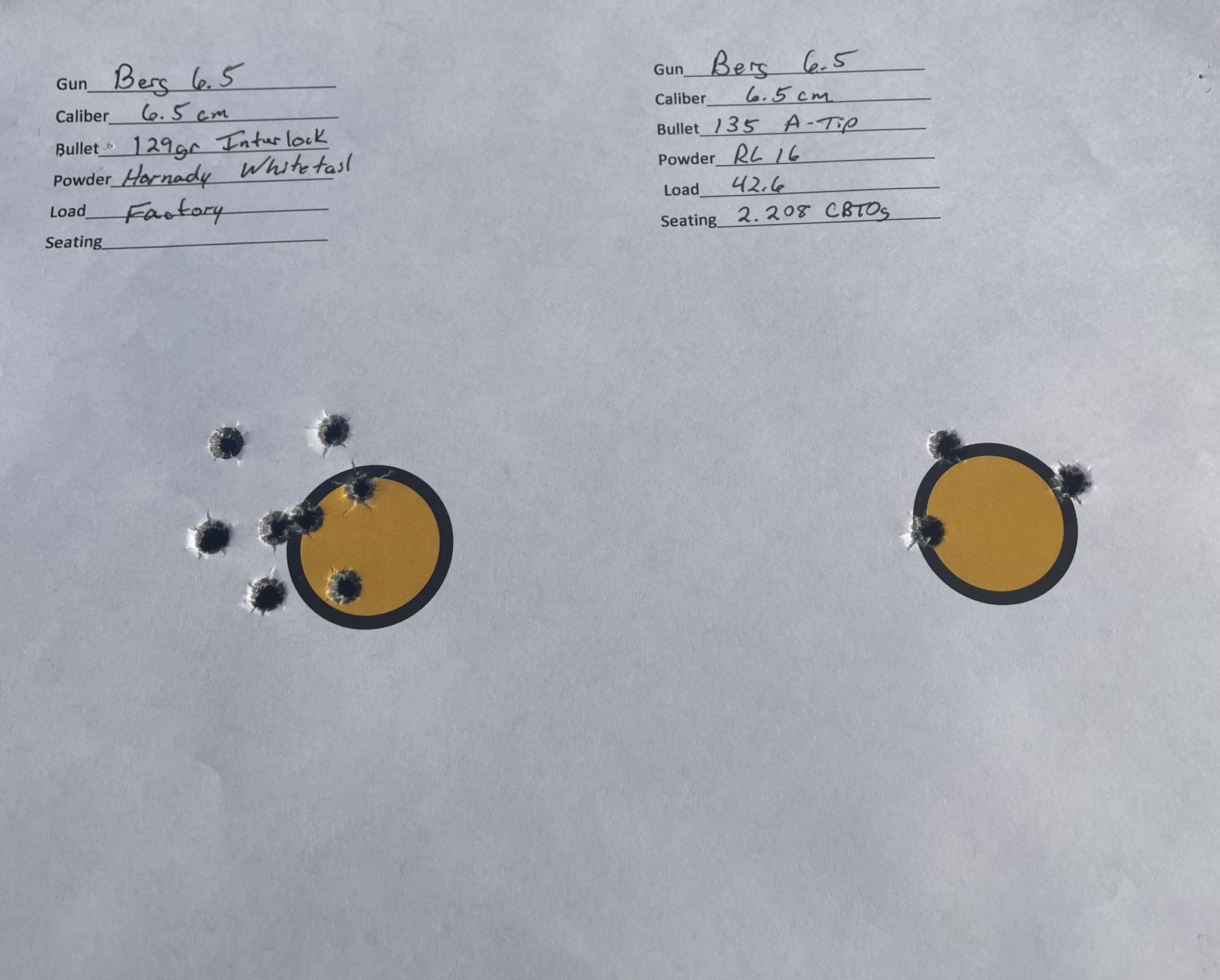

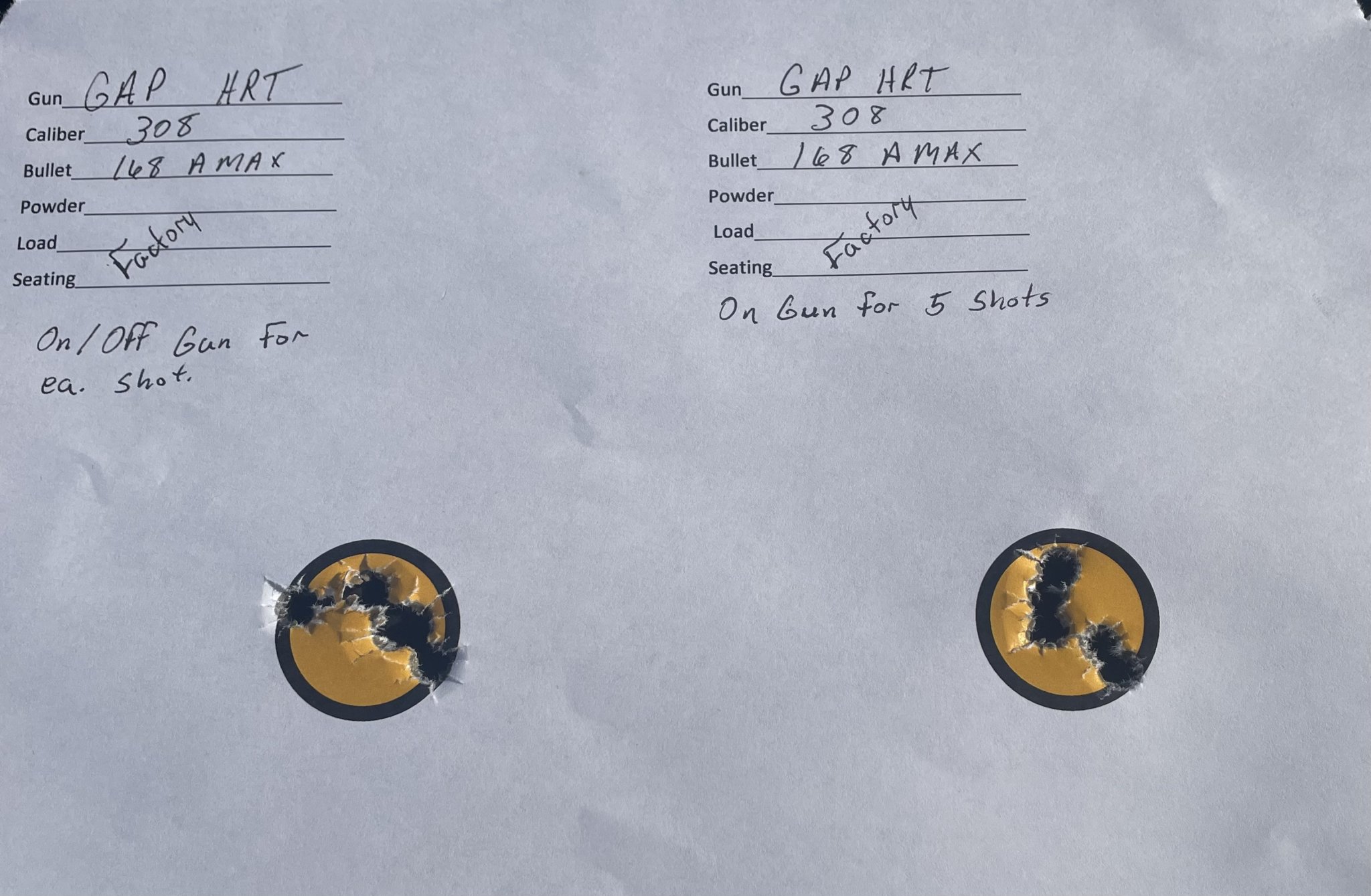

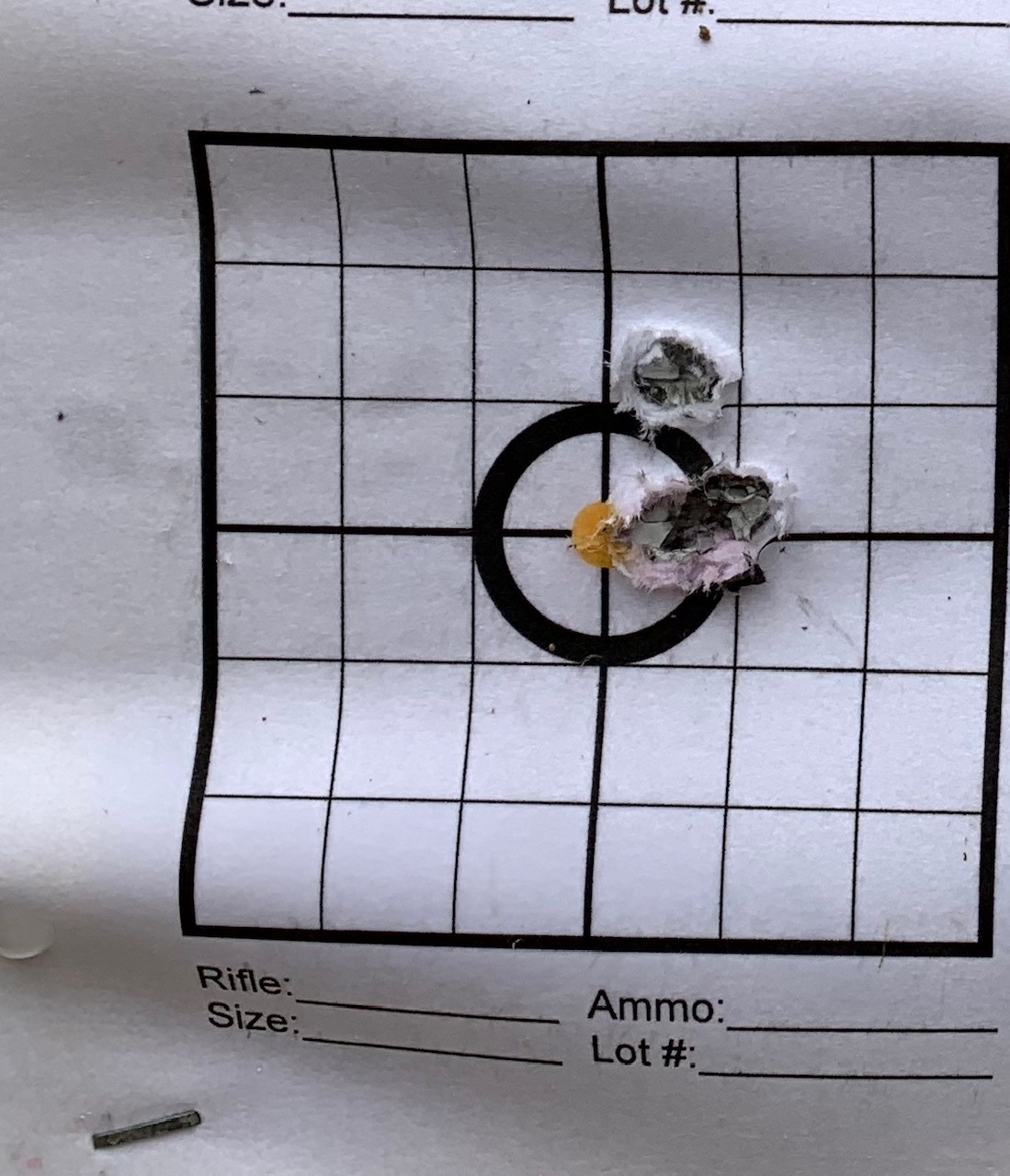

Ok! GAP targets and a couple of others from the 6.5 again. No I know they don’t mean too much but just a sampling of my shooting from the same setup, same day, different guns.
5 on the left are off the gun each shot.
5 on the right I stayed engaged in the rifle.

That’s pretty clear. My vote is that the gun doesn’t like the A Tips but it could be an issue with the gun/barrel. Can you see a lot of copper in the rifling at the muzzle when you shine a light on it?
Not a lot of fouling. It was cleaned before I started this process and after I got it “sighted-in” with the 129s…. So maybe 10-20 rounds on a clean barrel.
yeah that's disappointing. is this a new barreled action? how many rounds? clean barrel?
Gun is one I purchased new a couple of years, sold, and bought back with the same ammo I sold it with. Probably 150 at most down the barrel. Barrel was fouled before starting this process.

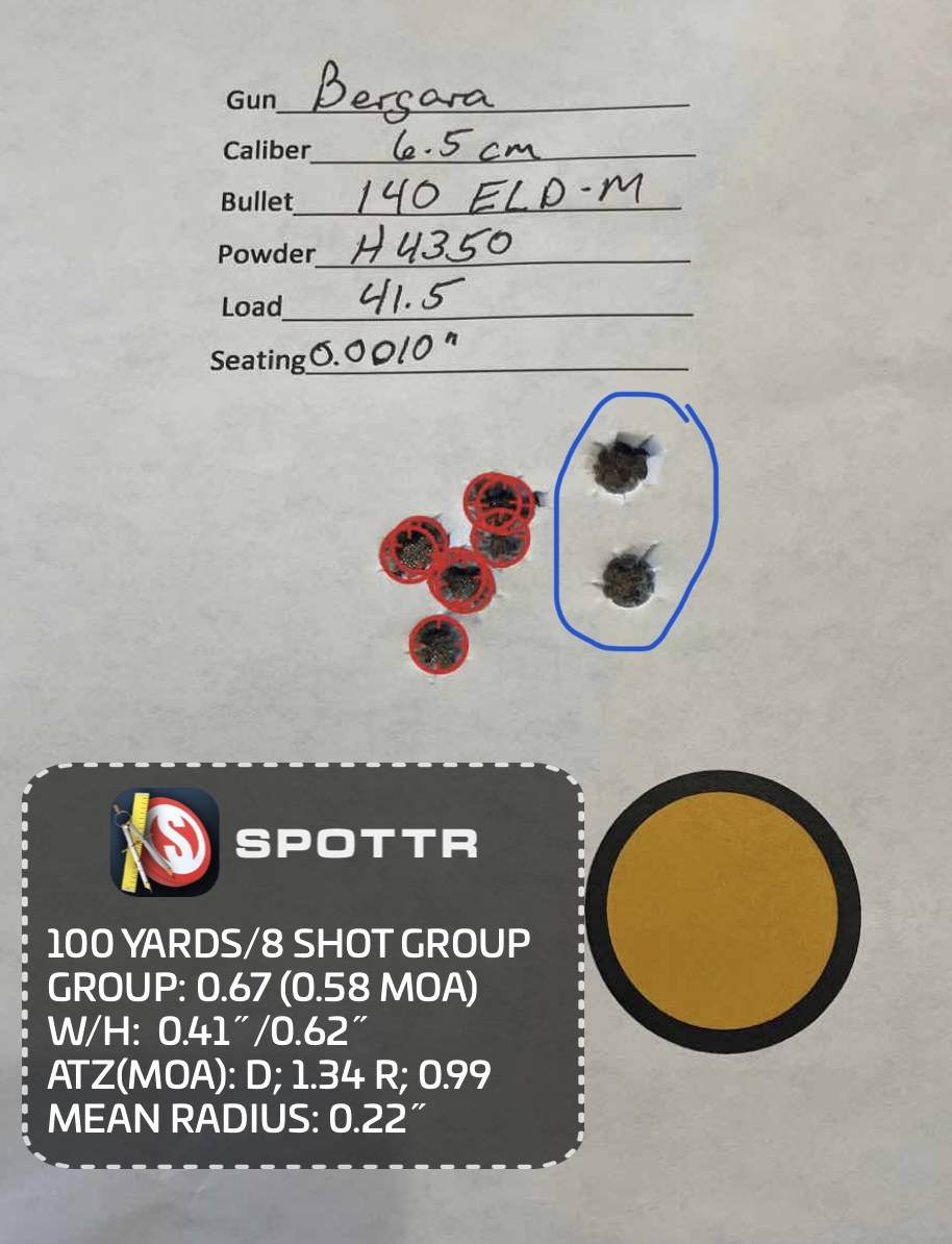

Right now the group on the right is shooting euqal or possibly slightin inside the group on the left.
good
I agree 100%! I am looking for something to get a “control group” at least. I’ve got some legit help going on in here….

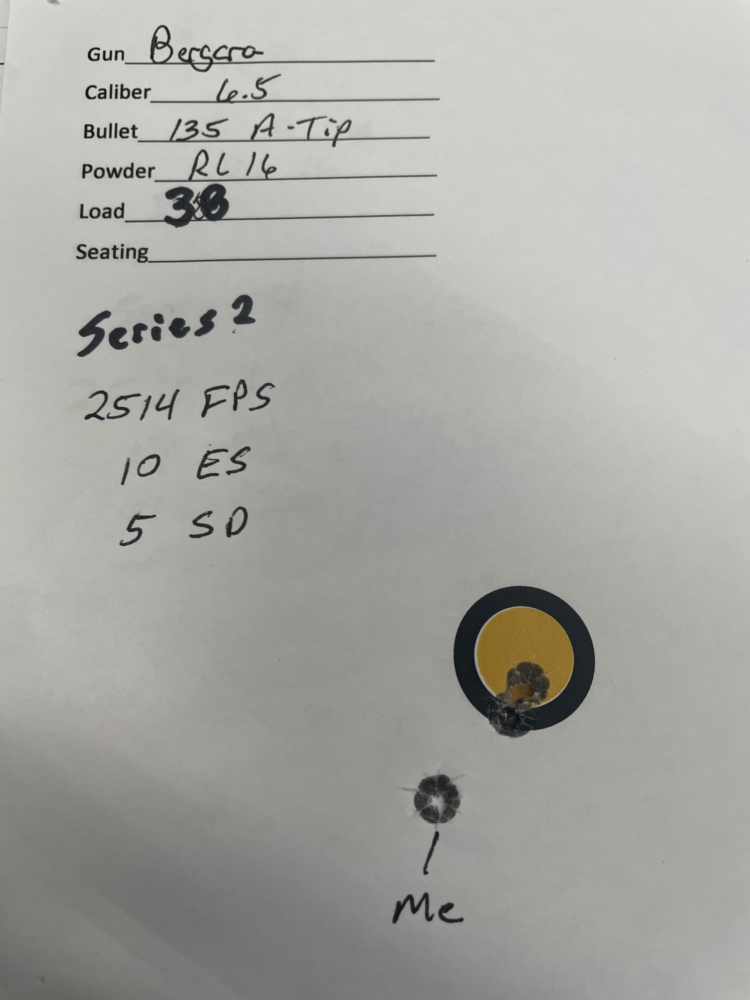

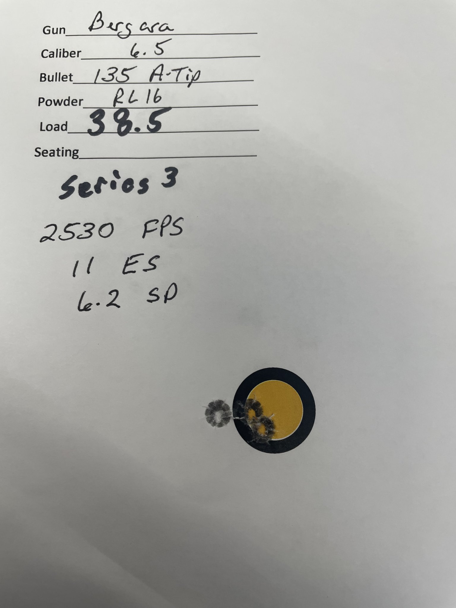

Another update:
Still with RL16 and 135 A-tips.
(Got some 140 ELD-M (thank you BuildingConceptsllc) and some H4350 on hold for me to try)
But, I wanted to go back out with what I had….
See below-
Another update:
See below-

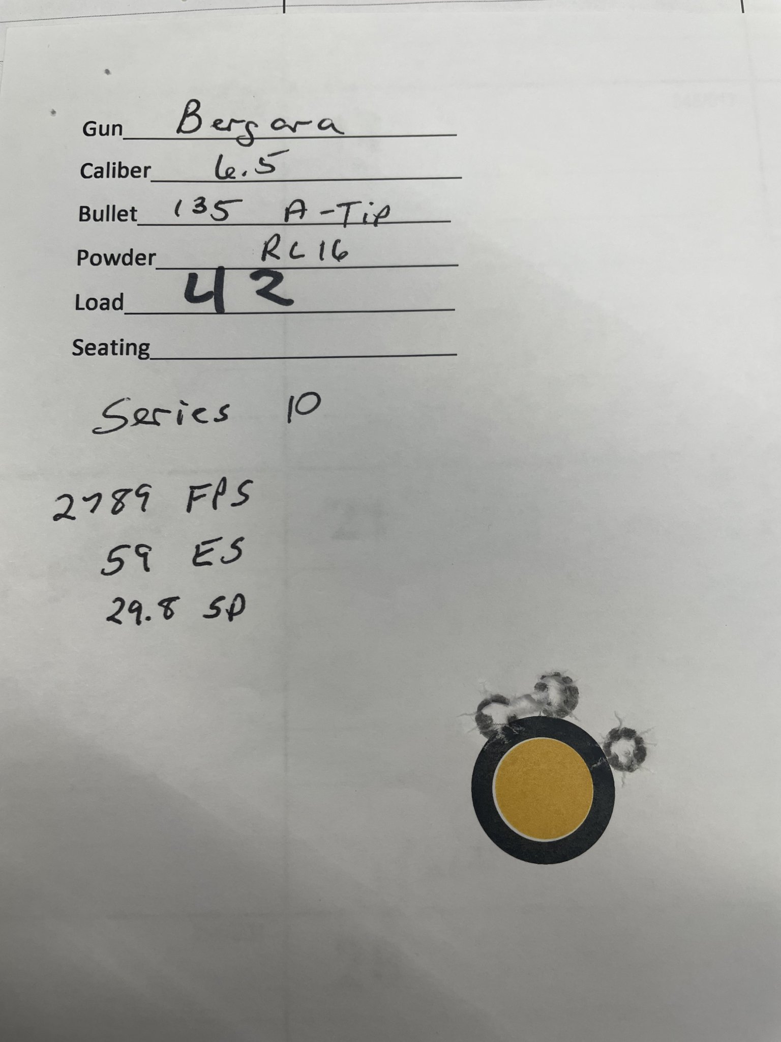

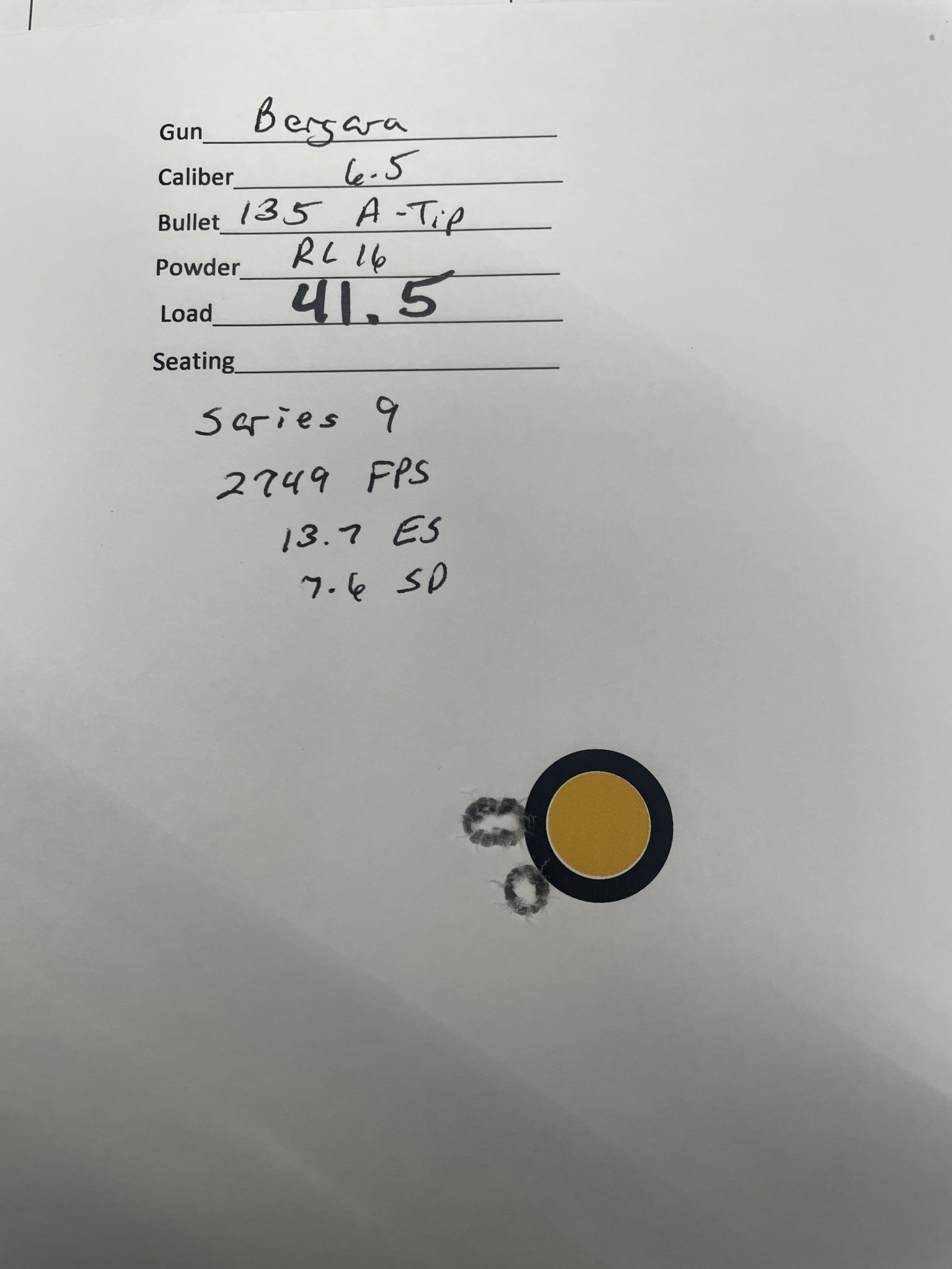

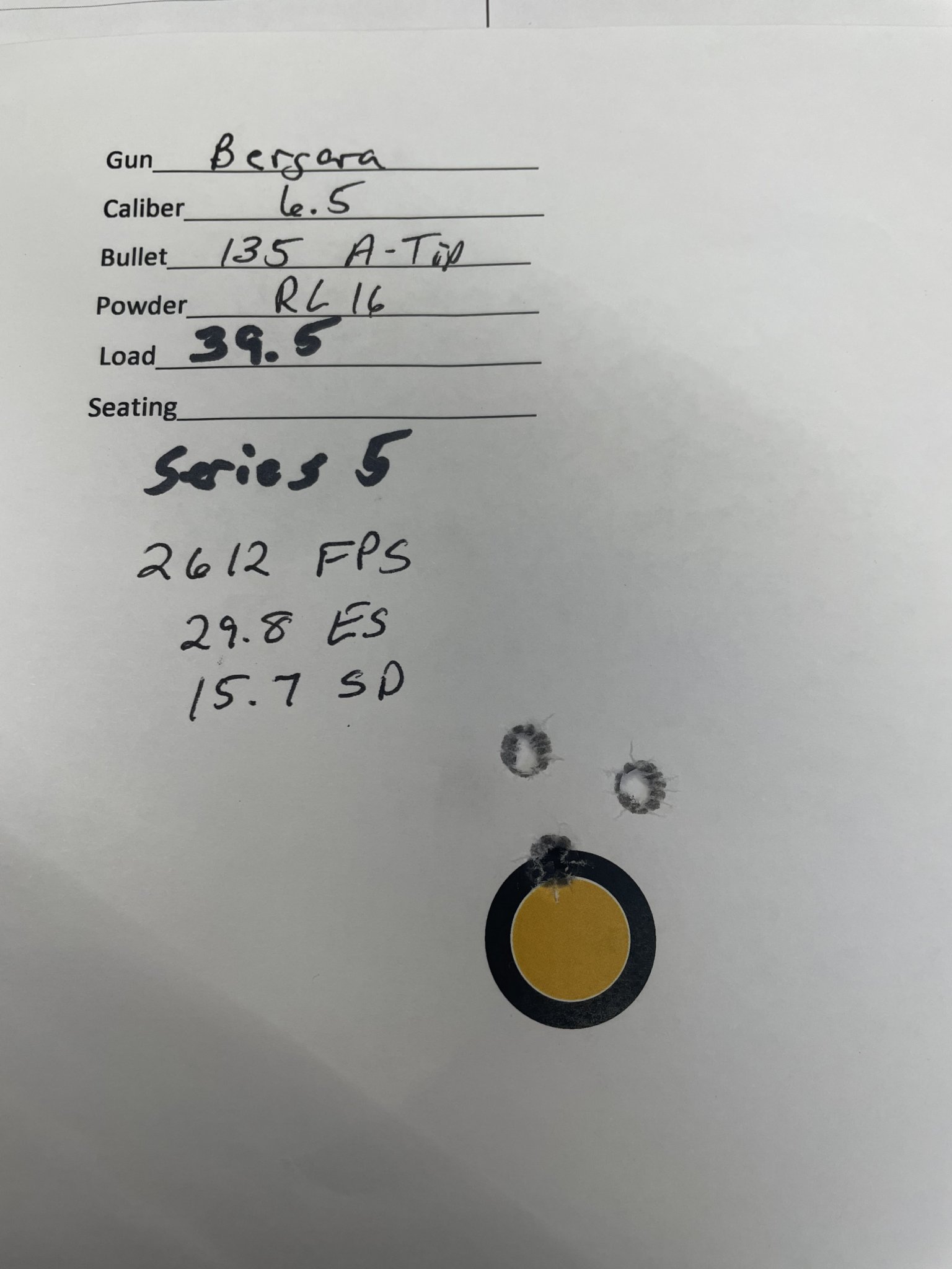

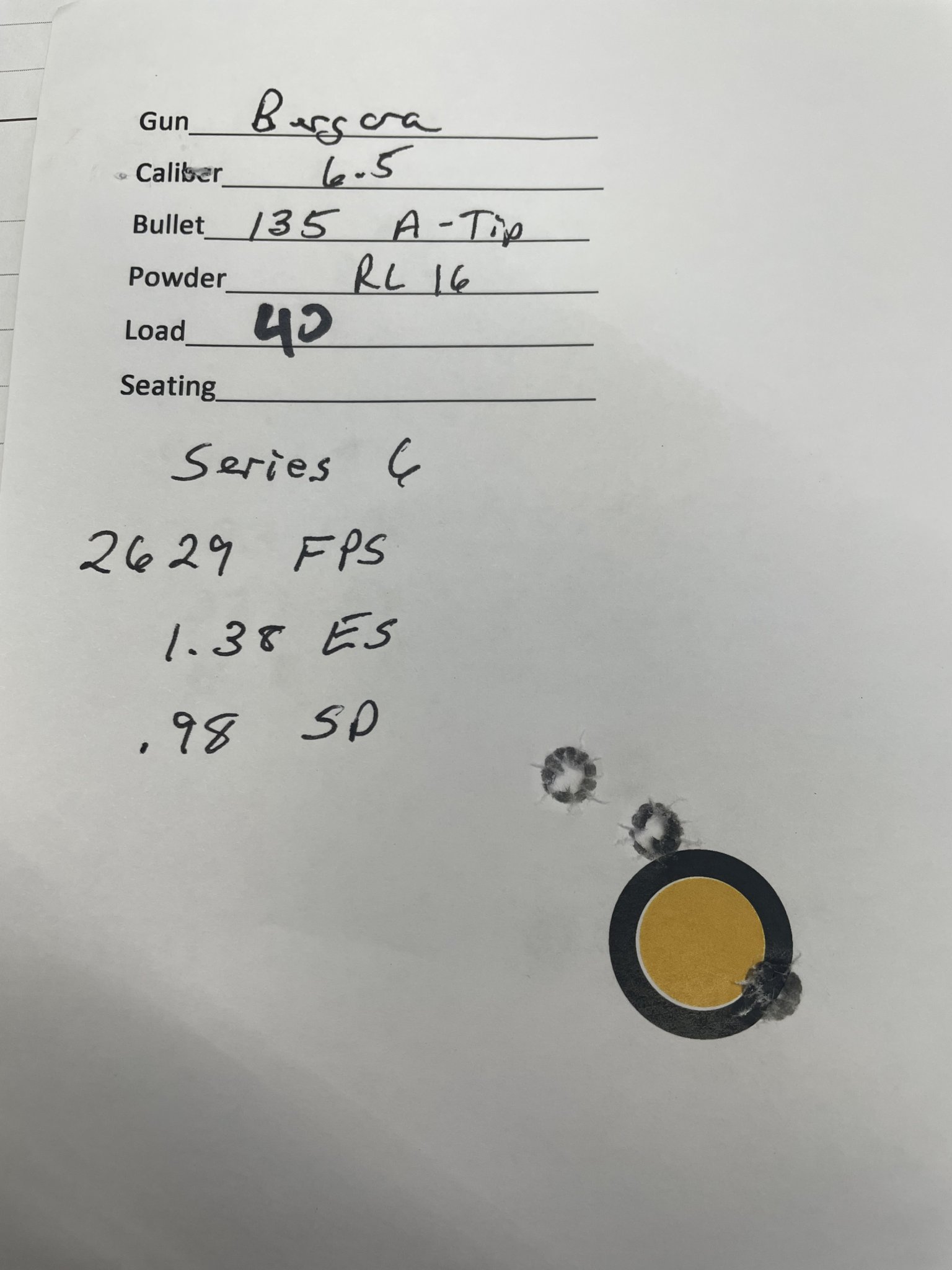

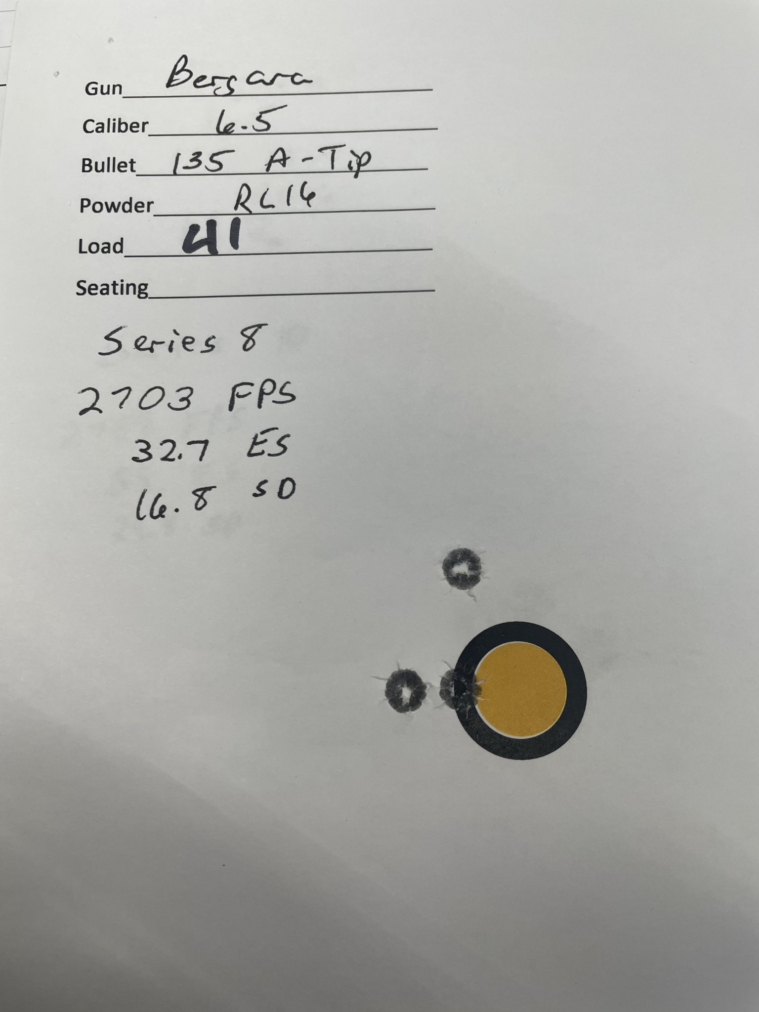

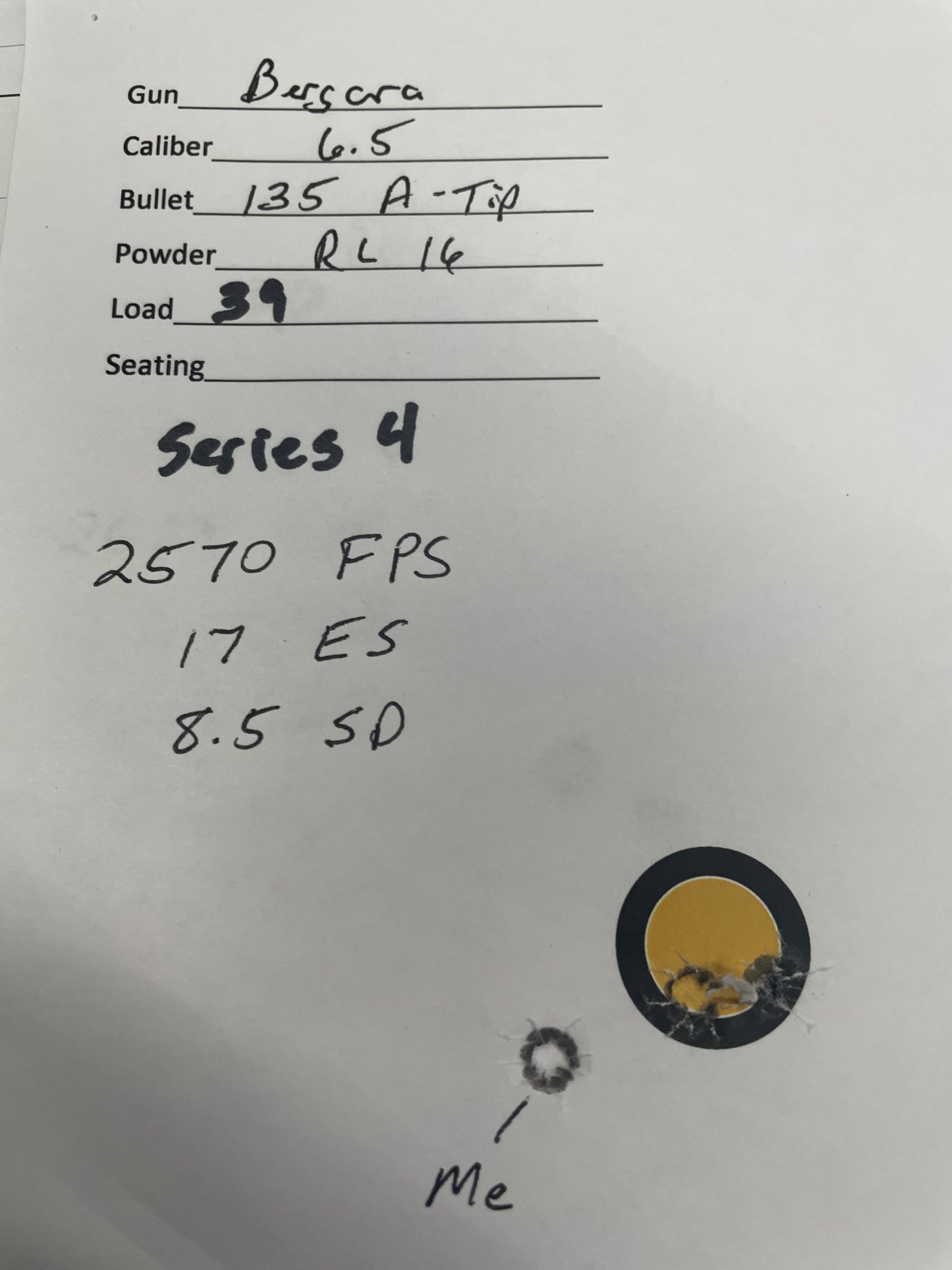

View attachment 8014491View attachment 8014493
That 38-38.5 looks pretty nice and consistent in point of impact if you are certain that it was you that caused the flier.
Half a grain raised you up only 16fps with a reasonable es/sd and it didnt drift somewhere else so thats where I would explore and verify it wasnt a fluke due to small sample sizes.
Both of the shots that are marked "ME" are definitely mine to own. I knew it as soon as they broke. I'll be doing some more exploring for sure. Thanks for all the help guys. I'll follow up with some 140 ELD-M with H4350 in the near future hopefully (weather dependent).
I still want to try to get some more speed eventually but I'm getting closer to getting something that works.
Also, I just ordered a 21st Century Mandrel Die and some Mandrels along with Moly Dry Lube. I use this step on my 300wm and have had great luck with it.

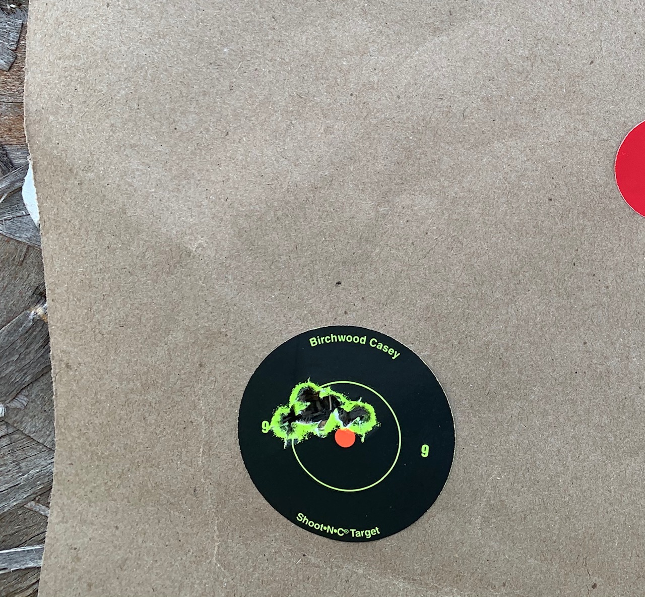

Below was my quick and dirty load work up recently done with 135 A-tip and RL16
My barrel is 25" PVA Rock Creek Button 8T (about 1100 on barrel)
Lapua sml primer brass. It gets annealed after each firing with a Mike's reloading bench flame annealer.
Redding type S FL with .289 bushing & expander removed. Shoulder bumped back .001 -.002
Dry Graphite lube. I run a 6mm VFD pellet saturated in the graphite through the neck instead of dipping the case.
21st Century .2625 mandrel
Fed 205 primer seated .003 below flush
Final load
RL16 - 44.2
135 A-tip loaded CBTO 2.205 = COAL 2.881. I like to always give COAL because ogive checkers can vary a lot depending on brand.
Jump to lands = .056
The starting jump & charges I picked after a lot of reading on here + modeling on Gordon's Reloading tool (Gordon's is free).
For this load I wasn't interested in finding a low node. My goal was 2900+ since this was for a match that went to 1900+y.
For me, having a defined goal and a time constraint keeps me from getting stuck in the quagmire of endless load development.
There was only enough time for 1 charge ladder followed by 1 jump ladder.
I shot 3 charges in PA at .050 jump 43.6, 43.9, & 44.2 and picked 44.2. Had the speed I was looking for with no pressure signs and shot a good 5 round group @100 with tight vertical.
I don't have pics of the first 2 charges just saved the one I picked 44.2
2 weeks later in MD same 44.2 charge, trying jumps CBTO 2.200 - 2.241
I got lucky on the first quick & dirty charge test. 2.200 & 2.205 CBTO shot the best @200y
I picked 2.205 as it seemed a little more in the middle of a forgiving zone. 2.886/2.210 shot a slightly better group &a 1 SD, but poi shifted and group opened @ 2.215
2.205/2.881 @200y with 44.2

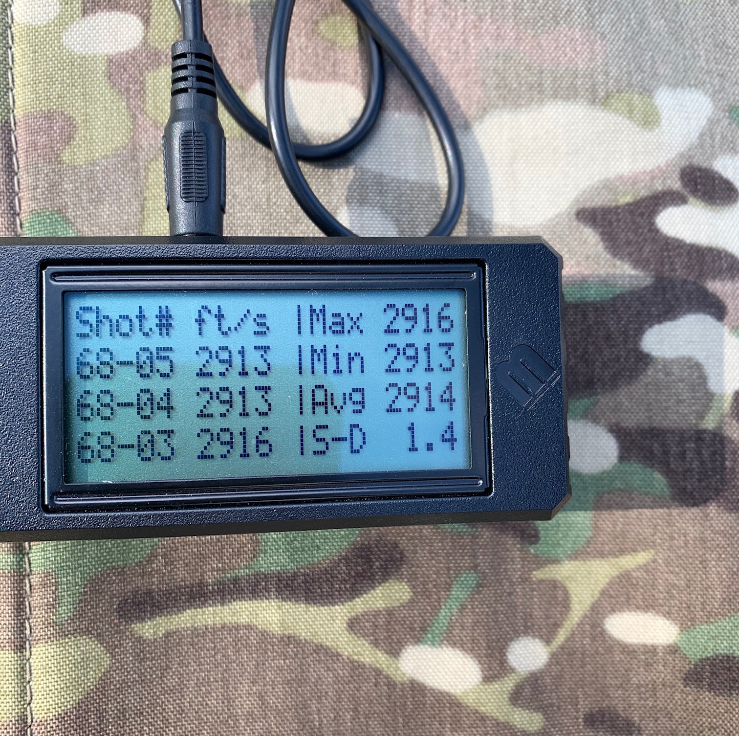

Get to the match on Friday & head over to the 100y berm, attach magneto expecting 2914ish with low SD.
Nope WTF, now I've got 2965 - 2990 & SD's are shit. Group is also shit @ 1 -1/2" Well fuck me!
Looking for pressure signs as I put these in the case & a fucking light bulb goes off. Fucking dumb ass, that prepped brass had cci #41's in it.
There it was, a fucking inadvertent primer change screwed my load. I know the 41's are hot, but damn +50 - 70fps is surprising.

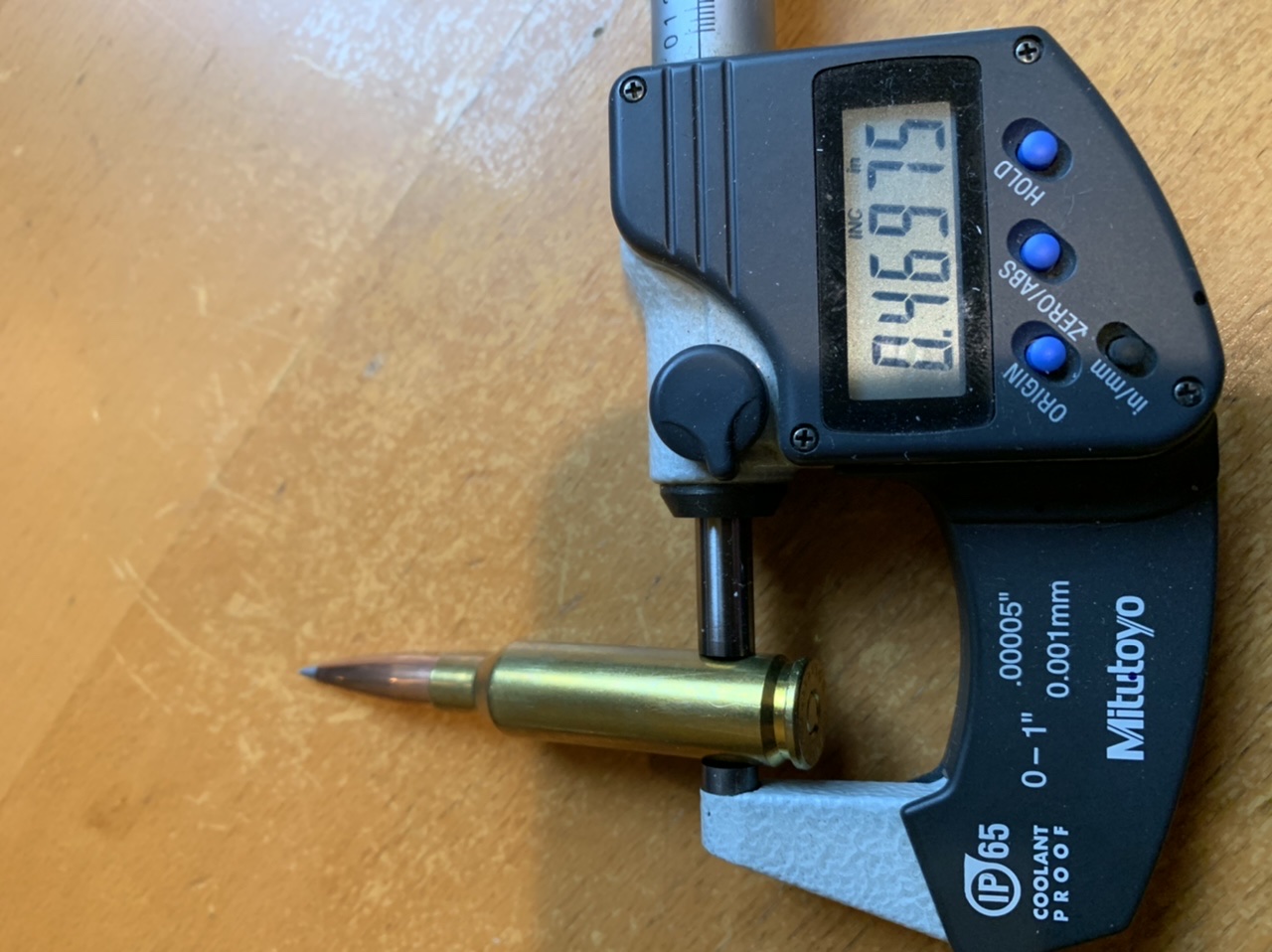

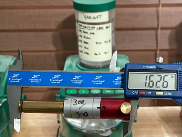

Check your fired brass using a headspace gauge and dial calipers (I use the Hornady tool).
Ideally you want your case head-shoulder measurement of your sized brass to be .001-.002 less than the same dimension on a fired case. Adjust your sizing die until that’s achieved.
FYI - Hornady brass typically has a more case capacity than most other brands which means you have to use more powder to achieve the same velocities vs others (Lapua, Federal, etc). Said differently, you will hit pressure with lower charge weights with non-Hornady brass so keep that in mind if you decide to change your brass.

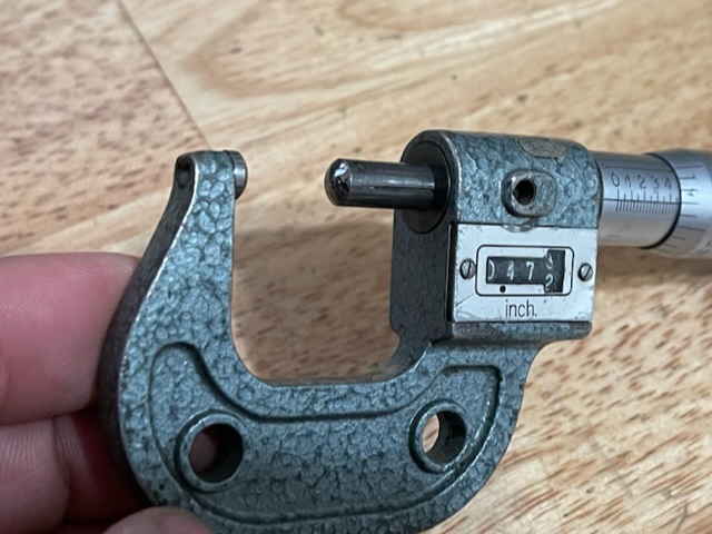

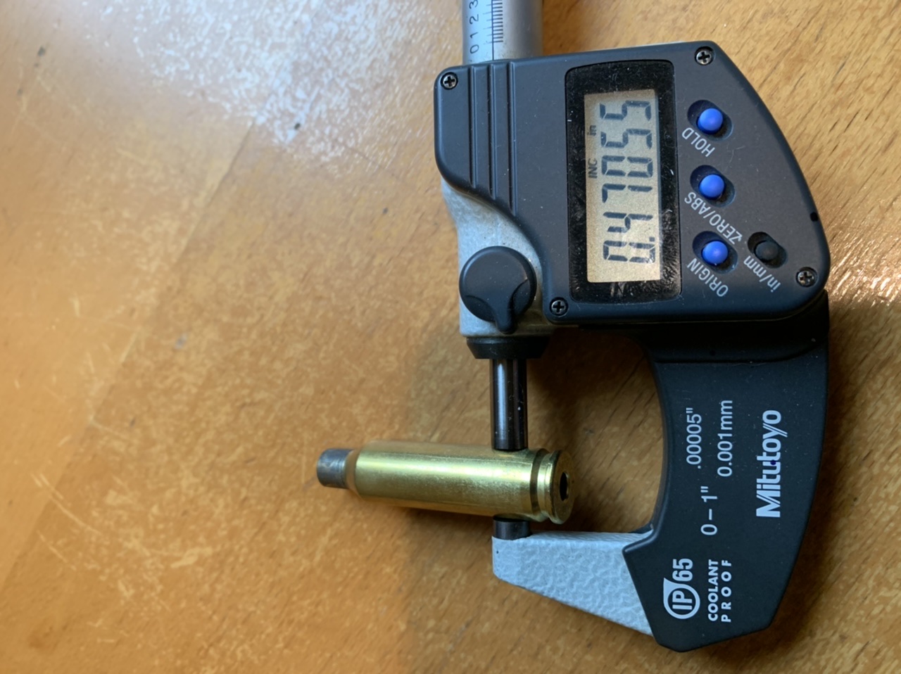

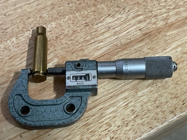

Simply use a quality mic at about .300 up from base. You should be able to see a line about .200 up from base. When measuring make sure the mic isn’t touching below that as it will give a bad reading.
I don’t have any aics magpuls, but I suspect the back is thicker & pushes the nose towards the feedramp. Should be able to get all the way to the lands with an Accurate mag or MDT binderless mag.
Perfect! thank you. I assume calipers may not be accurate enough or should I get the Mics?
A good set of calipers may tell you if the Hornady die is .002 under a fired case, but it’s not a good precision measurement tool.
Mitutoyo absolutes are capable of +-.0005 or half a Thousandth, but require a good feel for repeatable measures.
The Mitutoyo mic pictured is good to .00005 and has a slip ratchet to improve repeatable measurements.
Get a good mic, it will serve you well. As you can see from the photos. Sized - Fired is only .0008 different. The best calipers aren’t going to read 4th decimal place accurately.

Here’s the Hornady tool I was referring to that I use to measure case head to shoulder
I use this to set up my f/l sizing dies
I have that comparator (I think it's called?!)... I also have some pretty good calipers as mentioned above and that's exactly what I have been doing. I hadn't heard of what 357Max was referring to though. Thanks
He appears to be showing you how to detect pressure by measuring caseweb expansion on fired cases relative to the caseweb diameter before it was fired for any given charge weight (he can correct me if im mistaken about his intent).
That said, I do the same and prefer mics with ball anvils but a flat anvil is also fine. Any expansion greater than .0005 indicates pressure (at least that’s the threshold i use). Many times, the brass doesnt show visual pressure signs nor sticky/heavy bolt lift is present at .0005 so I consider it a “leading” indicator vs a lagging one.

Then you might better try some 4350 and a known good shooting bullet like the 140 eld or smk. It's just weird that you did get a group or maybe 2 that were consistent but then all the others weren't, but still, if you shoot multiple other guns consistently (notice I'm not saying "well" I'm saying consistently), then you need to just try some other stuff. I have some you can try. I have like 100 smk and maybe 70 eldm you can try. Just find you some 4350 and these 2 bullets will tell the tail for sure. Load 41.5 gr with both of these and load you 10 of each and shoot 1 target for each bullet then post it here. That will tell some info.
Pm me and let me know where to send em .
I did this finally! I know for some of you this will be inconclusive but he willingly sent me bullets and gave me the guidelines.
Here are the results. This is the only load I tested this day…. Definitely going to be playing with this combo.
2692 Avg FPS
23 ES
7 SD
The two circled in blue are all me!
Reactions: BuildingConceptsllc
2692 Avg FPS
23 ES
7 SD
The two circled in blue are all me!View attachment 8019646
So you are calling those circled in blue your fault ?
If so you could just roll with that charge weight and then doing a seating depth test. I figures they'd shoot for you with 4350. You could probably tune that a little with seating depth but whatever you decide from here on out, you are shooting some groups now .
Yep! The ones circled in blue were my fault. Called them both out that direction on trigger break.

Something isn’t right with that target. To believe an OCW test (to be confident the shooter/something else didn’t induce a bunch of dispersion) I want to see a clear poi shift between charge weights. That target is very random. How many groups did you shoot? Did you shoot them round robin?
It was shot round robin but conditions were difficult.
32F temperature with an 18mph wind gusting to 30mph.
It was shot round robin with every round chronographed with my LabRadar.
Here is my other thread with more data.
https://www.snipershide.com/shooting/threads/which-node-would-you-use.7169057/
Here is the first OCW test I did.
The difference is the bottom target is with Lapua brass and the top one is with Federal.
There is a nearly 3% difference in case capacity.
This is a more complete picture actually shot at 0F but no wind from a covered position.
I couldn’t use the chronograph due to the overhang on the building.
That one makes more sense, especially if it was shot RR. I think you’re making too big of a jump between charges. I’d be going in .2gr increments. With that big of a jump in a creedmoor case you’re missing data on the in between charges so the target is going to be harder to read.

This is the data from my 41.3gr H4350 load in Lapua brass.
I don’t know how much it will increase as the weather gets warmer.
