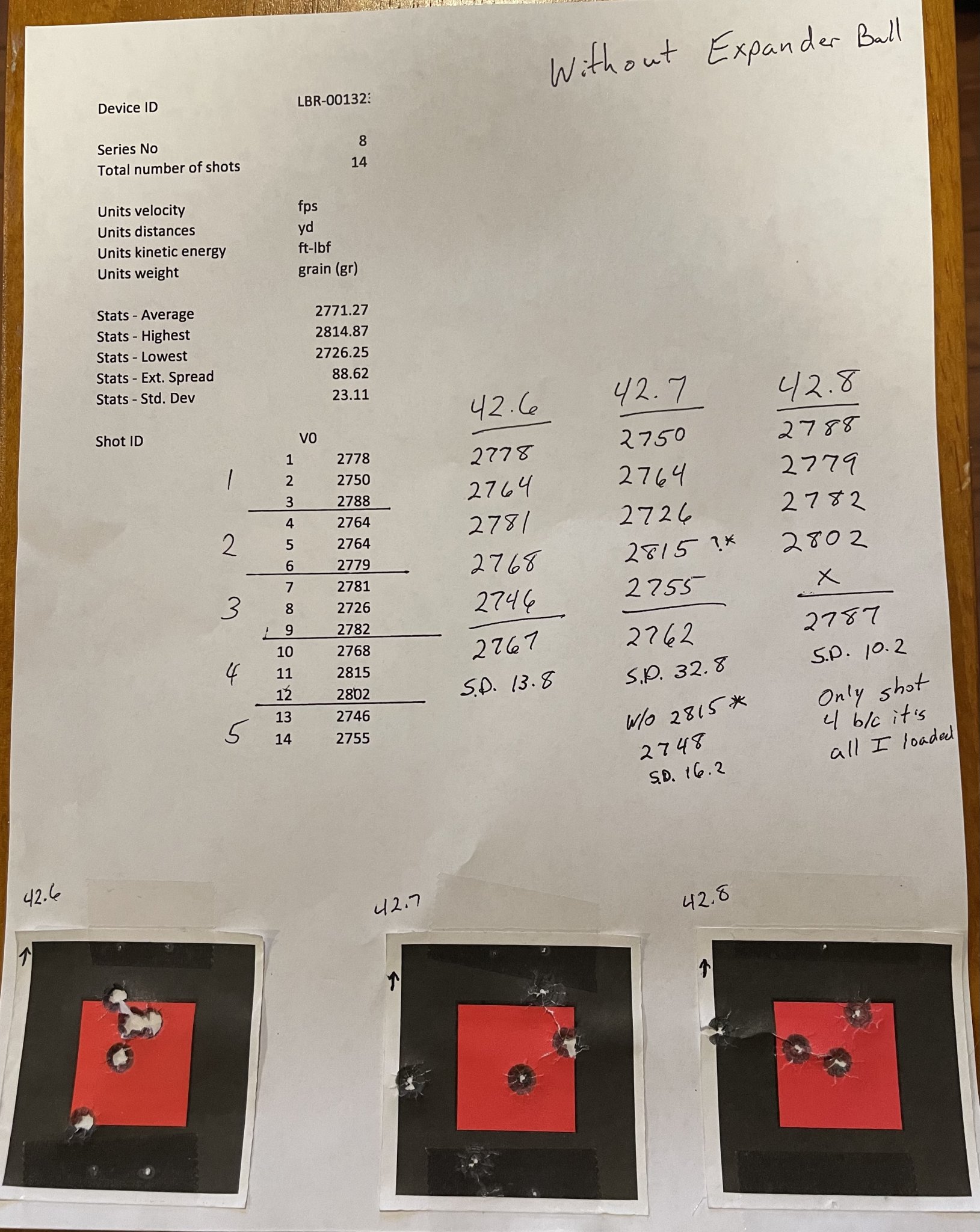

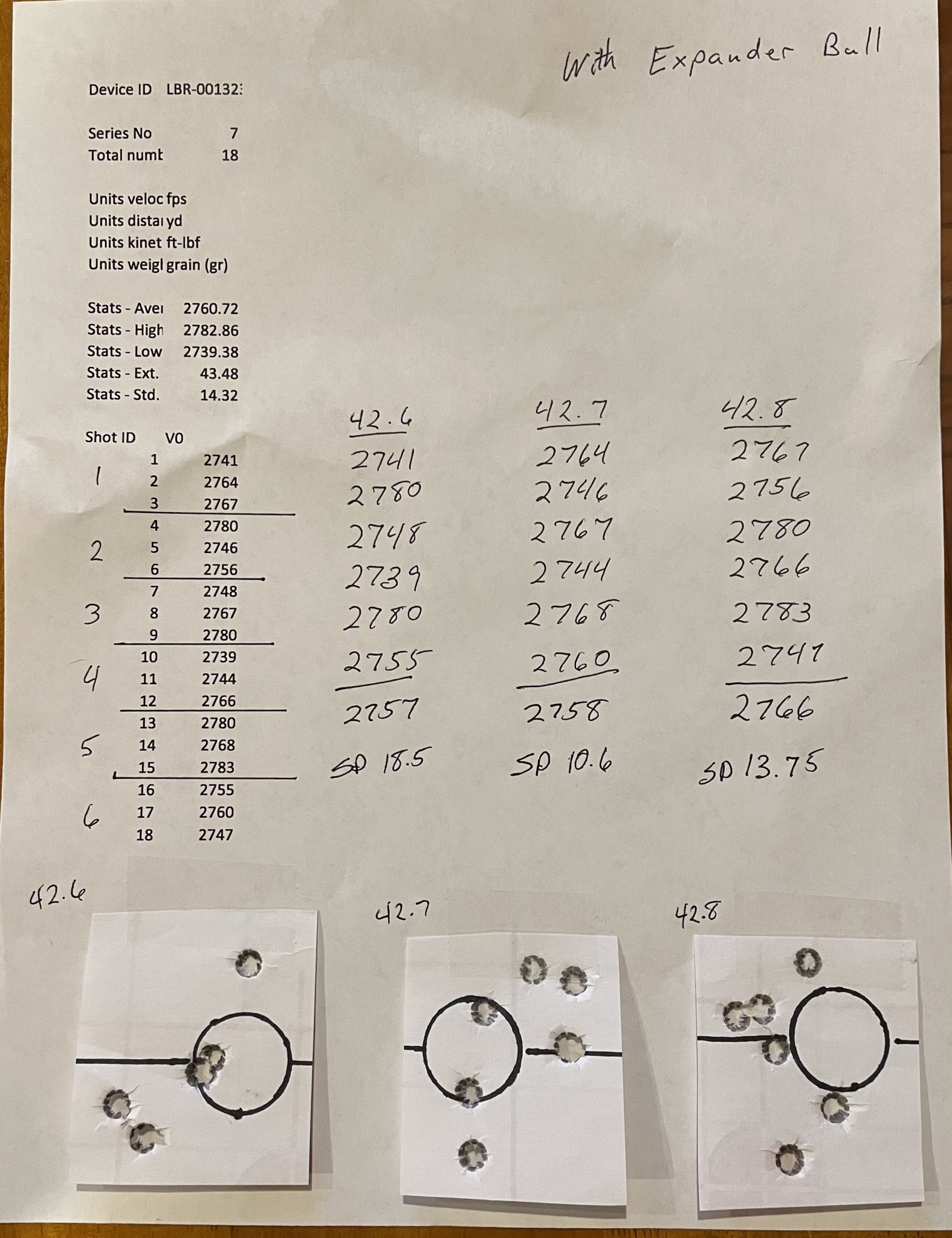

First test! I installed the “sizing ball” on the die. Processed the brass exactly the same as before. Neck tension was the same 0.004”.
Loaded 6 rounds at each grain weight!
Results
Note- circle is the outline of a penny
Removed “sizing ball” and loaded prepped brass again. I fucked up and only loaded 4 at 42.8 but 5 for the first two.
Results
Note -red square is 1”
Was this another OCW? If so, why did you load/fire 6 per charge weight instead of 3? More than three makes it harder to see where the true POI center, especially with the first set…also SD/ES are irrelevant at this stage so dont make any decisions based on those numbers at this point.
ETA: i also load an extra round for each cw but don’t use it unless i really screw up one of the other shots.
were those last groups at 100? I think this is possibly more shooter than anything. Well also something is funky in the reloading room also, those are some pretty high ES
That’s why i only do three rounds in an OCW. Using the red squares, eliminate the center impact in the first, left most square, along with the the impacts at 7 oclock and do the same with the middle red square, leaving the third alone (or eliminate the hole at nine oclock) and it looks like a good node. But it’s not that simple, lol.
O well, think he’s relatively new to reloading so he’ll learn…Sd/es may be high but ive seen them peak at about 10-15 rounds in a string then fall back down to the mean by round 20-30 or so…that’s why you need bare min of 20 but ideally at least 30 before the info is useful

So if you look at my previous post with the red square targets, one set was shot with the expander installed and the other with it removed…. Everything else being equal. From what I can see it did not like having the expander ball installed.
I appreciate you input and I’ll take a look at some of methods mentioned.

Can we have more info on the rifle specs and how you are shooting these? tripod? camping chair? bipod on a cement bench? sled? rear bag?
if im being honest this looks like shooter/equipment induced poi shift. has this gun ever shot tight groups?
the reason I say this is because the group is moving in all direction relative to the center of aim and what looks like a flyer on each.
I like spifes suggestion to try a lower charge. I would do 3rds every .2 though its just a higher resolution if there is a poi pattern you're more likely to catch it. some of my most accurate 6.5CM loads were lower velocities. sometimes it is what it is.
I think the info you are looking for is in the edited OP! I added it but am realizing some don’t go back to look that far.

Gun has never shot one hole type groups. In fact the groups you have seen with the 42.6 and 42.8 loads are the best I’ve ever gotten with it. On its best day along with my best day I’d call it about a 3/4 gun…
A lot a questions come in about the shooter. Yes, I’m human and yes I error. I can shoot though. I’m new to reloading, not shooting. I can drop my pedigree but it won’t impress anyone here so I don’t want to start that fire.

On the two round robin sets of targets, one was shot with an expander ball and one with out. That was in response to guys saying I should use an expander and those groups were horrible (the circles). On the same range session I ran the same loads without the expander ball and they tightened back up some (red squares).

If thats the case then I would just pick a charge like the 42.8 and work on neck tension or seating depth. some bullets like more jump than others. as a last resort I would try a different bullet or powder, whichever I had the least of.

That’s about where I’m at with what I’ve got at the moment. Rather than just keep burning them up with no real good results.
I agree with you about getting off the gun, back on and shooting same POI. But this is load development, not a match or a hunt or or a fundamentals class or whatever. I know you’re not looking at groups for the sake of their size, but you are looking for a central point around which your shots land. I can’t argue with your point at all. But it’s not an argument for or against round robin shooting that I can tell. All I’m taking from what you’re saying is that if someone has shitty fundamentals, they’re not going to glean anything from an OCW test. Which I agree with completely.
Shooting round robin is much more important than a lot of ppl realize. The whole point of an OCW test is to correlate changes in ammo with changes in POI in order to identify a window a charges that produce a similar POI . The hard part is that it’s very, very easy for the shooter himself to cause significant changes in POI. A change in cheek pressure can change poi. Not being square to the rifle can change poi. The angle that you pull the trigger can change poi. The way you breathe, a change in mindset/focus, being fatigued, etc… can all cause a significant change in POI.
Shooting round robin spreads those variables out over the whole test vs injecting them into a single group/charge weight.
Example- you didn’t get square behind the rifle on group 3:
If you’re shooting separate groups for each charge weight you’re going to see a POI shift on group 3 and think that the charge weight is the cause when in fact it’s just a product of bad alignment. If you’re shooting round robin the POI shift will be spread over all of the groups. This may make the test harder to read but it will go a long way to prevent a false result.
The false result we see posted most is when the target is a mess but there are one or two decent groups on target. If it wasn’t shot round robin, there’s a pretty decent chance that the better groups have little to do with the ammo and just show that the shooter had better focus/trigger control/body position/etc… on those one/two strings. If you shoot a test RR and see a pattern on target, the chances of the pattern being shooter induced are very slim bc each group is made up of a shingle shot from each string. It almost makes it a blind test.
I agree one thousand percent with your premise. Im not cherry picking any one thing you said other than to point out that this line sums up about half of what I’m getting at. It’s been pointed out in this thread that shit fundamentals is going to render an OCW pretty useless. (OP, I’m not singling you out…I’m just making a broader point). To your point, if a cluster of charges is shot round robin, and the shooter addresses the rifle say, 5 different ways across say, 15 shots, then the center of the various groups could just as easily wonder around on the target as they could if the shooter addressed the rifle 5 different ways across 15 shots but shot all charge weights in ascending order. Your point is taken, and it’s valid, and I challenge anyone who decides to undergo an OCW for the first time to spend some time thinking about how they should approach it, knowing that garbage in is going to equal garbage out every time.
