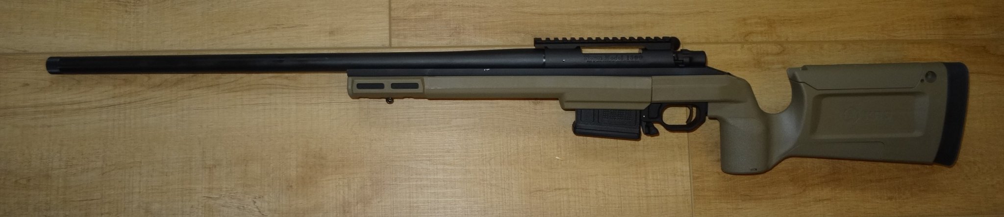

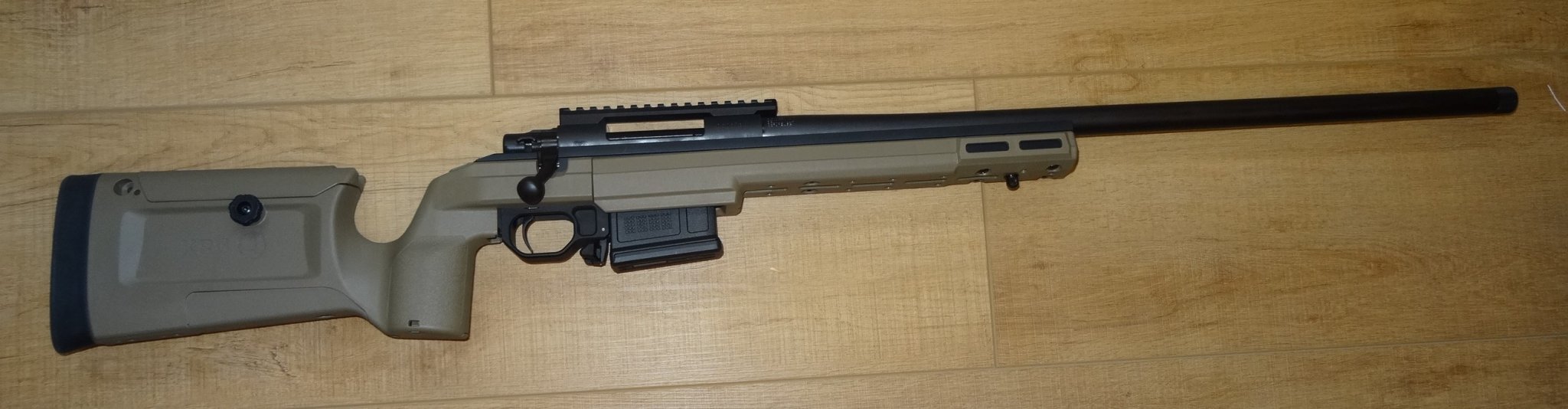

I ultimately went with the KRG. Shown here with a Talley scope mount.
Also have a pair of 30MM Seekins rings for it.
