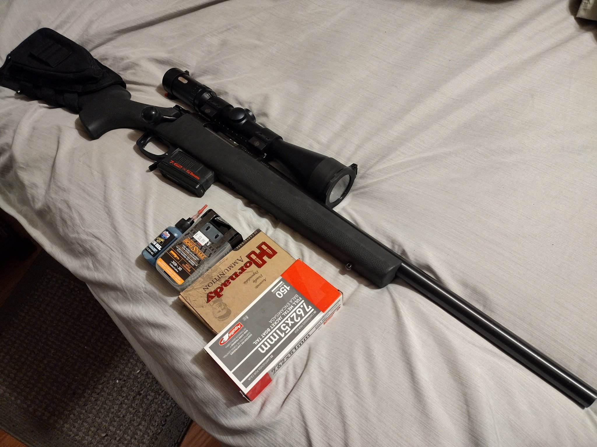

I have a few lathes in the shop, so bought some 6061 tubing and acetal (delrin) rod, and made my own rod guide. Since my machines are all manual, and took several different set-ups to machine the various parts, it's not practical for me to make a run of these guides. But perhaps one of the companies that are making aluminum DBMs to replace the cheezy plastic ones could be convinced that there's enough of a market for them so that making rod guides for the Mini would pay?...hint, hint...

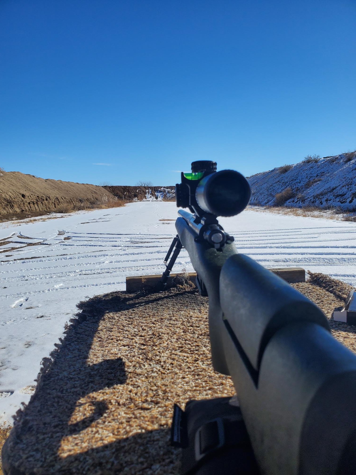

I was supposed to be at the lease today to finally sight it in. I been busy with work and stuff. But more shit got in the way lol. Hopefully I can make it tomorrow or sometime this week as I start work again on Monday at Waco.
I'm really liking how this little build turned out. It's going to make a great deer rifle.

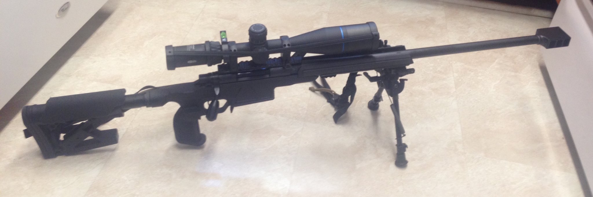

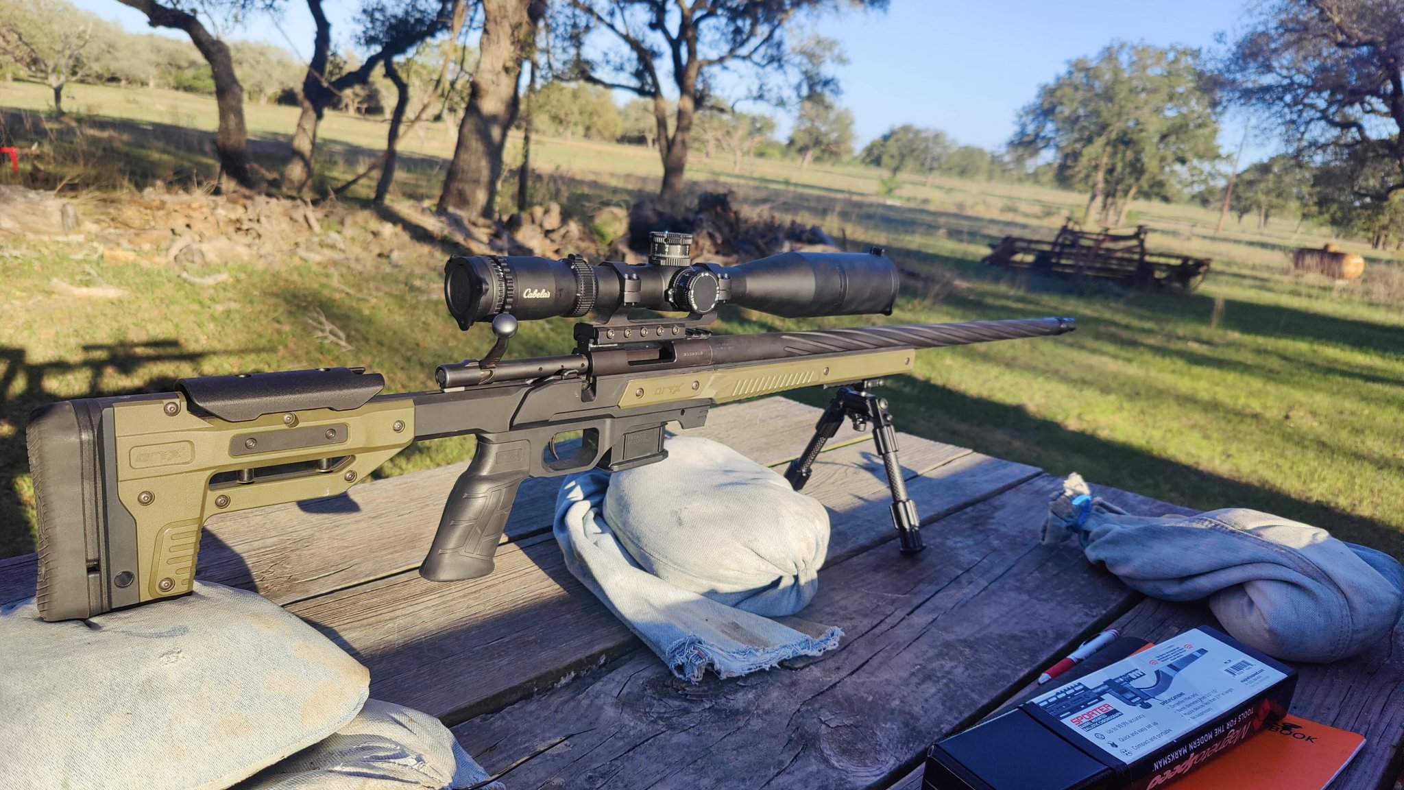

I finally got everything together and took this beast to the range today.
From the bench at 100 yards, .75" with Magtech 147 grain 7.62x51 FMJ.
While there are better options, this beast is all mine. :)
Howa 1500 in .308 Winchester with a 24" Barrel, #6 Contour / 1:10 Rifling in a Howa Chassis System (Accurate Mag Sport-Tact Lite)
And now from rear to front:
- Magpul CTR with .50" Cheek Rest and Limbsaver Recoil Pad (stock play lovingly tightened using HVAC tape) with an Urban Rifleman LLC Bag Rider
- Anarchy Outdoors Alpha Grip
- Extended Bolt Knob by Tactical Works
- MDT 20 MOA Picatinny Scope Base
- Leupold Mark 4 30mm Super High Aluminum Rings
- Meopta Optika6 3-18x50mm MRAD1 Reticle and Sunshade
-Vortex Level (The Thick One)
- Harris SL-M 9" to 13" Bipod with ADM Quick Release Picatinny and Tactical Works Steel Mini Bipod Locking Lever
- Colorado Precision Rifle Sling
- 4AW Muzzle brake 3 port (5/8x24 thread) timed with Precision Armament Accu-Washer

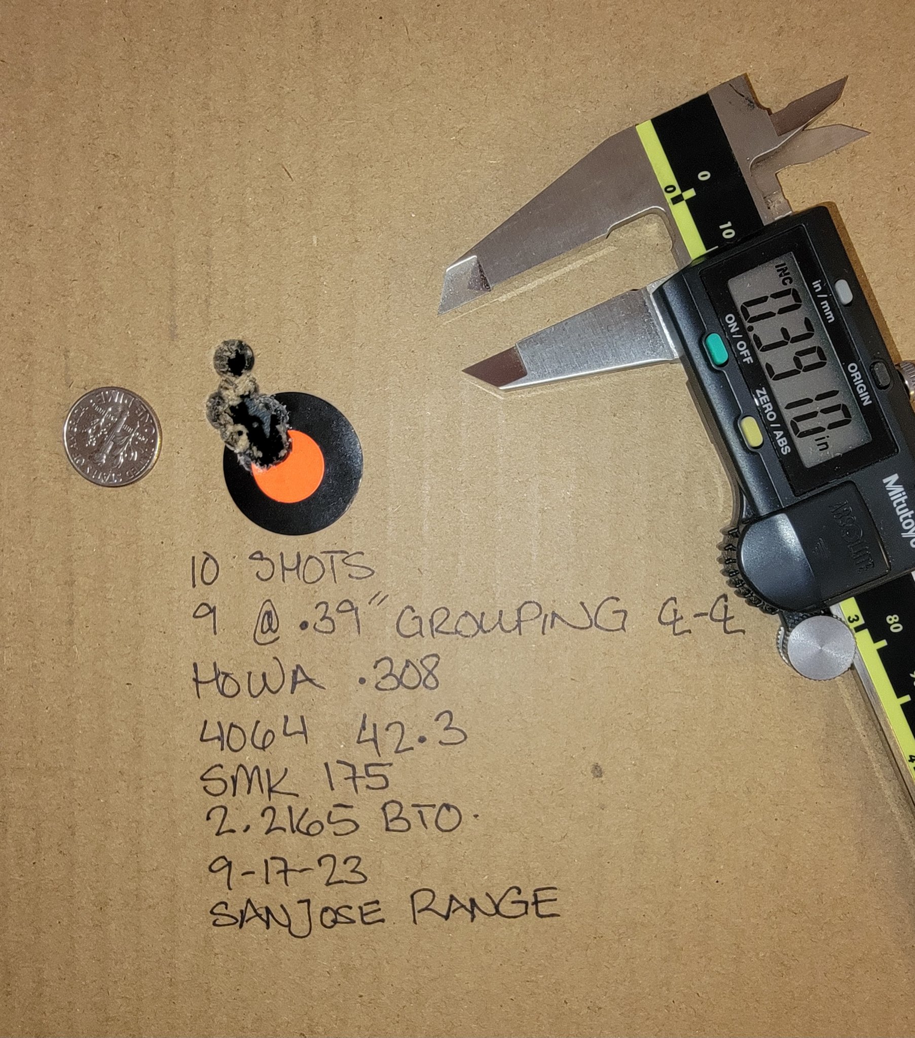

So I have unfucked myself. I have gotten the gun to 1 MOA with cheaper SB HPTB and IMI 7.62 175 OTM. I got to .69 moa with horny 168 Grain A Max and .98 Moa with 175 Fed Gold Medal Sierra match. The guy that owns the range I got to who's I guess the county commish was Navy Seal for a while he got excited when I said I'm going to zero my MK12 then I said, I fucking suck at this 308 he came with me watched me had me dry fire. He said my fundamentals were good lob one down range for me. Wooden shooting bench bipod....gun kinda jumped and slid. He then told me to fold up my bipod legs, and use my backpack as a rest. I went from 3 to 4 moa down to 2.01 with some cheaper PPU matchline 168. I had a lot of boxing of ammo with me to test what my gun liked by the end of 4 hours he had me down to that .69 moa. I guess now I see why Henry from 9 holes reviews always shoots off his backpack vs bipods on that wooden shooting platform he's on.

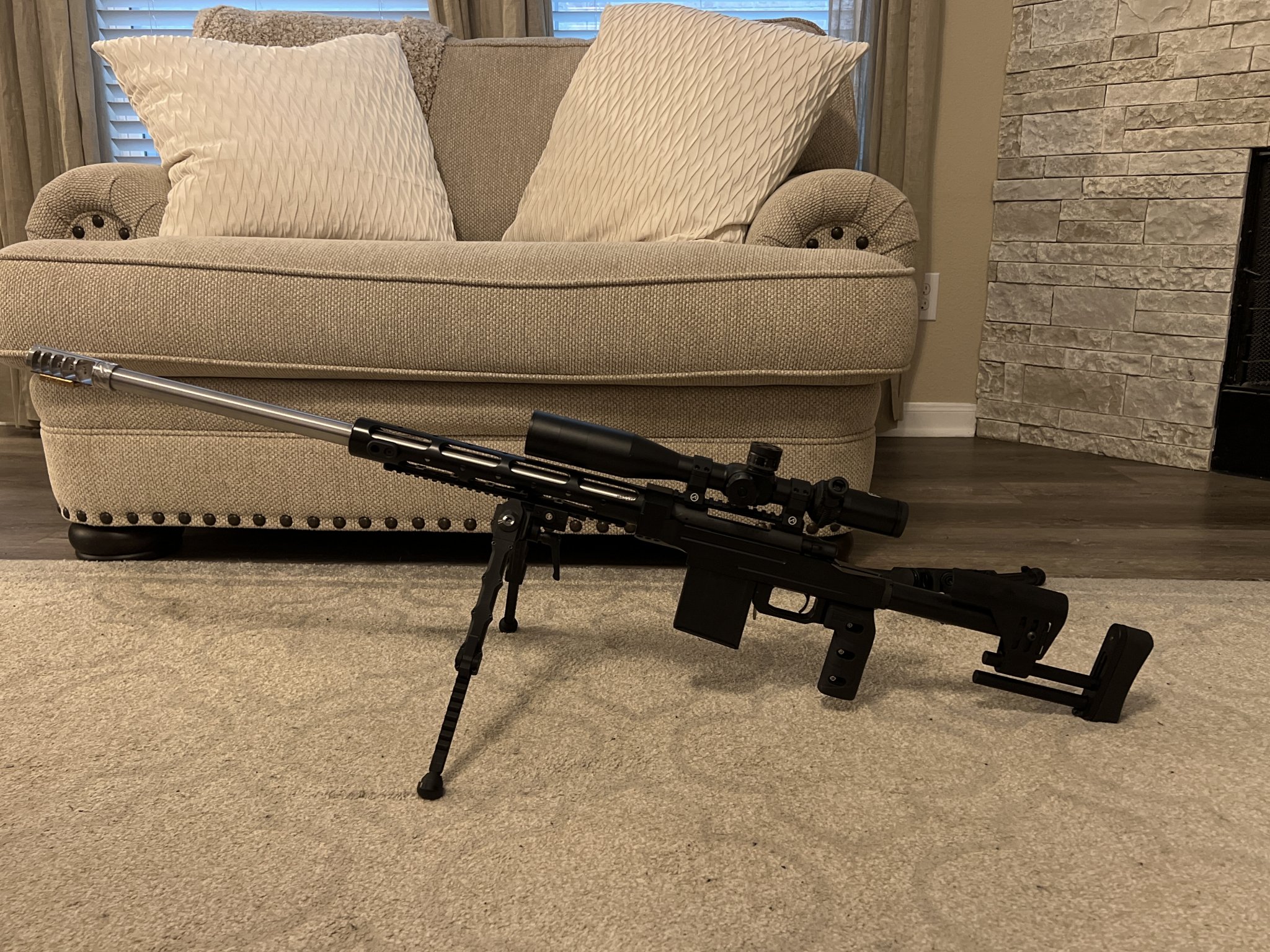

Finally have my grendel build finished
Howa Mini Action
28“ 1:8 twist Bartlein heavy varmint
6.5 grendel/ 264 LBC-AR chamber
Mdt oryx chassis
Jard 8oz trigger
Cabela's CX-PRO 5-25x56. Mil reticle
Leupold mk-ar mount
Caldwell bipod (bout to replace)

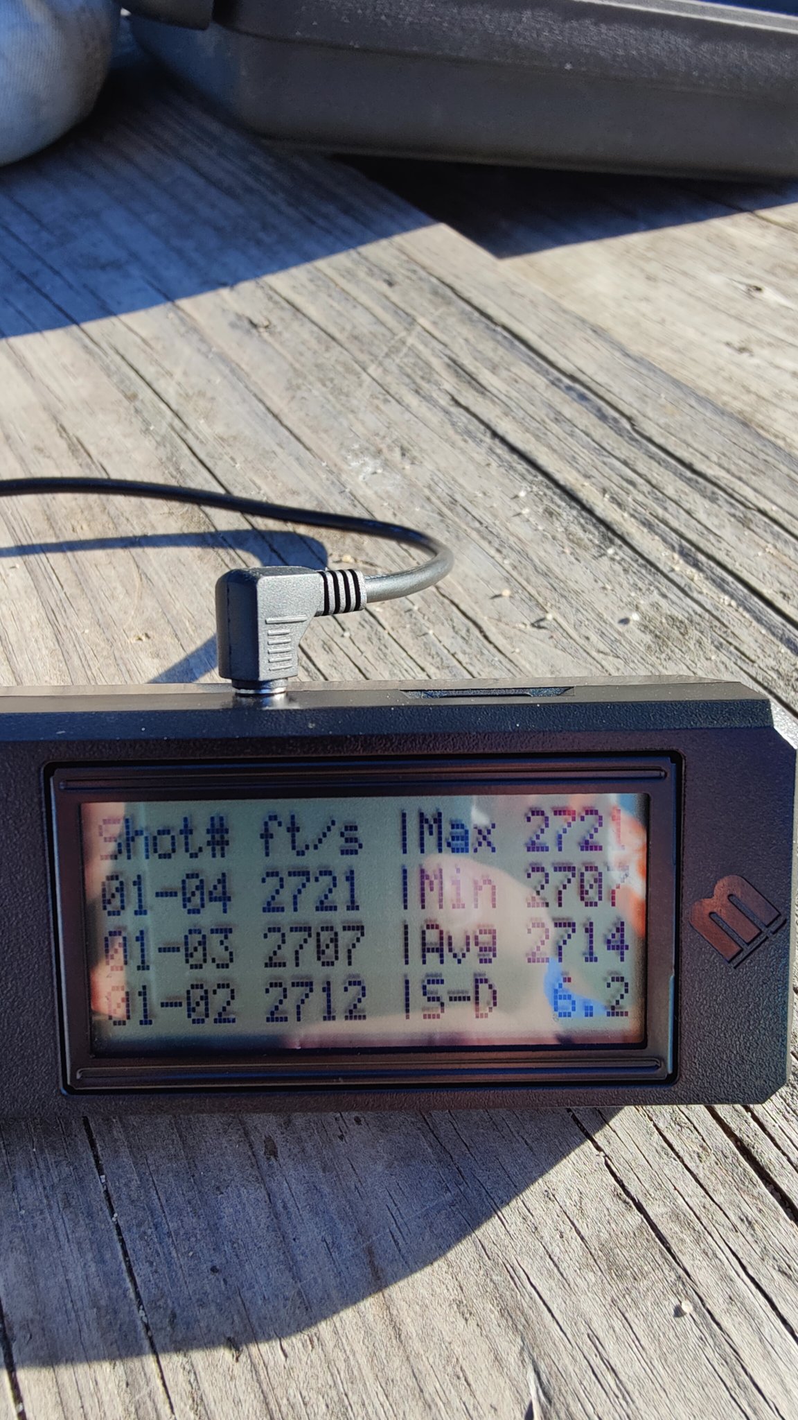

Getting avg 2714 fps with 130gr eldm, 30.2gr of h4895, cci 450 primers, and Hornady brass.
View attachment 7908275View attachment 7908277

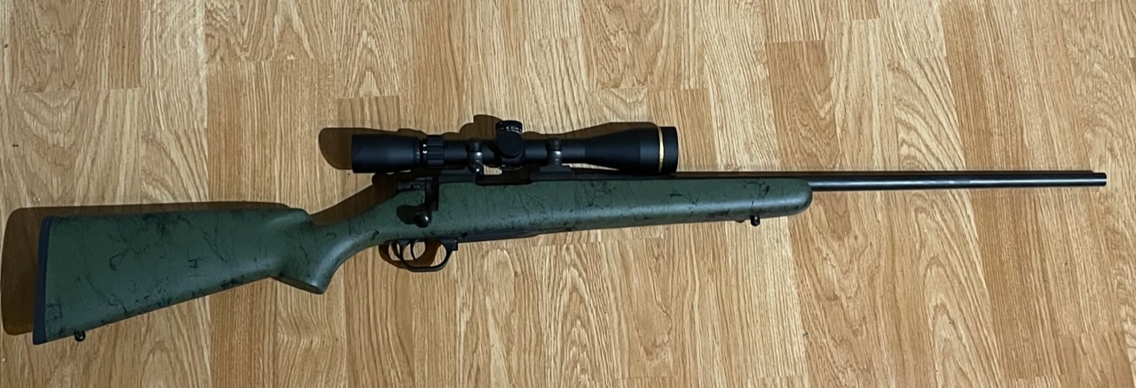

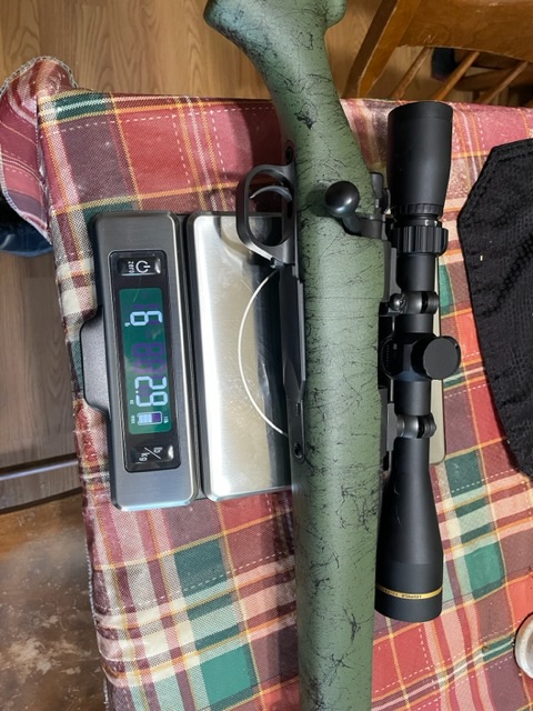

Not much of an exotic build. My father wanted a compact, light, deer rifle that he doesn’t plan on shooting over 200M with.
Howa 1500 Mini 6.5 Grendel 1:8 Factory Sporter
Oregunsmithing Bottom Metal
Pendleton Custom Stock’s Carbon Fiber
Leupold VX-Freedom 39x40mm
Leupold Classic Rings and Bases
6 pounds 2.9 ounces.
I have a load that averages 2535fps and has given multiple 1/2” 3 shot groups at 100 yards. Slowly building group data by using the FIRST GROUP only for each trip. 1 cold bore and 2 follow up 1 minute between shots. The POI has remained consistent as has the group size. I just need more trips/samples to call it a true 1/2” load.
By the time he is healed from back surgery it will be ready for him.

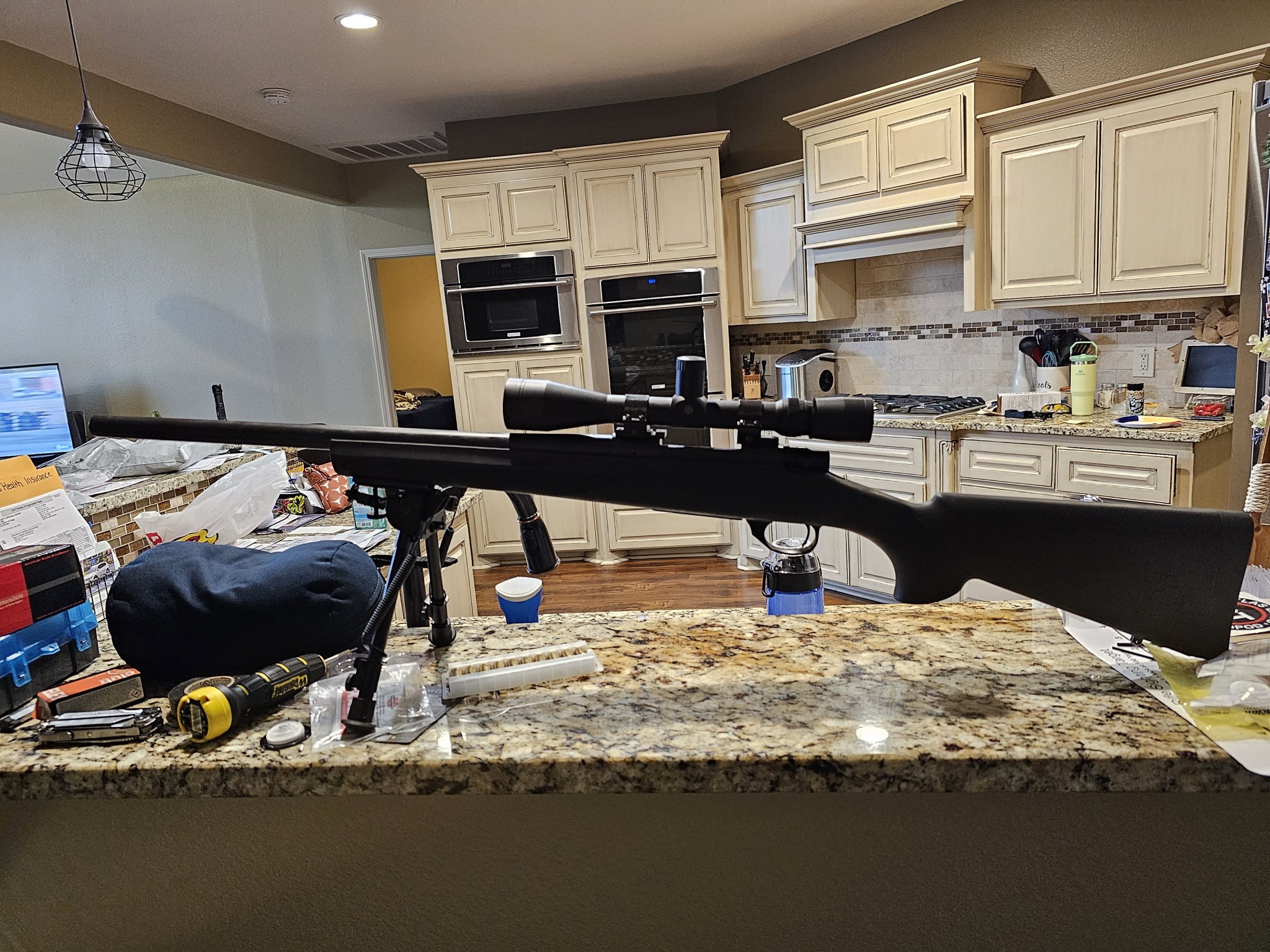

This 308 started life as an Axiom. It ended up in the following configuration before I just passed it on to my son. 20" heavier contour barrel, slick action, tuned HACT trigger to 3.5#, outer impact scope rail, Warn rings, Japan made Tasco Titan 4-12x56 with Butler Creek element flip caps, Hogue stock has a triangle aluminum strut epoxied into the forearm & action and Atalasworx DBM are Devcon bedded. I also included a new sling, case & some starter ammo.
Reactions: stanley_white
This 6.5cm 16" heavy threaded barreled action ended up in my Axiom stock which has a triangle aluminum strut epoxied into its forearm and action and PT&G DBM Devcon bedded into it, Timney trigger, Vortex Strike Eagle 4-24x50 in a DNZ one piece mount, and a now rare Surefire 6.5 muzzle brake. In this pic it's wearing my only Warden that can be quickly changed to most of my rifles. I keep finding myself in need of just one more Surefire muzzle device...
Ready to bed the same action, but in 308 into a B&C stock, I think I'll buy this same glass again and another will be almost finished, both these will need some action love to smooth them out.

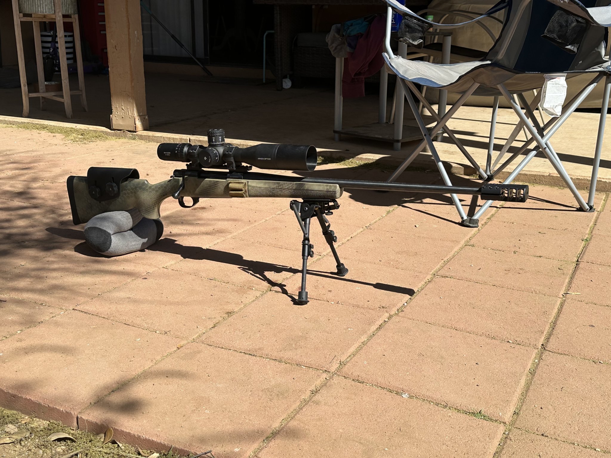

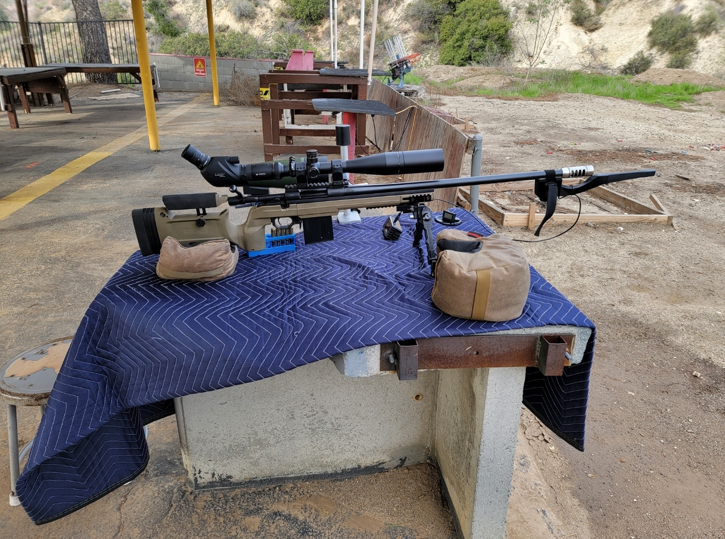

HOWA 1500 BA
1:10 twist
Sitting in KRG Bravo
SuperCal bipod
Vortex optics
EC muzzle device/tuner
ETA: This was a consistent ⅝ shooter. I cut the trigger spring by coil and a half and it went down to 1lb3oz trigger and I filled the stock with weight.
Now it shoots as pictured.

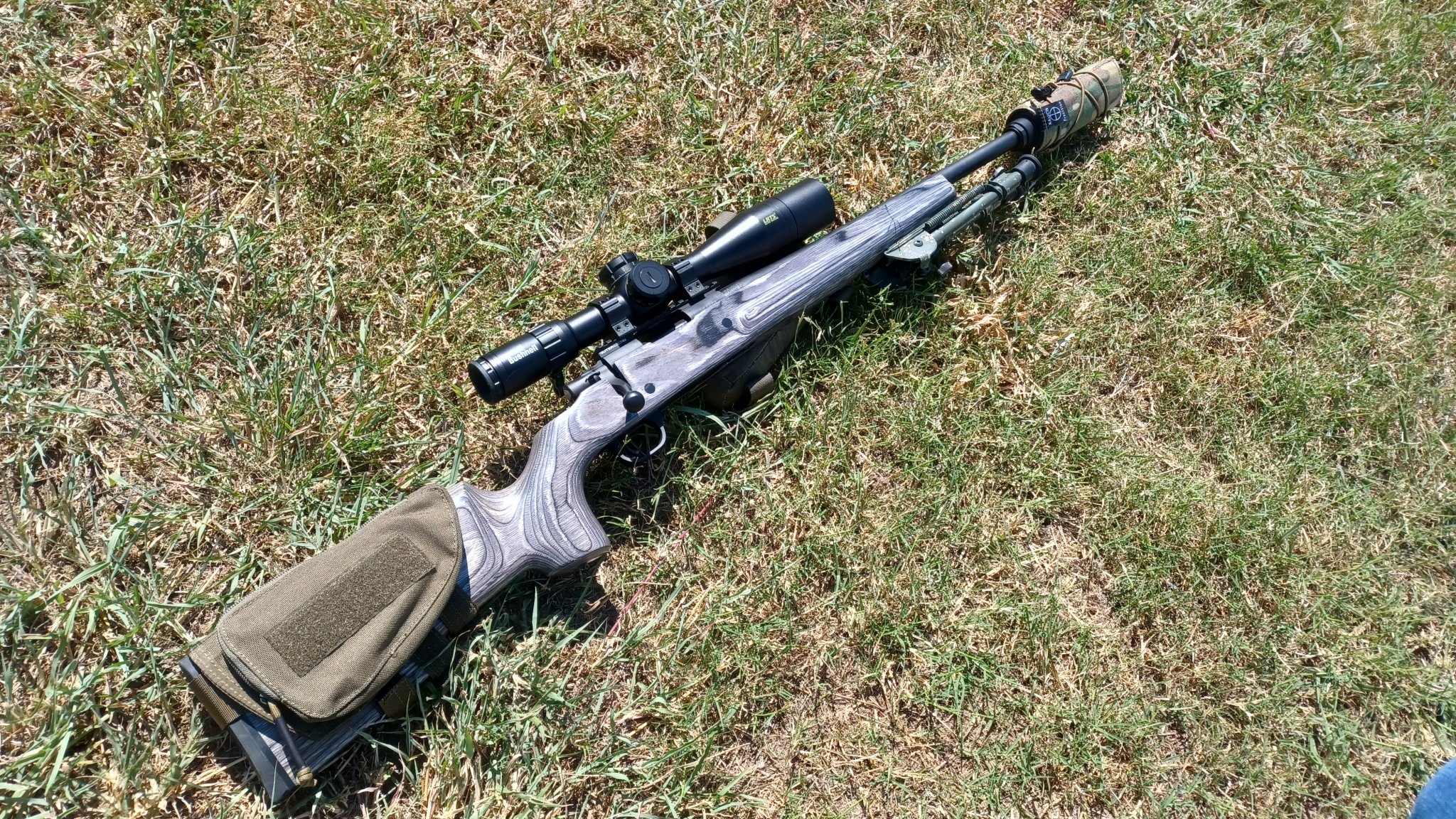

Did some more load testing yesterday Howa 1500 .223 - 77 gn Sierra TMK , with my Factory 20 inch fluted Heavy Barrel , threaded Muzzle / Stocky's Factory Seconds Carbon Stock .
Haven't finalised the load yet , but best of the three tested averaged under 1/2 inch , all three averaged under 3/4 inch ( only 3 x 3 shot groups so not exactly conclusive , but something to work with )
I put this thing aside for awhile because I got tempted to the " Dark Side " of Tikka's .
I revisited the Howa while having some doubts about my Tikka .223 , and realised that the " Cheap Old Howa" actually shot better .
The Tikka is on it's way to the Gunsmith to become a 6x45 / 6mm223 , so not all is lost .
PS- The slip on Limb Saver Recoil Pad is to add length to the stupidly short stock , not to tame the excessive recoil :D.

Great looking rifle. It is hard to tell, but do you have one of the Mini actions or one of the lucky few with the Short action 1500 in 223?
It’s a 1500 SA - Not the Mini Action .
