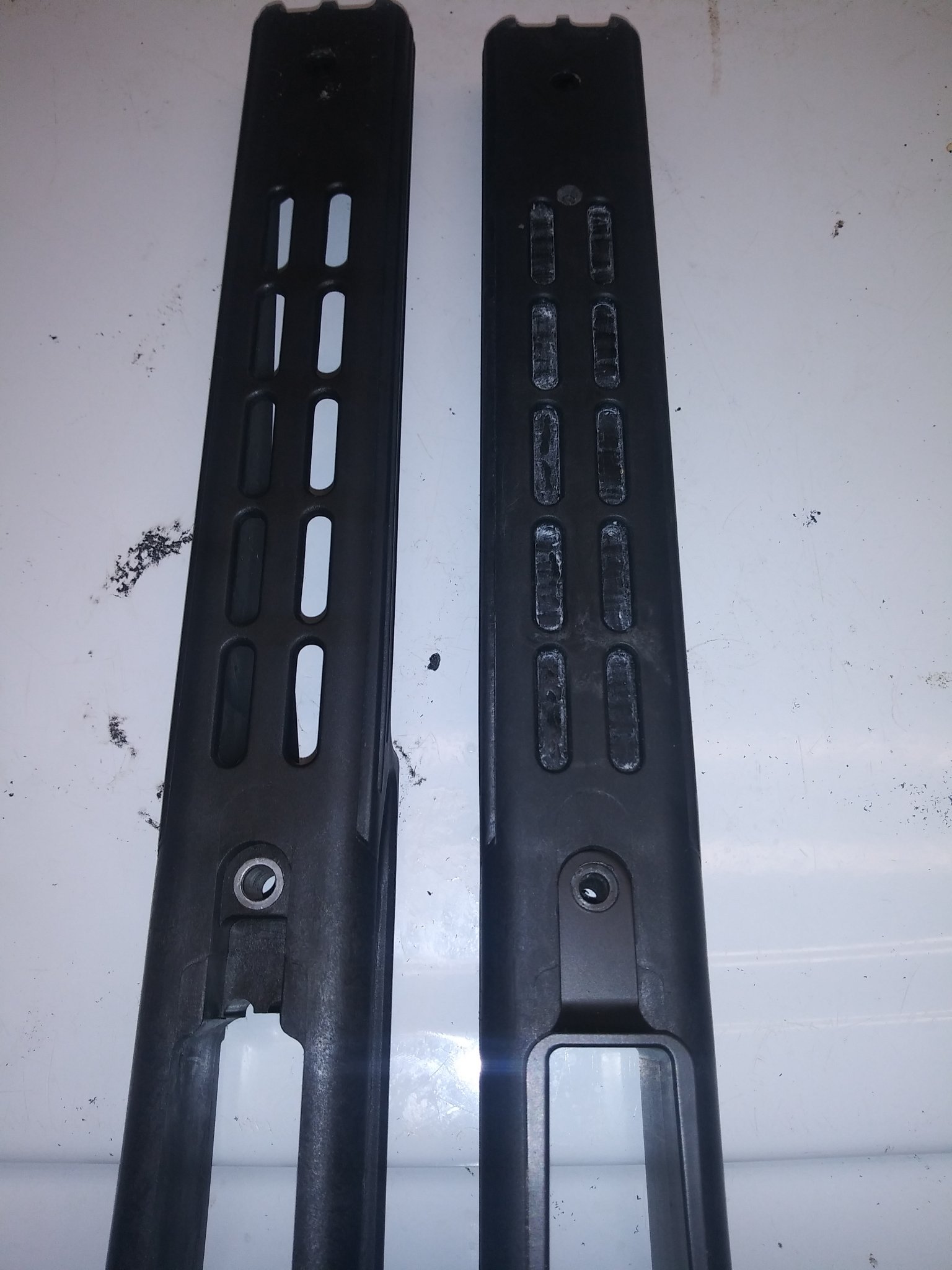

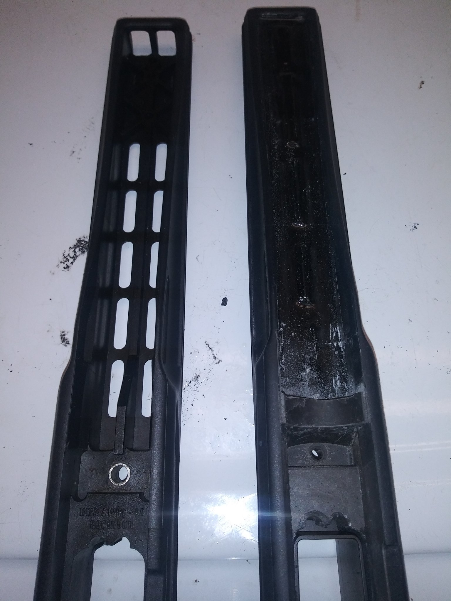

Both DIP & Jefferson Outdoors make aluminum replacements for the plastic-not-so-fantastic factory DBMs. Jefferson also developed a BDL-style hinged floorplate for the Howa Mini, but after a quick look at their website, it appears that they've had serious enough supply chain issues to shut down production temporarily. Jefferson also has a DBM that uses CZ527 magazines, but again, the supply chain issues have forced them to suspend production for the time being. Since CZ discontinued the 527 action this past year, it's anyone's guess as to how long spare 527 magazines will be available.
I've used DIP & Jefferson DBMs on my Mini customs, and have had good results out of both, even though I'm still limited to using the rather flimsy & grossly overpriced plastic mags. Never had any issue with these mags, just not impressed with how thin-walled they are. I've re-barreled five Mini actions to this point, with Bartlein & Krieger bbl's chambered for 20 Tactical, 223AI, 22 Grendel, 6RAT, and 6.5 Grendel. I've got a reamer for the 22 Grinch, and will be using it to punch out the 22 Grendel bbl as soon as PTG gets the resize reamer to me so I can make myself a die set for it. I originally wanted to use Sako Vixen actions for rifles in these chamberings, but that's more or less a pipedream, with the cost of buying a used Sako rifles as the source of actions. And besides, I'm not crazy about tearing a Sako rifle apart just to get the action. The Mini is a substantial action, plenty strong enough for these chamberings, and the HACT 2-stage trigger can easily be modified to get the trigger break down to well under 2lbs. McMillan made me a Game Scout stock for the 6RAT rifle, which I like very much. Tom Manners had committed to building me an EH1 or EH1A for the Mini several years ago, but demands for his stocks (and likely feeding issues with the Howa mags) convinced him to reconsider. Wade Dunn at Bell & Carlson worked to come up with molds for a M40-style and sporter stocks that I like - had two of the M40 stocks on the 22 & 6.5 Grendel rifles before trying a sporter stock on the 223AI, and I now prefer the sporter stock for it's slim & trim lines. Boyds Stocks also makes laminated stocks for the Mini - I have one of their Pro-varmint models with adjustable cheekpiece on the 20 Tactical - but laminated stocks are a fair bit heavier than either B&C or McMillan stocks, especially with the addition of the adjustable cheekpiece. 1st photo shows the McMillan Game Scout 6RAT & Boyds Pro-varmint 20 Tactical. 2nd photo is the 223AI in the B&C sporter.
I recently bought a mini-action 223 and changed the bottom metal out to a D.I.P. aluminum bottom metal and installed the new mag release . I am pretty pleased with it as it changed the mag release orientation and the release spring is much tighter now . I had a mini-action in 6.5 Grendel and sold it as I hated the mag release and as my luck runs I wasn't aware I had options until after I sold the rifle .

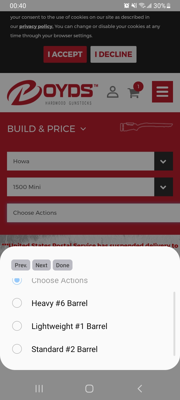

I am building my stock for it at boyds and just trying to make sure I get the right barrel channel opening.
I have a short action howa in 6.5CM with a heavy barrel and it is much more beefy than the one offered on the Grendel even though it's also described as heavy.
The option on boyds to go with a #6 heavy I think would leave me with a barrel channel to wide. I'm guessing #2 would be the right choice. Thoughts??

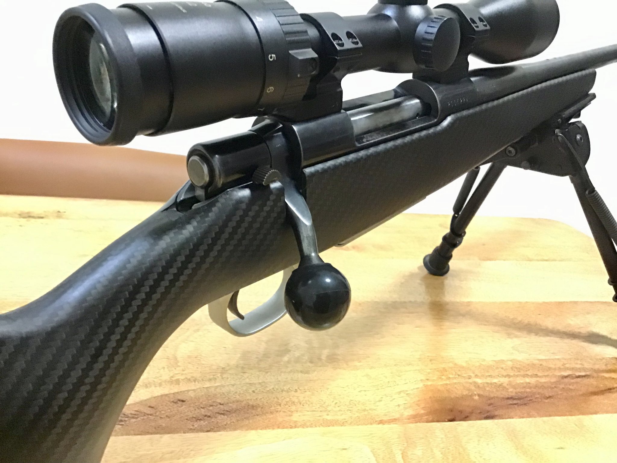

Guys,
Have any of you ever seen a howa that looks like the below pictures?
These pictures are not mine and I am in no way claiming ownership, etc. I am just curious because this was posted for sale as a Howa but looks different than a model 1500.
View attachment 7785191View attachment 7785192View attachment 7785193
The bolt handle itself does indeed look exactly like the one on my m1500...
That looks very similar to one of the original Nosler model 48 actions that Howa made/make for them
The #6 contour is the correct choice for the mini action heavy barrel.
It is not a "standard" #6 as you would regularly think of but of the 3 options listed for the mini action that is the one to get.
The #2 is for the standard contour 22" barrel that is .568" at the muzzle

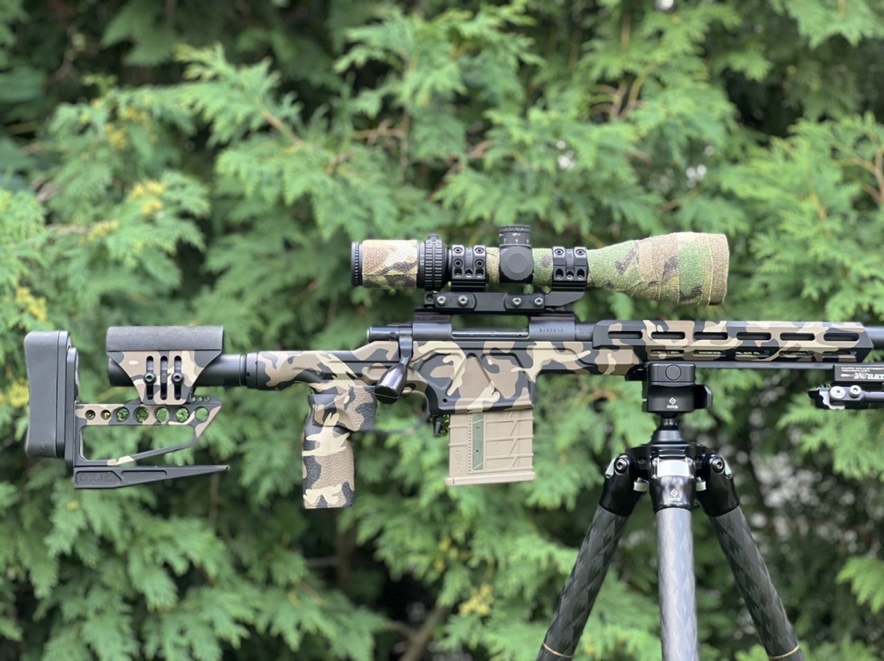

I know they get a lot of hate for being flimsy, but the axiom is light weight and has an adjustable butt. I epoxied an aluminum strut in my fore-end & bedded with Devcon, IIRC it added about a pound and really helped stiffen it up, I bedded the PT&G BM as well.

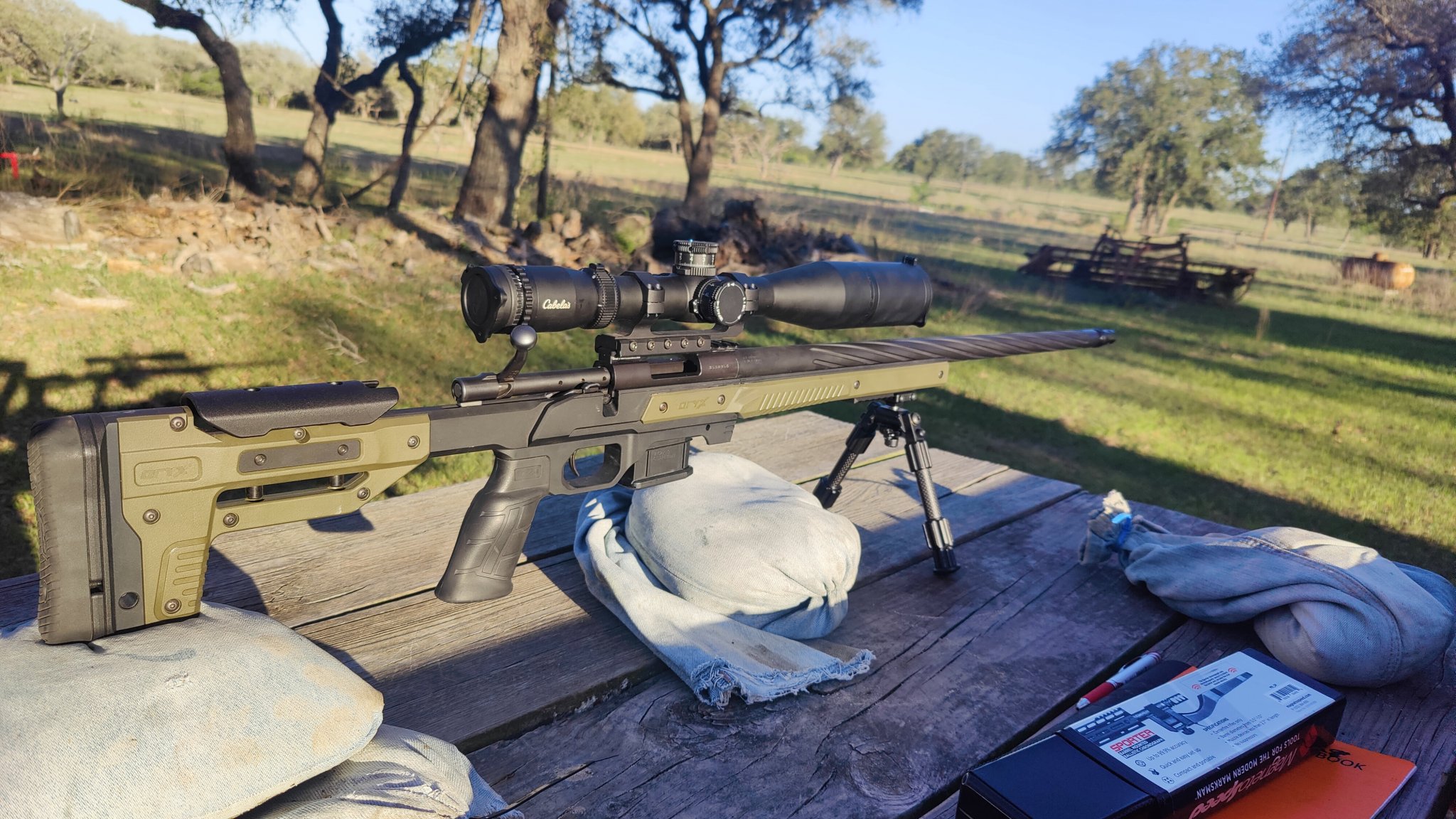

Here is mine.
Howa 1500
Preferred Heavy Palma Howage Barrel 1/8 twist
KRG Bravo with arca rail
wiebad pad
harris bipod
ken farrell base
American defence mount
Vortex Strike eagle 5-25
jard trigger
Area 419 3 port

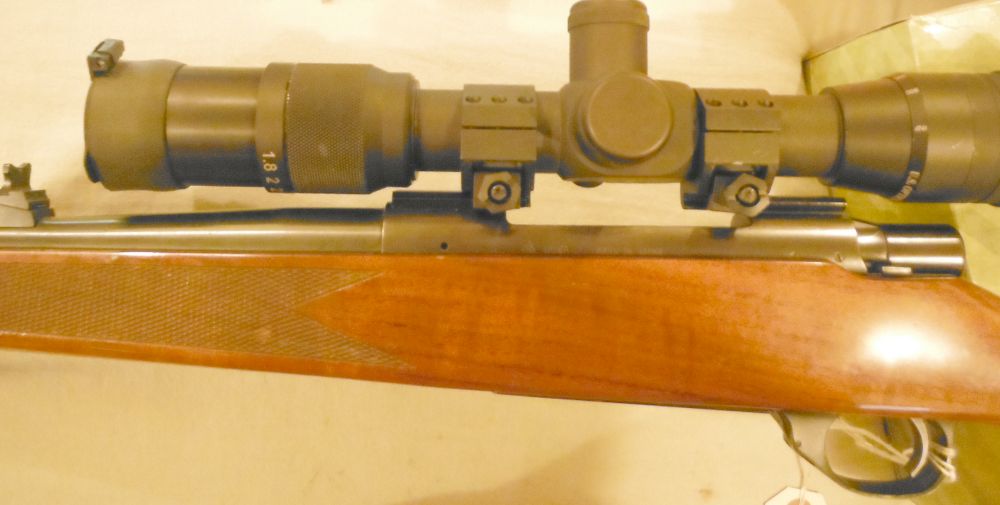

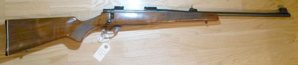

I bought a Howa in 2005.
I have not rebarrelled it yet.
I have rebarrelled Arisakas with metric threads [have to get my hands dirty switching gears in the lathe], but not the Howa... yet.
Metric threads is something I do not look forward to.
  • Howa 1500 270 with Weaver mounts Burris Low Tac rings  and USO 1.8x10x37  m 7-19-2014.jpg
Metric isn't hard you just can't disengage the lead screw. You have to stop the machine and run it backwards while it's still engaged. I've done it quite a bit on Howa short ,long, and mini action and a few bergara b14r at our gunshop

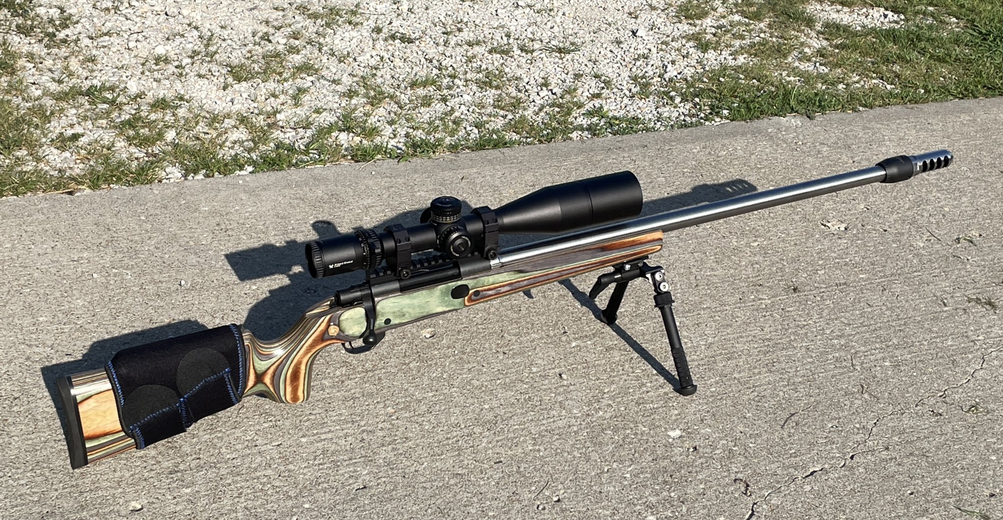

Finally got it together. 16" .308
What load & projectile you using?
Very nice handy looking rig by the way.
With that short stout barrel, you may well get some very good results if you drop down to 110 grain projectiles loaded near max charge weight of H4198. Using H4198 will reduce the muzzle blast considerably as well with that short barrel.

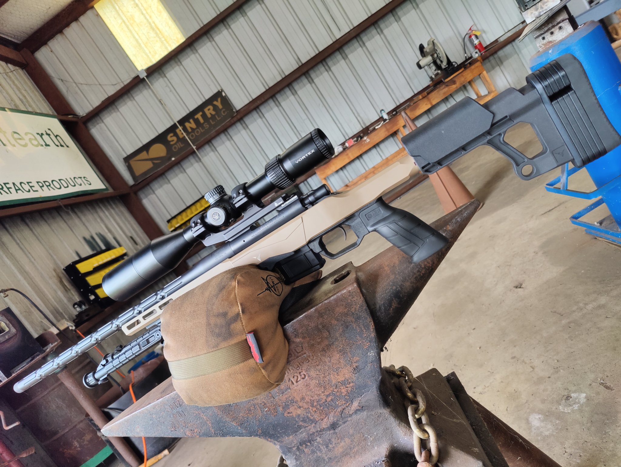

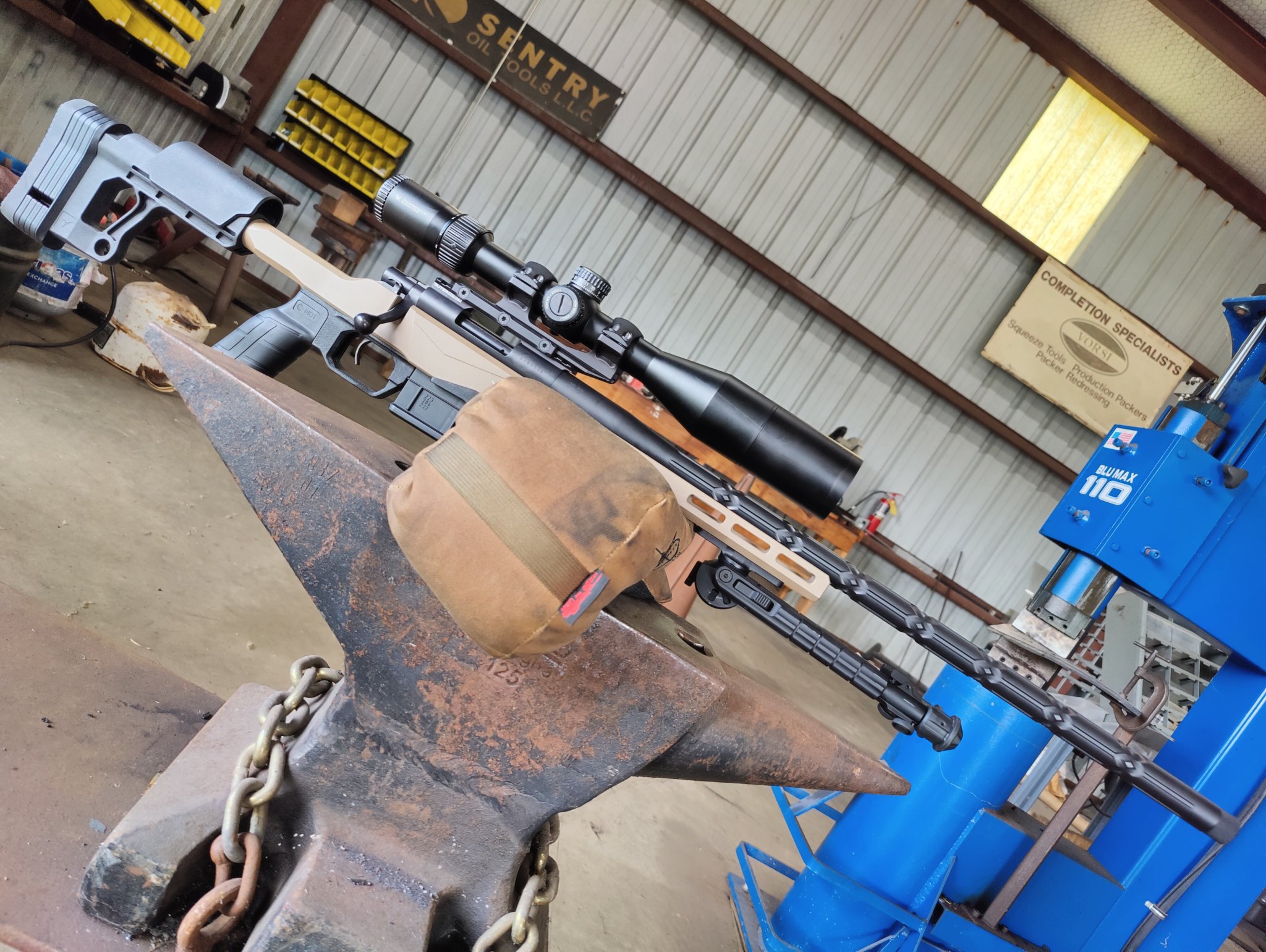

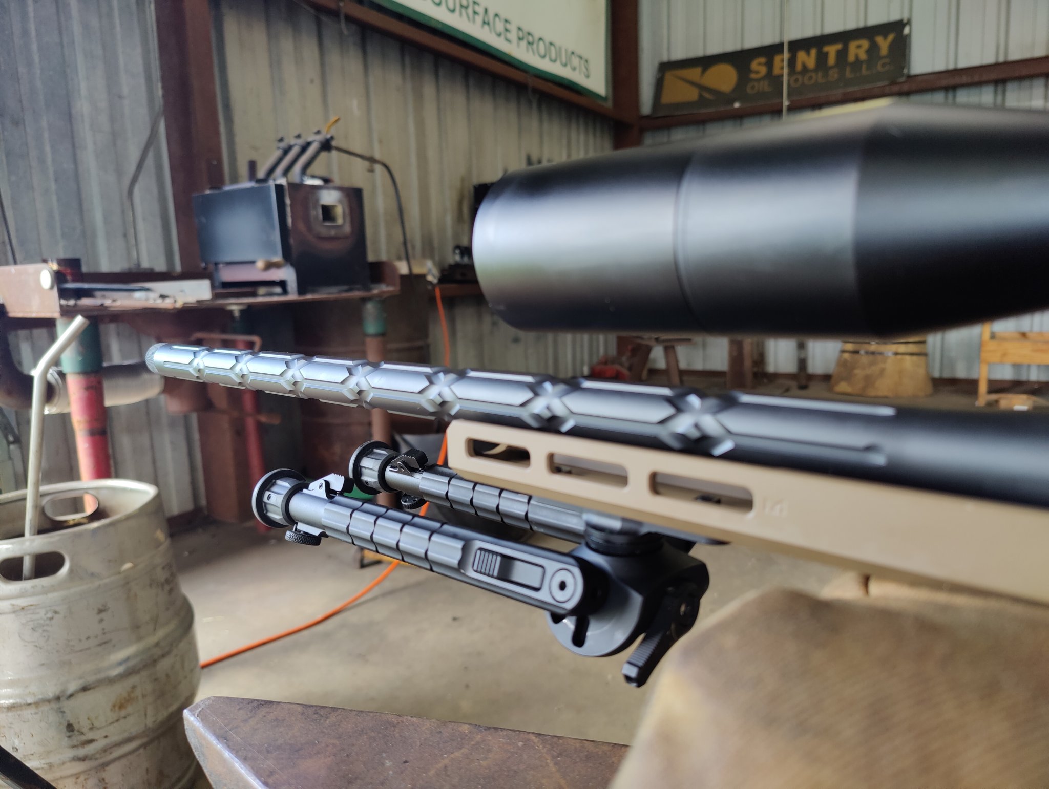

Howa Mini Action 222 Rem
PBB taperless 900 24“ custom fluting
Trybe ROCS chassis
Vortex Diamondback tactical 6-24x50
MDT pistol grip
UTG recon 360 tl bipod

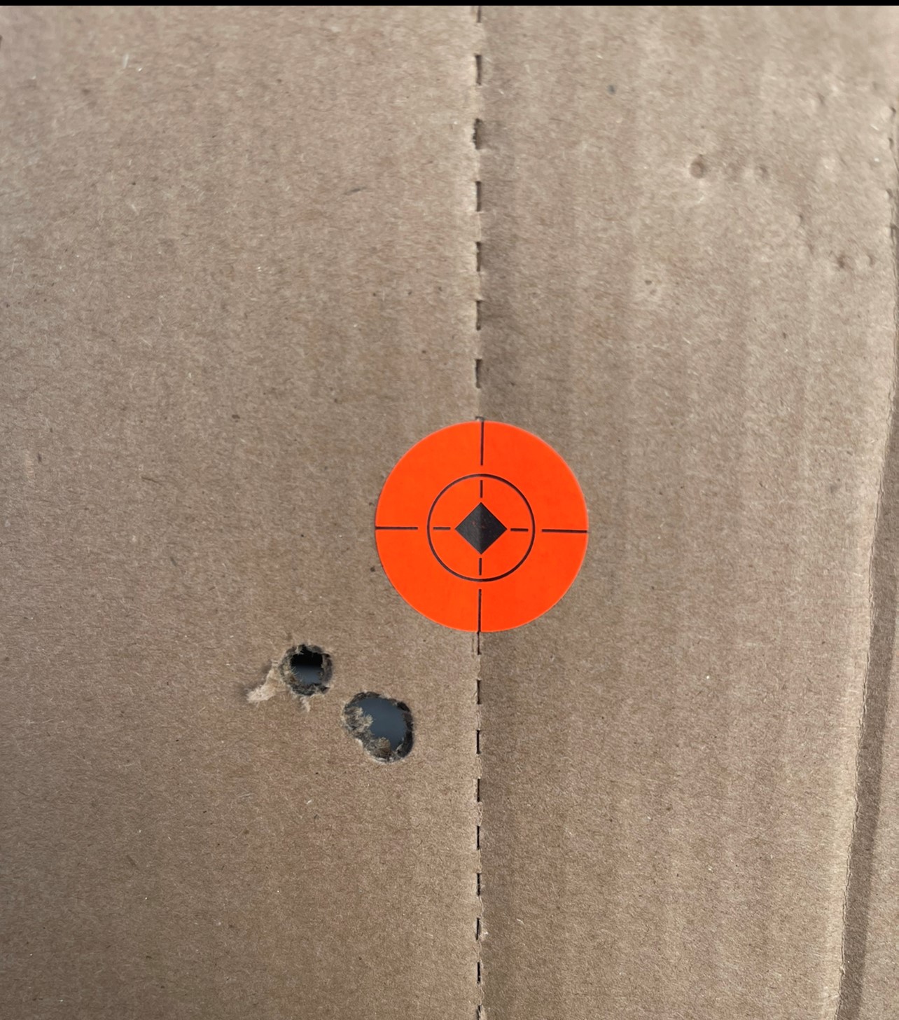

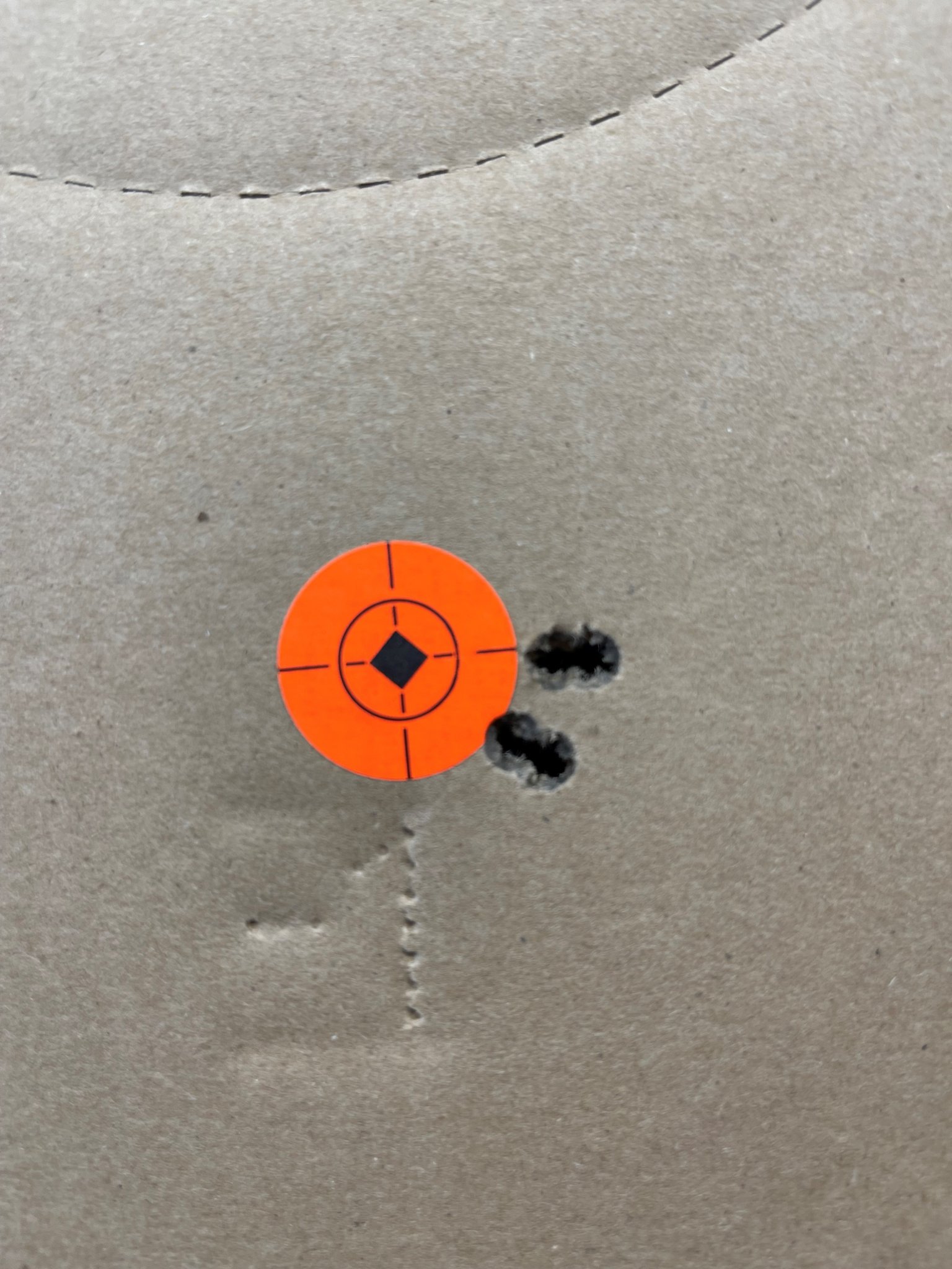

Always enjoy seeing Mini builds. Have you put any rounds on paper with it yet?
This was from the break in. The center 4 holes are two different 3 shot groups. The outer groups opened up but the barrel was getting hot because I wasn't giving it almost any time to cool, so I was still impressed. That was with handloads from the old barrel that I loaded years ago.
Reactions: jpop8807 and rhsc
Out of curiosity; why .222 Rem instead of .223 Rem?
That's what it was when I originally bought the rifle and wanted to keep it the same. Always had better accuracy out of it and I have tons of brass for it. Didn't see any real benefits of going 223 as there's not enough of a velocity increase for the distances on the property for hunting.
