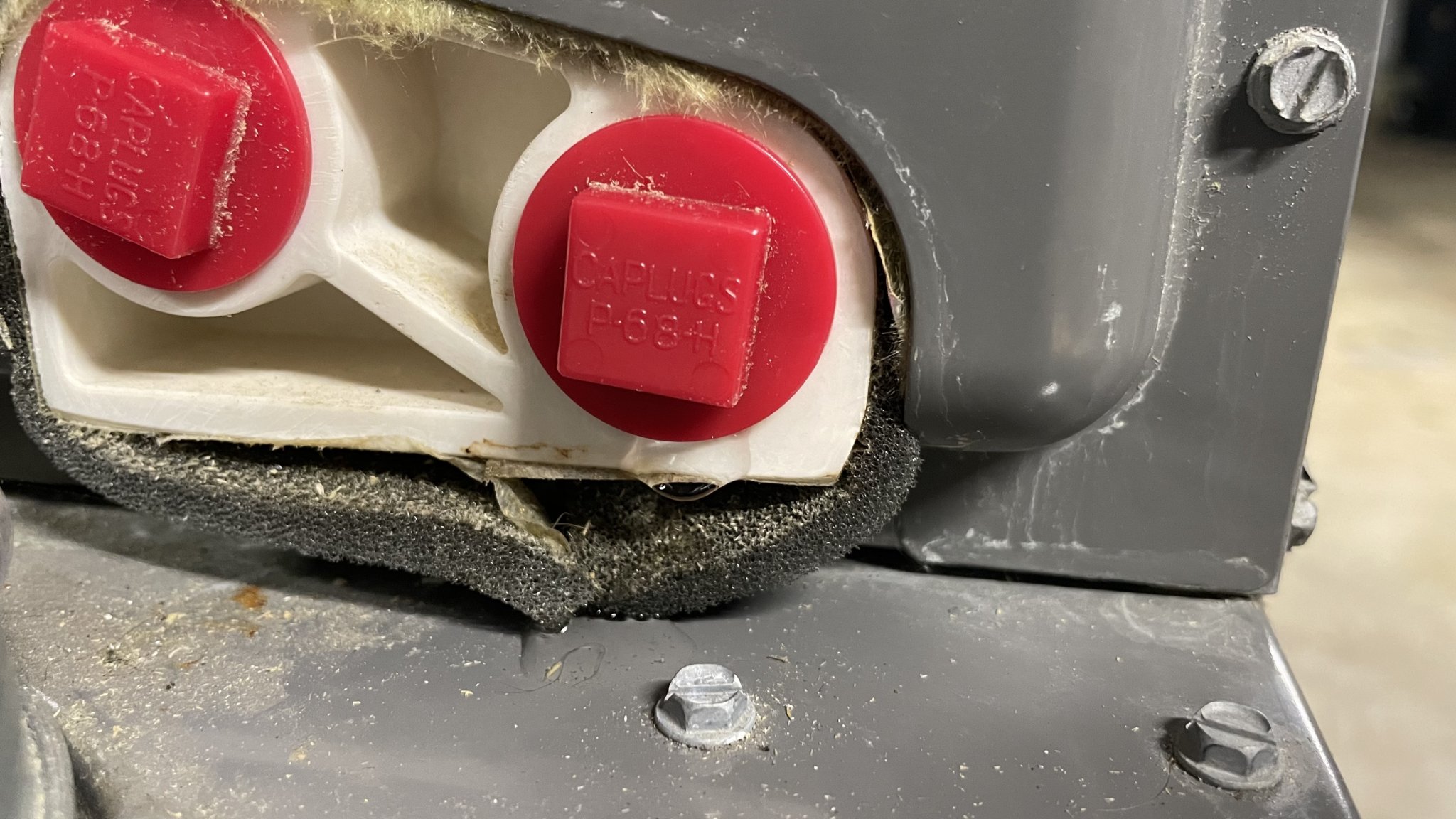

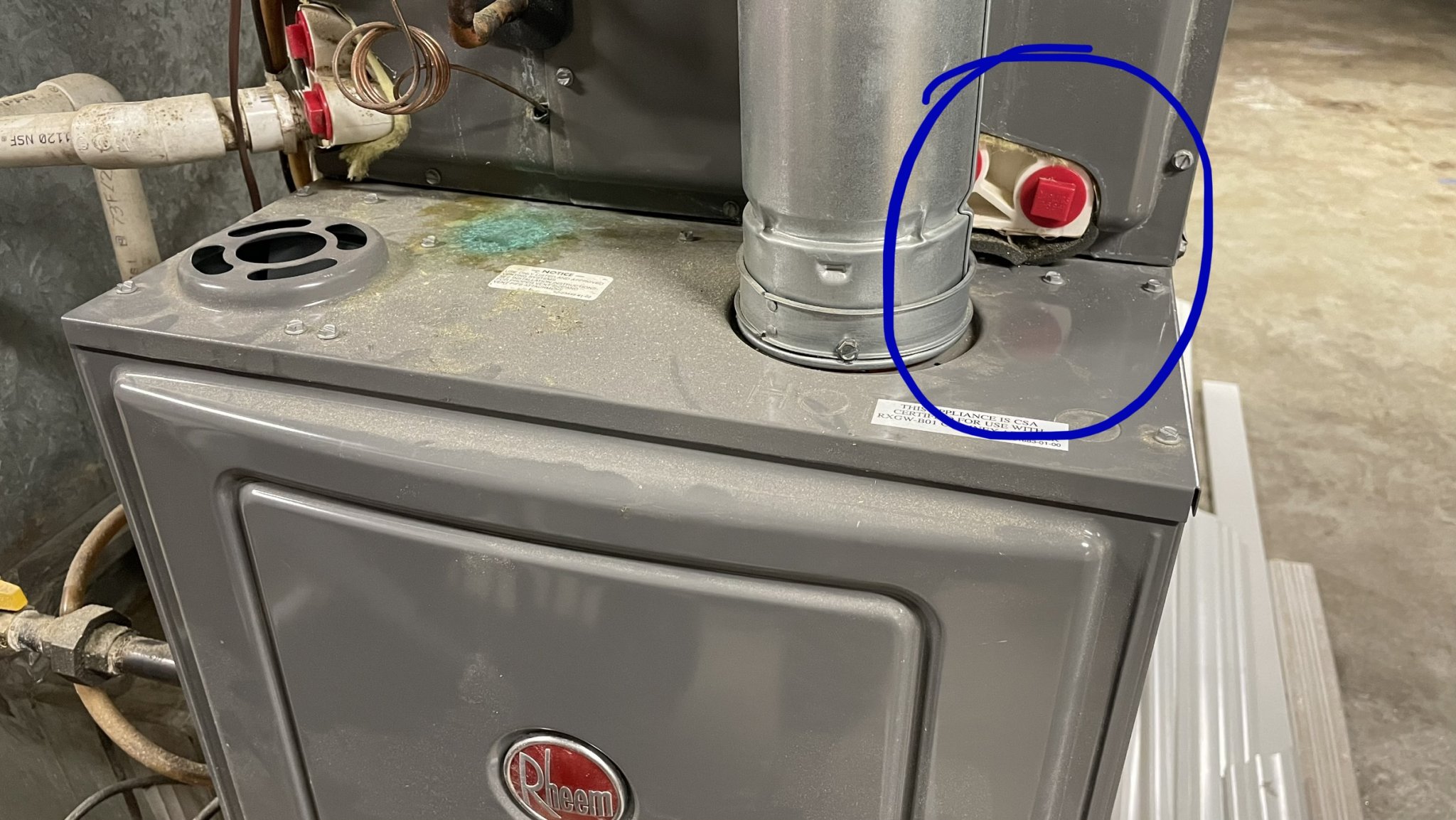

I noticed a small puddle of water this morning underneath my handler on the basement floor and followed it up to a red plug on the side of the unit. I dried up the water and tightened the little plug (it was barely tight at all. Actually kind of loose) don’t worry, I didn’t bare down on it just did finger right and about 2 degrees of a turn with a crescent. Just a tiny bump. However, it’s still leaking very slowly.
What is this plug for? Does it need to be drained? Is this Indicative of a bigger problem?
Excuse the coming dumb questions... what could be clogged? This handler is in the basement and does not have a "drip." I believe it drips down the pipe to the left and goes into a small pump that is then tubed up and out of the basement, following the lines coming from the condenser outside.
I believe I fixed the issue. I checked out the pump, and it is working as it should. I looked up the manual for this unit just to get a better visual and learned that these are just plugs for the drip pan beneath the coils (i think I'm correct). removed the side cover to verify. There is about 1/2-3/4 inch of water sitting in the bottom; not sure if this is ideal or no big deal since the holes for the drain lines are not all the way to the bottom of the pan. The drain seems to be working just fine into the pump. Teflon taped the one drain plug that was leaking.
The only further question is, should the pan be holding any/some/little or no water? Does it matter? Should I investigate further?
There really shouldn't be water sitting in the pan like that. The drain lines get plugged up sometimes with organic matter. There are various ways to clean this out. I usually use a shopvac connected to the end of the line to pull all the crap out, followed by some hot water and vinegar. You can use bleach as well.

In the morning I think I’m going to pull the PVC drain line off and vacuum it out and see if that pulls any debris that’s sitting at the base and damming it. I know it is draining but the pan holds some residual. Thanks for the feedback

In that limited view of it....PVC to steel (MISTAKE!) to PVC 45* to PVC 90* to PVC 90* all on what appears to be the same level.
Not sure that is a steel threaded piece in there, it looks like it....and we all know steel doesn't rust, right ?
There should be a downward slope to every bit of it, and I see none (granted camera angle and whatnot).

All those junctions make for places inside the PVC to hold residue which in turn causes clogs....kinda like what you're experiencing, right ?

It has been my understanding that there should be two drains out of the evapoprator the lowest (main) drain and the
a second drain connected to the higher drain port to provide a visual indication that the main is clogged.

It comes from an open pan at the bottom of the "A-coil" that is actually the evaporator (hey, everyone says a-coil everywhere, it's just not technically accurate unless going by looks).
The drain is an open at both ends tube, connected to nothing on either end....it's basically a guide for dripping water, nothing more.
It can't siphon unless you seriously have done something impossibly stupid.
The only reason for a trap on one is to prevent insects from climbing into the A/C system.
Reactions: ArTeeKay
A trap is used for negative pressure drains on HVAC systems.
When the evaporator coil is located up stream of the fan you have a positive pressure situation and a trap is not required for condensation to drain. When the drain is down stream of the fan you have a negative pressure situation and a trap is required for the condensation to drain.
The coil pictured has multiple drains so you can either make it a right or left hand drain depending on what the installer needs. Some of the evaporator coils are designed for multiple layouts. Whether it's up flow, downflow, horizontal left or right and there's multiple drain connections for those layouts.

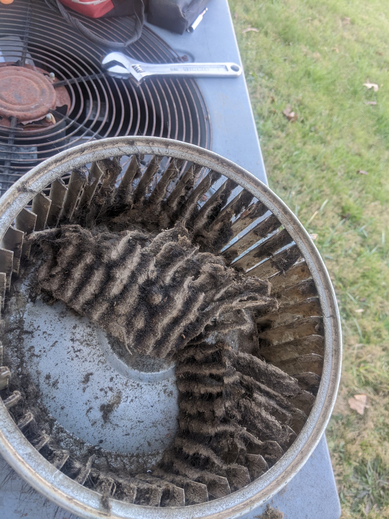

Thought you would get a laugh out of this picture.
Customer states that the air was working fine until last night. (This was a year or so ago)
I asked when was the last time they changed the filter. Of course they said last night. So I asked them.. before that? Every month they told me.
Considering that their ductwork was intact. I believe that they were not telling me the truth

JB, Sounds like at least some of the advice offered was on point. The A-coil in the HVAC for either central air (gas heat) or heat pump will produce liquid condensate when the A/C is running. The amounts vary with the humidity. The PVC pipe in the 2nd pic is the drain for that water. It only collects in the warmer months. Often the drain will clog with mold, algae, dust, etc and cause the drain pan to over fill. Clean the drain and pour some bleach in it once a month in the cooling months and it is usually trouble free. Not enough detail in the photos for me to critique the design and installation. It is humid in KY in the summer and I can see as much as a couple of gallons per day from my drain.
While cleaning the drain, replace the filter every month or two and check to make sure there are no boxes, gun cases or ammo cans piled on top of the duct vents in each room. It will improve the efficiency of the unit's performance and extend the life of the compressor.
