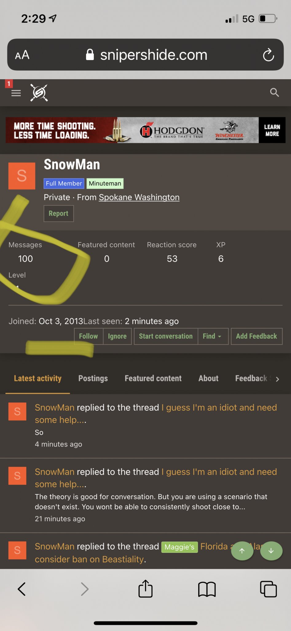

Lol 2020 join date with 3 posts that day and 11 posts today. Total.
They give off a smell or something I know the answer before i click the profile
