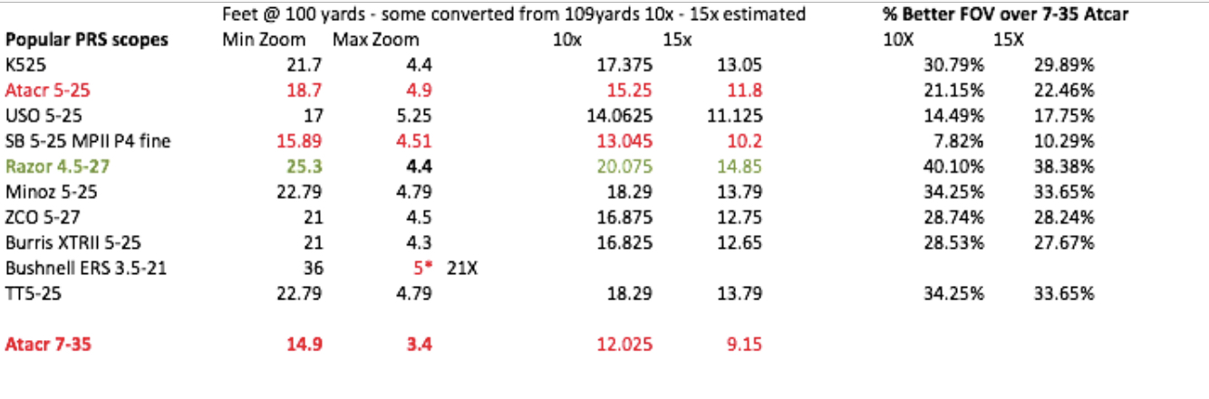

FOV is my only really gripe about the kahles 525. It’s awful compared to the others.
I know by comparing the ZC0 and K525 they have similar FOV at max power yep, max power... When I shoot a match I am not bitching that I am on 13x vrs someone 14x or whatever, it is splitting straws.. Hell, I probably shoot al lower powers by default anyway. I shoot most targets NRL22 matches at 8x, most center fire around 12x... I do well and do not think I would win more if I was 2x or whatever higher in magnification.
MY 7-35 was truly like looking thru a straw, similar to the Sightron. My older SB Tunnels severly and the FOV is not greater at the powers I use, than my Kahles. -- no matter how you slice it the Kahles, is NOT "awful compared to the others".
Yes, I used the MFG listed numbers to so that the Scopes other than the 7-35 are in the same relative ballpark.. If the MFG numbers for S&B are wrong, bad on them.. But even with your images the Kahles is not awful and certainly not to the 7-35 the OP asked about.. I sold mine quickly. Going round and round trying to defend the statement It’s awful compared to the others just isn't productive.
Anyway thanks for taking the pictures.. They came out nice btw - never been able to get my iphone to take a good thru the glass image.
@Diver160651, can you expand on the "looking through a straw" comment. I'm about to pull the trigger on a NF 7-35, but your comments about the FOV have given me pause. I'll certainly be shooting positional stuff with the NF and have magnification around 15-20x, so FOV at that mag is important to me, as is eye-box.
I did see this excellent comparison from @spife7980, which seems to suggest the NF is pretty solid re FOV, and that the Kahles is indeed significantly worse than the competition. Also, which Sightron did you compare the NF to?
I'm wondering if @koshkin can comment here re the FOV discrepancies noted in the tables in post #84 & #83. I'm not interested in calling anyone out or anything of the sort, but I am interested in accurate data. If the NF 7-35 is a handicap for positional stuff due to FOV I'd like to know before dropping 4.5K (AUD) on one. Cheers, BP
I did not create these tables, so I do not know some of the calculations used. You have to go to the original source, so to speak.
I will say that the 10x and 15x FOVs in post #84 are mostly wrong.
7-35 ATACR has perfectly competitive FOV. It tunnels a little, roughly between 7x and 8.5x or thereabouts. Above 8.5x or so, its FOV is quite good.

Thanks @koshkin, I'm still weighing options. My most used scopes are a S&B 3-20 and a NF 4-16, but I've some time with a March 5-40 re the larger mag ranges. I do tend to prioritise FOV over absolute magnification, but I'm certainly interested in the NF 7-35, I'll try and get some time behind one before deciding which direction to go (for a PRS optic). I'm actually perfectly happy with my Bushnell XRS 2, 4.5-30, so my $ may be better spent on components :)
Regardless of personal opinions, none of the optics in the discussion will handicap you in PRS.
The 7-35, k525i, and 624i are very popular among shooters. I’d imagine zcomp will be as well as the year goes by.
I tend to agree, but it's equally important that personal opinions are based on factual data, which is what I'm trying to address in my most recent posts.
Agreed. Though even if the different data is correct, non are enough to hinder you in a match.
