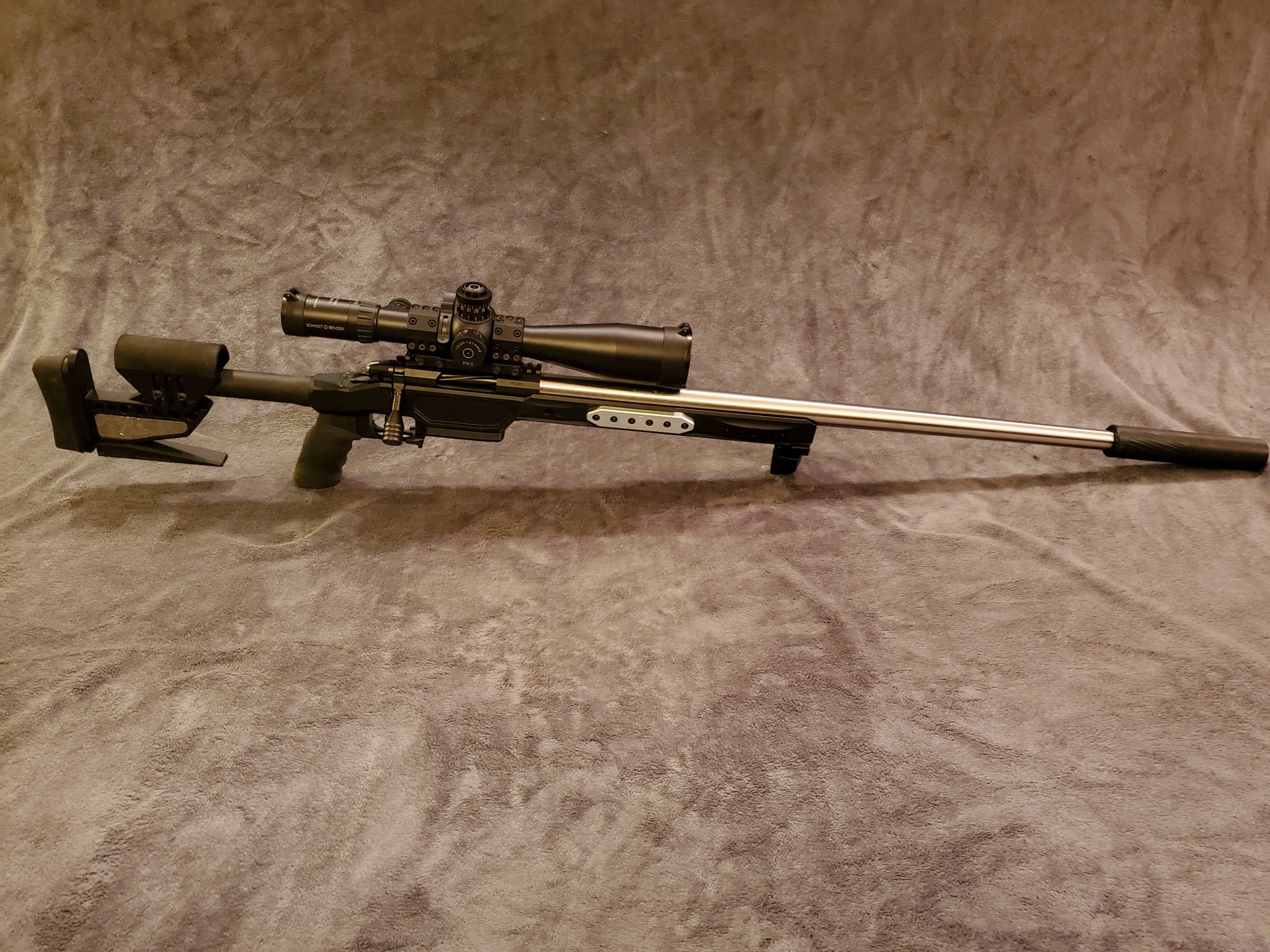

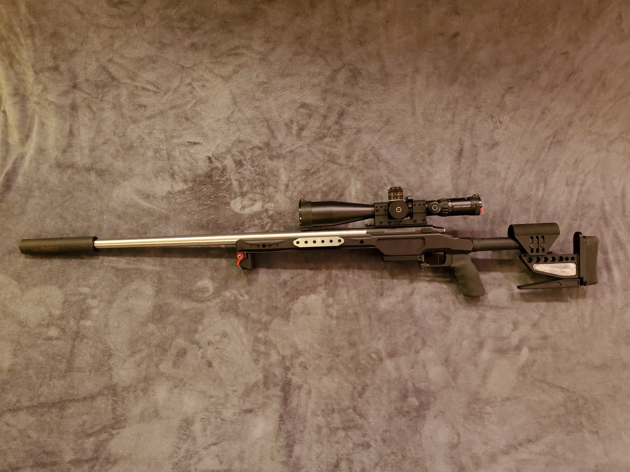

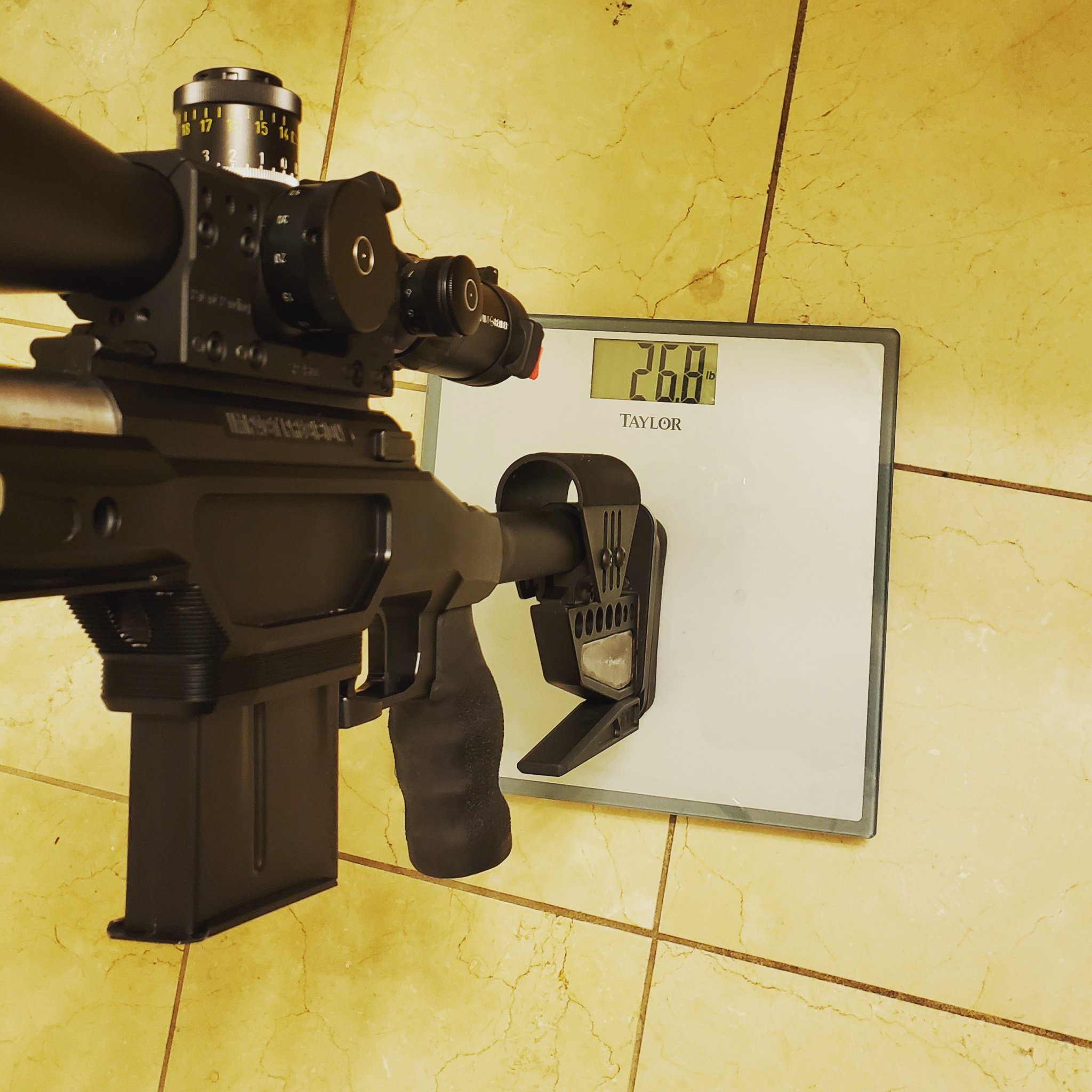

Finally got my build fully put together between rifle, chassis, scope, and suppressor. I'm pleased with how it turned out, and more pleased with how well it shoots DTACS. The heavy weight is a nice plus for PRS matches.
As far as the action itself goes, it's hands down my favorite action I've laid hands on. I had some early issues because I'm apparently too dull to figure out a trigger hangar - I installed it upside down and then backwards before trying the right way last - but once I actually put it together properly it's been fantastic. Super smooth cycling straight out of the box, and it stays smooth regardless of if it's bone dry, drenched in oil, properly lubed, or filthy from shooting in the blowing dirt of Colorado farmlands (which sadly included all the freshly planted seed). It doesn't have all the bells and whistles of the Nucleus I had previously, but it's an action that just works and that's the reason I bought it.
My only complaint would be that the partial cock on close and heavy firing pin spring affects the adjustment range on my TriggerTech Diamond. With the Nucleus I had it set to about 10oz without problems and it was fully drop safe down to below 4oz, but with the heavy spring on the Impact I have to set the trigger to about 14oz and that's as low as I can go without making it unsafe (setting the firing pin off when you close the bolt hard and fast).
Rifle specs:
Impact Precision 737R Action
Krieger 27" Heavy Varmint barrel chambered in 6BR by Keystone Accuracy
XLR Envy Heavy Fill Chassis with accessories (barricade stop, mercury buffer tube, weight kit, and a custom chunk of lead)
S&B PMII LP w/ T3 reticle and 6MIL Spuhr mount
Thunder Beast Ultra 7

How dare you post a picture of a 30lb 6BR with a sub - 1LB trigger on this forum!
I'm young and spry, in a pinch I can still run around with it in my hands or on my back in all of those scenarios where I'm told you absolutely need a lightweight gun. As far as the trigger goes, this thing feels like a double-action revolver compared to what you use in free pistol matches!
Or I can just acknowledge that this gun is built for a specific shooting game and keep using my cheap 30-06 beater for hunting and everything else where you want something light and powerful, ha ha.

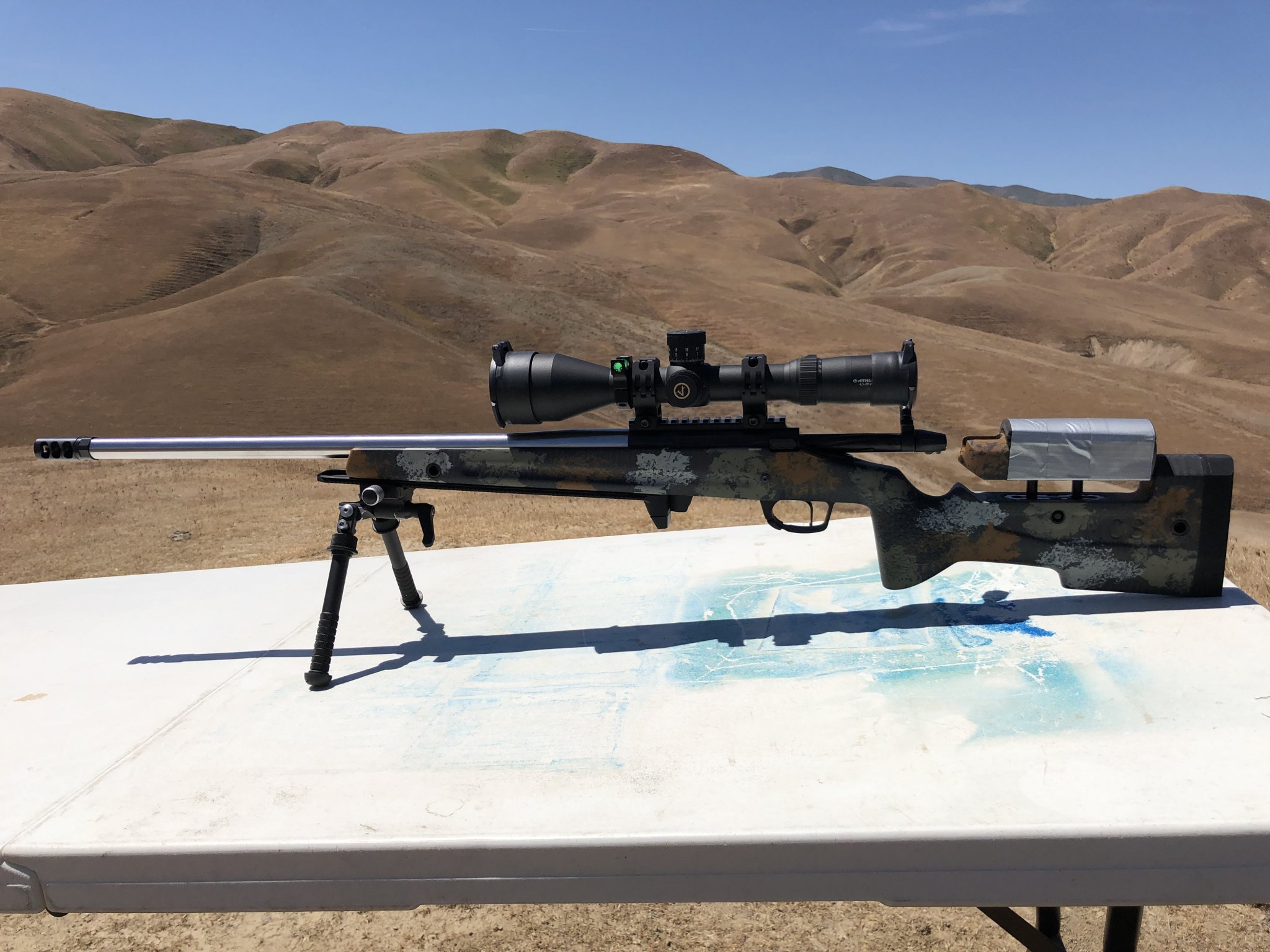

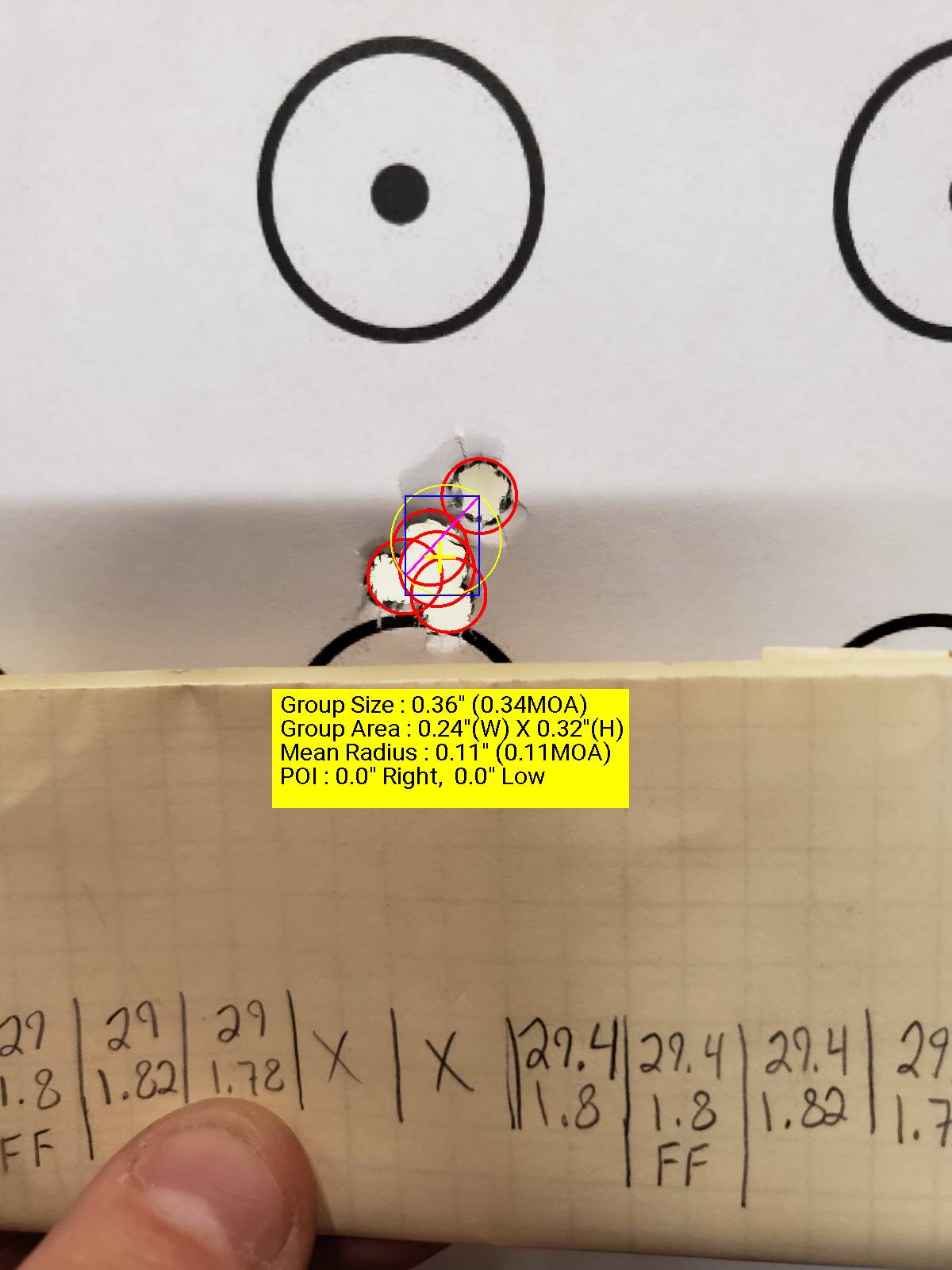

Just got the impact out today. I was a bit nervous as I put it all together but shot nice little groups.
Group is at 350.
Impact 737r
6.5 marksman contour 24in by PVA
Pva jetblast
Manners prs1
Area 419 rail
Cal gen 2 atlas w/ rrs mount
Cronus BTR

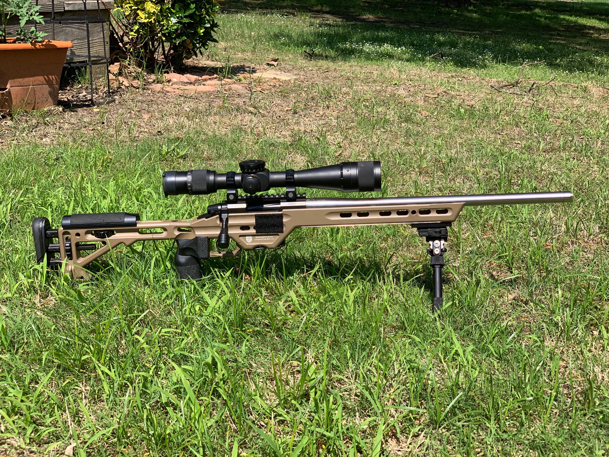

So i didn't feel like googling and am waiting for a PRS2 to come in stock at Altus so i can get it from them cut for my impact. However barrel just shipped, action wrench will be here tomorrow, AMG and rings soon to follow. I want to drop it into my brothers MPA just to start shooting it. Any modification required?
Unless the MPA is cut for an Impact Precision action it will require some modification so that the trigger hangar can fit properly.
You will need to use a dremel (or a file/sandpaper and a LOT of elbow grease) to put a small notch in the front of the pocket that's machined out for the trigger. The front, in this case, is the part right between the trigger pocket and the mag well.
This cut out needs to be centered in the trigger pocket and about 1/2" wide because the trigger hangar is centered and 0.490" wide. The cut out must extend at least 0.2" down from the top edge of the trigger pocket (the trigger hangar sticks out from the action by 0.183").
Finally I'd recommend gauging the depth (more depth = cut out extends further towards the mag well) of the cut out by how your action itself fits into the chassis. start the cut out very shallow and gradually make it deeper until it fits your action just right. In my XLR chassis I had to cut away approximately half the material between the trigger pocket and magazine well. YMMV and the less material you can remove the better, so again I recommend going slow and steady with regular stops to test fit your action.
Note that when you test fit the action you need to install the trigger hangar before testing the fit. When I did my cut out I forgot to do this at first and made a super shallow cut out that seemed to fit great. I installed my trigger into the action (trigger hangar was on the trigger, outside the action, during the cut out and fitting earlier) and was confused when it didn't fit. Then I realized what a goof I was and had to go back to my shop to make the cut out the right depth.

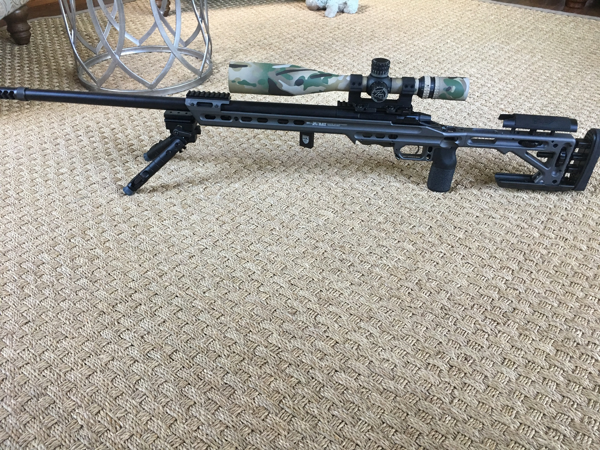

Waiting on the AMG and PRS2 but pretty happy with how it's turning out weight wise. I was worried with the impact and 20" medium palma it might be too heavy. But i think it will be right at 10-11lbs once i get the PRS2 in. My brothers MPA needed no modifications to fit the impact fortunately.
