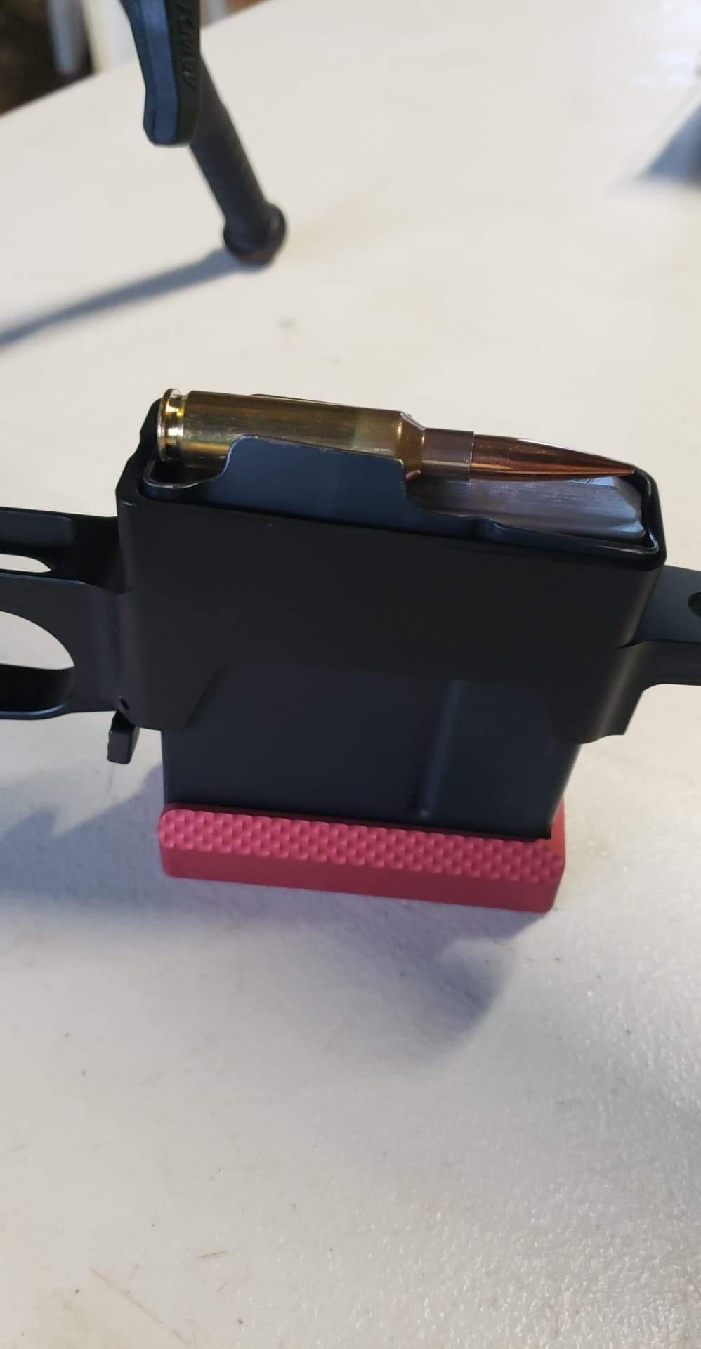

Is anyone running magazines with no binder plate in these actions in 6.5mm Creemoor? I've got a 737r on order that will be going in a MPA competition chassis, and I'm debating the binder vs. no-binder plate magazines (Accurate brand). I don't want to have to notch feed ramps, but would prefer the longer COAL without binder plate for loading solids. If it's going to come at the expense of reliability for things like 147gr/143gr eld-m/eld-x though, I'll just get the binder magazines. I saw post talking about this:
Mine works well using either an Accurate Mag with no binder plate (I use a spacer kit for this, since I shoot 6BR) or an ARC mag without the spacer kit.
but that was for 6BR with a spacer kit, and another two that weren't cartridge specific:
Can anyone tell me if an Impact will work with Accurate Mags that don't have the blinder plate? Deciding on my next caliber and I need to know if I'll be able to load to the OAL I need for some.
Got an almost immediate response from Tate via email. They've had no problems running mags with no blinder plate.
Would that indicate with 6.5mm CM it'll be no issue for factory ammunition as well as longer handloads? That's how I'm reading it, but would like to confirm before I buy a bunch of magazines that won't work. Hands-on experience would be awesome! Thanks.
This was his exact response: "With a properly tuned magazine we have had no problem running magnums at lengths that barely fit in the accurate mag without the binder plate.
Thanks
Tate"
I ended up changing directions with the build so I no longer needed the no blinder plate mags.
Thanks
Tate"
Great, thank you. Now I have to figure out how to 'tune' the magazines. What'd you end up doing with your build?
I was going to build a 7SAW because I wanted something different and was impressed with its reported performance. But I'm impatient and indecisive and didn't want to bother with renting/buying the reamer, getting to a smith, making sure they got it done in time if renting, buying custom dies/brass etc. So I just built another 6mm. I LOVE my BR. It's crazy accurate and so easy to load for. Went with the 6XC so I can shoot the 115gr DTACs.
Tuning magazines just means bending or trimming the feed lips to ensure they don't interfere with the bolt (and they release the round properly), as well as potentially shimming the magazine catch to remove any slop or play in how the magazine inserts into the rifle.
