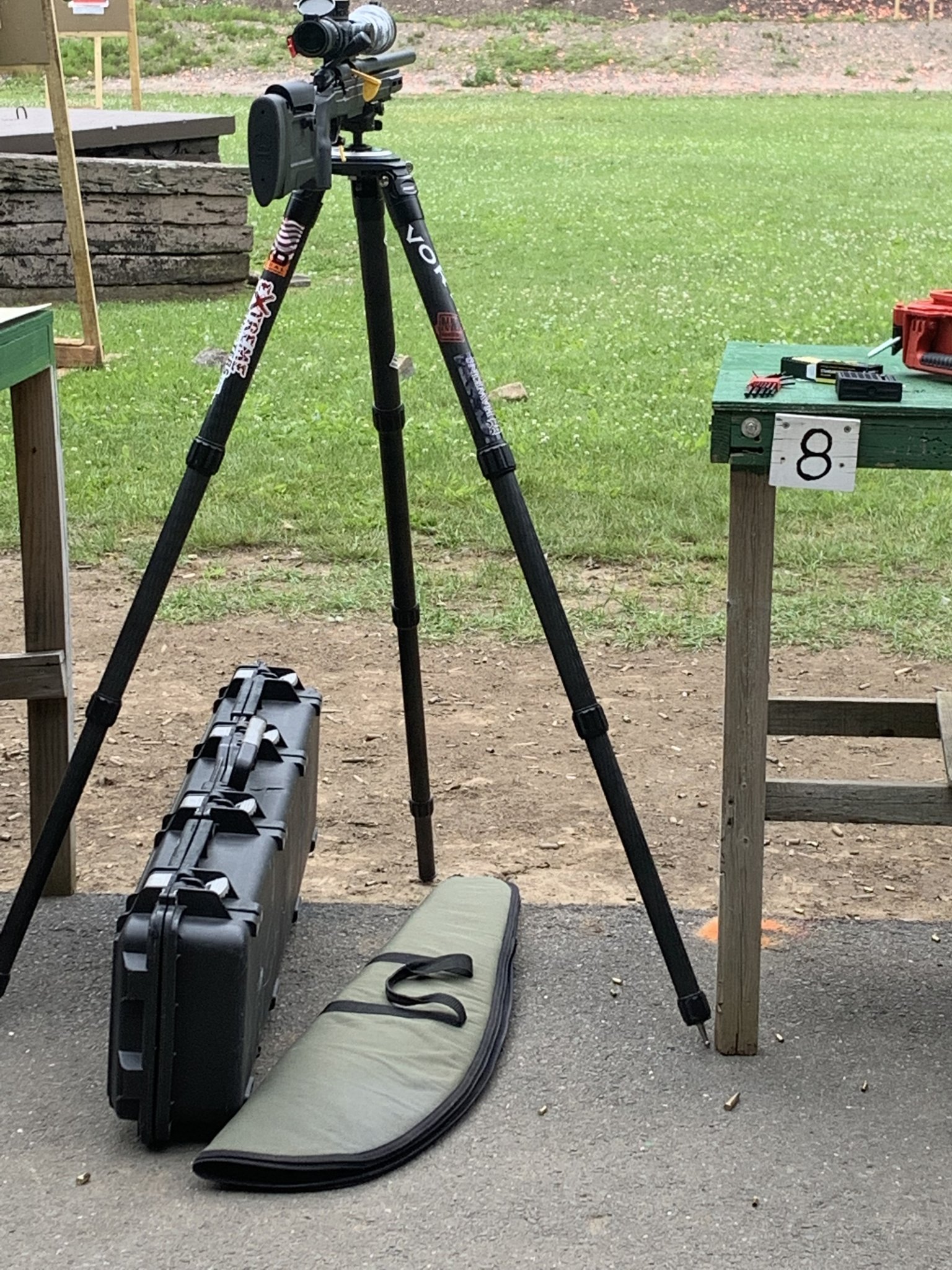

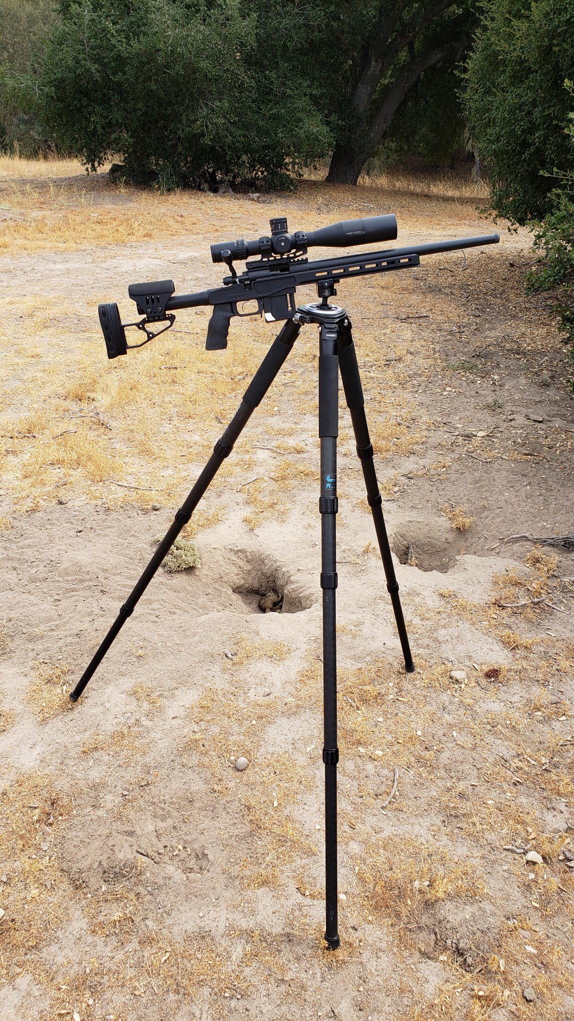

I initially bought the RT90C to use as a spotting platform for precision matches. After going through some different ball heads I settled on the Sunwayfoto IB-30. I've gone on to use it to great success for varmint hunting, shooting squirrels standing off the tripod from point blank to 200 yards with my 223 and out just past 100 with my Vudoo 22LR (pictured below). The RT90C now seems a bit heavy to be walking around with. I may be in search of a lighter option for next year's varmint shoots.

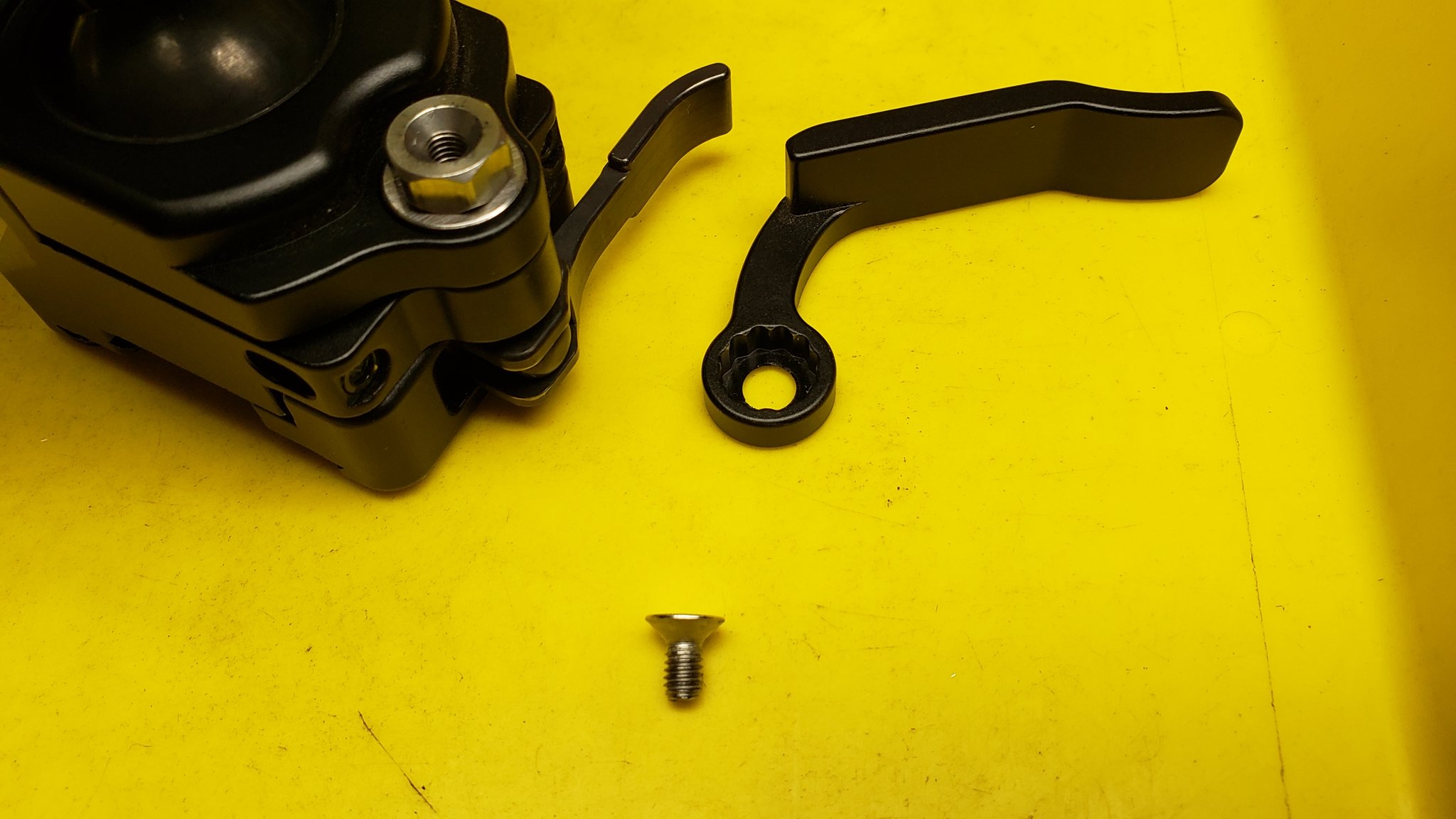

When new, the IB-30 held tension well, but after a year or more, it was right on the edge of holding the rifle securely without tipping.
I looked further into the construction of the IB-30 and found you can adjust the tension. Just remove the screw that holds the tension lever and you can then re-index it to hold tighter. Hopefully this helps someone who's displeased with the initial tension these offer.

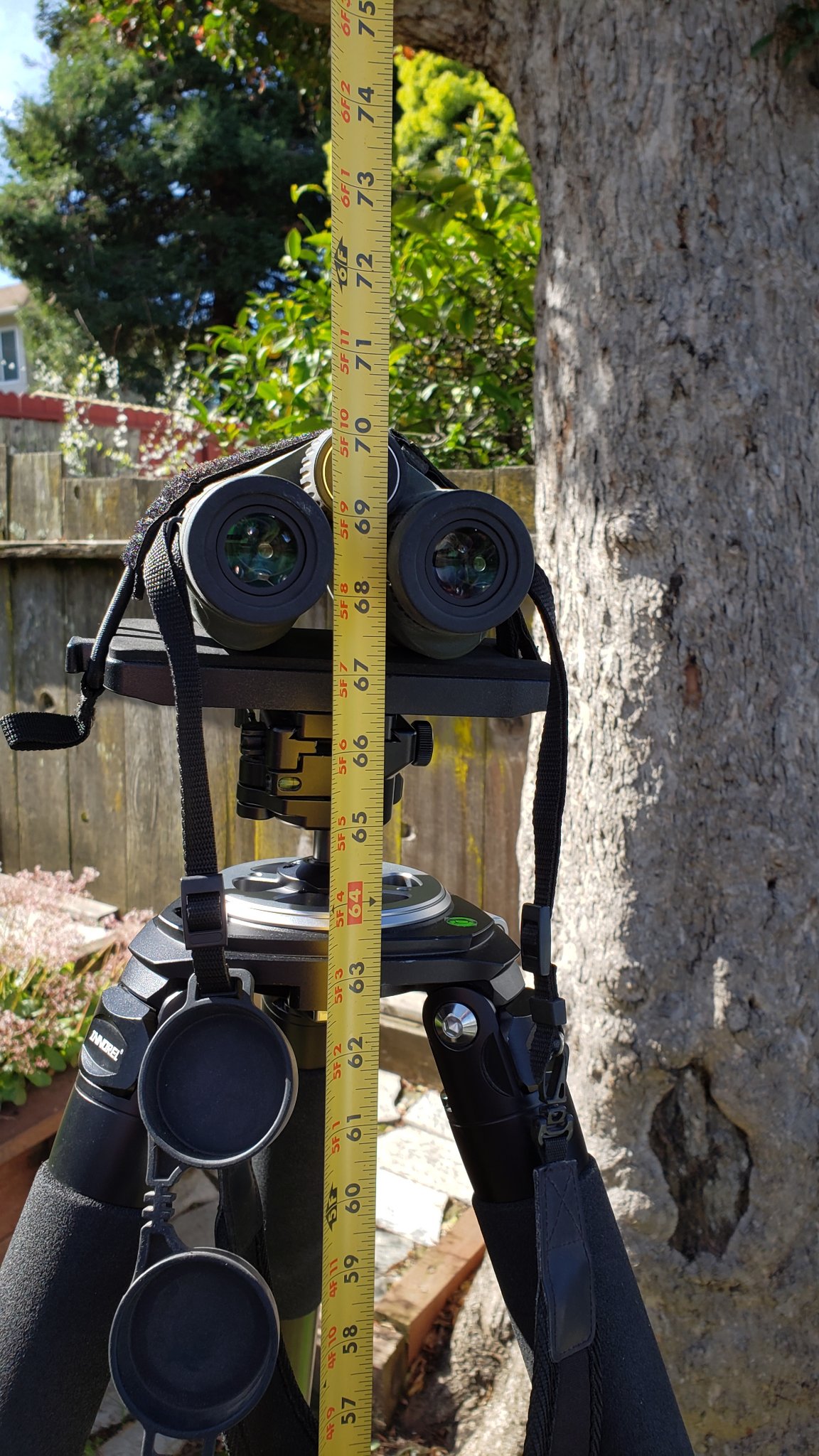

Nice. Looking at purchasing a similar set up for hunting/rifle use. How’s the height of the tripod? I’m 6-5” and concerned about the height.
Reactions: MustangGreg66
Will most likely be low for you if you’re glassing with it depending on terrain but shooting off it shouldn’t be an issue. I’m like 6’ 2” ish and can shoot off it without issue since I typically try to keep the rifle mid chest to shoulder height depending on what I’m doing. Now for glassing I’ve got it fully extended for binos and I’ve got to hunch down a bit, with my spotter I’m definitely hunched a lot, I ended up find a leofoto SO-386 and it’s a skyscraper fully extended but it’s a two section leg making it long.
Reactions: Fresh2death
I'm 6' 2" and find the height works well. If I stand up straight I'm just looking over the binos when glassing. I like to stand a little wider anyway. At 6' 5" you might find it too low.
Thanks for the info fellas. Ended up getting a Leofoto SA-364c + ma-30 for $287 shipped from Desmond photo on eBay. Couldn’t pass that up. It appears the height is the same as the rt90. I’m only going to be shooting from it so the height should be ok.
